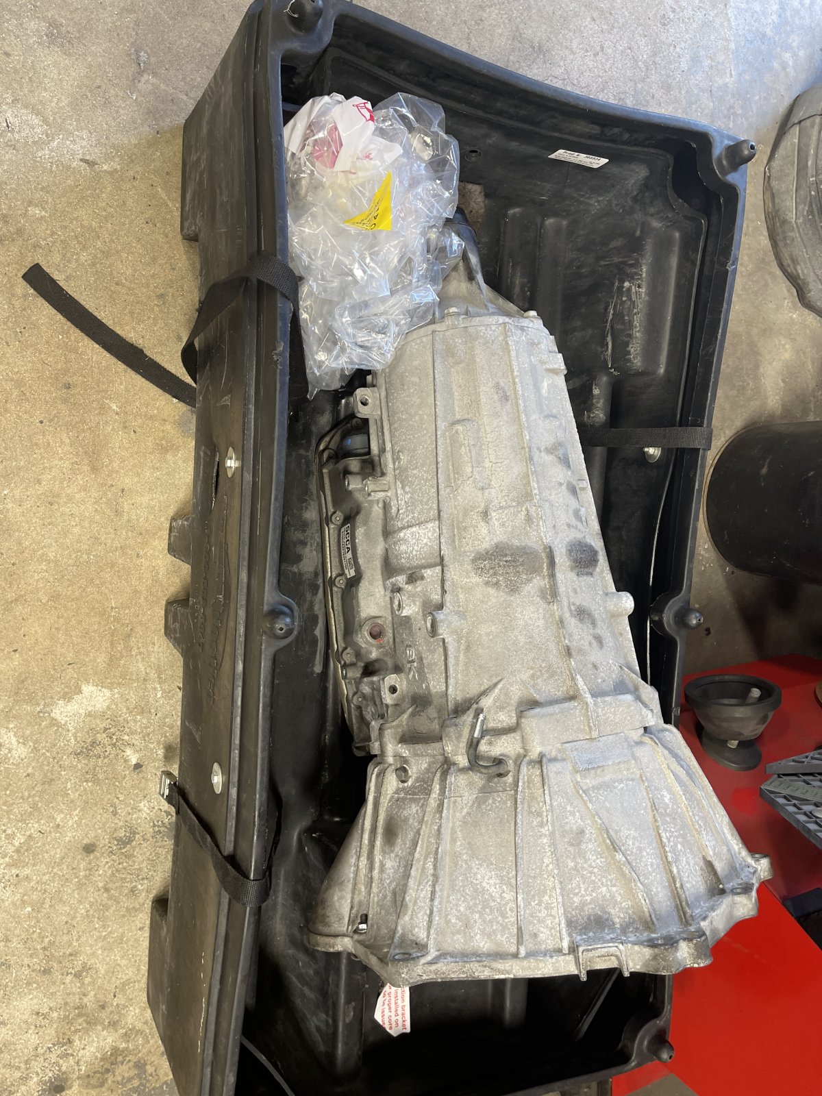

Ouch I know about Jasper cost, but The rest of my 2015 LTZ is nice…. 3 years and 100,000 miles warranty parts& Labor. NOW it shifts so smooth and No shuddering.
As crazy as money is we got a 0 interest credit card and will pay $300 a month for the next 18 months. The Shop here in Stuart Fla did a Perfect job. And advised me to always come to a full stop when shifting, like when coming home and backing in to driveway. I have confidence in Transmission now… and I think the V-8-V4 DOD AFM was what “ Hurt” the Transmission. Hey just curious what you quoted.? Oh yeah it was a 3 week wait for the Jasper… they did not have a core at first and your core goes back in the container they ship the remanufactured one in.
