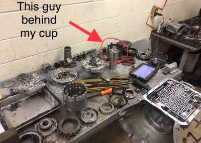

Unless that loud roaring is the sun shell broke and that would also kill your reverse.
Do you still have all forward gears? If that’s a yes I would be willing to condem the sunshell.
