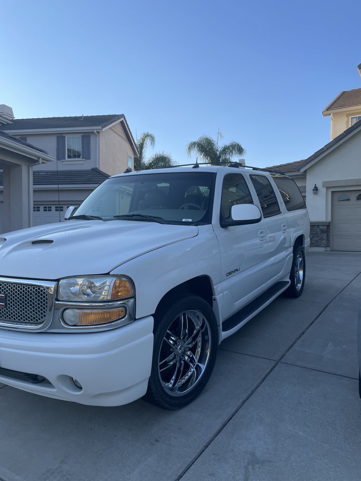

Struggling with this troublesome Denali
savagetek
Aug 24, 2023
My first experience was with a 2004 Suburban Z71 with 160,000. I added 40,000 of my own miles driving the family all over California. The front seat leather was trashed and my young kids continued to beat up the rest of interior. The exterior paint was never all that great and continued to chip away. I did have the bad instrument cluster and followed instructions online to pull it and replace the stepper motors on several guages. Other than that mechanically this was a very solid A to B vehicle a very strong, fast and reliable 5.3L motor. Regular oil changes was about it. 6 months ago the rear drivetrain got very loud. We serviced the transmission, changed UV joints, and ultimately figured out it was the rear end. We decided to sell it to somebody who wanted it and already had a new rear end to put into it.
We wanted another one so 2 months ago I purchased a 2003 Yukon XL Denali 6.0 AWD with 154K miles. Excellent condition in and out. Rust free California vehicle. There was the message in display window “SERVICE RIDE CONTROL”. It was explained to me that there was a problem with the on board compressor years ago and it was removed from the vehicle. This was from the original owners who maintained an excellent service history. The trouble for us then starts almost immediately:
1) small transmission fluid leak coming from crack in the plastic part of the radiator where upper transmission cooler line connects to the radiator. I replaced the radiator.
2) the driver side mirror turned orange/brown. I believe the auto-tinting oil capsule in the housing failed. I replaced with a powered version without auto-tinting.
3) the vehicle stranded my wife in a no-start situation while in the pickup line to get the the kids from school. After troubleshooting, I was hopeful that a new fuel filter would suffice but no luck. I had to drop the tank to replace the fuel pump.
4) Next the display window in dash adds a new message “rear access open”. I have troubleshot based on instructions found online, and am awaiting a programmed replacement bcm which should arrive in a couple days.
5) next, check engine light comes on. Code indicates there is a problem with the mass air flow module. I ordered from eBay and am awaiting delivery in about 5 days.
6) the rear view mirror lights and temperature display are fluctuating between a proper display and flickering/blinking. Please , not another electronic item failing here
7) Today , another new message in the display windows says “SERVICE STABILITY”
This is getting ridiculous. I seriously have good intentions for this vehicle. At purchase time, I already decided I would be doing several of the services I just did with the 2004: tranny fluid, UV joints, rear end. I’ve upgraded the stereo to new bluetooth touchscreen. This is a good looking Denali with another strong motor. Besides, the above I’ve already pictured doing some things with this one that I never did with the other one because the 2004 was too beat up visually to care about the appearance. For this one, a 2-3 inch lift, new rims/tires, new headlight and taillight assemblies with led’s, new suspension (shocks, bushings, arms and armatures, etc).
Unfortunately, there’s a new fairly significant issue every week. I’m beginning to think this one is cursed. I may need to cut my losses before I end up completely upside down here. Does anyone here see light at the end of thus tunnel? Any thoughts, ideas, suggestions that you members of this group regarding what I’m experiencing? Thanks in advance for your time and attention.
