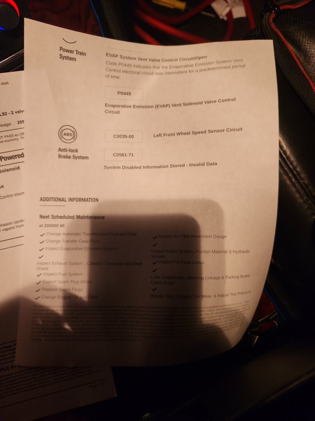

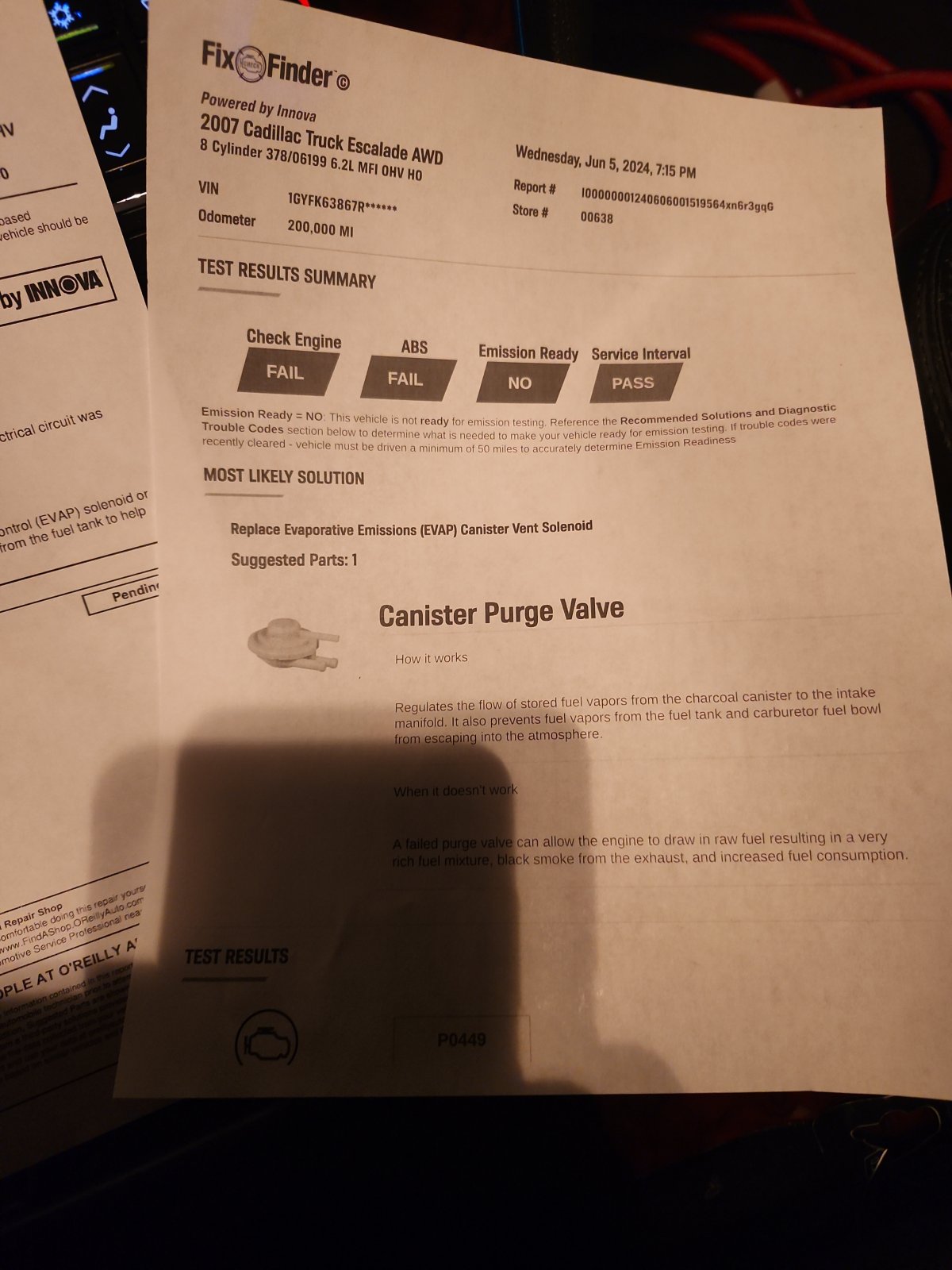

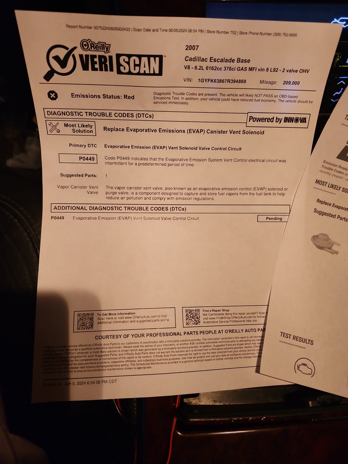

It had to be running for a long time and then it will start shaking a lot then die unless I rev it up in neutral for a little bit. The first time it happened I was just sitting in a Walmart parking lot with the air on. It dies faster the more it's been driven aggressively. It starts up again after a few minutes. Today the trans temp went all the way to 201F and it usually stays at 135-175. One mechanic said that its getting stuck in 3rd gear and causes the engine to stall but idk how that would work because it still happens even in park. Another mechanic thinks its the fuel pump or spark plugs but the fuel pump is new. I still have to see about the spark plugs. ive also been getting about 7.5 mpg and there is 207000 miles on this 2007 caddilac escalade. After I get off the highway or ive been going above 40 mph for a while thats when it starts shaking a whole lot and the rpms start dropping to about 250 rpm and then it usually dies unless I rev it in neutral. Today I went to the highway and went straight to the mechanic and it was like the engine couldnt wait to move like it was moving a lot quicker even without me pressing the pedal. Usually when its trying to go dead you can see smoke or gas coming out the engine next to the oil but this time there was none. I just got the vacuum leak fixed today and its still trying to go dead. It hasnt actually gone dead today even though it was really trying to like it was reving itself up without me pressing the gas pedal. at 35-40 mph you can hear a really deep sound like a viberation or a helicopter kind of sound or 20hz. You can only hear it if you press the gas pedal. On the highway its like the whole cars shaking and one wheel is getting a lot more power than the others. Its not bad at 70mph but when you start speeding up to 106 its really bad. (I usually go 80mph). I have to drive it like an old grandma in a caravan for it to act normal ( until I start going past 40mph). It also feels like its not downshifting right like when you press the gas about half way it usually drops a gear and starts speeding up really fast but now Idk if it does that or not. Ill test that later. When you scan it at autozone or orileys the only thing that comes up on the check engine light is the EVAP and thats it. I used to be able to smell something burning when I floored it when this first started happening in april but now I cant smell nothing at all. It has had 2 crankshaft sensors and a camshaft sensor.
