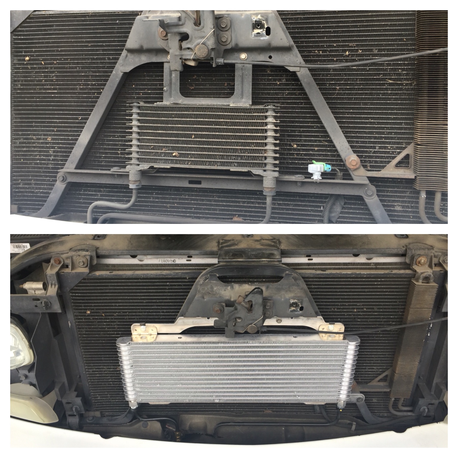

The yukon came with the oem trans cooler, but I added an aftermarket one. I got one with a fan and put an adjustable thermostat on the power feed. The oem cooler was mouned in the center, i added a couple aluminum braces top and bottom for mounting and moved the oem cooler to the passenger side and mounted the aftermarket one on the drivers side. I cut the oem lines and clamped hose to them, but you can use braided line and proper fittings if you want. I plumbed it so the fluid goes thru the radiator first, then the oem cooler, and the aftermarket cooler last. I think it is a Derale, but might be a hayden unit.

Do a google images search for "sierra trans cooler" and you will see how people have mounted them to the hood latch "a-frame" in front of the condenser.
For the lines I cut the return line with a tubing cutter and double clamped trans cooler hose to them to feed/return the new cooler.

The tru cool 40k is a popular upgrade

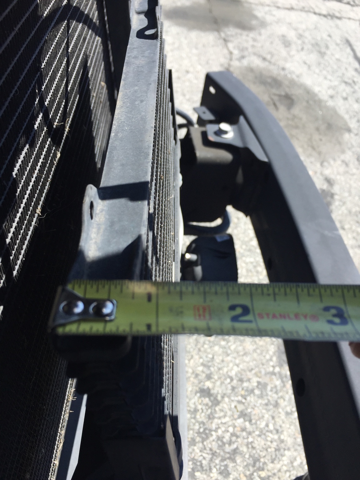

Sorry, forgot about you, it looks like you can purchase the oem trans lines and add the aux trans cooler, either the oem or the aftermarket, you could also cut the hose and run lines but I prefer the oem trans lines, if you need a oem cooler I will send you one from an 07 escalade I upgraded over the weekend

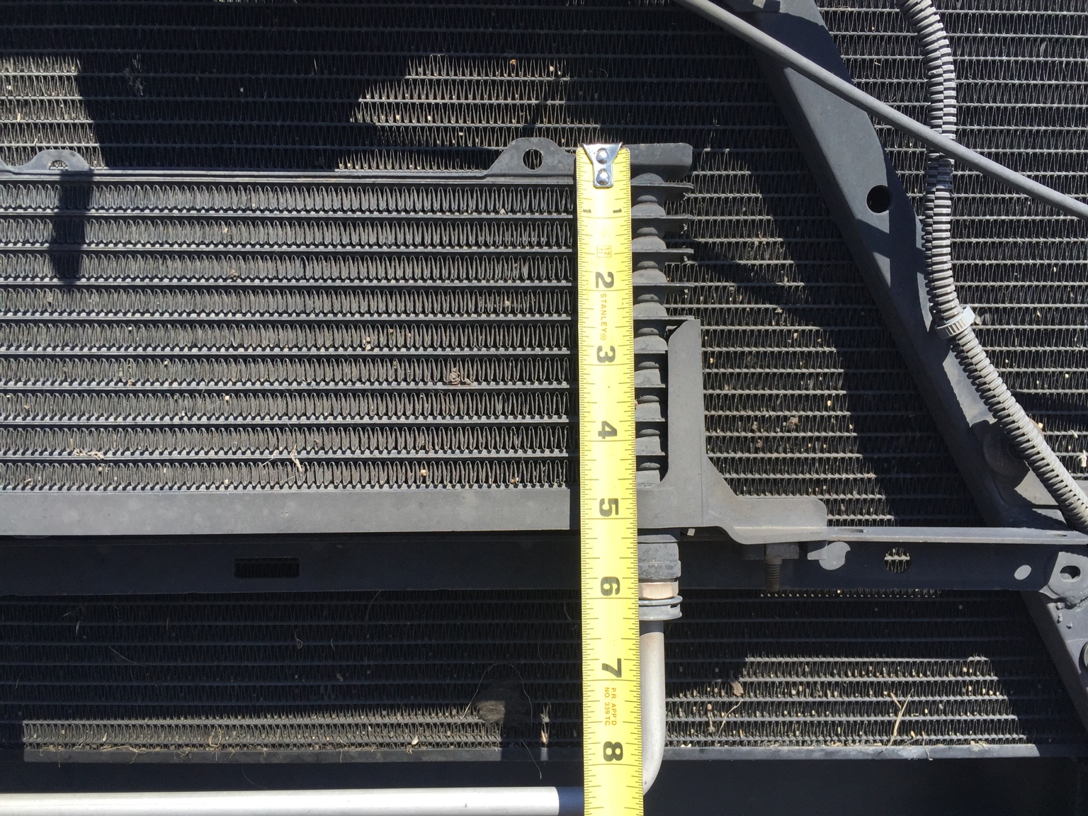

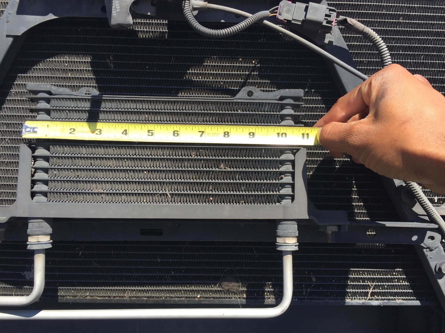

What is the OEM size, I was checking on ebay and could get a tru-cool LPD 18K for $70. It is 7" x 11".....I know most do the 40K which is almost double at 8" x 22"

Id have to measure when i got home, you have a leak?, are you planning on bypassing the radiator cooler, the radiator is needed to warm the trans fluid so you don't experience firm or hard shifting, the oem setup still utilizes the radiator
