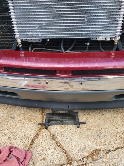

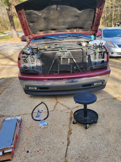

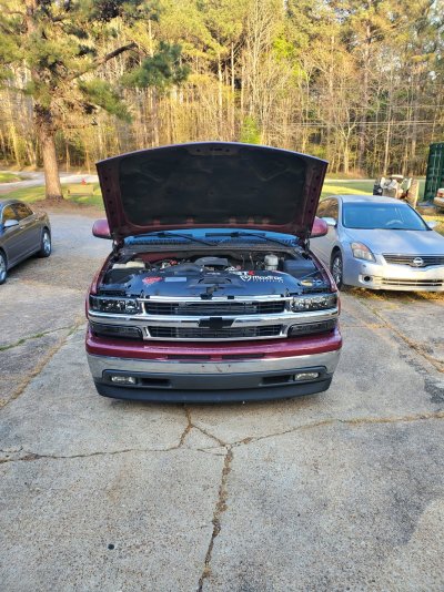

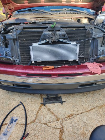

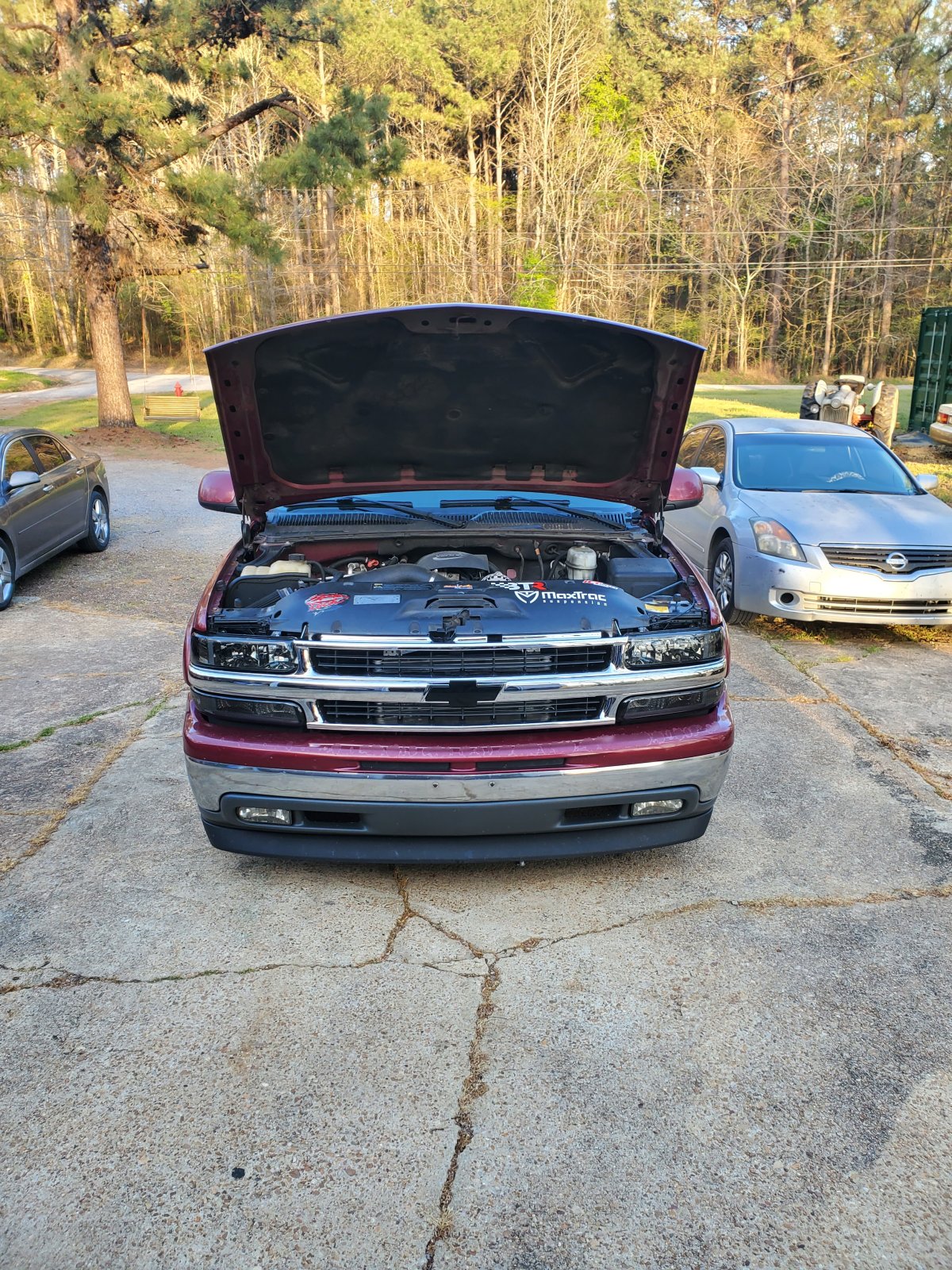

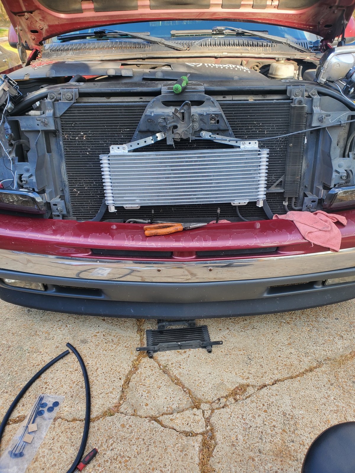

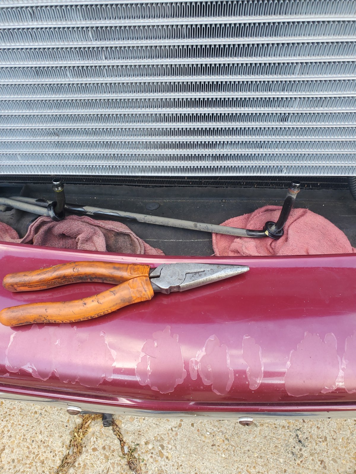

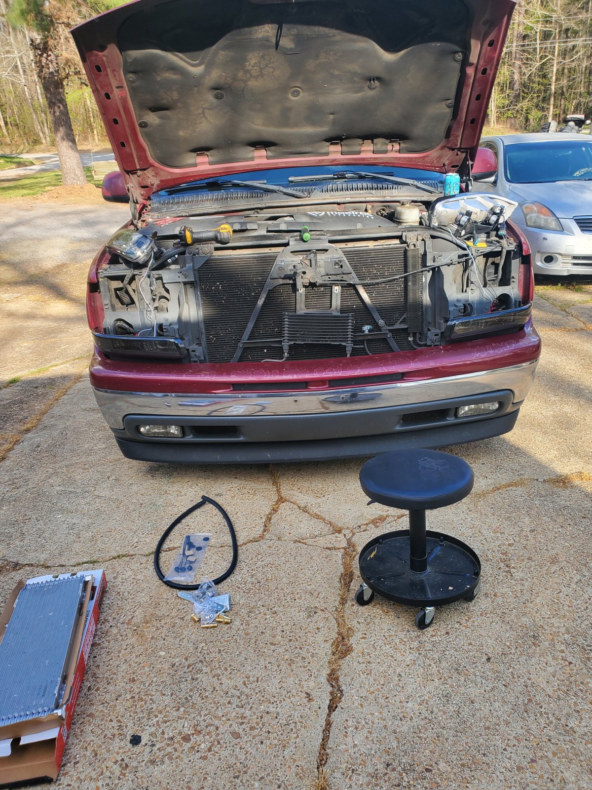

Not to happy with the installation parts provided. Had to tweak the brackets to recieve the cooler. Then had to hide the hoses. Because the kit doesn't come with 90 degree barbs. So at this point I'm not cutting my factory lines so I had to make do. But the end result is the same as for now. I went the cheap route on the trans cooler. Should have bought the full kit and paid up. Wouldn't have had the back to the future car with hoses everywhere thing going on! So new grille to cap off the job. Will be upgrading to the better trans cooler.

it might help to know the tru-cool is not a "fit's gm kit" it's a universal kit that must be modified to ANY vehicle it get's installed in.
so with that being said, my advice is always too use 6an hoses and adapters, that way there is never a leak, those barbed connectors and worm clamps will eventually leak
the factory lines can be connected to a gm female quick connect, then the threaded side is adapted to 6an and the other 6an fitting adapted to the tru cool.

Yes I agree, went cheap and this is the result! Lol. Going to buy the good one .

But in the end for now, it's cooling the tranny down. For a 4L60E that's a plus! Looks cool to I think.

The cooler is perfectly good I have had mine in for years and years, I would just use better connectors for best results. after 2-3 years those hose/clamps are going to seep at the least using good 6an lines they will never leak.

Ordered the 6an trans kit for the hoe and some 6an 90s.

I see another cooler on the ground. Was this a replacement with a larger unit? If so, why? Towing?
That's the stock one on the drive way. I built this truck to be driven. So.... ankle is mostly at a 20 degree angle! Lol. 4L60E is bad about overheating. So this'll help cooler her.

This is a Derale trans cooler. Trying to not put a lot of money in this 4L60E. Til I figure what imma do with it.
