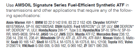

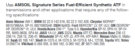

you used this one correct?
OE Fuel-Efficient Synthetic Automatic Transmission Fluid OTL - AMSOIL
mine has a drain plug on it makes it easier but I would still have it taken off and change both filters on it...
I used this one. Little more expensive but I think it’s worth it. I have about 15k miles on the oil and it’s still cherry red
https://www.amsoil.com/p/signature-series-fuel-efficient-synthetic-automatic-transmission-fluid-atl/

Yeah not Dexron 6
spec for
GM DEXRON* II, DEXRON* III, AutoTrak II
Wrong, Brent. @Bob2C listed the Fuel Efficient version:

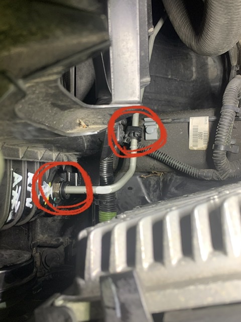

Yesterday I just did just a first flush on a 2016 with 6L80 at 50k miles. I used method where the transmission’s pump does the work using the return line and Hayden 397 fitting/hose. About 14 qts resulted in much cleaner fluid cycling through. I plan to flush again at 75k miles and again with a filter change at around 100k.
Theres lots of videos and threads out there for a DIY flush, but one confusing thing for this year/model (2016 with 6L80 without towing package or aux cooler) was figuring out what line/fitting on the trucks trans cooling system to use… some hook up at the thermostat. For mine, the return line fitting is in a tight spot on the drivers side on the bottom of the radiator. Also the line needs to come off the close-by hanger as it’s pulled out of the female fitting.
Also… With mine warmed up to 180, I didn’t have any fluid pumping out of the pulled off line (because of the thermostat) in addition to the discharge hose. I did have a hose on that line too though, just in case.
