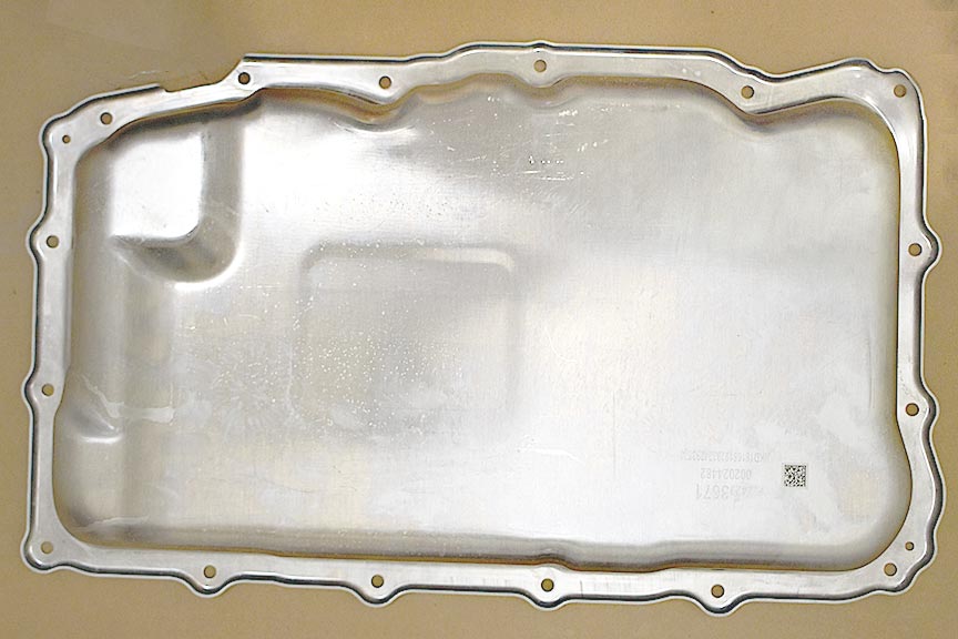

C. There are 2 different trans pan configurations. Some have the "Drain plug" which is not a drain plug at all, it is a bottom fill with a standpipe. If you remove the bottom fill plug while the engine is not running, if you are lucky you may get about 1 qt of trans fluid to drain out! Some of the trans pans do not have the bottom fill feature at all. Unclear which models have the bottom fill pan and which don't. It seems like many of the 3/4 ton/2500 series trucks have the bottom fill plug, earlier builds may have also included the bottom fill type pan. My 2024 does not have the bottom fill feature.
Pan with bottom fill plug
Pan without bottom fill plug
