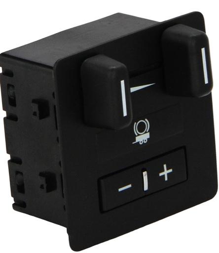

The 2012> integrated trailer brake controls in the left kick panel of the NNBS can not be added unless it’s installed on the factory line.
However, there’s always an exception to the rule. If you have the ability graft 08 Escalade into an 09 Silverado 2500 Duramax, you can add the ITBC

The Integrated Trailer Brake Controller (JL1) was introduced in 2009 and cannot be added without literally taking the truck apart. The wiring for an aftermarket controller is under the dash.

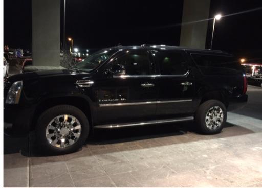

SoCal
We had the Tekonsha P3 in our 08 Denali YXL when we purchased it pre loved in ‘14. Had zero issues with it when used just once.
For some reason GM didn’t want to install the ITBC on the NNBS Escalade. Not sure if they changed their mind after 2014.
