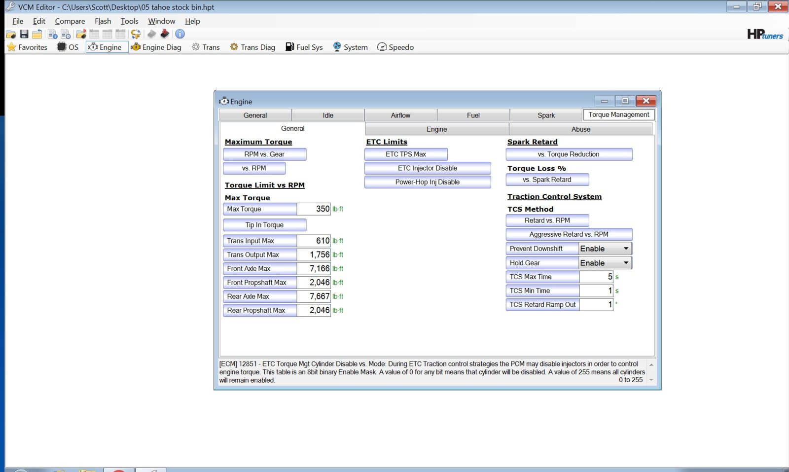

read inside the box at the bottom of the window, mouse is on etc injector disable. its part of tc. im still learning all this thing can do. there might be another file in spark.
That is only a small part of the traction control system unfortunately. The brakes being applied is the most intrusive part of the system and the only way to completely disable stabilitrak is to pull the fuse.
