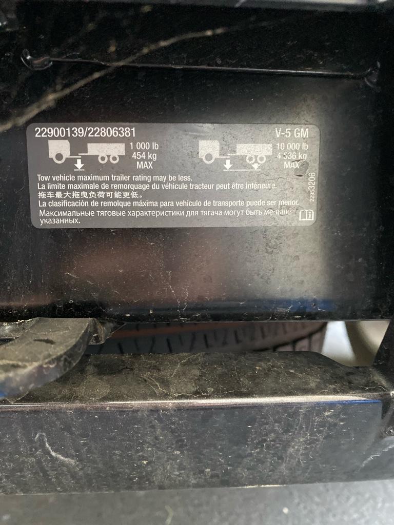

So am I reading this correctly? 1k tongue weight, 10k max trailer weight
Bob2C
Bob2C
Jun 11, 2019
532
435
Northern VA
That's the hitch rating. NOT the vehicle rating.
Trailer Life puts out a guide that's often referred to as the Bible for towing. What year do you have?
Sent from my Pixel 3 XL using Tapatalk
