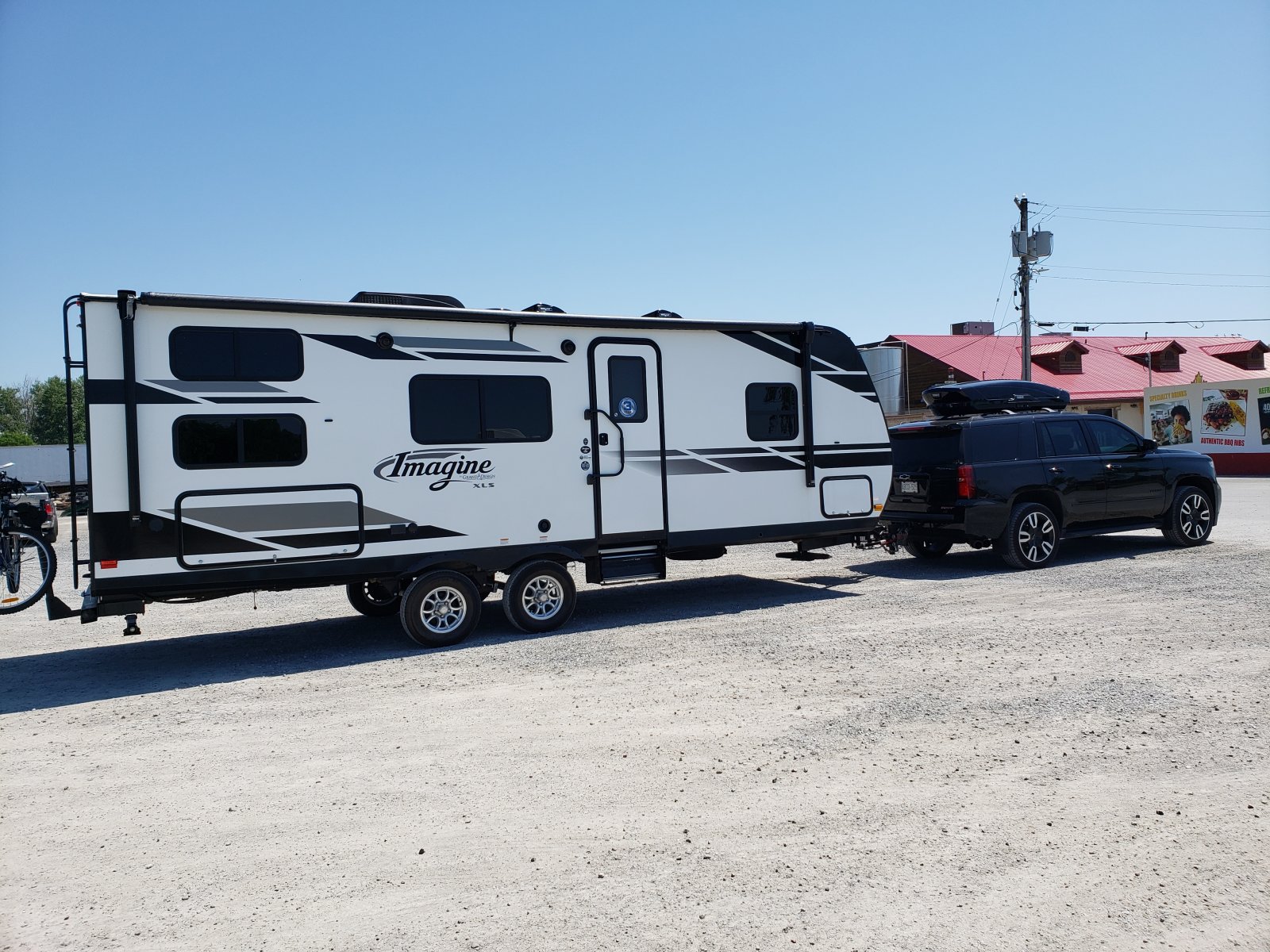

I pulled my 2020 Grand Design Imagine 23BHE for the first time over the weekend with my 2020 RST...
It's hard to tell, but it looks as though the rear end of your Tahoe might be down a little. And the front might be up a little, which might mean a little less weight on the steering wheels and tires.
Did you weigh the trailer as loaded and get the tongue weight and axle weight and ensure that the tongue weight was 10-15% of the axle weight? Except for my first trip with a U-Haul trailer, I have had no trouble with sway with heavy trailers including a 24 foot Argosy, 31 foot Airstream, and a 34 foot Holiday Rambler. I always made sure the tongue weight was 10-15% of the total trailer weight.
For the last one, the 34 foot Holiday Rambler, I took it from where I bought it to some scales a couple of miles away to check weights on the way home. I understand manufacturers are more honest with weights than they used to be, but there can be a big difference between advertised empty weight without options and weight as delivered.
Also, my 2016 Tahoe owners manual says to adjust the weight distribution spring bars so that the height of the front wheel lip above the pavement is "...the same after coupling the trailer to the tow vehicle and adjusting the hitch." It doesn't say anything about having the engine running and the automatic leveling compressor active while adjusting the spring bars. My understanding was to adjust the spring bars and then start the engine. Do you see something in your manual which suggests otherwise?

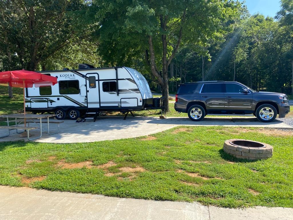

Great info here. The trip will be going from Virginia to Cooperstown NY up 81. I have gone through PA before In my vehicle and it’s not a bad drive. I think the highest elevation is 1500ft around mountain top in northeast PA. Just 2 adults and 2 kids. I did however after reading some advice decide not to get the trailer mentioned initially. I am now considering this one which I believe should be fine. I won’t be pulling huge inclines and we are stopping along the way and any one part of the drive is around 3 hours
I think that you will be a lot happier with this trailer. After you get it loaded, it shouldn't be over 6,000 pounds. The route you are taking should not be a challenge engine performance wise and you can get an idea of how your Tahoe handles a load.
The trailer floor plan looks like my brother's Starcraft 26 footer. I think I'm going to add the Kodiak to my Craigslist and RVTrader search.

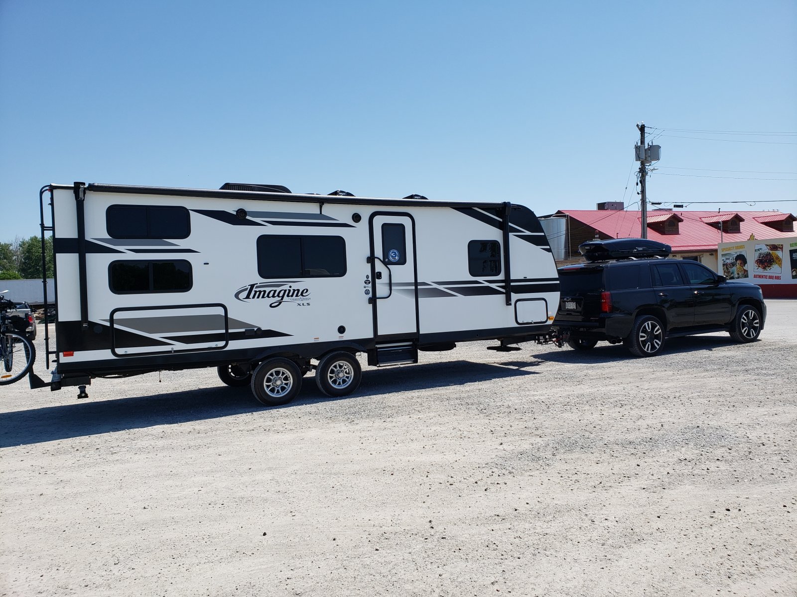

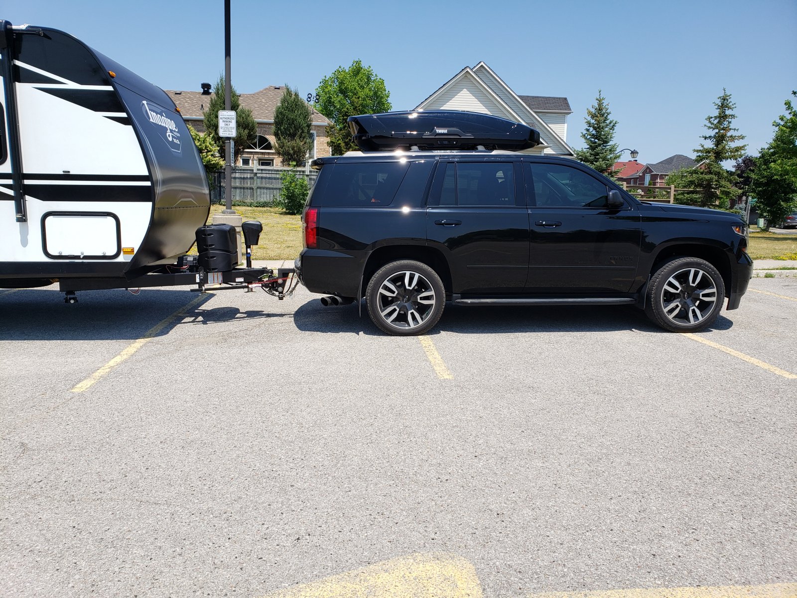

I measured the ride height on the front and the rear after the distribution bars were put on. Front was 38.0" and rear was 37.5" as what was recommended by Fastway. That was after with the magnetic air leveled out. Before that it measured at 38.5" on the front and 37" on the rear. However the bars still had some minimal play with some force by hand so the weight did not distribute evenly and was not putting brute force on the L brackets. Re-adjusted it to another notch higher and that's when it even out with the magnetic leveled. The bars was had more weight on the L brackets it was impossible to move even with the tool. I'm planning to take the trailer to a Cat scale here in greater Toronto area which is an hour away before we head out on next weekend trip to weigh it with all the gear in it minus water. I never pulled with water on any of my previous RV's as that can contribute to sway as well.

I measured the ride height on the front and the rear after the distribution bars were put on. Front was 38.0" and rear was 37.5" as what was recommended by Fastway...
Sounds and looks like you're good, then.
It used to be, before active air leveling systems, the protocol was to adjust the bars so that the front and rear of the vehicle both went down the same, with the goal being to split the tongue weight evenly between the front and rear. The biggest thing is to not load down the rear and lighten the load on the wheels at the front doing the steering of the vehicle.

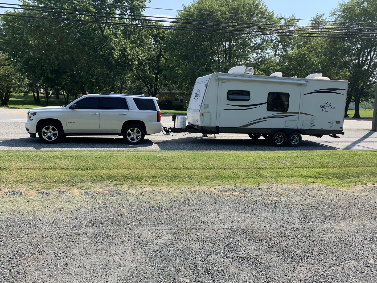

I’m running a 2018 suburban with max tow. I have a 2015 jayco white hawk, 24ft it’s 6800lbs loaded with all our crap and with the WD hitch it goes great!!
I will say I would not go any bigger than this, I tow a lot between this and my dump trailer and this is comfortable for me. I towed a friends slightly larger trailer and although still wishing my tow rating was scratchy as hell.
