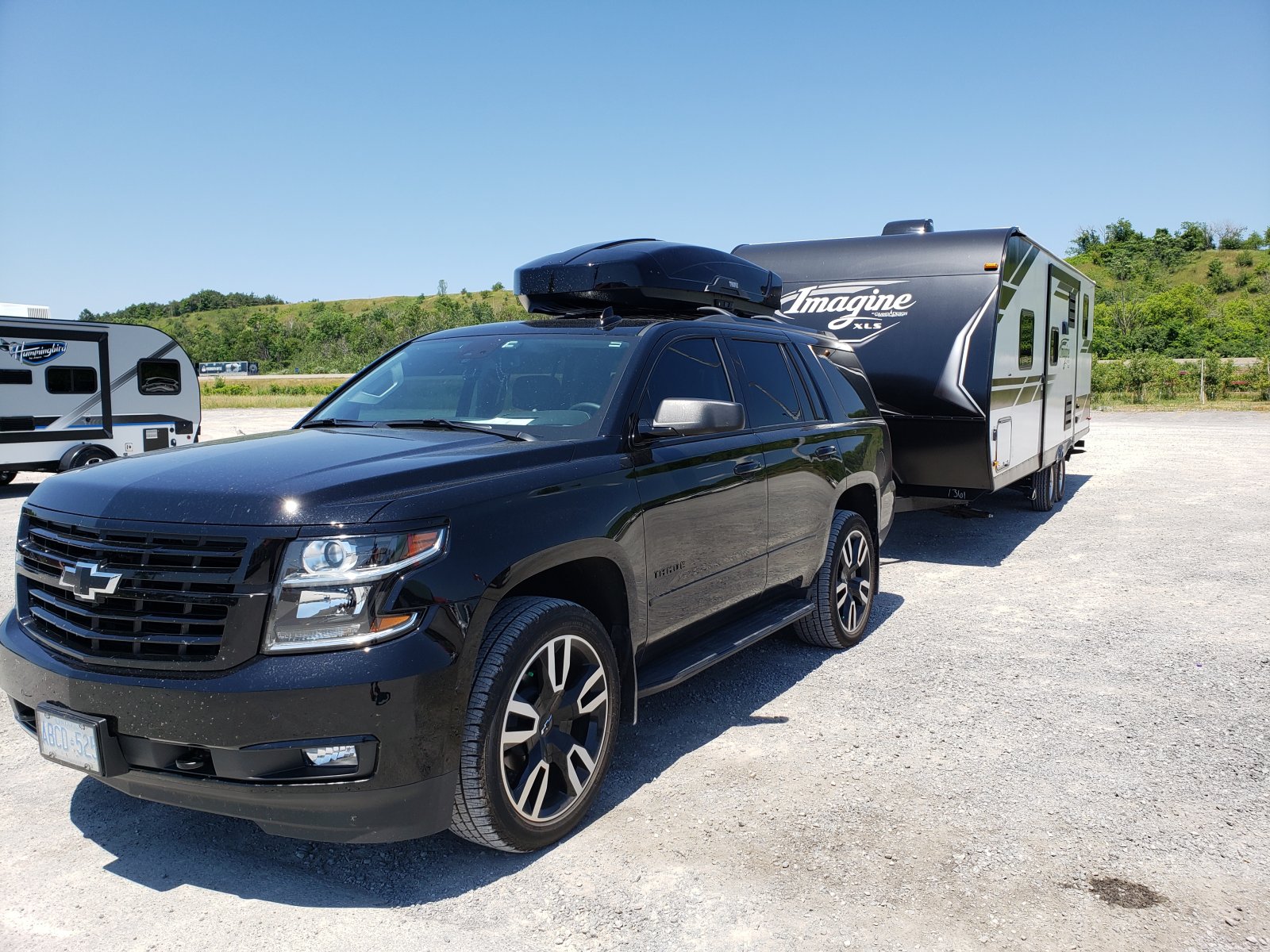

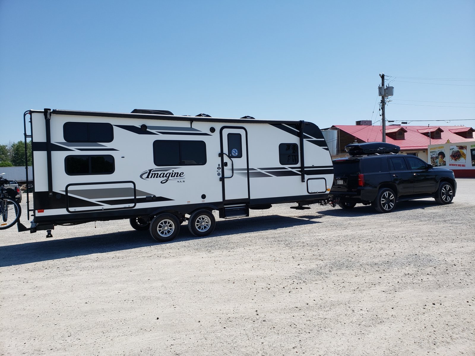

I pulled my 2020 Grand Design Imagine 23BHE for the first time over the weekend with my 2020 RST. The weight of my trailer is about 5500lbs dry add about another 850lbs with gear and food. The Imagine is over 27 foot long which I believe is the max for a SWB (Tahoe of Yukon). Towed ok. I still experience a bit of sway but still manageable. I'm using the Equil-lizer Fastway E2 weight distribution system with 800lb friction bars which did help a lot. You just need to be sure they are adjusted correctly especially if your Tahoe is equipped with the Magnetic Ride suspension with the auto-leveling. Mine was not installed at the correct height when I first picked up my trailer from the dealer. The engine needs to be running during the fitment and adjustment in order for the compressor to fill up the suspension in order to get the correct level with all the tongue weight on the ball. This way it can compensate for the excessive sag and the weight for the bars to be correctly adjusted accordingly. If you are just a weekender and not going any long hauls full-time I think you should be fine. I tried looking in YouTube if anybody uses a Tahoe or Yukon to pull their RV's and they are not too many of them doing this. It's "do able" but rare.
PG01
Nov 6, 2016
15,919
21,828
Up here to the right
Just curious..... what can possibly be in that roof top box that didn’t fit inside the trailer?
I carried a few extra camping folding chairs in the Thule roof carrier and an outdoor metal clothes dryer. It was just a test to see if the roof carrier was necessary plus my wife didn't want them in the new trailer as they would roll around.

I didn't start pulling the trailer right away, drove this Tahoe for about 5000km on it more than what GM had recommended. My 2018 Tahoe LS had the 5.3 and the revs where much higher on hills and didn't have the magnetic ride suspension and there was a little more visible sag on the rear too.
I was just busting your chops.. ;)
