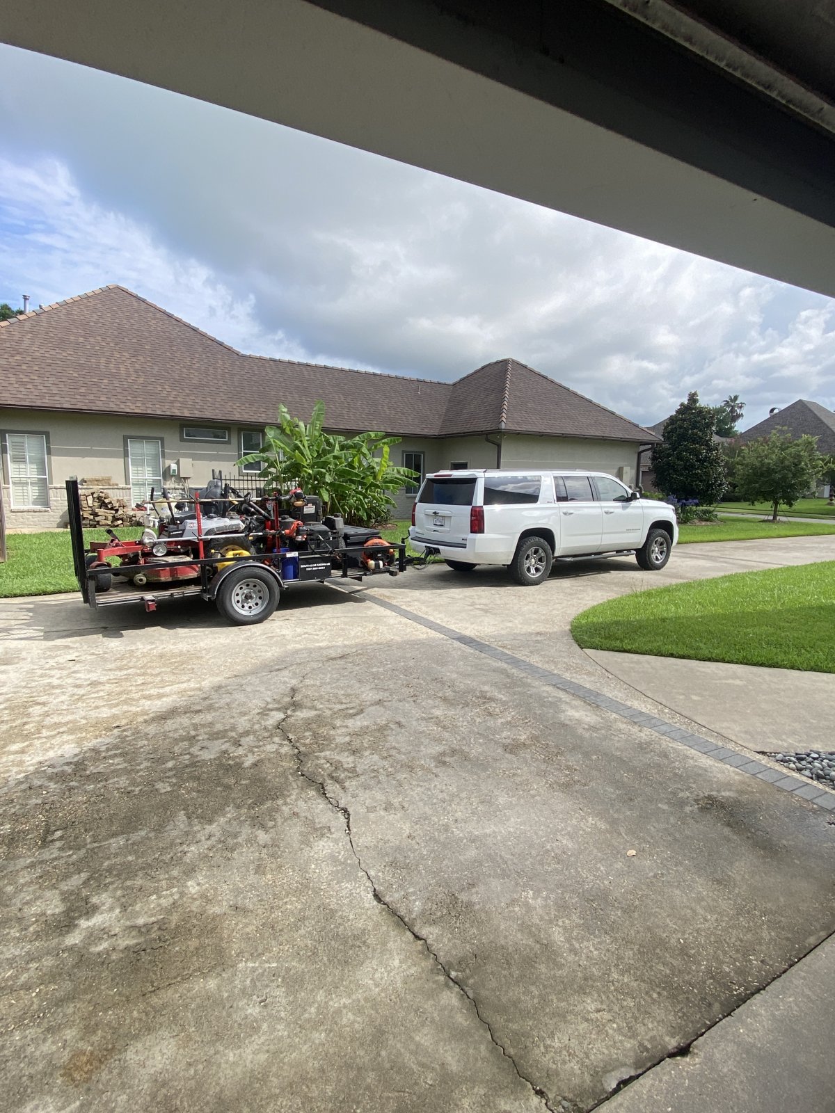

View attachment 460036I own a Lawn Care company and I tow a lot. However, it’s relatively light duty overall. Trailer is about 3500lbs and on weekends I tow a boat that weighs the same. I just bought this 2019 Suburban Z71 5.3. I don’t like the way it shifts in Tow Haul mode. Last few days I just put it Drive on L5 for around town. 55mph max. Tows better that way when driven properly. I’m pretty easy on it when towing. Pretty much speed limit all the time. Wondering if 3500lbs is too much for regular Drive on the tranny? Any opinions?
I hope to do a Blackbear style engine/trans tune in the near future.
You'll be fine. I frequently tow a larger load in Normal Drive mode with a similar vehicle. The tow mode just changes the shift profile . The transmission in your vehicle is not changing it's strength or load capabilities..
