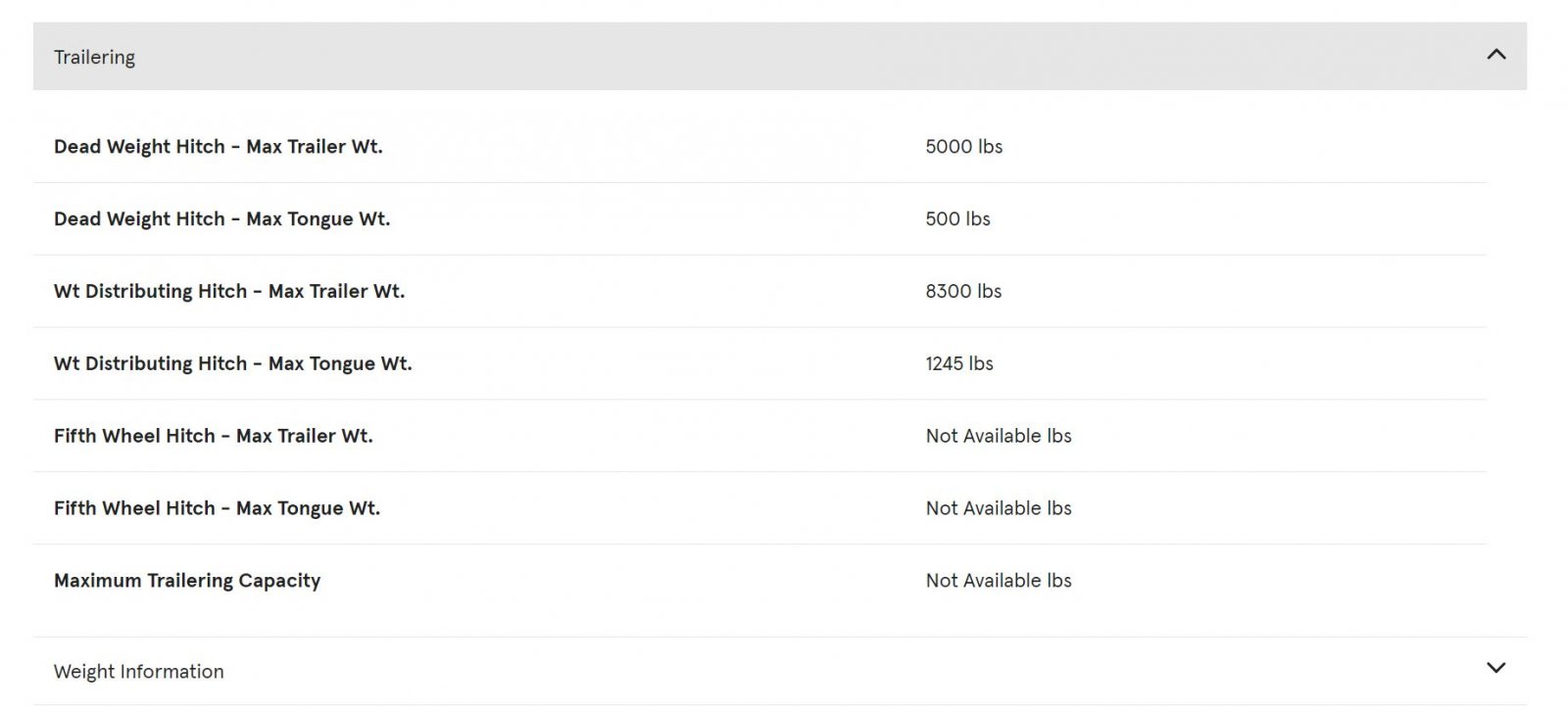

I noticed the much lower hitch rating than actual tow rating of my Denali.
Supposedly, my Denali is rated at 8,100 lbs towing capacity but the factory hitch says 5,000 lbs like yours does.
GM must use the same hitch across all of their SUV lines.
Guess if I want to actually safely tow anywhere near the rated tow capacity I need to upgrade the hitch.
Grady_Wilson
Sep 26, 2023
4,166
20,570
Wyoming
I just ordered another hitch from Tractor Supply.
They are having a blow out on towing and trailering equipment so go check it out.
Picked up a Reese 7,000 lb hitch for $65 plus tax.
Not big enough to cover the actual tow capacity of my Yukon but still gives me an extra ton of capacity over the stock hitch.
It will work for now.
https://www.tractorsupply.com/tsc/catalog/hitches-ball-mounts
Poking around online I found these specs for towing capacity.
Explains why there is a 5,000 lb hitch on all of the Yukon / Tahoe SUVs.
