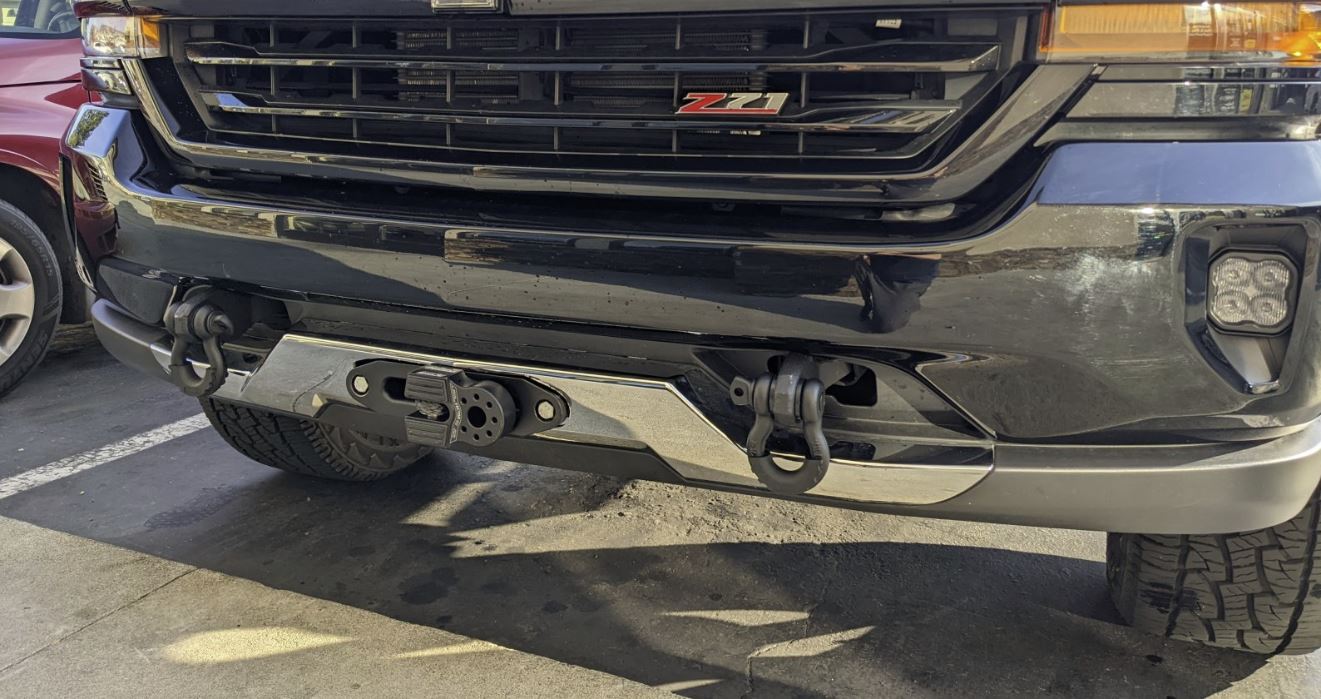

30,535
47,970
another member added these rough country shackles to his suv with a extension bracket he made
I put them on my silverado (what they are made for), they bolt up but on the suv's I believe you need to make a extension otherwise they are too short
30,535
47,970
Interesting. Seeing as the Tahoe and Silverado tow hooks are exactly the same part numbers, I wonder why an extension bracket is necessary when using the Rough Country D-ring brackets on a Tahoe?
I believe the bumper cover sticks out out more than on the trucks, more nose on them
the bumper on my silverado is metal for instance and on the suv's it is plastic
