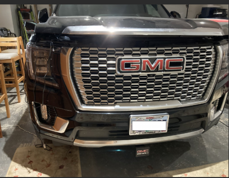

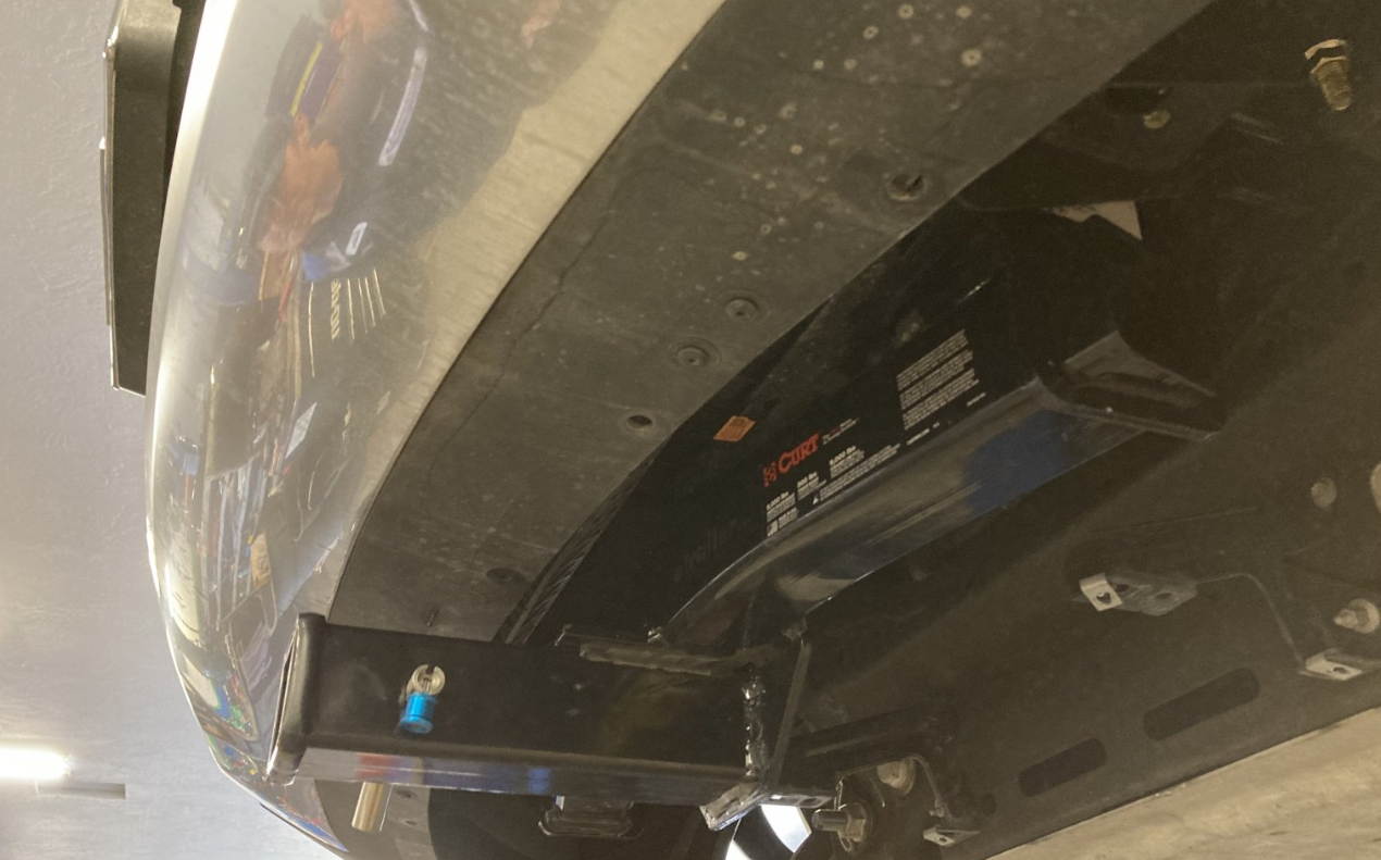

As an alternative, I was able to get a front hitch installed on my 2021 Yukon Denali 6.2L. With a tow point, this can be used to up to 5000 LBS GTW for the model of hitch receiver I installed.
Here's my thread on this - https://www.tahoeyukonforum.com/threads/front-mount-hitch-2-receiver-for-2021-yukon-denali.143264/ - that includes the hitch I bought. It was Item #C31088 - https://www.etrailer.com/new_review.aspx?oid=120641424&ouid=586EB8D1-E31D-4B1C-8A2C-8D89757BA9CA
The receiver comes out under the front bumper so there's no issue with any of the front cameras or electronics or modifying the bumper or grill. The mud guard was easy to cut a bit to fit around it.
I use the it to push my camp trailer into a narrow spot along side the house and it works OK.
The caveat is that the bottom of the receiver is 8" off the ground (same as undercarriage / vehicle clearance) which is OK for regular driving but...
- sticks out front low for off-roading over a deep gully
- is close to the bumper and you might need a hitch extender for use with a large riser.
- my 650lb trailer tongue weight pulls the front end down to maybe 6" which is low for obstacles (street curb for example) and I need a hitch with at least a 6" rise to keep trailer tongue jack sufficiently up off the ground.
