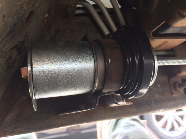

Now you're ready to press in the new bushings. For the passenger side I used a piece from my HF ball joint kit to drive the bushing in.
Now the drivers side was a while different story... The frame does not allow any room to drive in that bushing. Using a threaded rod, some washers, a couple pieces of pipe, and some components from my HF ball joint kit... I was able to press that bushing in.
View attachment 180049 View attachment 180051
I will get the part number for the bushing and post it here. I think they cost me $40 each.
Let me know if you have any questions and I'll try to help the best I can.
Hi there. When it started going in sideways did you just kept pushing along until it just straighten up by itself?
