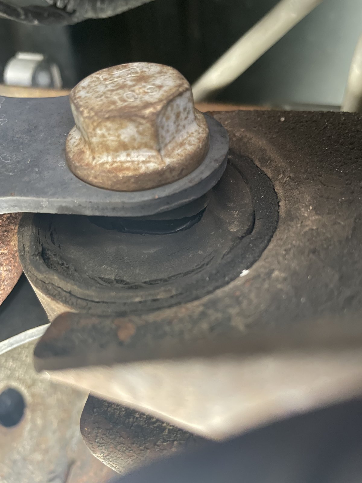

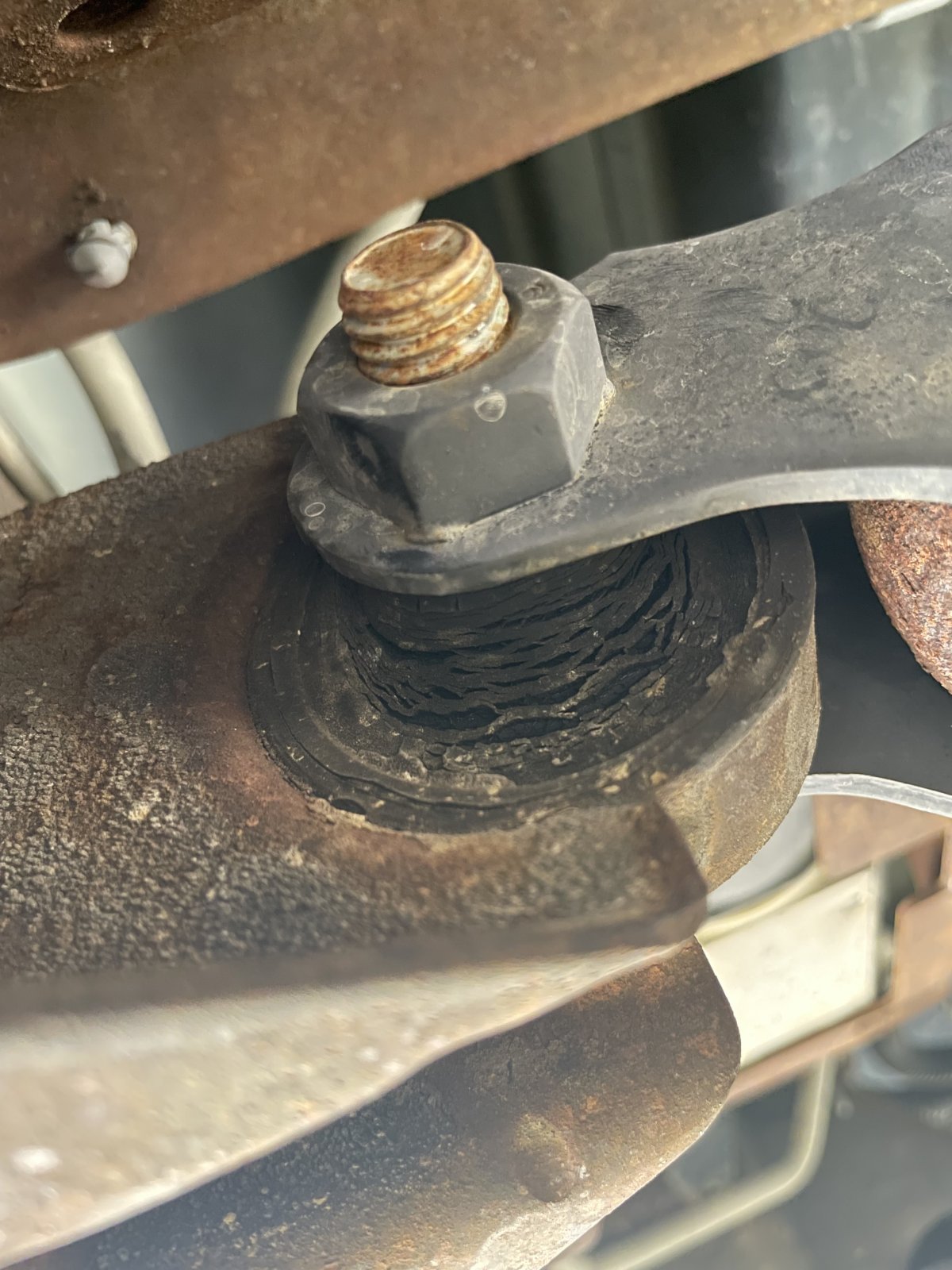

I’ve been chasing a popping sound coming from the driver’s side while turning in/out of parking spaces and while accelerating from a stop with the wheel turned. Replaced a bunch of suspension parts as part of a pre-planned overhaul project and was half hoping the issue would have been resolved with all of that maintenance. WRONG.
After dealing with the sound for another couple months I came across an old thread about the torsion bar crossmember bushings and went to check on mine. The passenger side looked okay for the age, but it’s safe to say that the driver’s side is shot. I’m willing to bet that this bushing is my source and that the noise is just being translated up to the front control arm through the torsion bar.
Once I get these replaced I’ll report back with an update but figured I would remind the forum that these bushings exist and to check them and potentially save some headache and frustration.

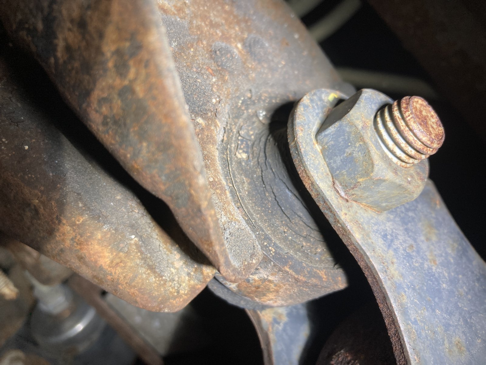

I recently did a complete suspension and steering renewal and didn't even notice these bushings. All noises and looseness are gone. I happened to be adjusting my torsion bars and found your post while looking for guidance. Just went out and checked my bushings. Like yours, the driver's side was worse than passenger side, but not as bad as yours. Pic below. 160K miles. I'll put them on my "do list". Thanks for the heads-up. Have you done yours yet?
