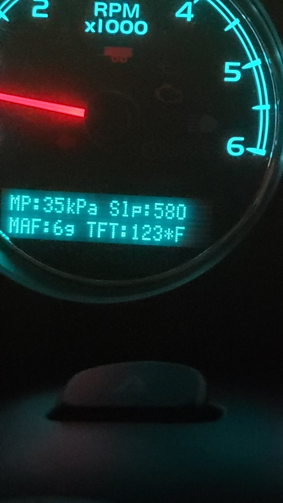

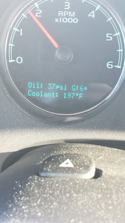

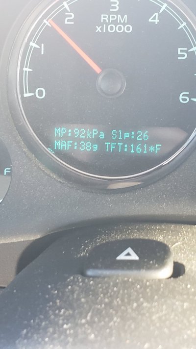

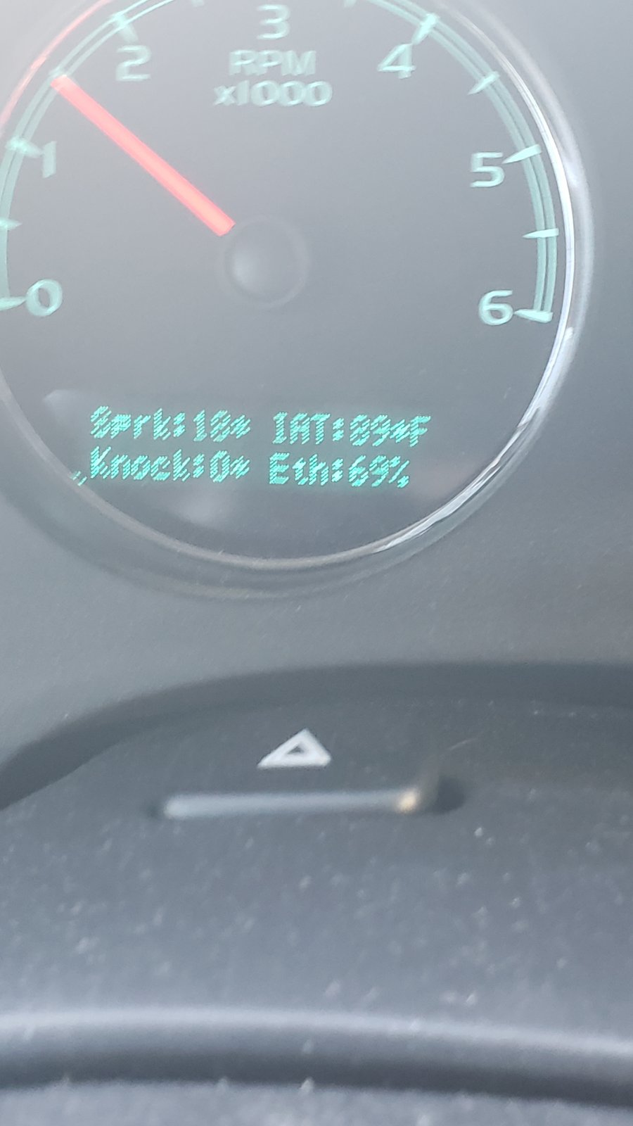

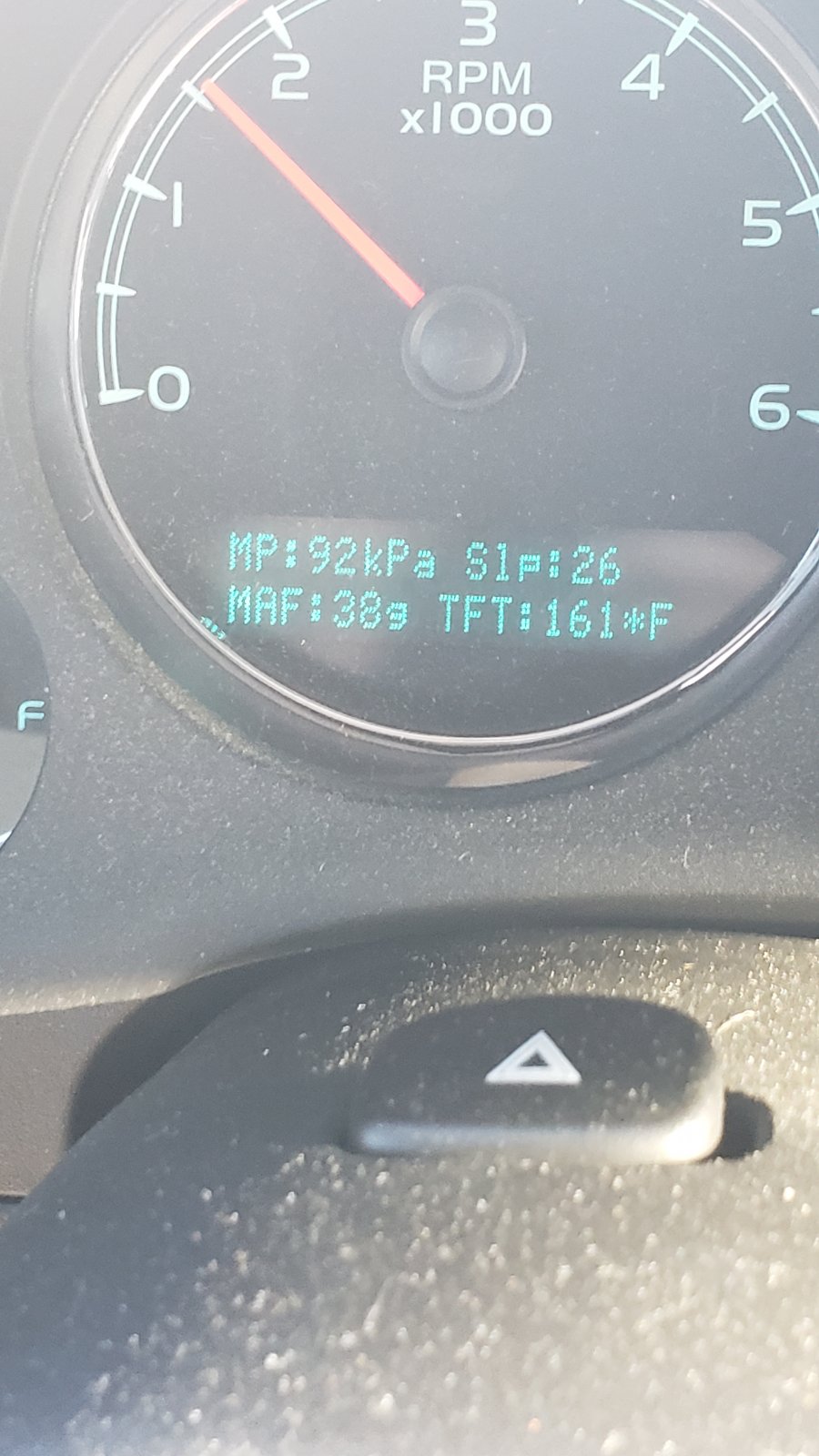

Here's the DIC displays that I get with the AutoSync. These were pics from back in June that I also posted in another thread back then talking about engine Temps and when the fans kick on.
The AutoSync uses the mirror adjust D pad to switch between these screens. Up returns you to the default screen you have showing and down shows the backup camera on the Nav screen for like 5 seconds.
The right button shows this info....
Left button brings up this....
Pressing the left button again switches to this.....
So yes, the TCC Slip info is in there somewhere, we just have to figure out the PID info for it for Torque to read it.

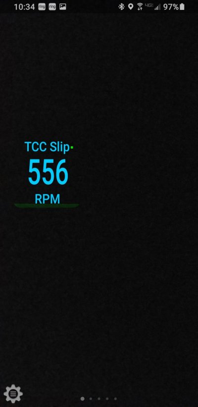

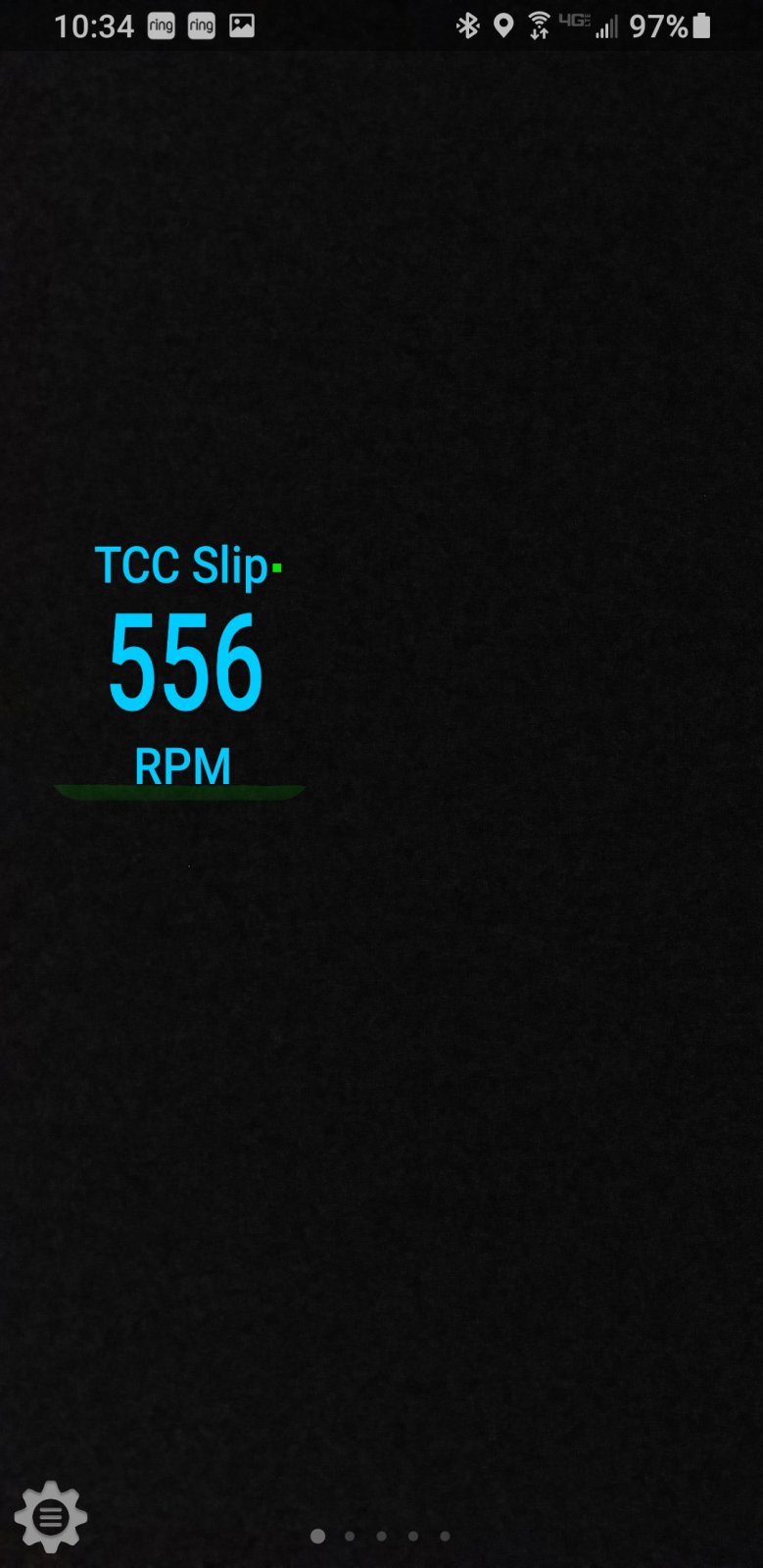

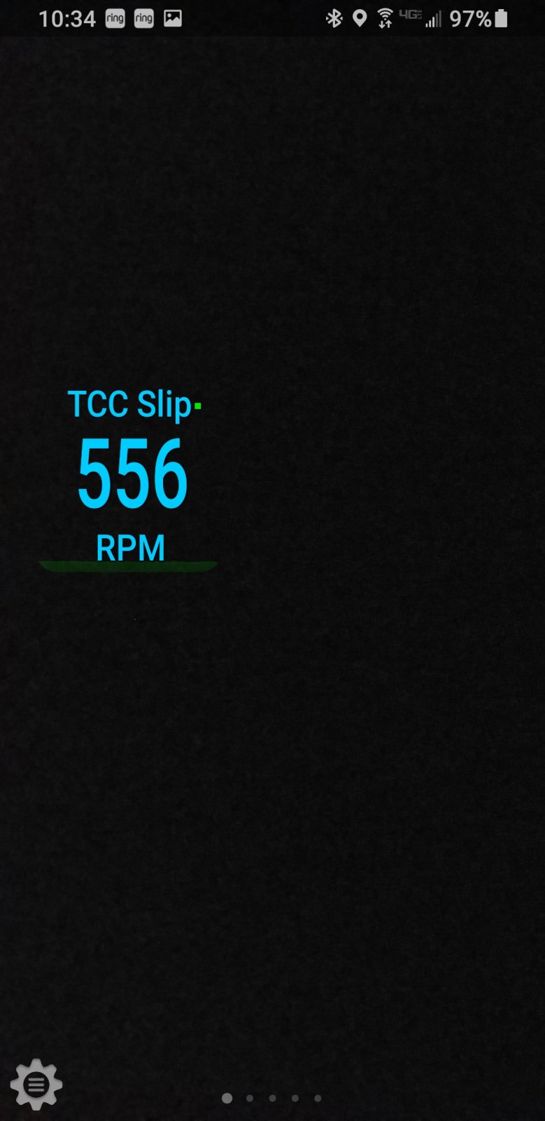

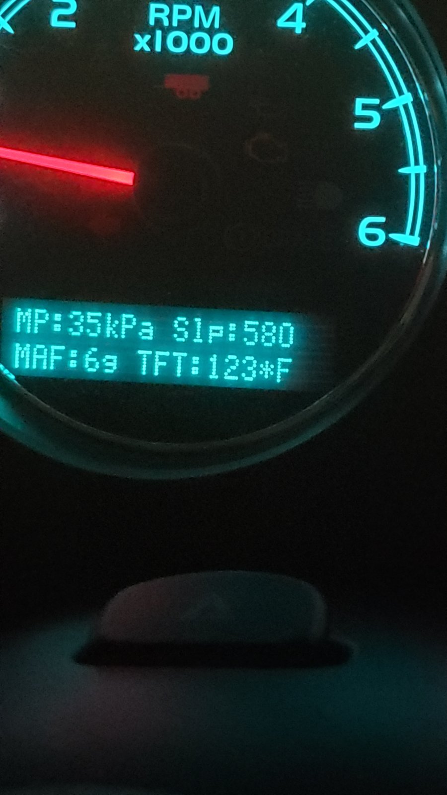

Got it working on my Torque Pro app!!
I was out adjusting my headlights and when I got done and went to pull it up the driveway I decided to open Torque and low and behold it was jiving with what my DIC said
In drive with foot on break. They both fluctuate and snapping a pic that corresponds to the screenshot is hard
21,276
30,208

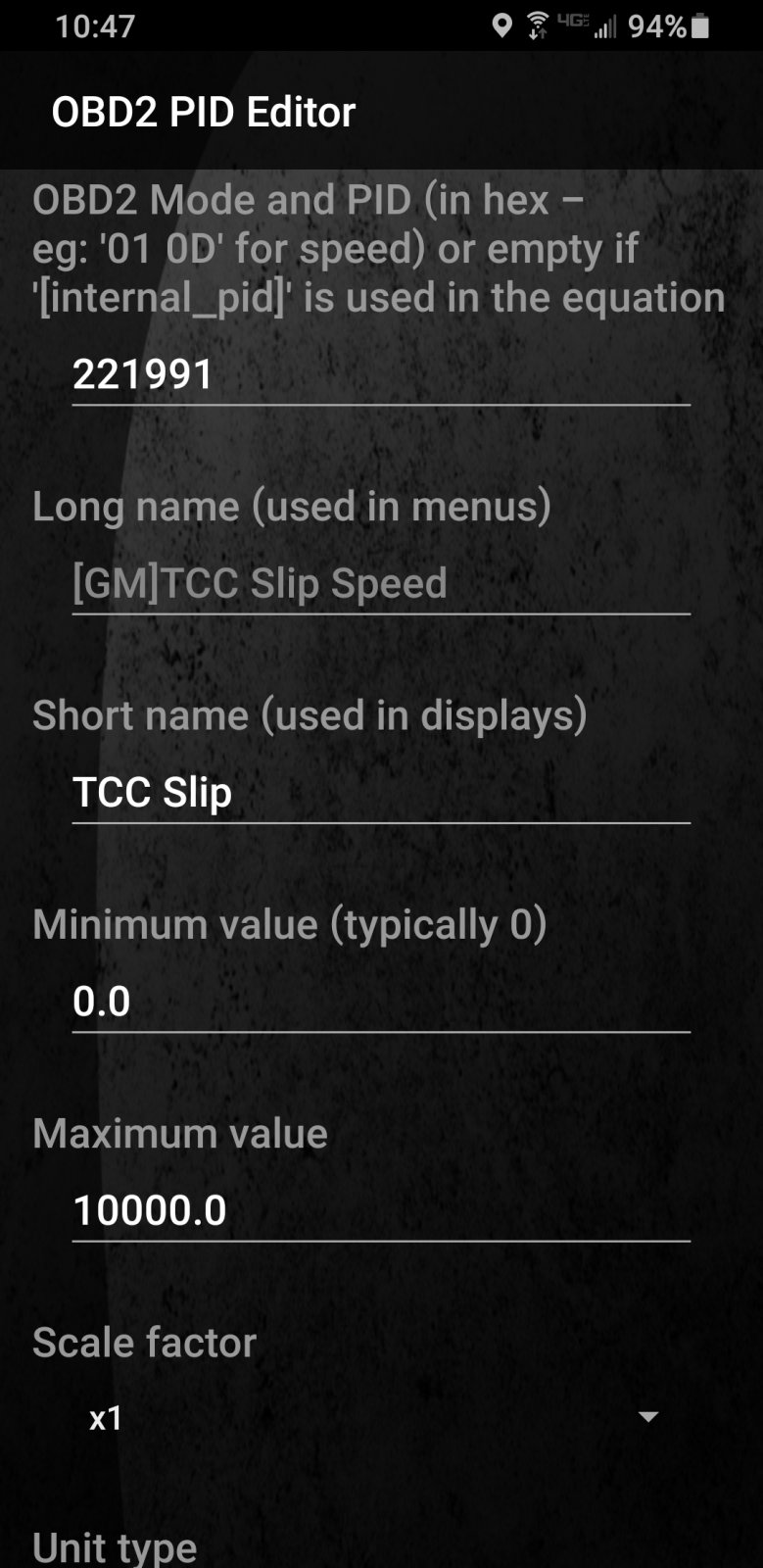

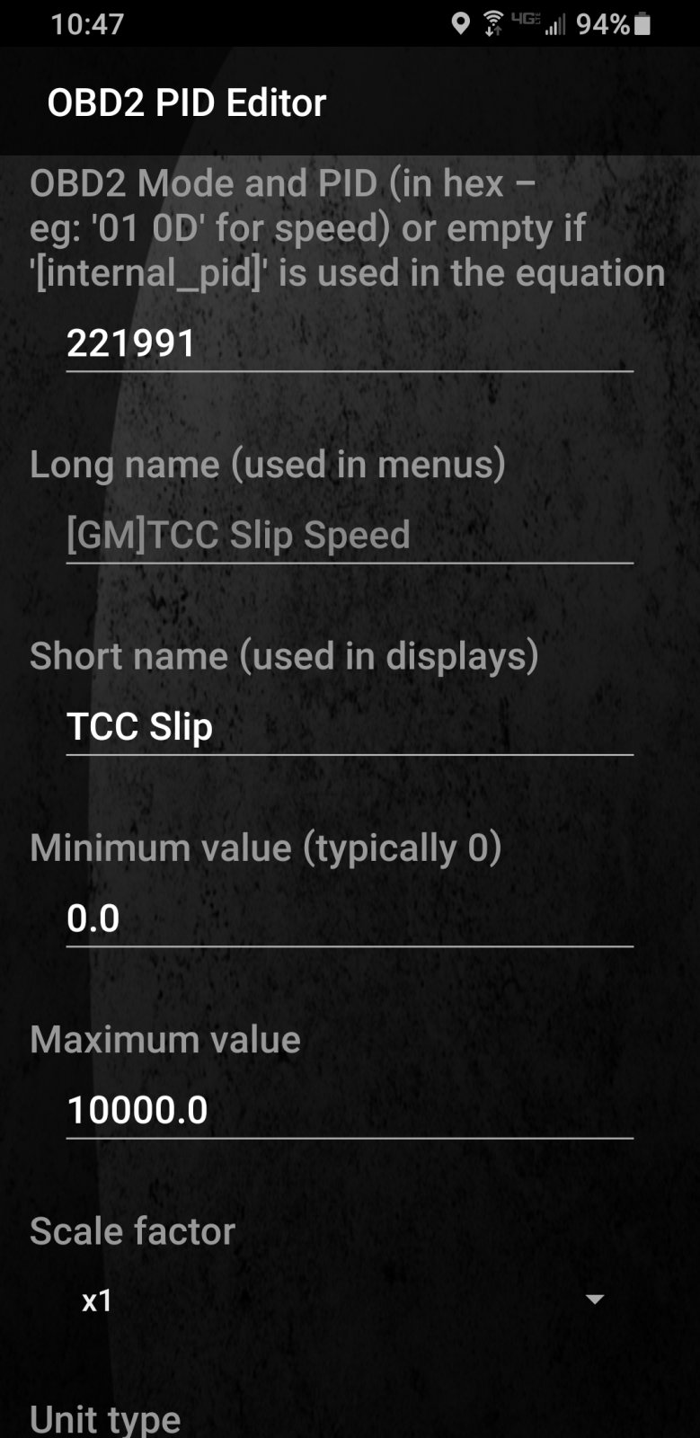

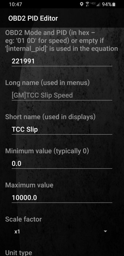

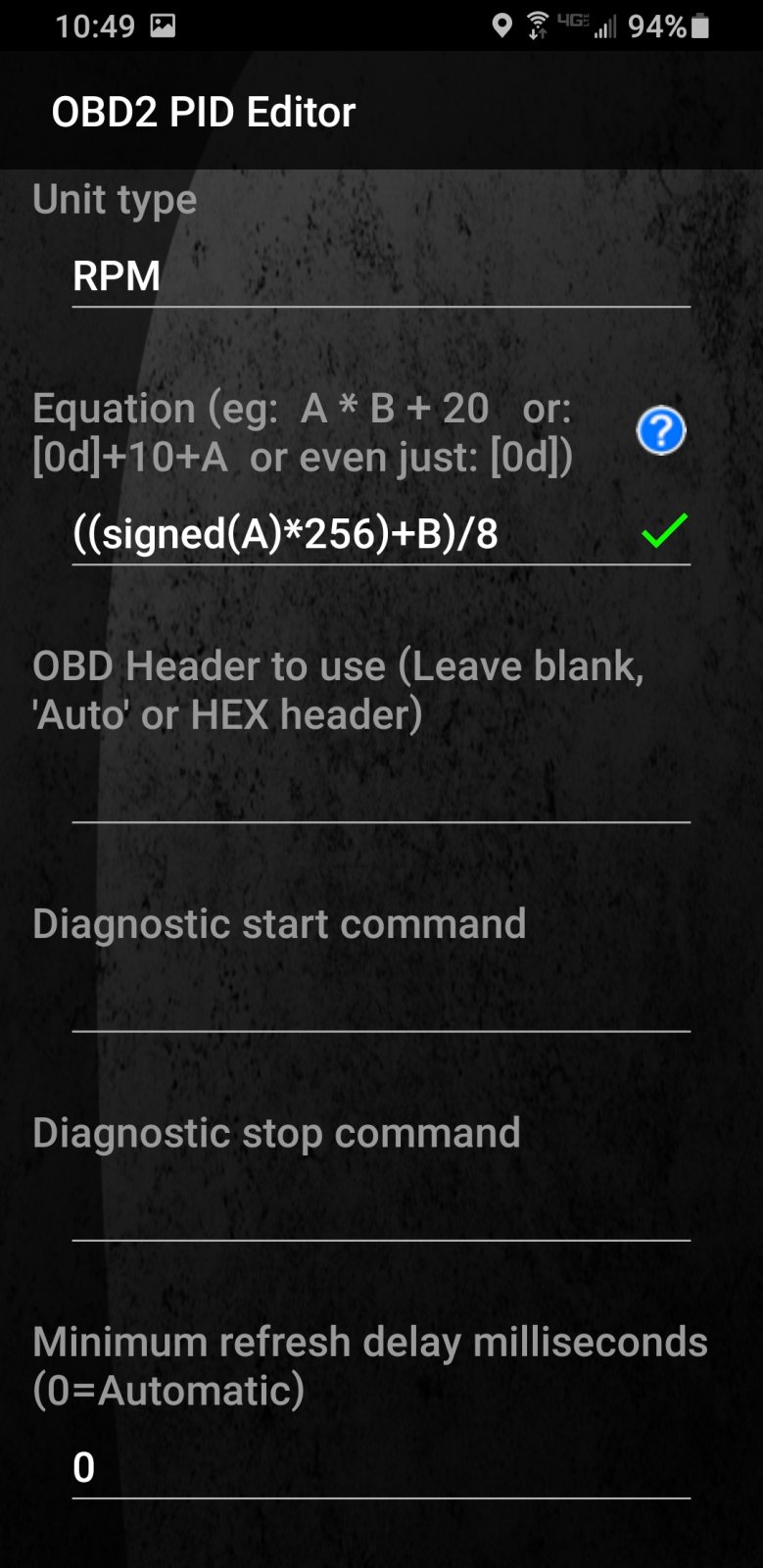

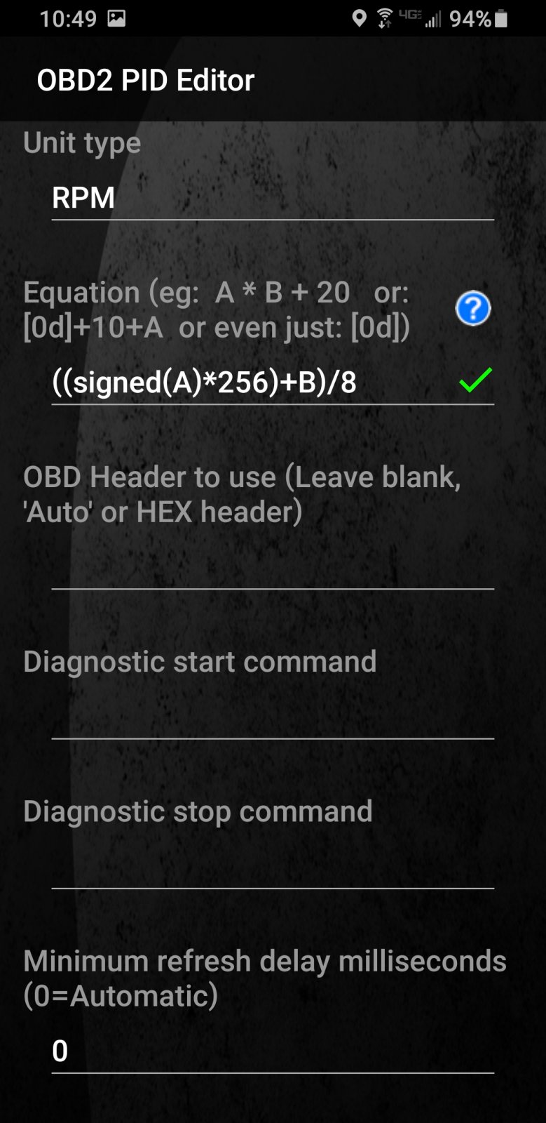

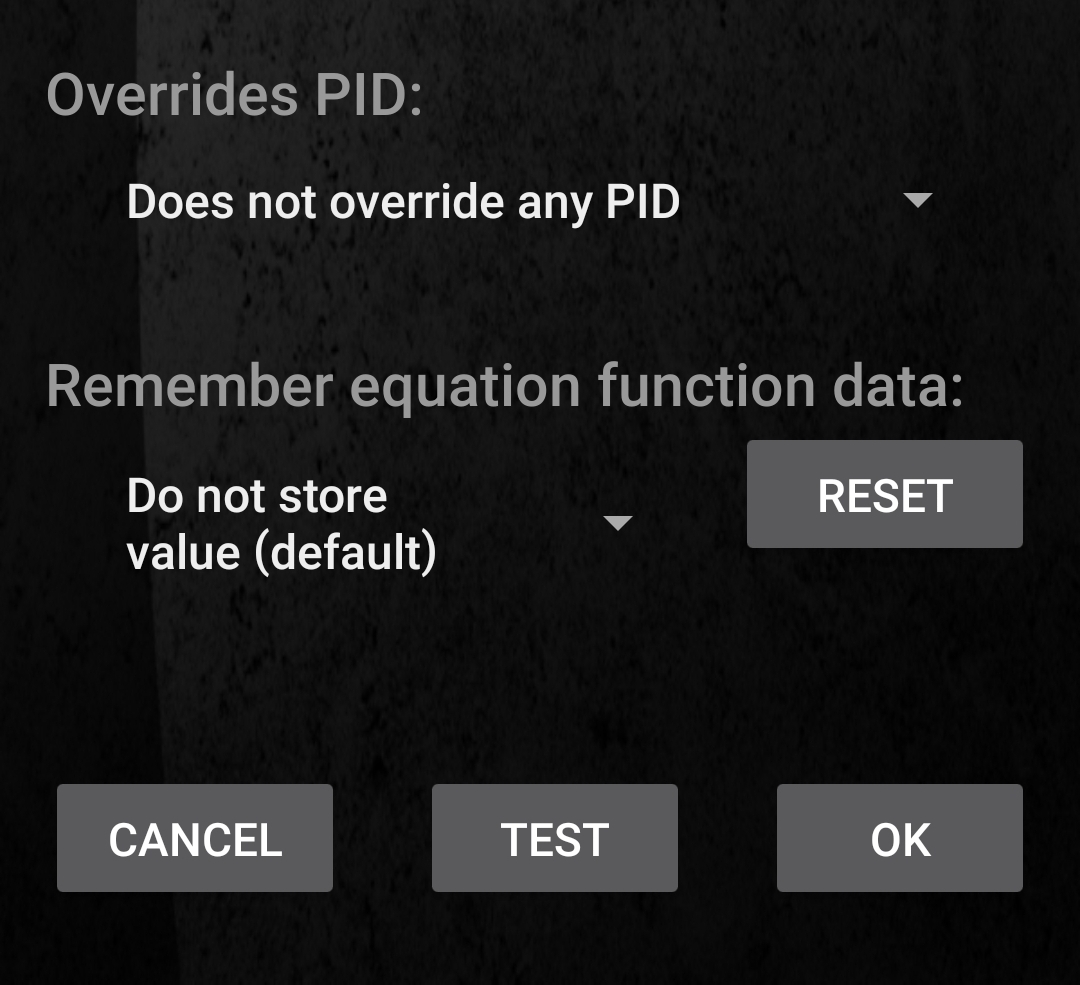

Well earlier today I reloaded the GM predefined set because I had the PID all messed up from messing with it. Even resetting it in the PID editor wouldn't put it back to original settings, soooo after doing that then re-adding the gauge it still wouldn't work and I went in and changed the header from Auto to just leaving blank like I posted earlier, but now it works.
Here's what I have for the PID info....
21,276
30,208

Everyone. Original poster here. IT WORKs. I was running the regular GM PIDs when it was not working. The error was in the "OBD Header to use" section. Mine was set to AUTO but when I cleared it out to BLANK, it worked.
I apologize for being MIA, I was not getting notifications that this thread was active. Thanks again for helping me with this.
