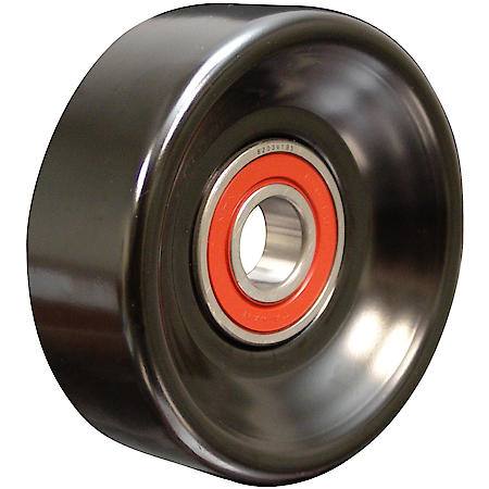

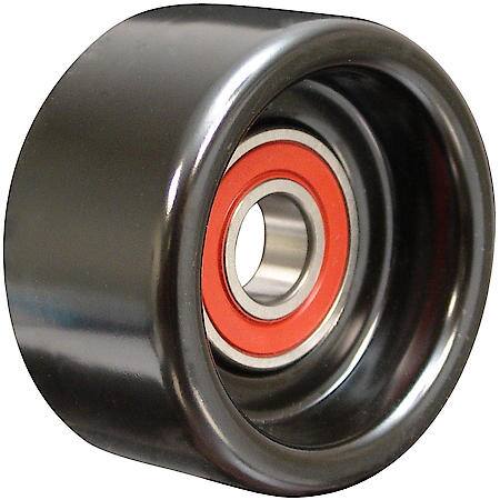

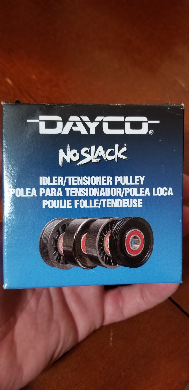

Everything was ok today, until I threw the belt--again. Grabbed a replacement idler pulley from Advance Auto. The design is a little different on the new one--not as concave as the stocker.
20190729_171743-jpg.227831
Also, I plugged in my better scanner and it scanned the Hoe with no issues. Maybe it's the cheap scanner. Who knows. I had to drive it overheating and just on the battery. I'm hoping I didn't damage anything.

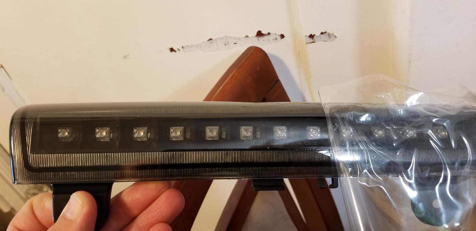

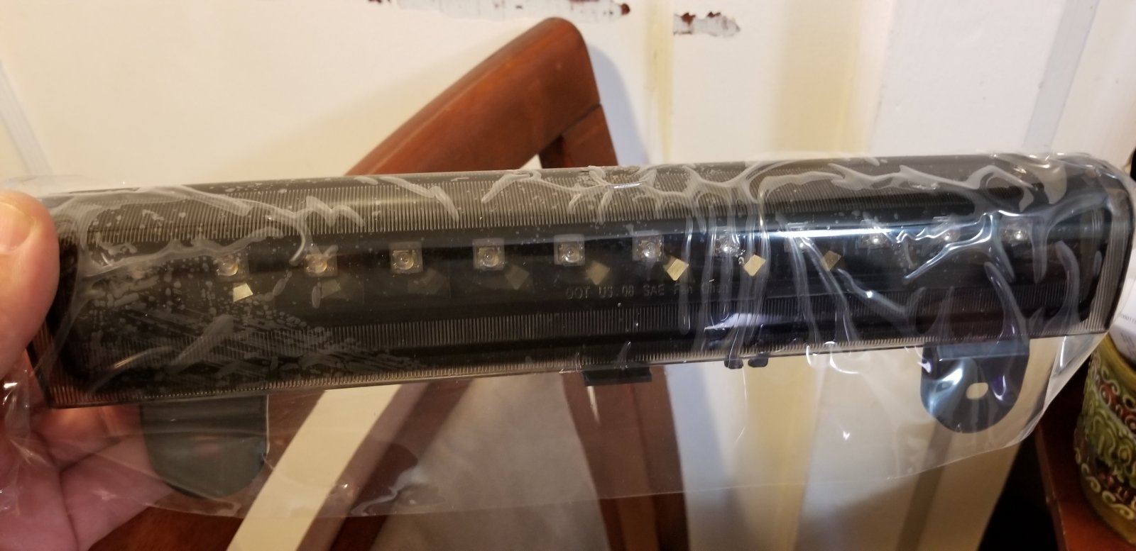

Parts came in. I'm not sure if I like the chsml tho. Thought the lens was smoked. What do you guys think?

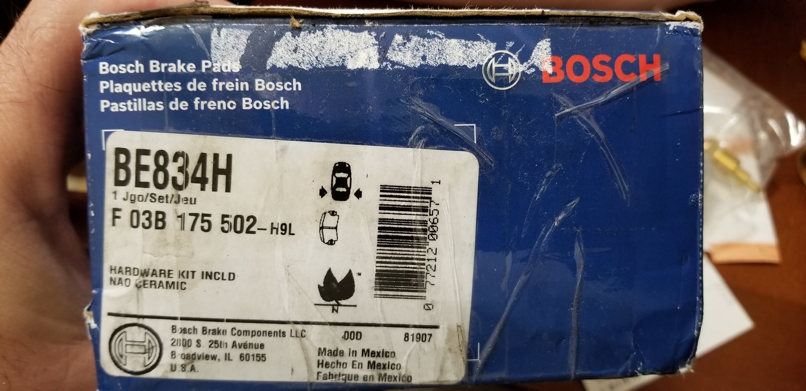

Here's the other parts that came. Looks like I might have a busy day off.
ceramic pads.
