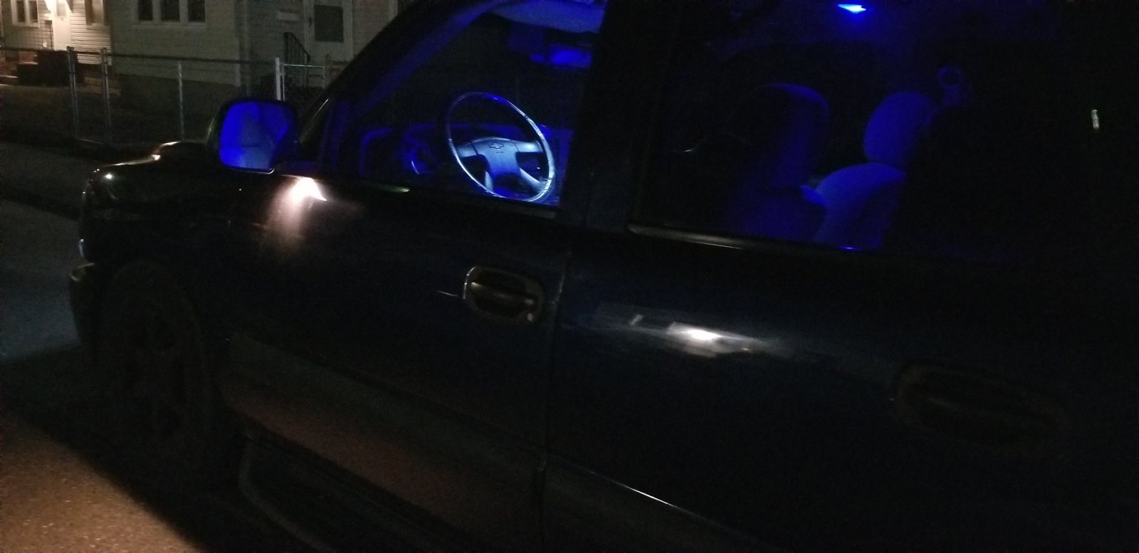

I found a better build than yours tony, sorry, some one had to be the bearer of bad news.
