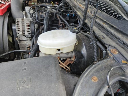

Finally swapped the new mc in. Literally took less then 10 mins. Now just gotta bleed the brakes--hopefully soon. I have speed bleeders on the rears, but I forgot the process to bleed with them. 20230528_152338.jpg

you'll need to bleed the master first. fill it, then have someone pump and hold the brake pedal while you crack the line nuts. do one at a time of course. you'll hear the air spitting out, stop when you no longer hear it. wrap a rag around the wrench and nut to keep fluid from spraying all over he place. then most of the time its rr, lr, rf, lf. if you didnt loose fluid to any of the calipers bleeding the master might be all you need to do.
