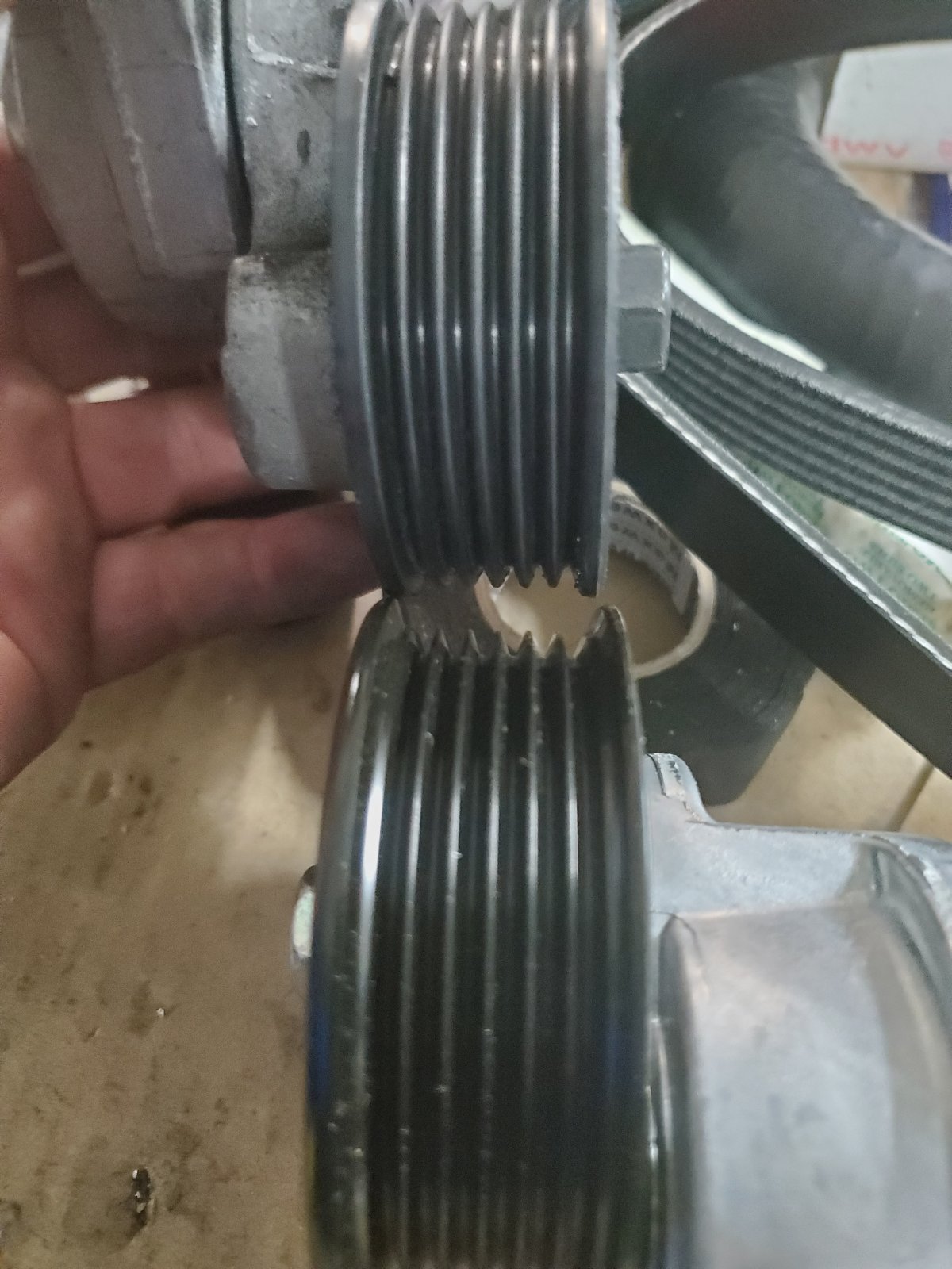

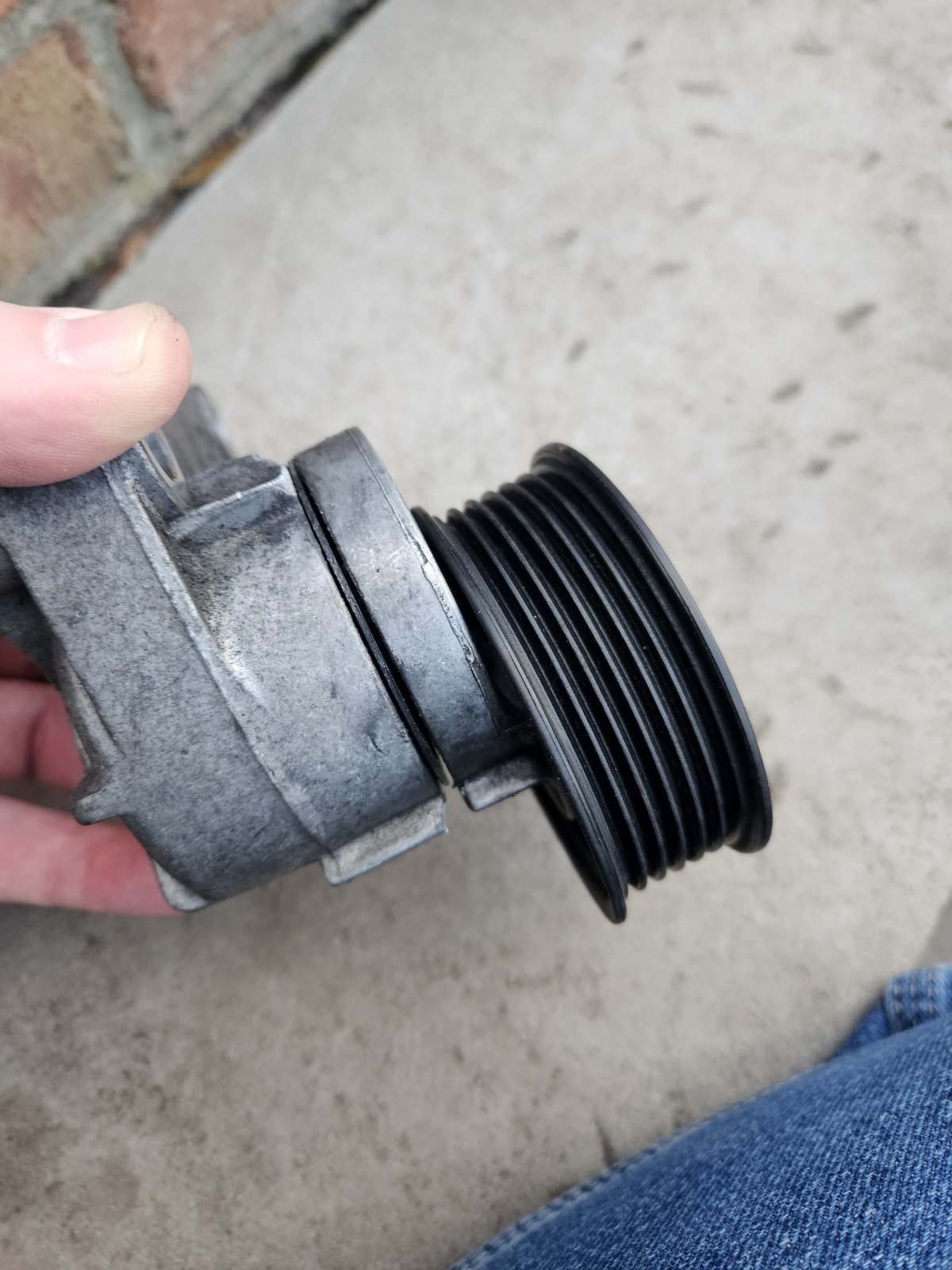

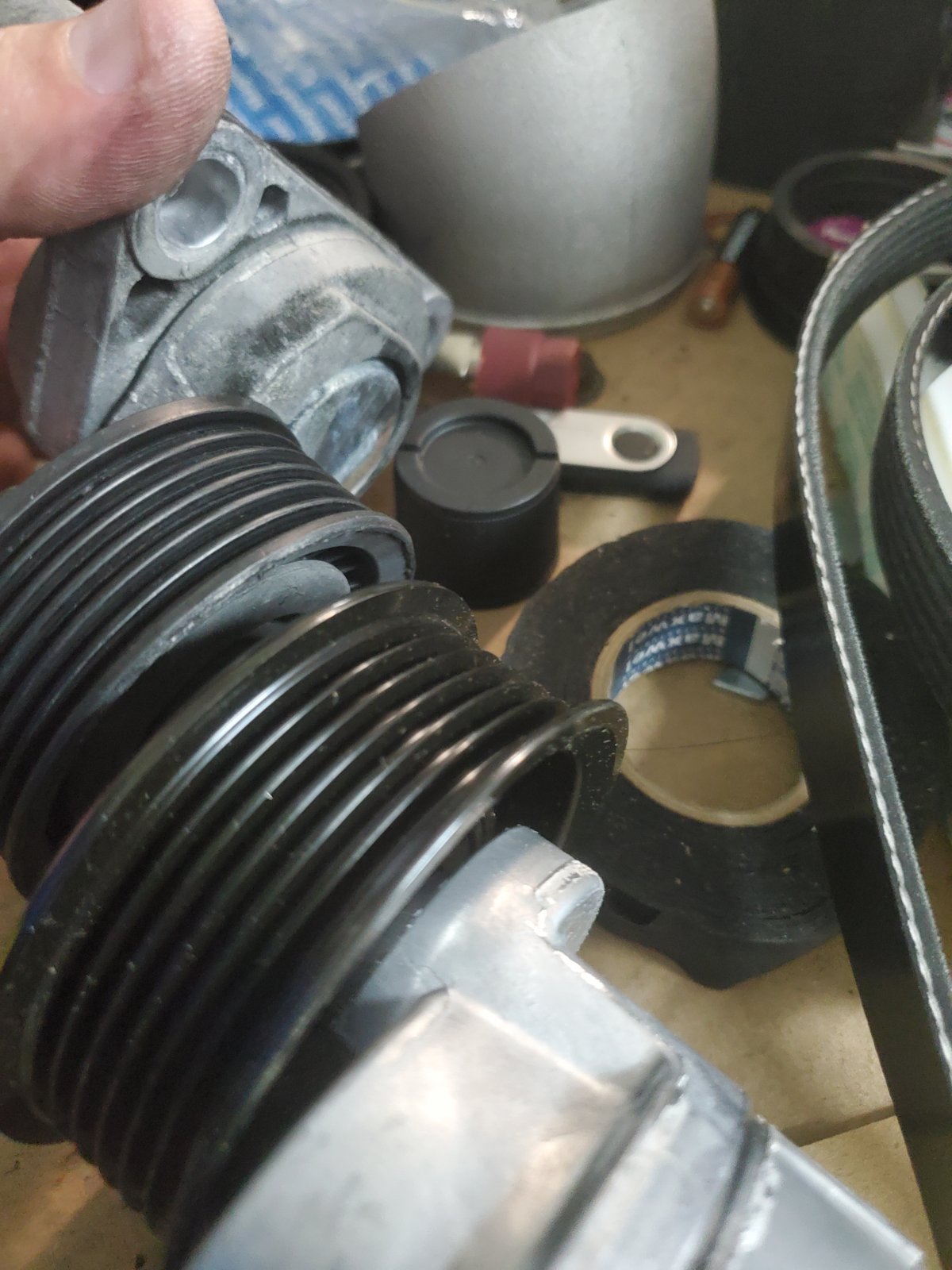

The correct tensioner finally came today. Got motivated enough to put my pants on and swapped it out on the Hoe. Took it for a ride and it's gtg! So that's what the issue was, damn tensioner.
There definitely was A LOT of excessive play in it. New one is tight as a drum.

Big difference. Is that other tensioner for the ac?
nah ac is 4 rib, i think its a tensioner for ctsv or corvette ls2 years. in my post i say the tensioner doesnt work cause its offset wrong, but the pulley itself can swap over on the other tensioner

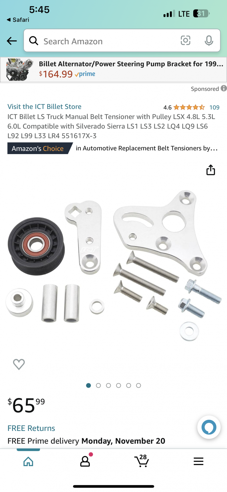

I’ve been looking at those billet fixed tensioners instead of the spring oem style. I wonder if they got one for the ac tensioner too?

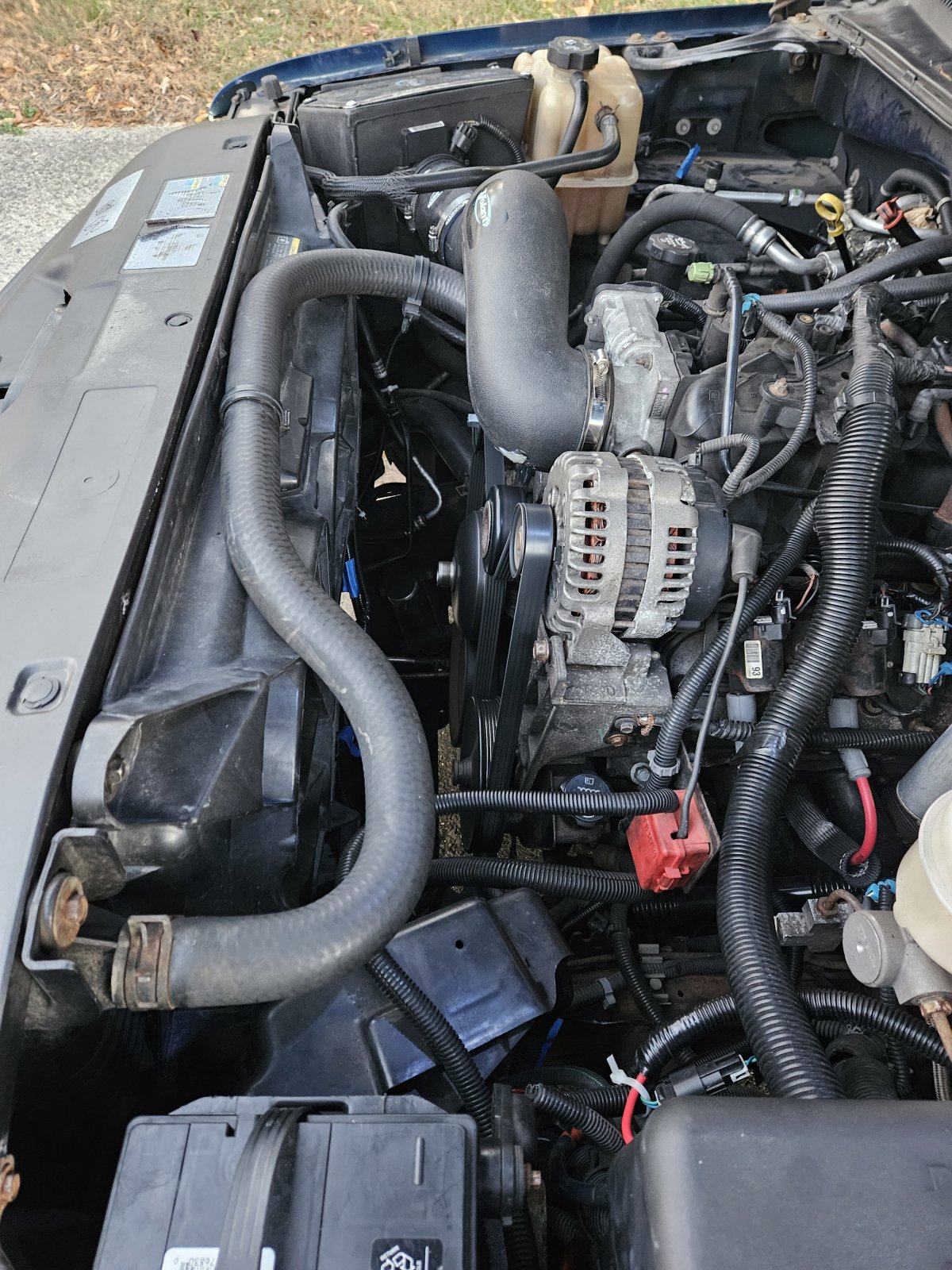

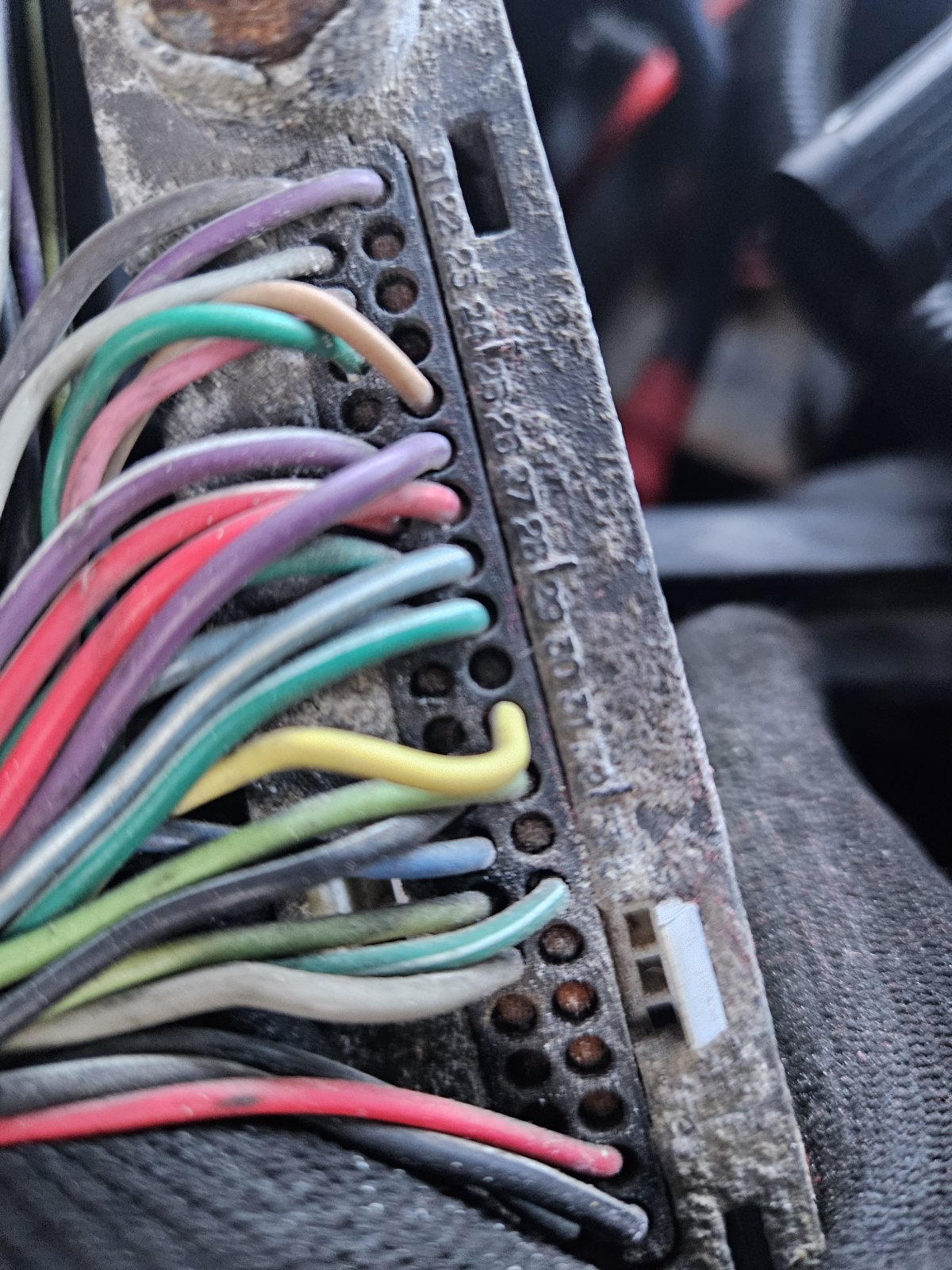

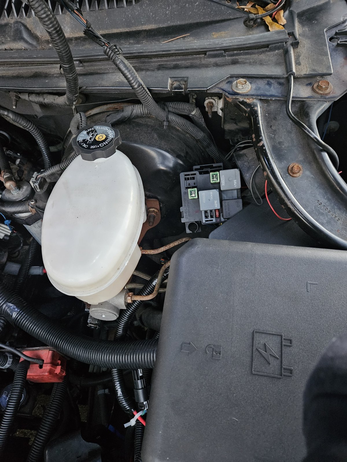

Ok, I finally installed my electric fans. Followed instructions to the letter. The fans aren't kicking on. It actually overheated while running. Stuck the correct wiring/color into the corrects pins, into the pcm. Everything else was pretty much self explanatory. Should any of the plugs going to the fan be hot at anytime? I even tested the plug that the 2 fan leads terminate to. I bolted the constant 12v to a hot pole in the fuse box, and I have a good ground--I tested it to make sure. What am I missing here? @ScottyBoy ? Anyone?? View attachment 41453320231118_163838.jpg20231118_154605.jpg20231118_163846.jpg

I assume you had them turned on in your tune.

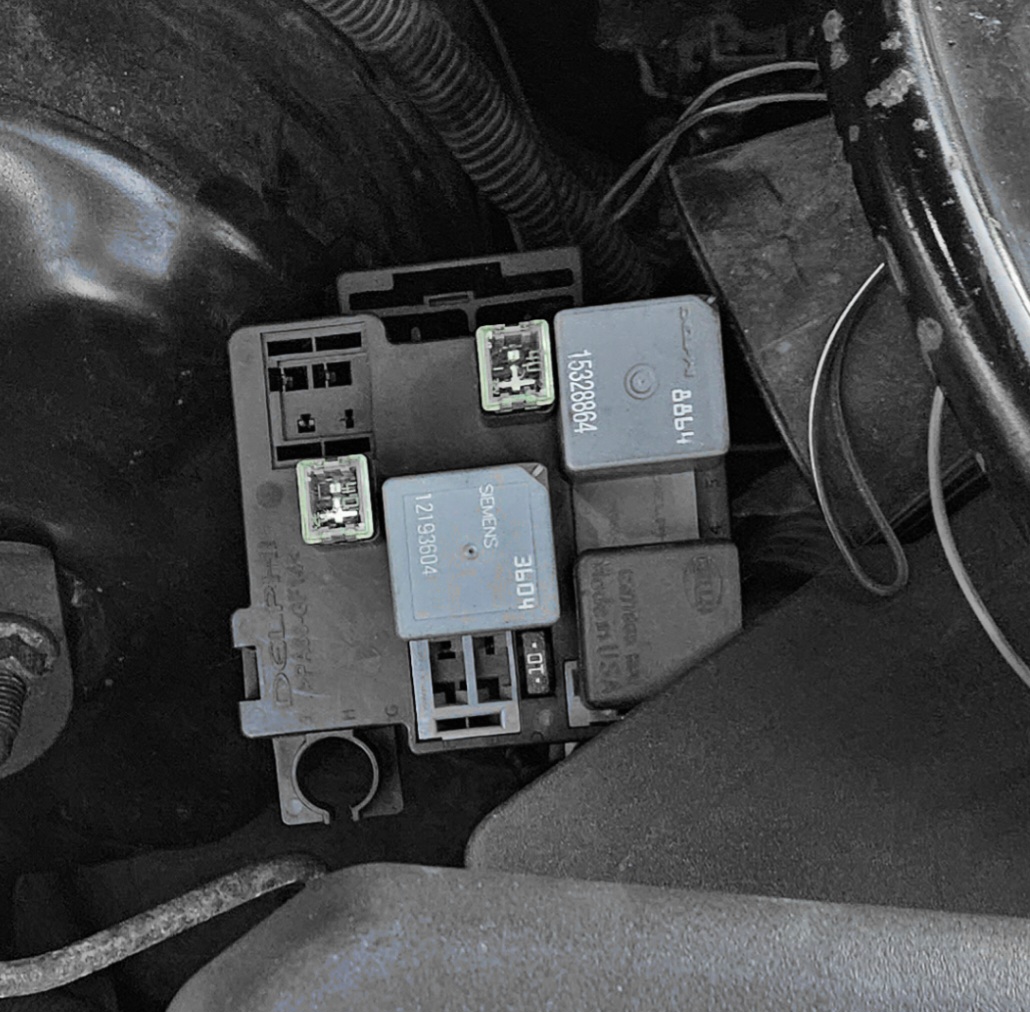

To test you could pull a relay and put a jumper wire between the 30 and 87 terminals and see if one or both turn on. I think there are three relays total if I recall. One for each fan and one for both if I remember correctly. If you are unsure of which terminals to jump look for the two with heavy gauge wire going to them.

Which relays? Do you have a pic hopefully? I suck at wiring and no clue how to read schematics.
I'm going to call Monday and make sure it was turned on in the tune, or maybe even drop the pcm off.
The relays you're talking about--are they part of the factory harness FOR the fans?Screenshot_20231118_212338_Gallery.jpg

If they weren't turned on in the tune, would they still turn on by jumping the relays?

What's a good way to test the fans now that they're installed?

I was under the impression as @kbuskill stated that for the pre 2005 trucks to get them going they needed to be activated in the trucks tune.
FIXED!!
It was instructional error. I had the constant 12v bolted on a constant hot pole under the plastic fuse panel. I moved it to the constant 12v "red box" next to the alternator. Fans work as they should.
Thanks to everyone who chimed in.
