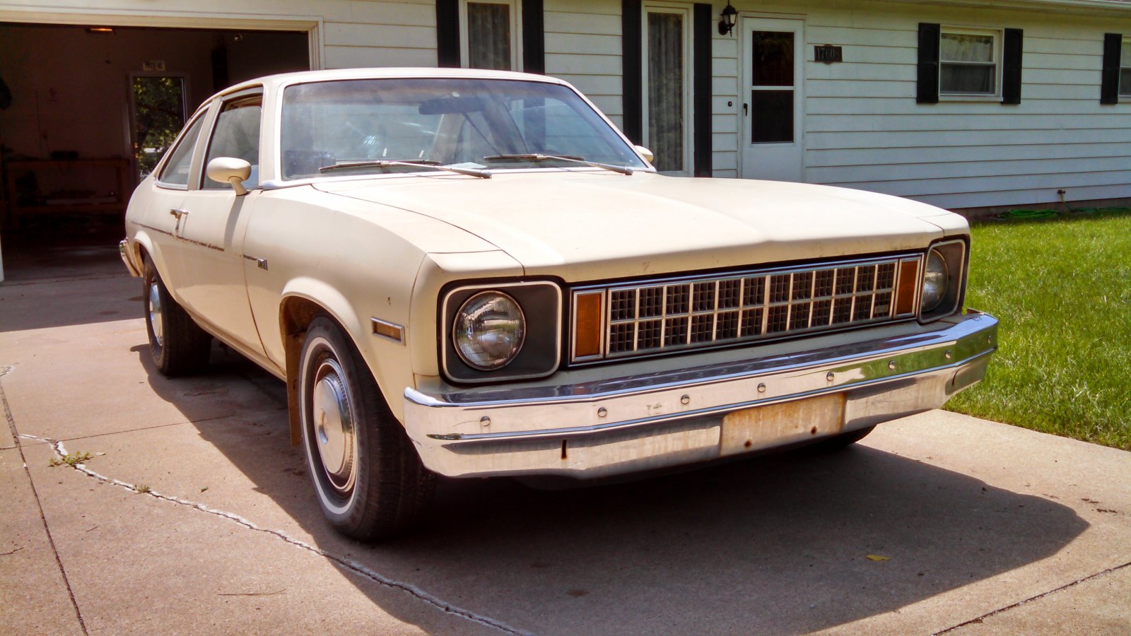

View attachment 403141mines a 76. "Disco Nova". As the nova guys call them. 36ish thousand miles when i got it in 2014. Probably should make a thread on it sometime. Originally a 6 cylinder car and i have the 6 cylinder and original transmission in storage. The original rearend died a grisly death with the v8 swap.

I remember those. I love the sleeper look.

Oh it is a sleeper too. But next time it needs tires im going to have to upgrade the wheels to some steel lowend factory 15s. The correct size 14s are more expensive than im willing to pay. Hell they ran me more than the tires for my Tahoe.

Unheard-of condition in that part of the Land of Lincoln. :)

Sleeper!
