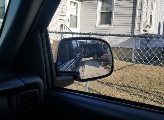

Had the day off--again--so I finally swapped out the ps mirror 20220221_180816.jpgAlso did the 2 plastic T connections. Easy, but what a PITA.20220221_154322.jpg

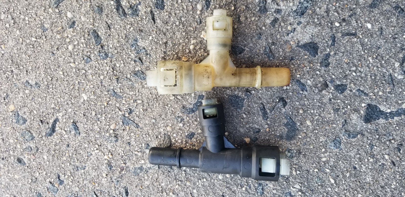

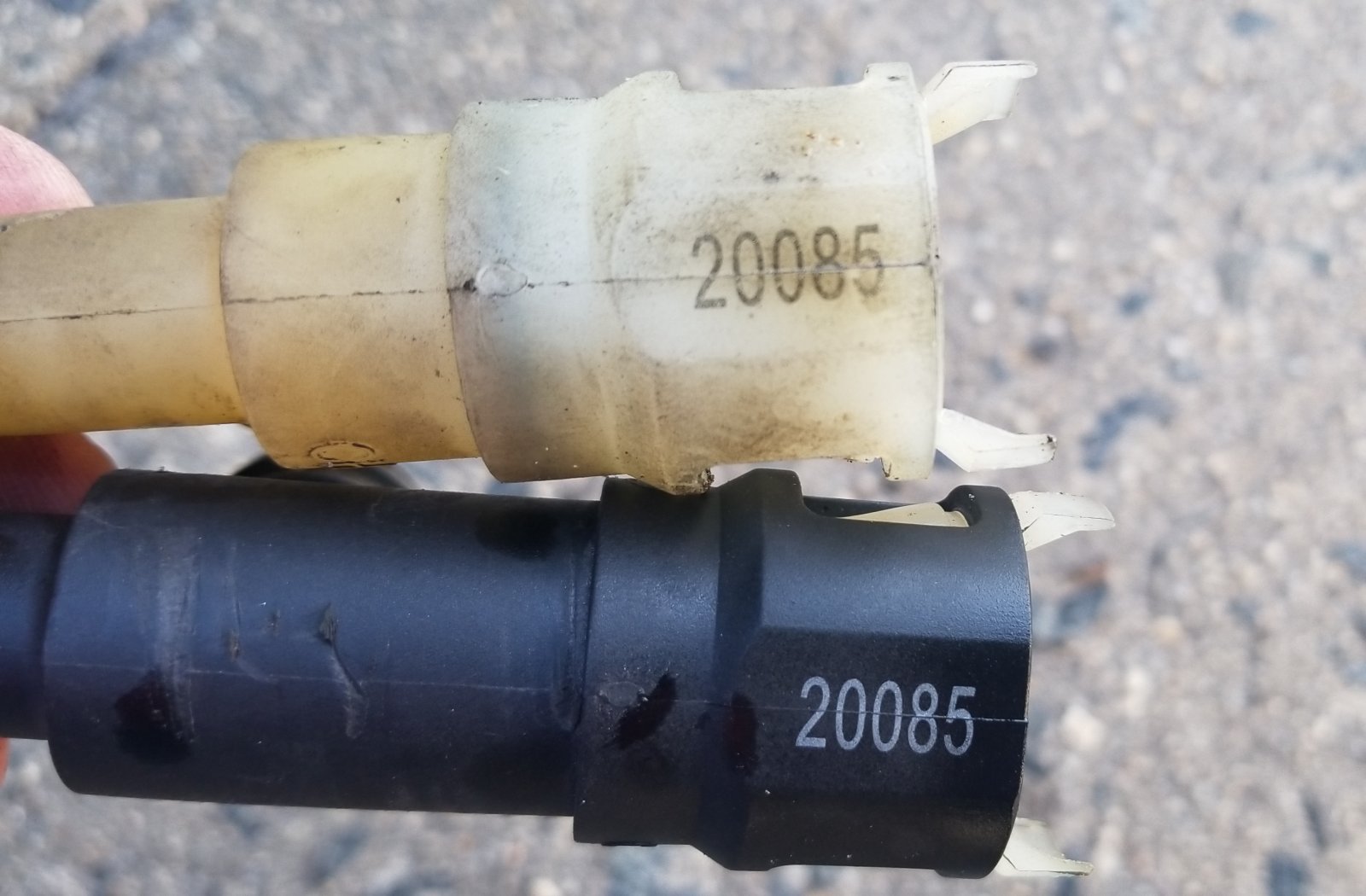

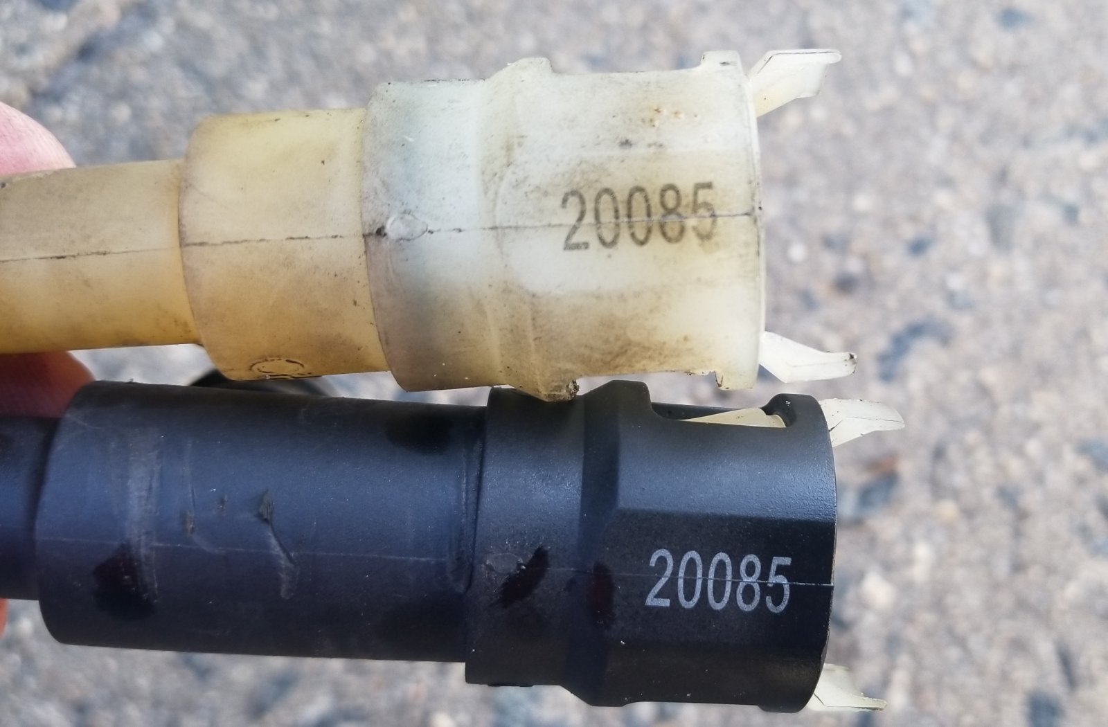

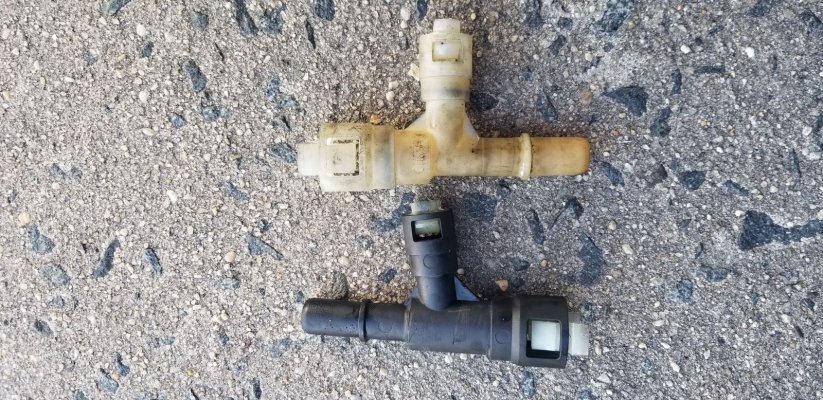

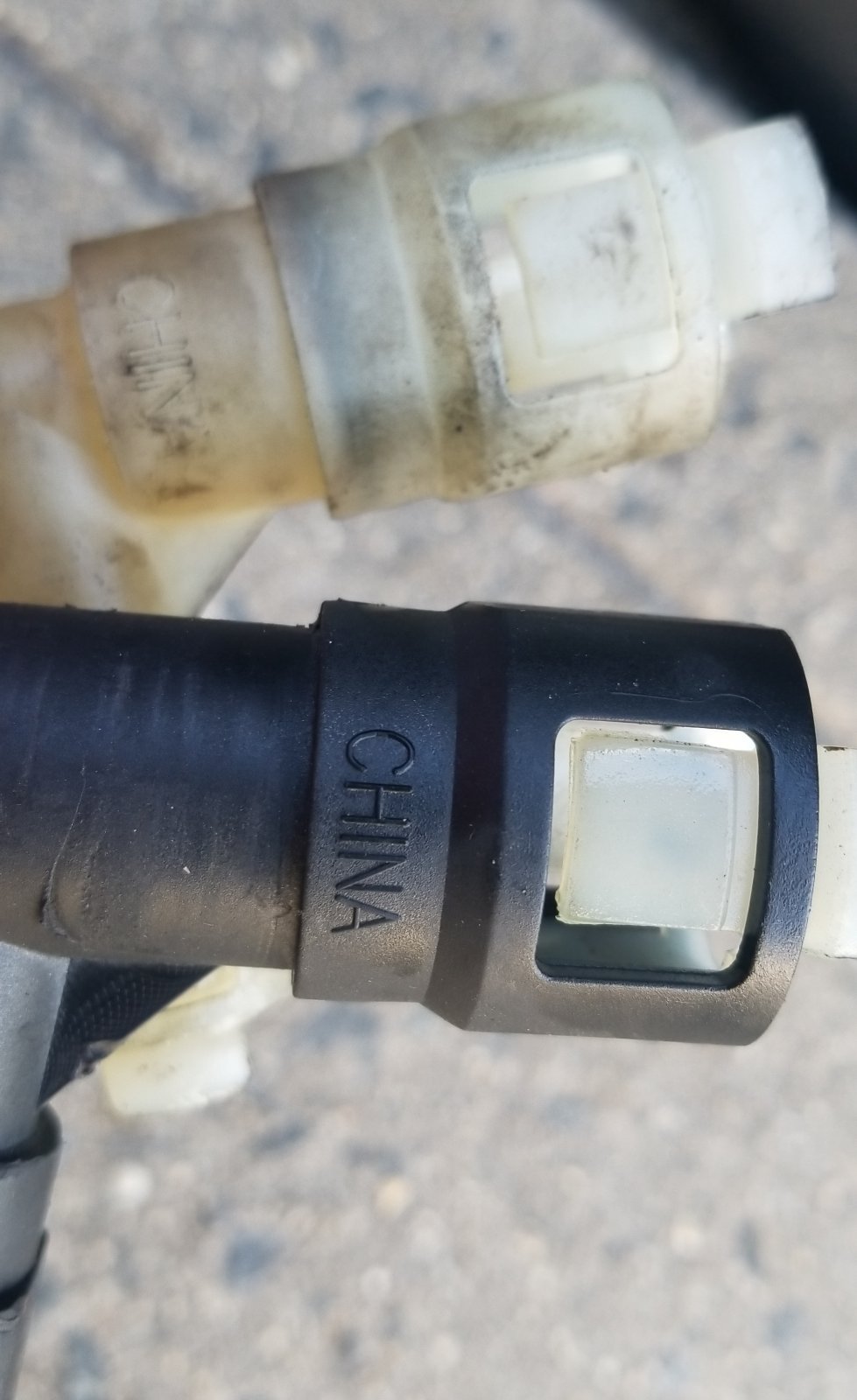

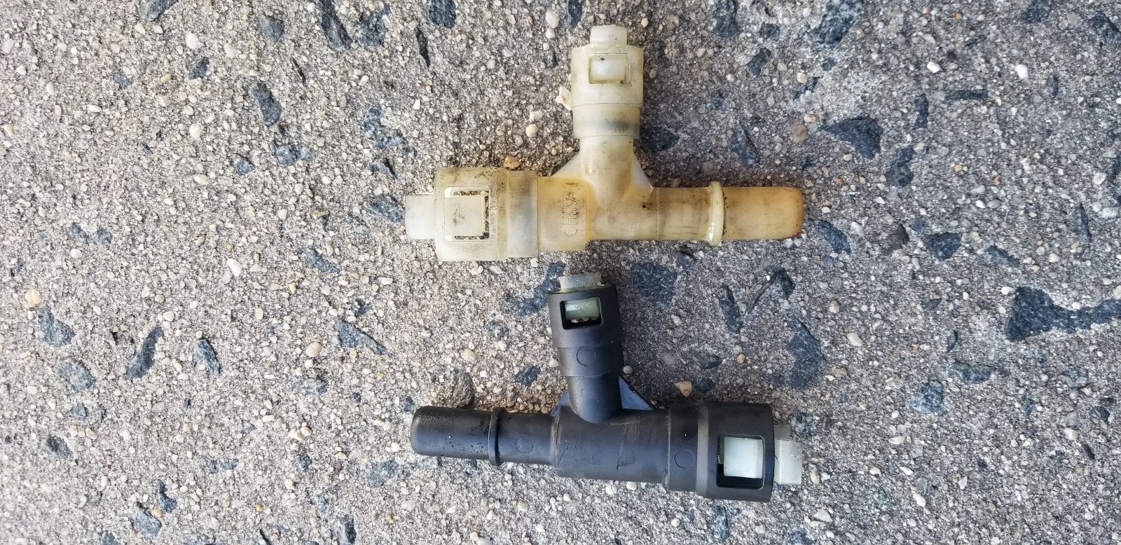

Got the old ones out without breaking them. Not sure if they were both aftermarket. Says made in China. Originals were made in Mexico. 20220221_180719.jpg20220221_180745.jpg
Looks like the system is holding pressure again.

Had the day off--again--so I finally swapped out the ps mirror View attachment 363936Also did the 2 plastic T connections. Easy, but what a PITA.View attachment 363934
Got the old ones out without breaking them. Not sure if they were both aftermarket. Says made in China. Originals were made in Mexico. View attachment 363937View attachment 363938
New ones in. View attachment 363935

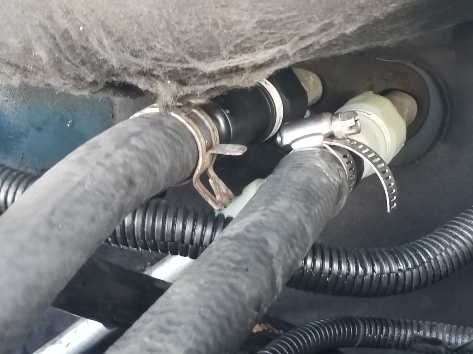

I think that’s when I’ll do mine. I have to figure on worst case scenario since I can’t find out if it’s even possible with the Whipple or if I I have to pull it. Every time I look at it I’m not sure if I can cut the old ones off. I’m pretty sure I can install the new ones since they just click on.
When I originally broke one about 4-5 years ago, I was able to get the rest of it off by using pliers. The pieces were just snapping off pretty easily.
52,954
I don’t think I can get pliers onto the DS one. The PS looks accessible. I can only hope that once I get the PS one off I’ll have room to get the other off. The blower hangs off to that side of the engine, right near the firewall.
