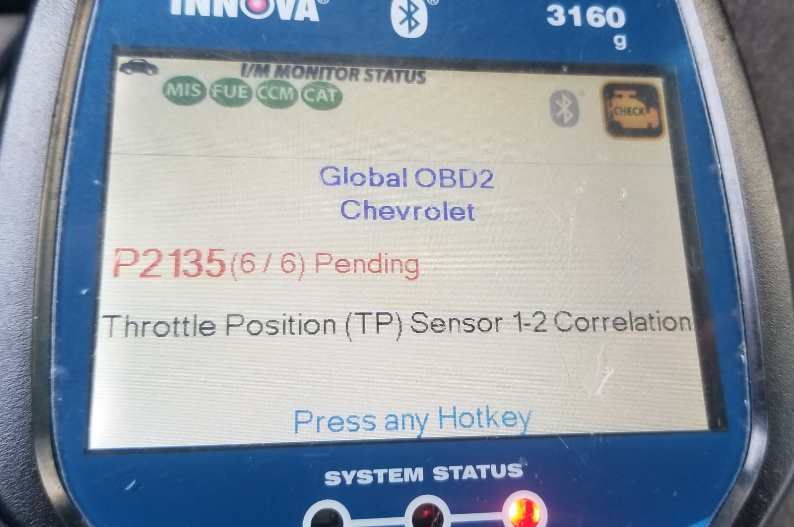

2nd time in about 2 weeks that I've gotten these--
And got this one!
I haven't seen this one in awhile. I think since I cleaned the grounds on the ds underneath. I cleared them all and it drove fine. Just really annoying. I read on another thread how the P0220/2135 components usually don't go bad, that it's due to GM using the wrong gauge wiring for those components, which they upgraded in 04.

I have had to replace the accelerator position sensor on a couple GM cars to get this issue to go away. They were on an '08 Impala and a '12 Malibu. Both had intermittent issues like you're having.
