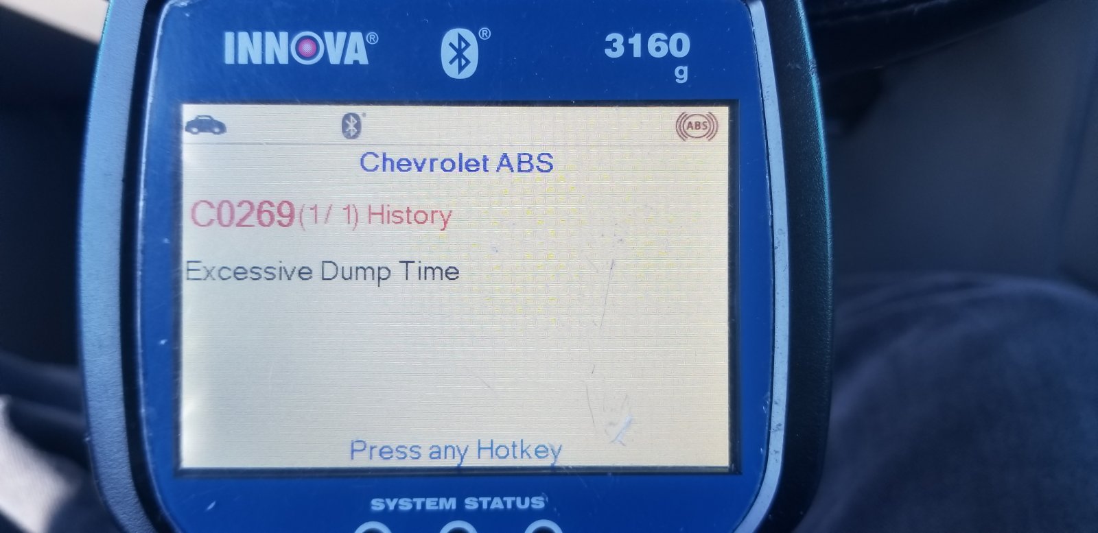

This was only stored, no abs codes.
I still gotta check those front wheel abs sensors.

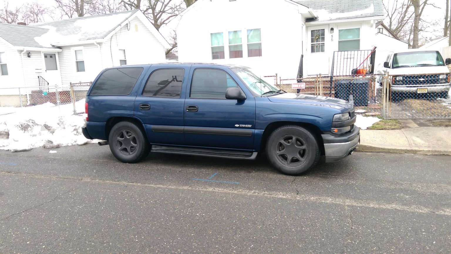

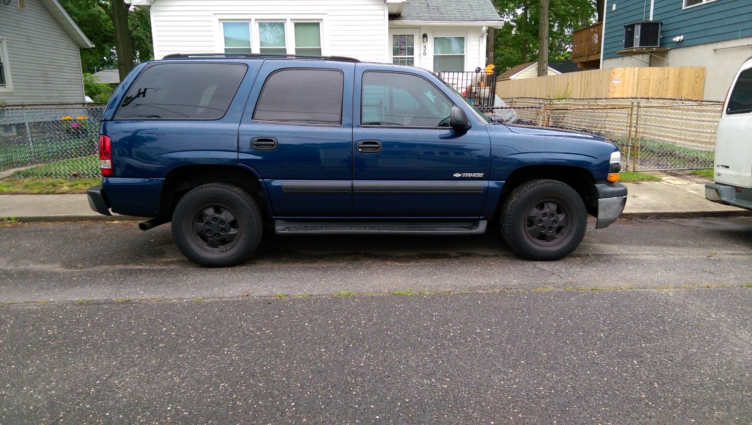

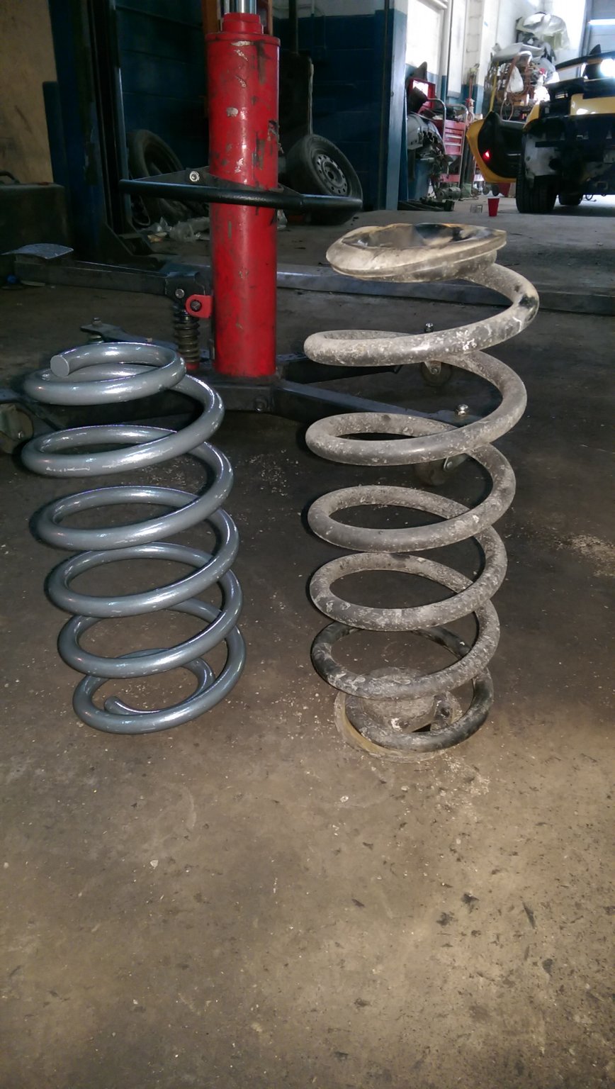

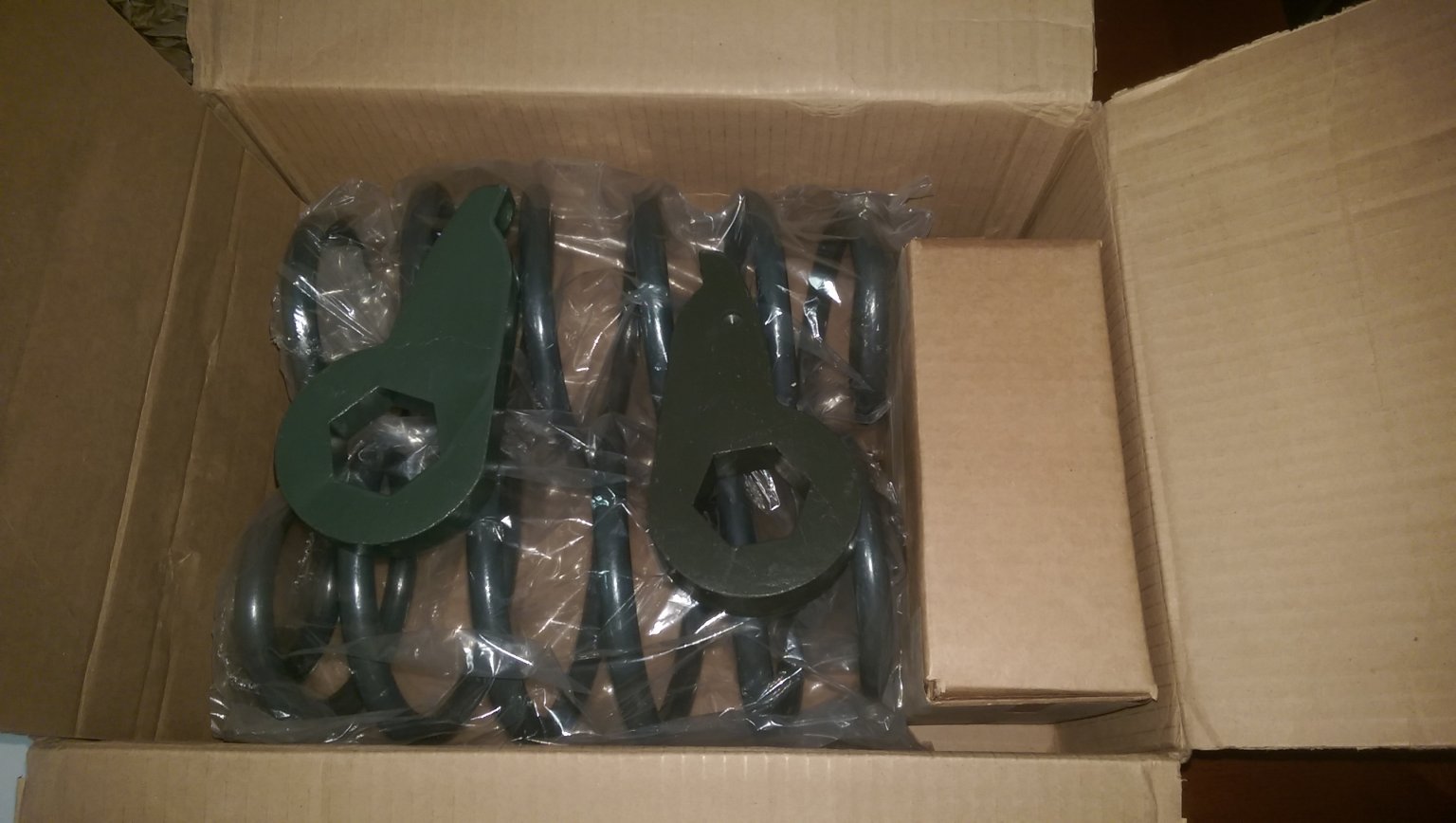

Time for a little suspension work. I've been wanting to drop it for awhile. By this time tho I've spent a ton of $$ on the swap. So I'm trying to go a little cheap. I'm looking to do a 2/3 drop. Nothing crazy. Find a reasonably priced kit from crown suspension. Comes with 2" keys, rear lowering springs and shock extenders. View attachment 80060 View attachment 80061 View attachment 80062
Before the drop. View attachment 80066
After the drop. View attachment 80065
No more of that huge wheel well gap.
Rear is 33" from ground to wheel well.
Front is now 32 1/2". I had to crank it up 1/2" the jounce stops were squashed.

Ok, great. I found the Crown with the 2" keys, 3"springs with the shock extenders.

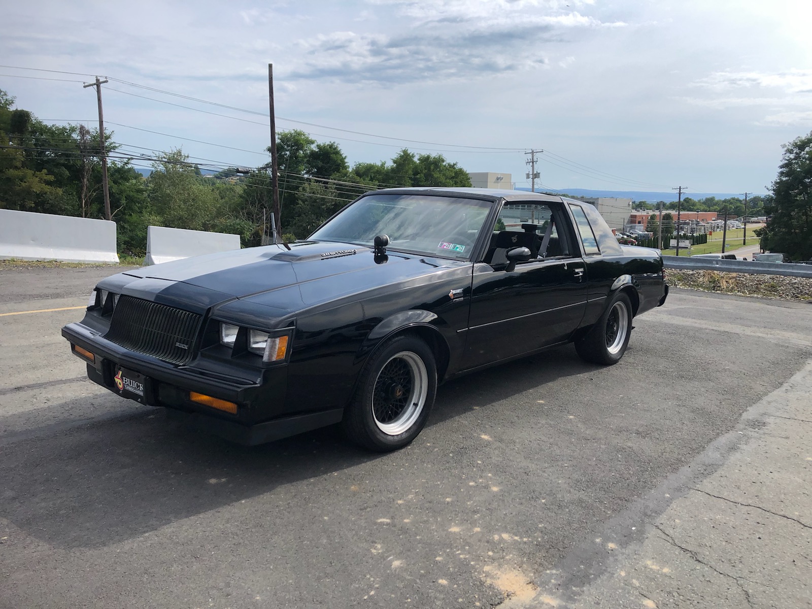

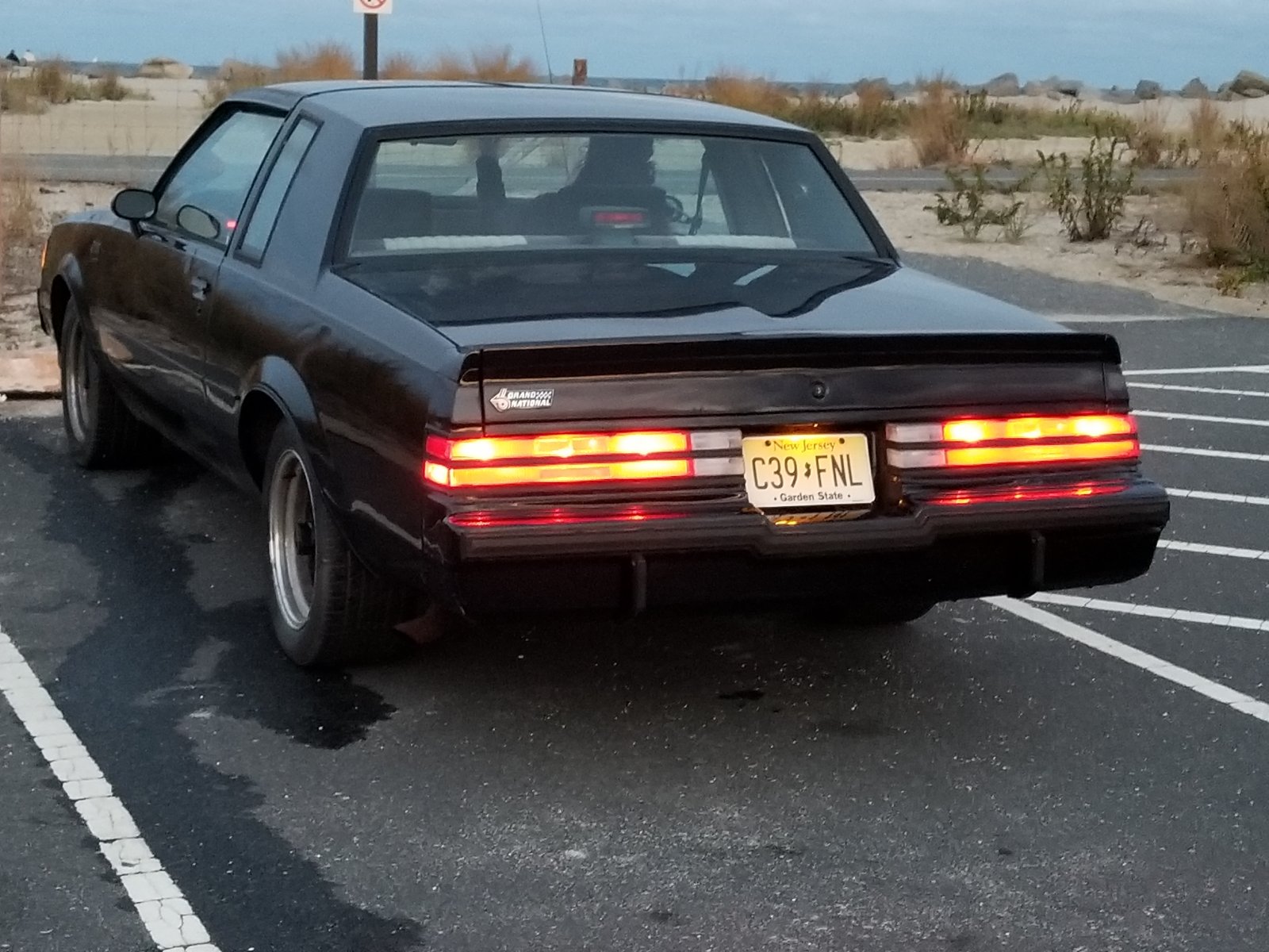

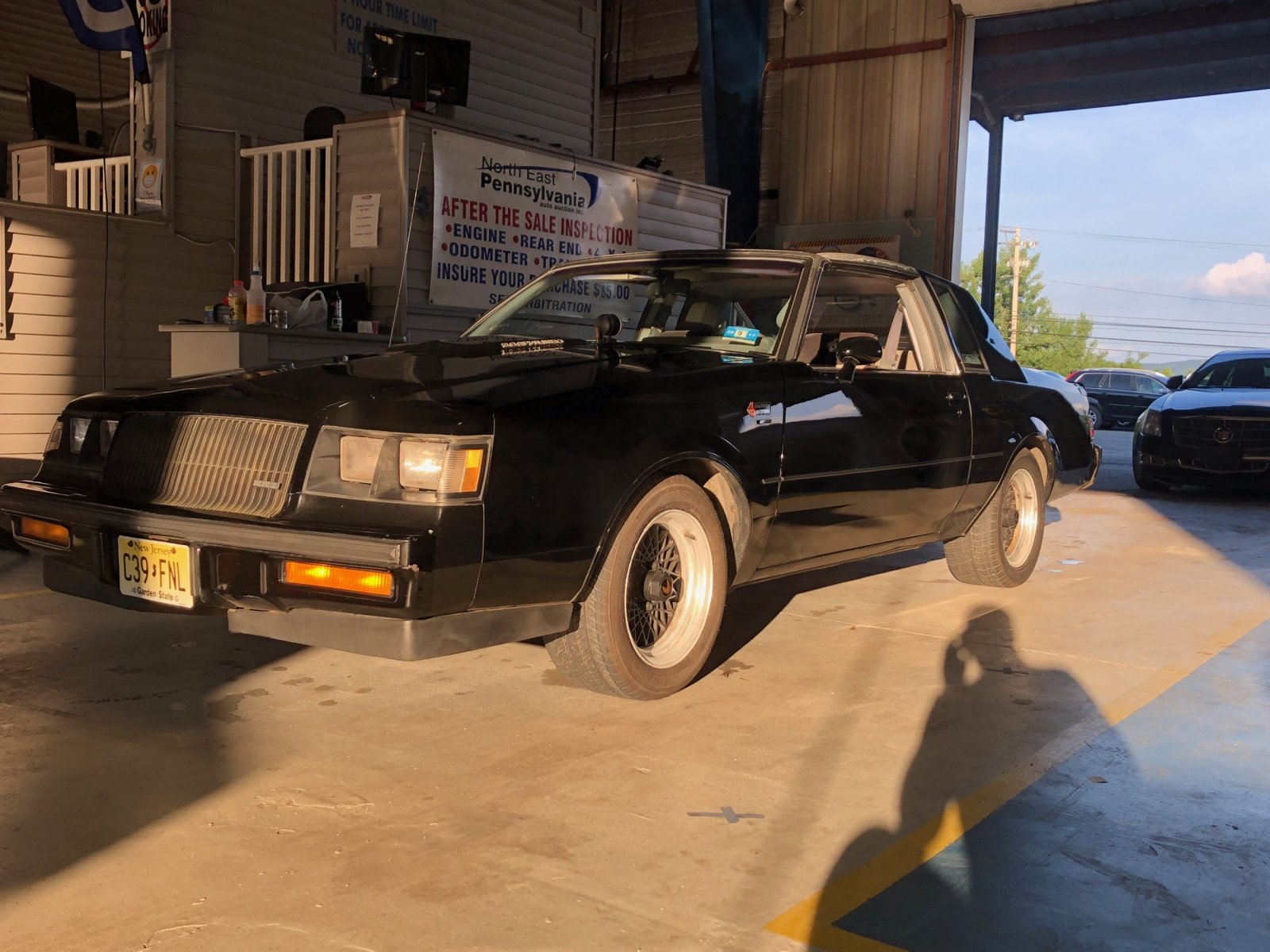

Any pics of the GN?
Sent from my SM-G950F using Tapatalk
Of course:D
This was him driving--not me lol.
I've had it since 1996. Got rid of my GMC Typhoon for it. Had around 43-44,000 miles on it. I gave it to my son about a year ago--had 48k on it. I've had it since my son was around 5, he'll be 30 next month. Time sure does fly by :(
