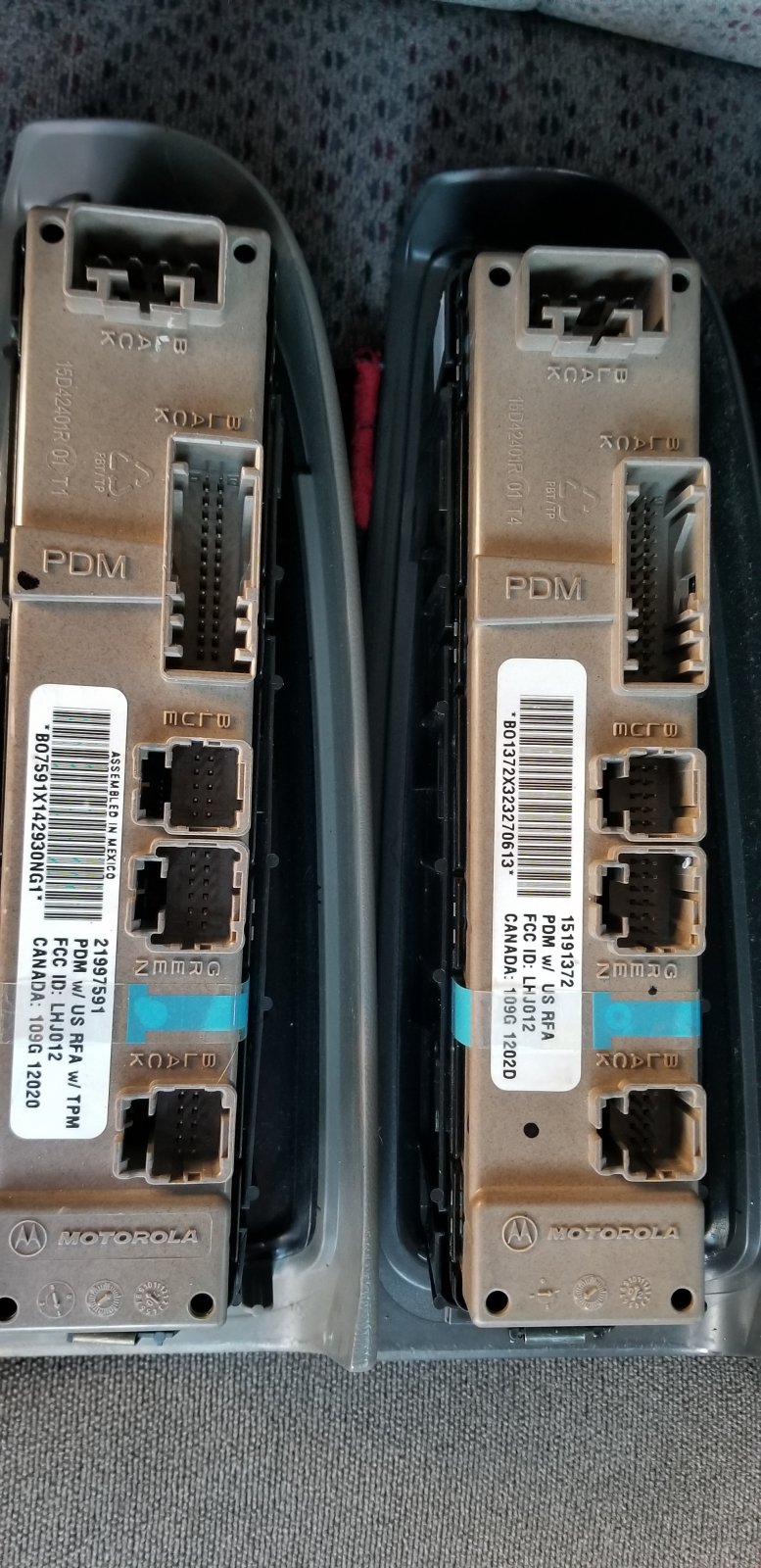

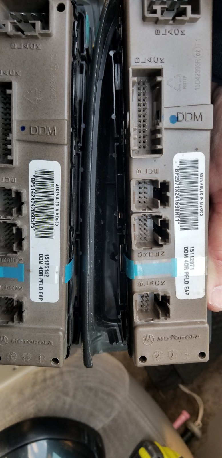

To add powerfold you need both door switches--driver's master switch and passenger window switch for everything to work.View attachment 268352 View attachment 268353
Each has a different part number. Also--They have nothing to do with the bcm, so no bcm programming needed.
Funny--both master switches have different part numbers but they both function exactly alike.

Yup, everything came from the same truck. As for the hyperflash--I have resistors on everything, no idea which one is doing it--BUT--All the cool kids lights hyperflash lol!

DAMN!!! Funny that you mention that--neither of my fobs work now. I thought it was the battery. So what's RKE, and how do I get my fobs to work again? Can I reuse the RKE from the old switch?
Just reprogram keys again
RKE is remote keyless entry and I think the module in the passenger switch needs flashed to the BCM with your tech2
