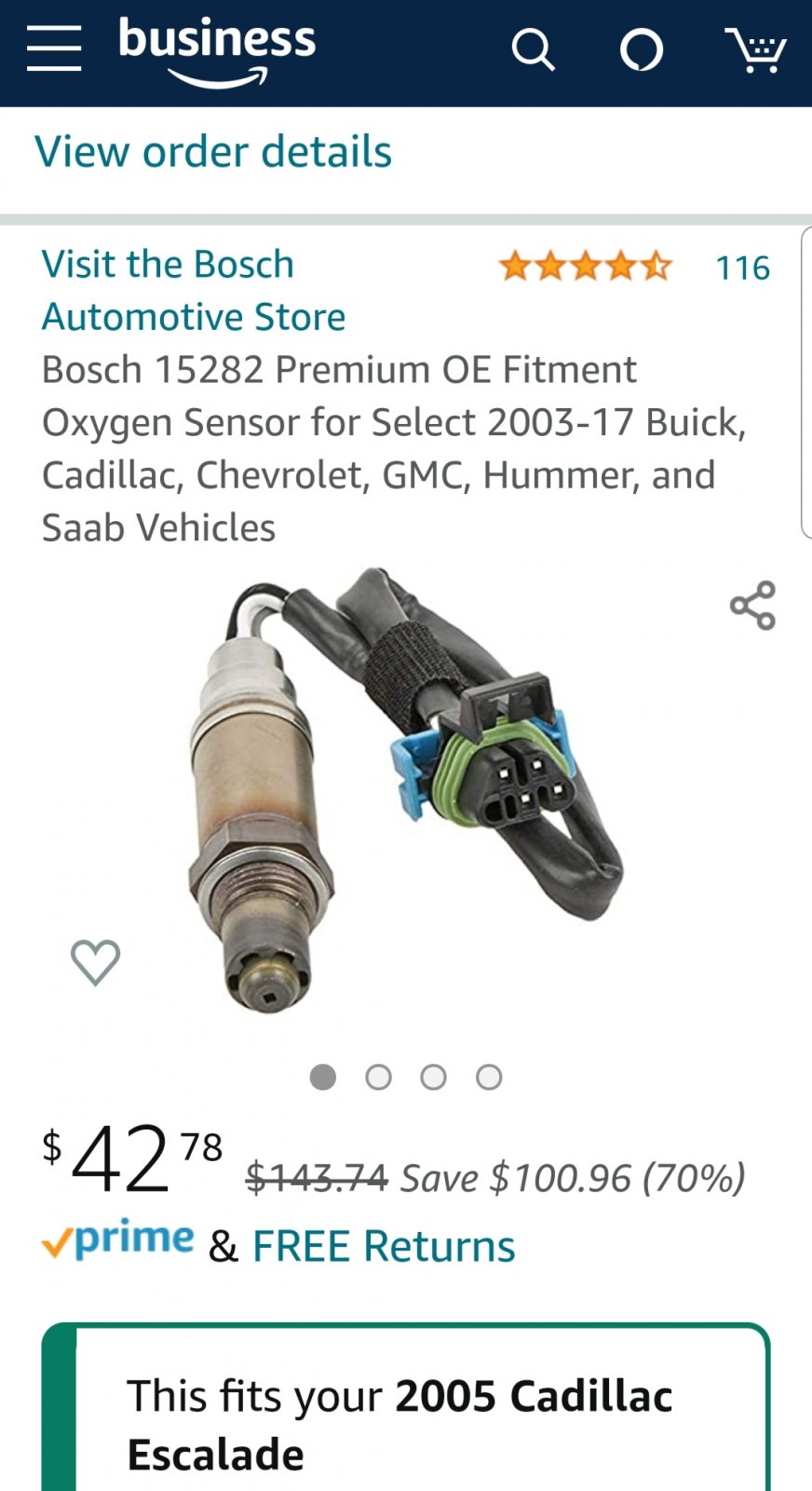

@Scottydoggs came by today to give me a hand with this beyotch. COOL ASS CAMARO--btw :D. Scott was able to scan my tune with his hp tuners. One of the O2 sensors looked a little "lazy" on the tune. I'd like to go with an AcDelco if the price is right. I googled but got a few different part numbers. Anyone know which would be a correct number? They are a little expensive, so I'd be willing to look at a Denso or NGK--possibly. Anyone have any suggestions? Something affordable. @Dantheman1540 @Rocket Man @915_Tahoe @Doubeleive ?

I got this one--
