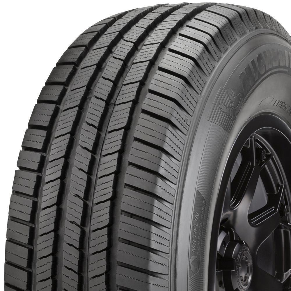

The thing is that the Michelin Defender and BFG KO2 are two very different tires.
The Michelins are top-tier all-season truck/SUV tires, and will be 1000x better on the road. They did OK in the winter - actual snow and ice - but I would never compare them to dedicated snow tires. The different tread patterns and rubber compounds make a tremendous difference, but you'll see that they have lots of siping..... very good in snow/ice.

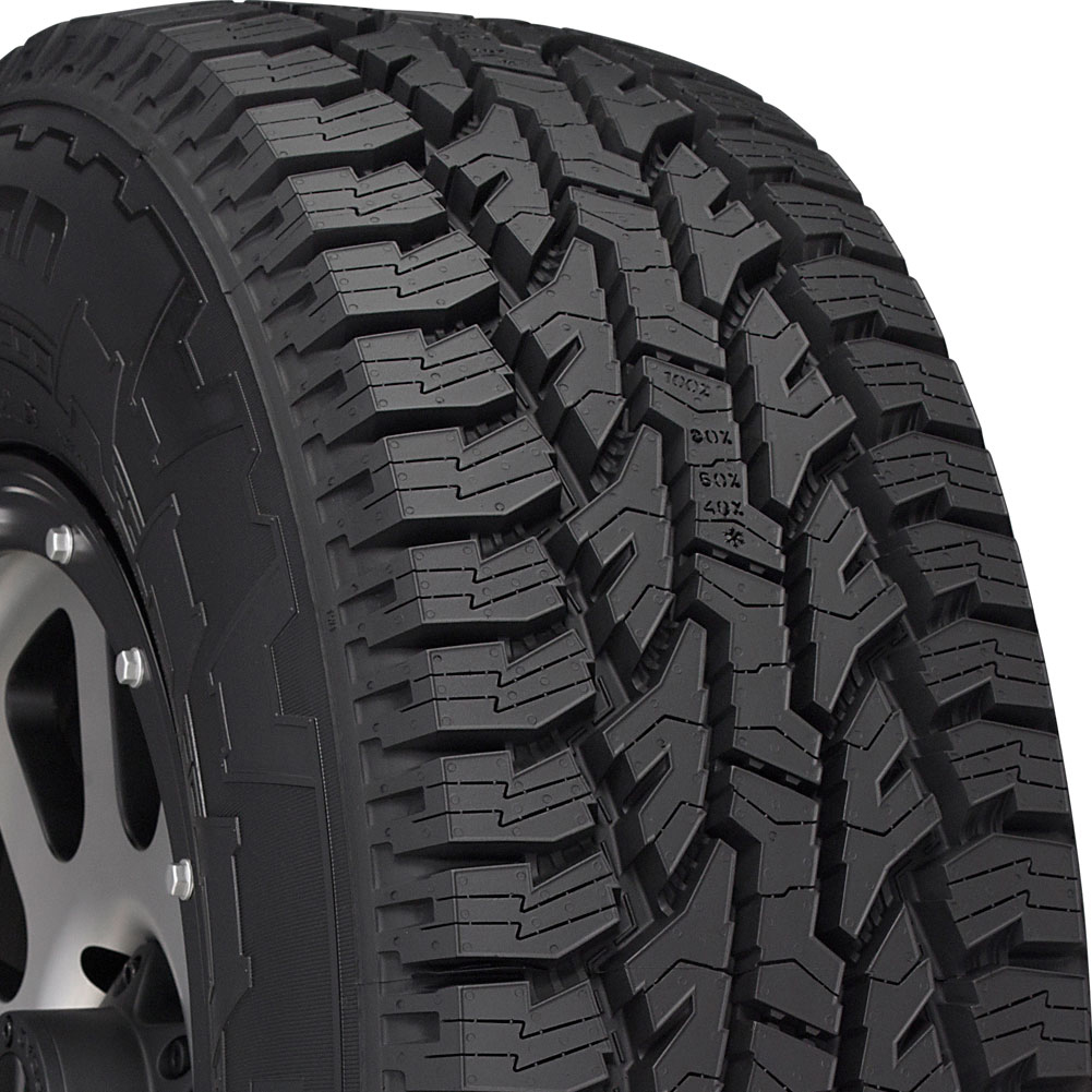

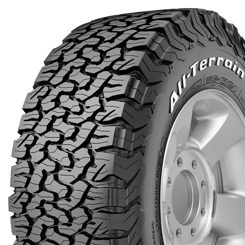

When I refer to the sipes, I don't mean the gaps between the tread blocks. I'm referring to the small cuts in the tread blocks that go all the way down. See all the small lines:
Those act like the toes of gekkos, and to a limited extent your fingerprint lines, to increase traction (gekko feet are a bit more complex, but it stands):
iu
The KO2s have limited siping, and I don't think they go all the way down... look at all that smooth tread-block surface:
KO2s are great tires, but they wouldn't even be close to my 1st choice for a winter tire.
If I had to choose one single A/T tire for a northern climate (snow/ice & hot summers) I'd go with something like these Nokian Rotiivas:
iu
