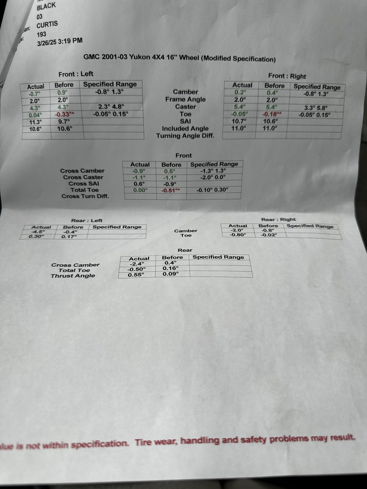

Hello! My 2003 SLT Yukon got stolen a week ago and I luckily got it back without too much damage, just front end out of wack mainly. Ended up changing out the Pitman Arm and Idler Arm, after having a shop take a look, drove straighter but still felt boat-like, steering won’t return to center, and heavier/harder to turn than it had before being stolen. Almost like I’m low on power steering fluid but I’m not after checking. Got it alignment yesterday thinking that had to be it… still does it. The shop did recommend a steering box, but everyone else I talk to says they’ve never seen one go bad or need changing. Opinions? Is my alignment even done right either?

That gearbox is smoked. Have a look at your driver side front tire and rim and I suspect youll see the evidence of curb splat on them. Jack front end up off the ground just enough to clear the ground and have someone put light pressure on steering wheel to left and right just moving a degree or 2 while you are underneath looking at the gearbox output shaft where the pitman arm is attached. You will see side to side movement of the output shaft. It will be obvious. Alignment shop shouldve checked ball joints but have someone do it again. Bad ball joints and/or bad gearbox will cause no return to center. Verify belts on the driver side front tire are not slipped.
