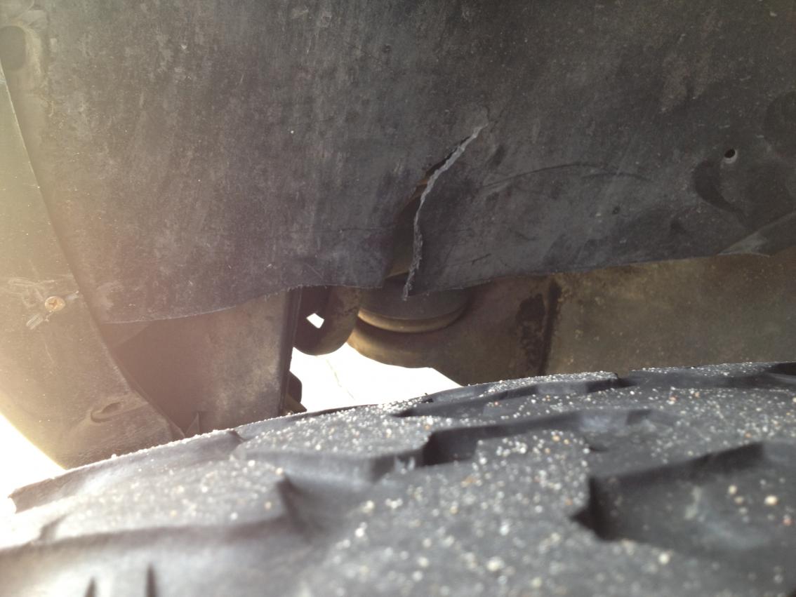

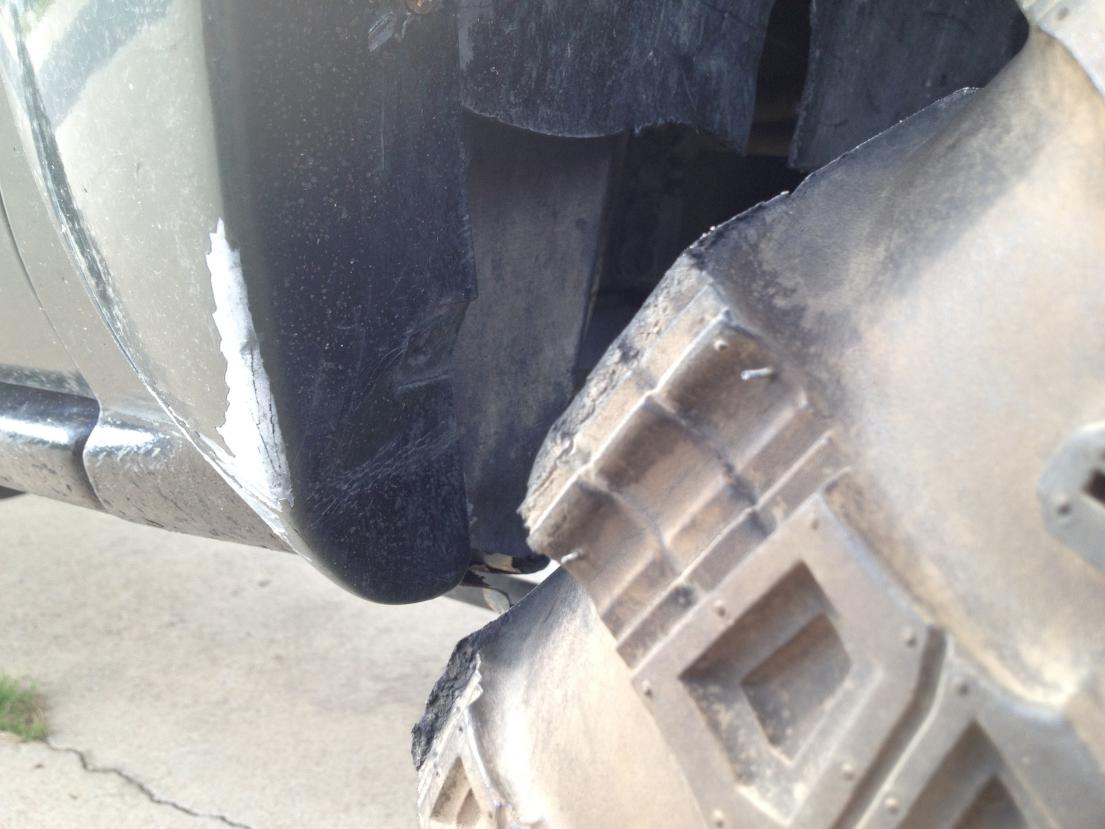

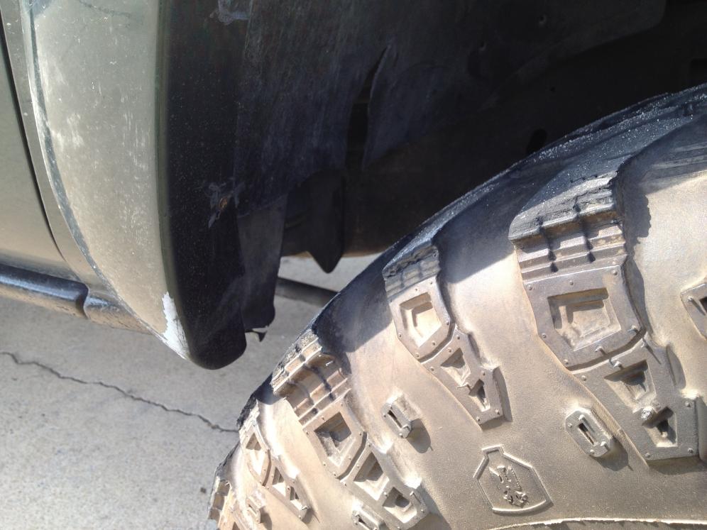

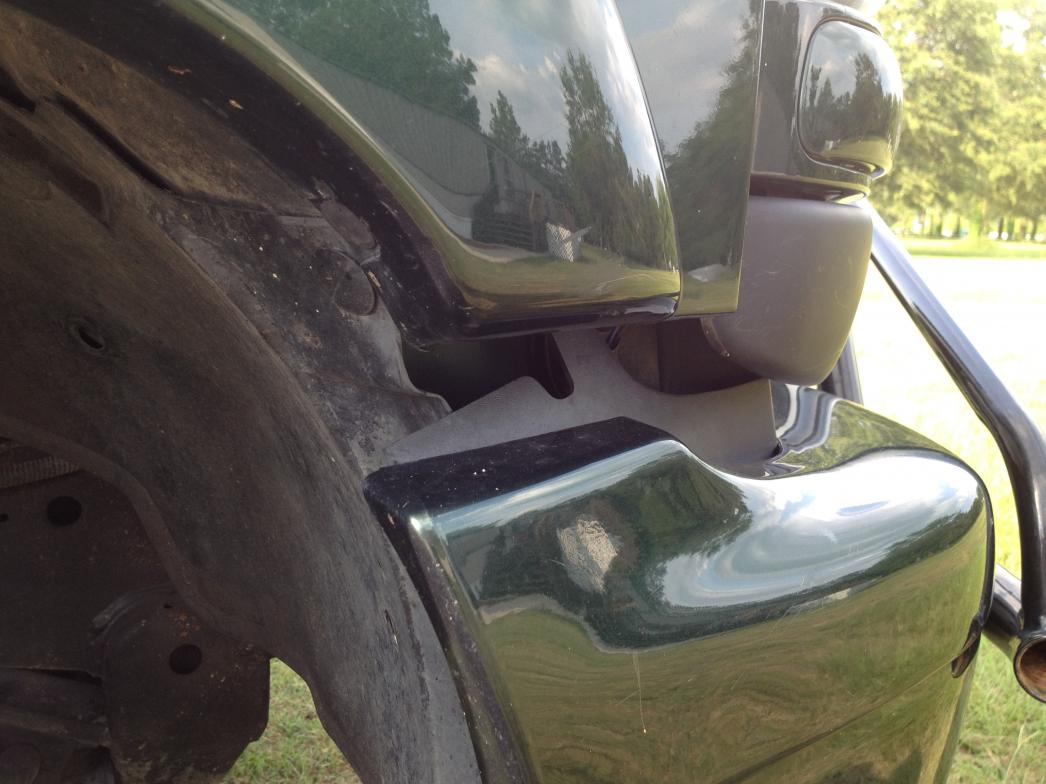

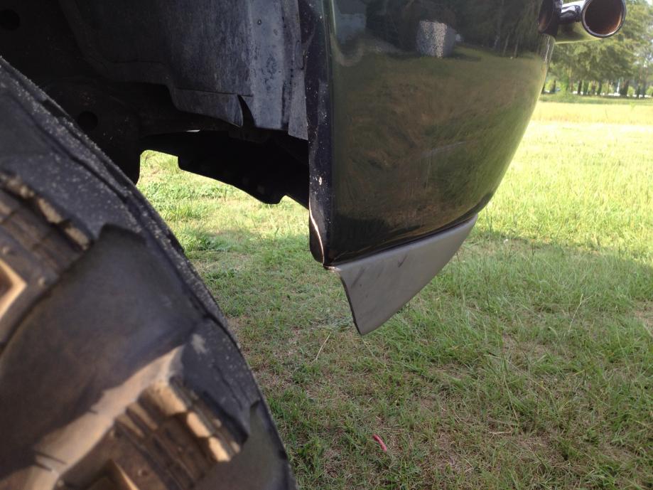

Here you go. I also have a HUGE problem with the bumper. Why is it going down like that? Im guessing every time it scrubs it pulls it down a bit

36's are pretty big tire for a 6". I will have to look the pics more closely when I get on a computer but wheels look fine but tires are to big for the lift.
yates ™
Resident Apple hater
Jul 9, 2010
24,413
6,448
Iowa
Get 35's or go higher. Bumper may need to be removed and see what's bent and replace it.
