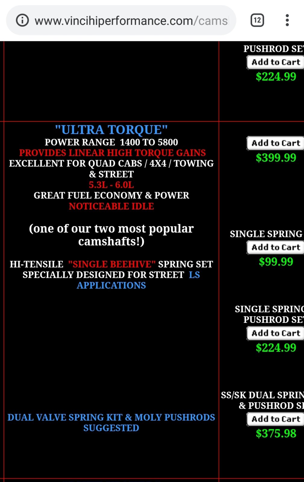

Like this one? Says nothing of converter but could still do springs rockers and pushrods
That should be fine but if you email them, I’m pretty sure Roger Vinci himself will answer you regarding the best cam for what you want to do. He helped me a lot.
