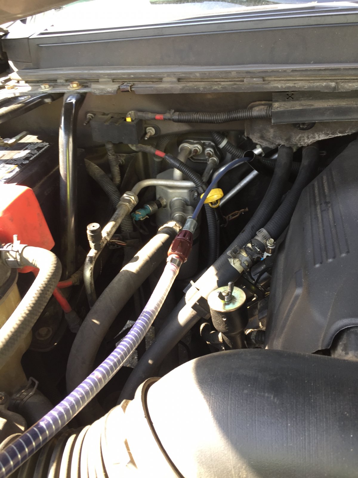

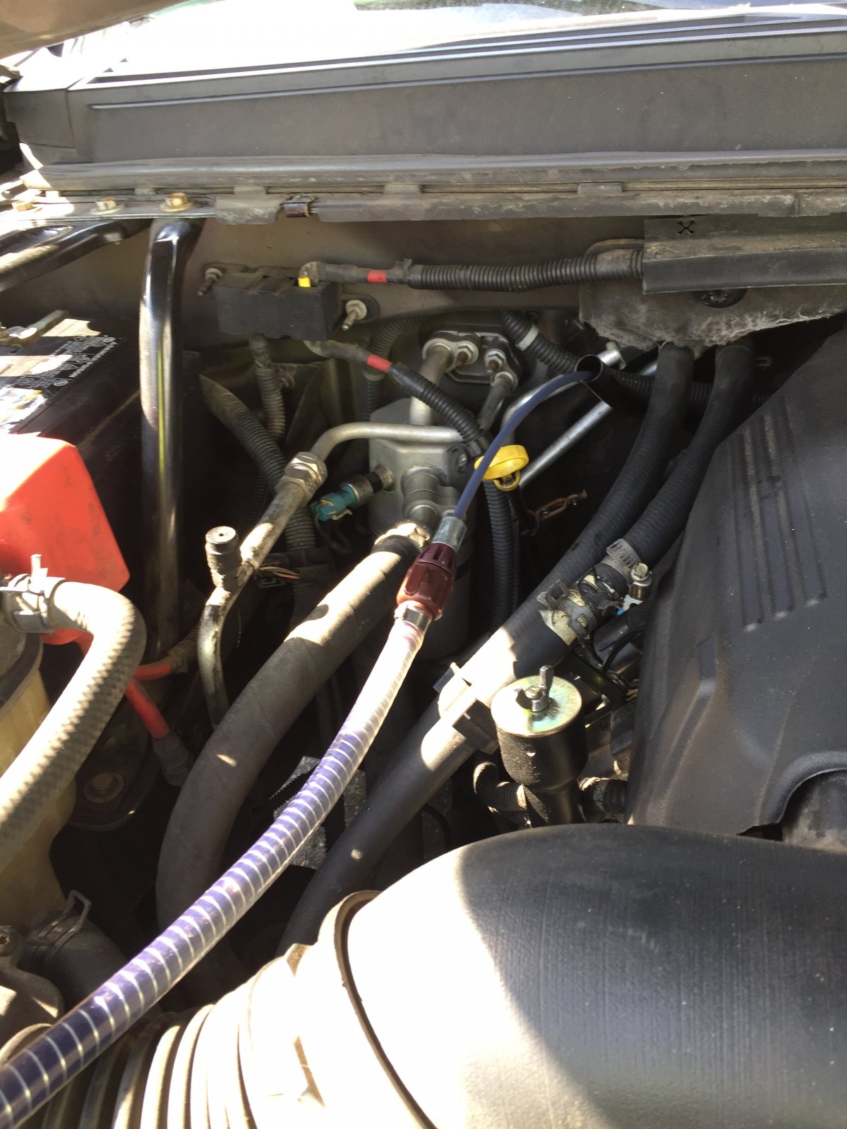

since the filter is changed simply use the flush method with the trans return line, It is to simple not to do it this way and the most effective method of fluid exchange.
The only reason I dont like this method is:
1) It requires 2 people
2) There is a danger zone where the fluid is almost out and you can over suck the fluid causing possible problems with tranny. People say to stop when you see the bubbles but what if someone goes too far?
3) the clip that holds the line in can get lost and a little hard to remove/reinstall
4) Opinion: Higher risk for damaging tranny since you are removing fluid while transmission is running?
The only benefit of this process is that it is way faster and probably gets out more fluid at a time than the way I suggested. Would this info be accurate?
Going both routes, the cooler line process takes less than 30 seconds I believe. Its super quick! The Harbour freight pump takes a good 5-10 minutes which feels like an eternity and you are pumping the whole time nice and slow. So you working and waiting what feels like way longer.
The Mytec pump would be way faster and best of both worlds but also the most expensive option.

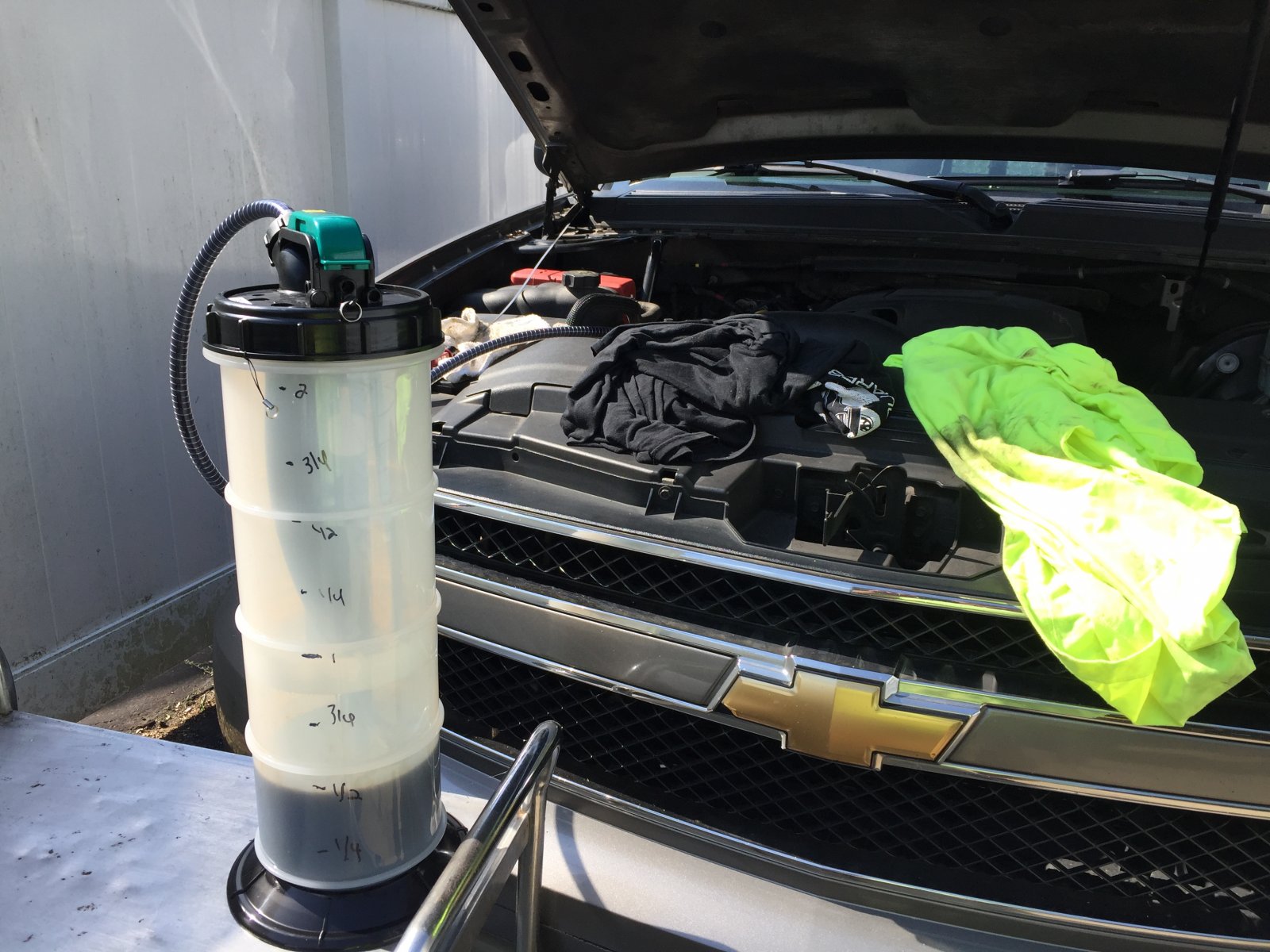

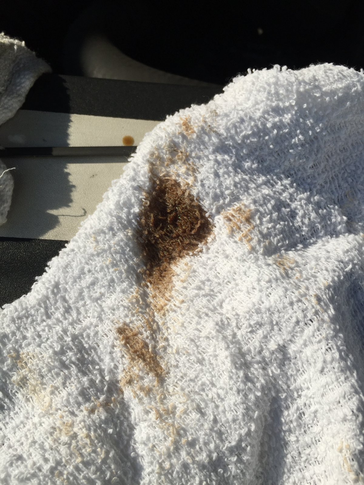

Ok here is my fluid in a clean rag. :oops:
89Suburban
Bull in the china shop
Space X Supporting Member
Jan 10, 2013
18,084
51,467
SE PA

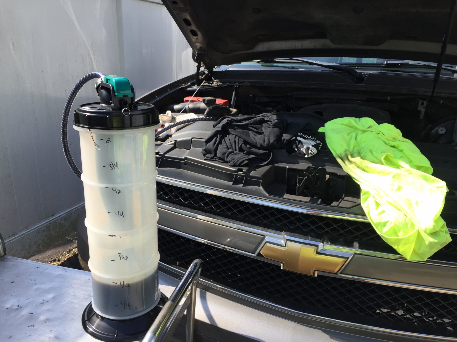

Ok we’ll see if she grenades or not. Did 3 quarts.

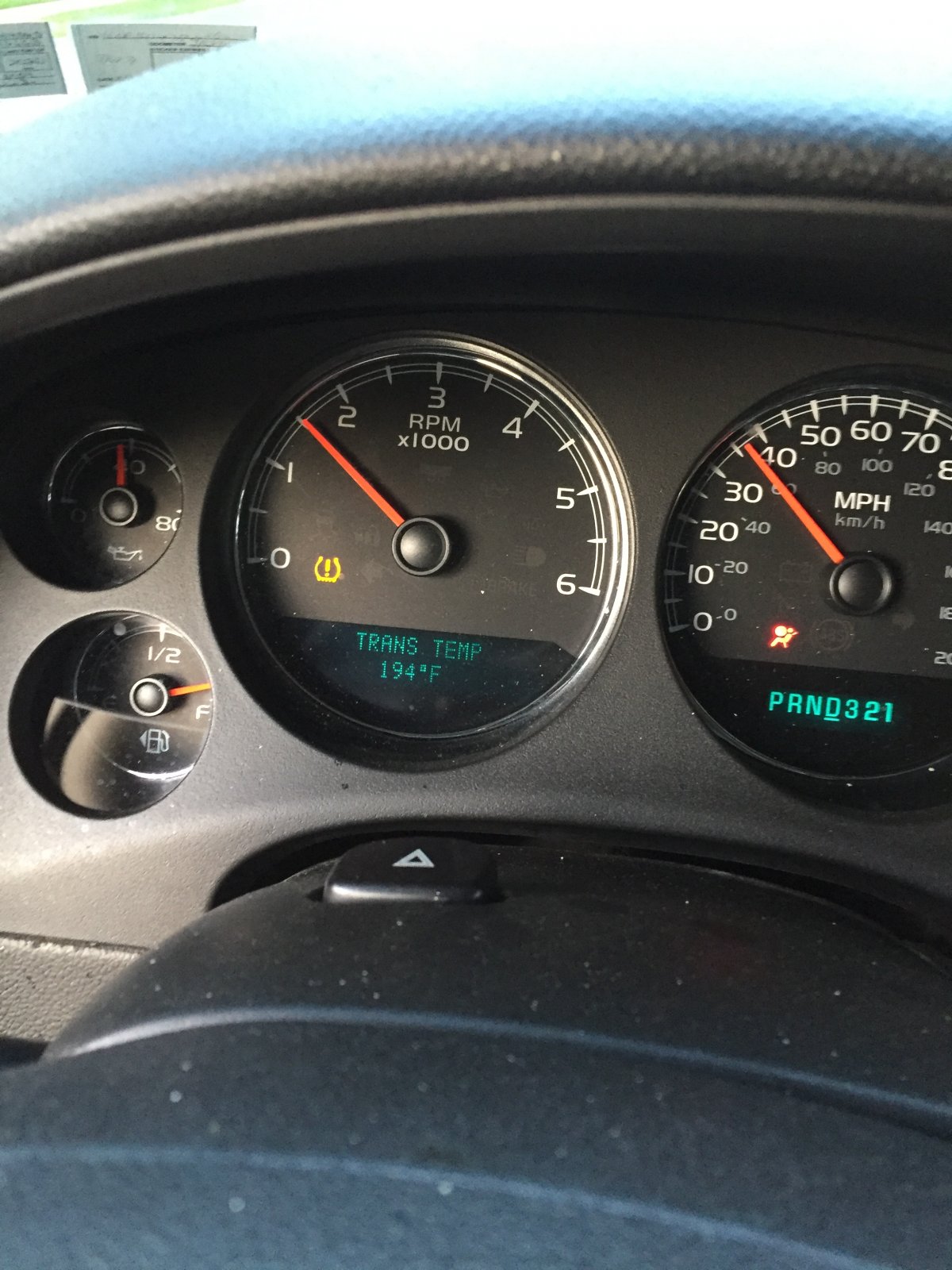

Trans temps towing the boat up the highway after changing those 3 quarts out.
cfmistry
Dec 5, 2018
249
424
Wow that's amazing. I'm getting up to 205F without any load!!
