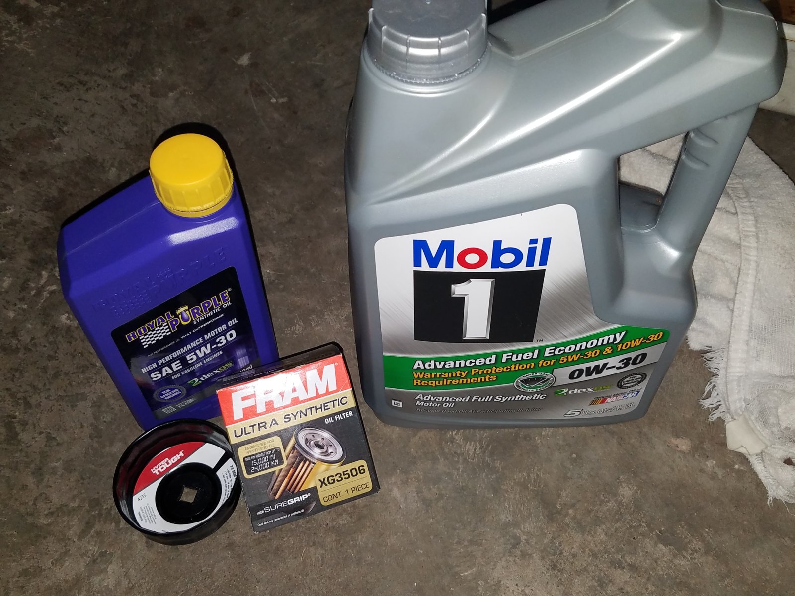

I was doing my monthly wallyworld getting oil change essentials and saw in the clearance wrack, Mobil 1 0/30 warranty protection oil.
It said gm approved with some part numbers, and good for 0, 5, or 10/30 oils..
It was 5 bucks cheaper than the high mileage Mobil 1, and for the sixth quart I got quart of royal purple 5/30.

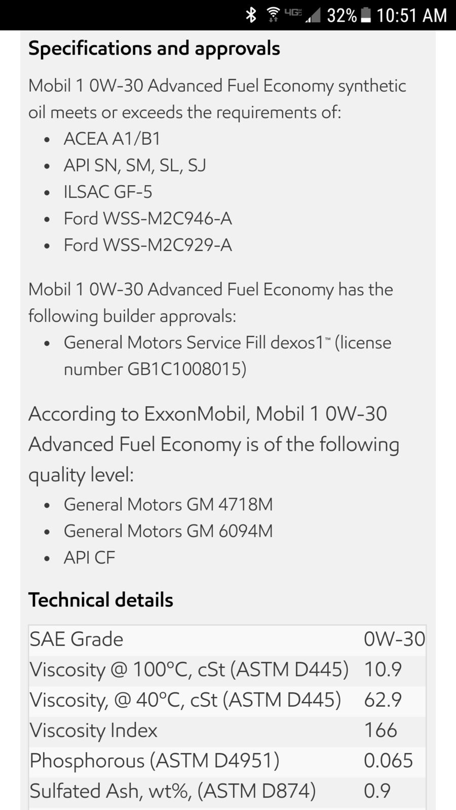

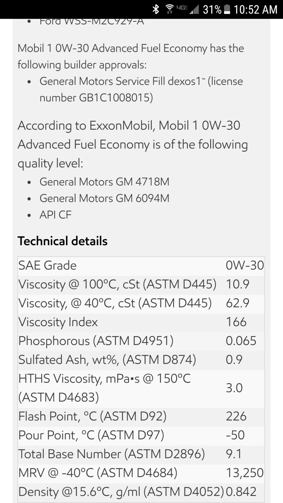

I use 0w30 M1 ESP in mine
It's actually a bit on the thick side at temp for a 30 weight but has desirable cold flow characteristics
