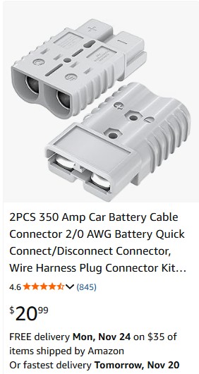

I run a two-battery setup, and I use the second battery strictly as a 'just in case' spare. Is this the use case that you are trying to achieve?
The second battery sits in the second battery tray, and I have cables connected to the main fuse plate, prior to the main fuse, and to the engine ground. with high amperage quick disconnects. Occasionally, I quick connect the second battery for a day, just to keep it charged up.
