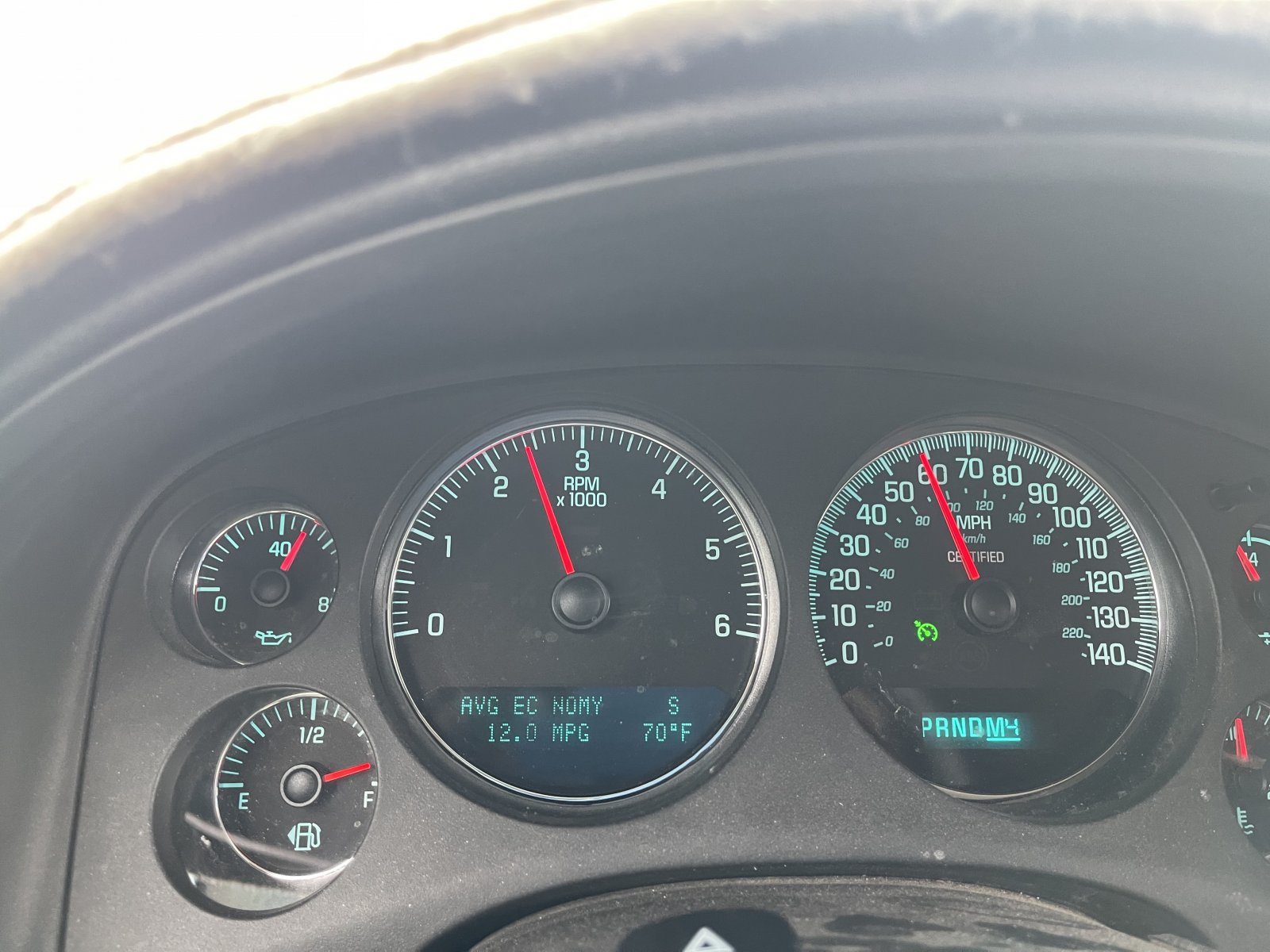

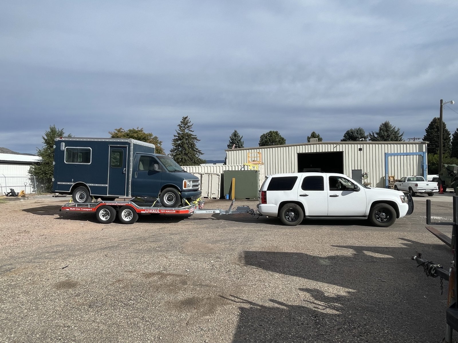

Well, I have a habit of not getting outbid on GovDeals. I just picked up my 5th vehicle this year. Rented a Uhaul toy hauler trailer. I do like the trailer, don’t like surge breaks, but that is because of my own fault.
So, you know the weight limit is 8600 lbs. is that when the car is loaded or unloaded? Wink wink…… drove from Phx to southern CO with an empty trailer 11 hrs there, pretty much stuck it at 75 the whole way there.
The return though was a little more interesting. 16hrs to get back. Pretty much was set at 58 mph on the way back. Stopping about every half tank. Depending on the section, I was getting as high as 12mpg down to 9.6mpg. There were only two points where the car temp got to 235 and Tran was 220. One was the pass on I40 from CO to NM. The other was climbing up from Camp Verde heading south on I17 from flagstaff to Phx.
A real trailer and brakes w/ a controller would have made that drive easier and would have driven about 65 on the way back.
So to address the big blue elephant in the room. I based the weight on a uhaul 10 box truck. The trailer was a little more then I though it was at a hair over 3100 lbs. the trailer was not over weight at all. That being said, I am guess that Tahoe was probably 2 or 3 hundred pounds heavy. Will I do that again, nope. The blue truck can tow more anyways……

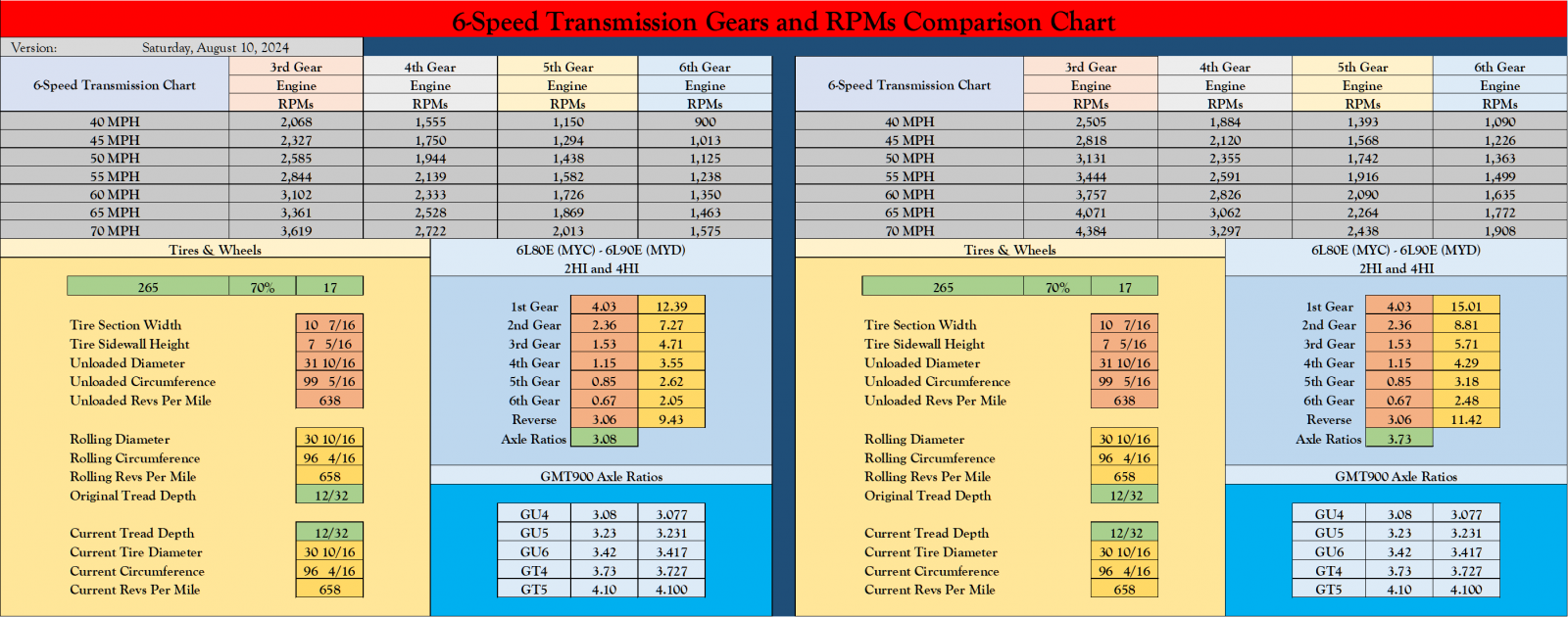

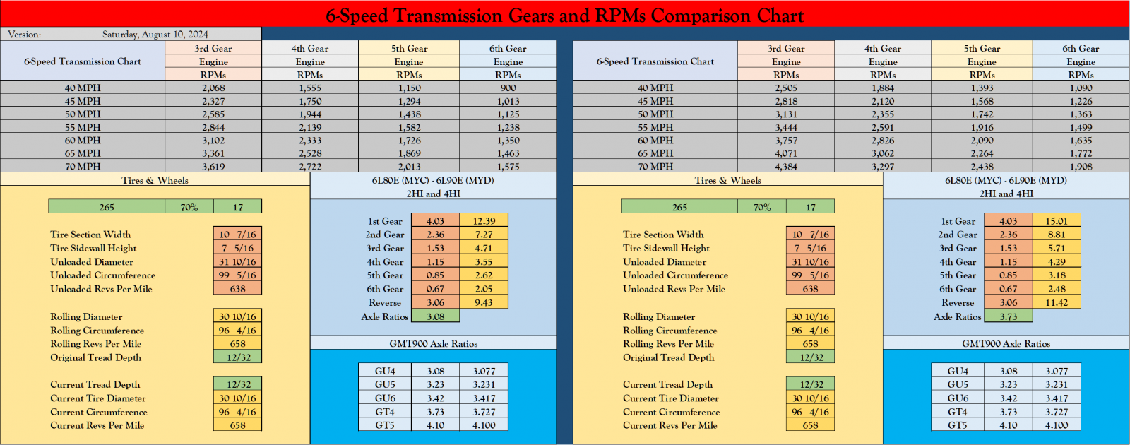

I still don't understand why being in 5th gear with 3.73 vs 4th gear with 3.08 at the same rpm would make any real world difference? overall the same thing and less gear multiplication done in the tranny usually means less heat and less power loss. why they used to always tell people to tow in 1:1 tranny gear.
I just towed thru the mountains with a 3.08 gear, not the rockies and not the big air brake he did. but I honestly don't see why a 3.73 would have helped anything other than raise the rpm when cursing in flat ground at 70.
Marky Dissod
Mar 3, 2023
4,230
6,170
(718)-
... still don't understand why being in 5th gear with 3.73, vs 4th gear with 3.08, at the same RpM would make any real world difference?
OK, 6L80E, 32" tires, 2125RpM ...
3.73 * 0.852 = 63MpH
3.08 * 1.152 = 57MpH
The 3.08 will likely need to downshift to 3rd to accelerate if towing heavy (unless it's a 6.0L or 6.2L)
They used to tell people to tow in 4L60E's 3rd because GM had a bad habit of weak@$$ axle gears to try to 'game' the CAFE MpG test scoring.
Putting it in 3rd avoids unnecessary 3-4-3-4-3-4 'huntshifting'. Lugging the engine isn't good for the engine either, by the way.
Of course, if one has enough axle gear to avoid huntshifting, both the engine and the transmission will last longer under duress.
A Tow/Haul shift mode (or a well-customized Normal shift mode in some cases) won't increase the tow rating but will prevent excessive huntshifting.
Take note that the 8L90's & 10L80's 2nd gear is roughly equal to the 4L60E's 1st gear. More gear helps the 5.3L when it's time to accelerate, for sure.
('More gear' is also why turbo4cyl & turbo6cyl engines are becoming more common.)
I just towed thru the mountains with 3.08, not the rockies and not the big air brake he did.
On flat ground, not much difference, ok, but hills will make you see why GM's GMT900 2500 & 3500 suvs & pickups pair the 6L80 with either 3.73 or 4.10.
