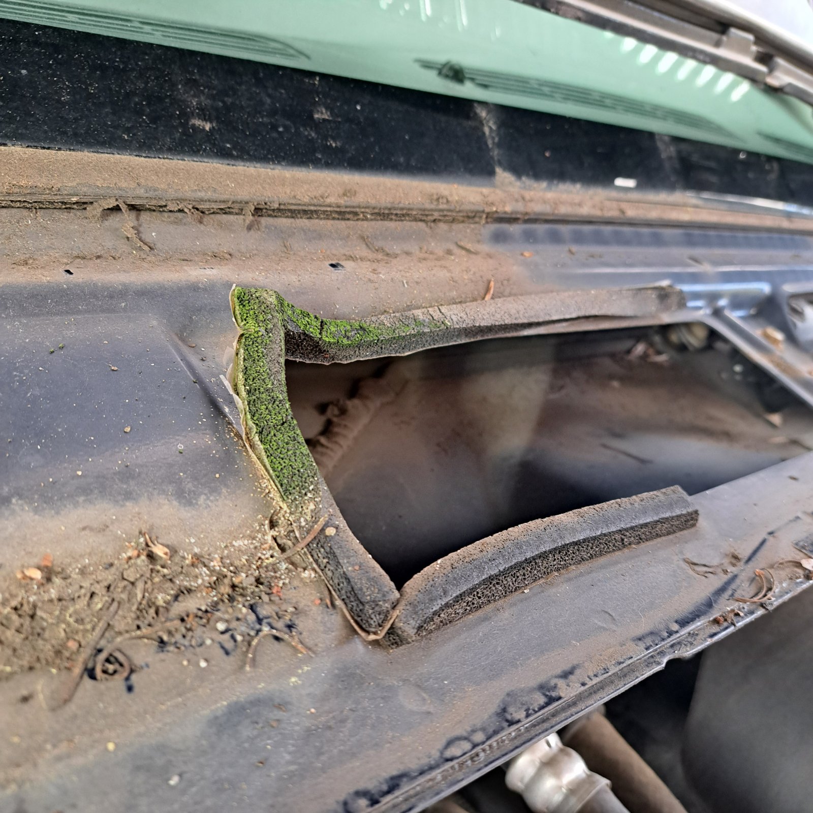

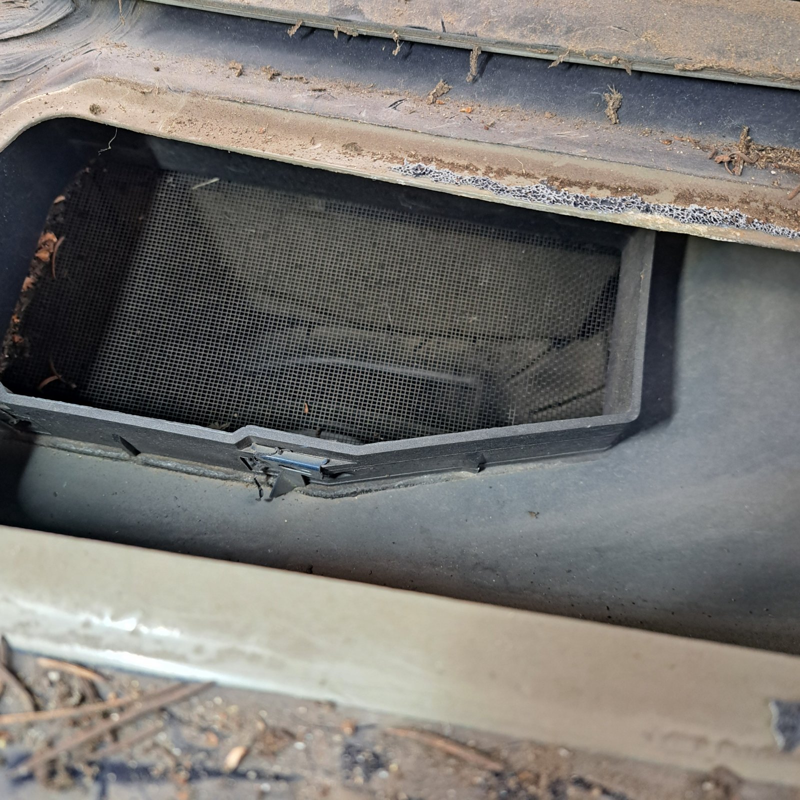

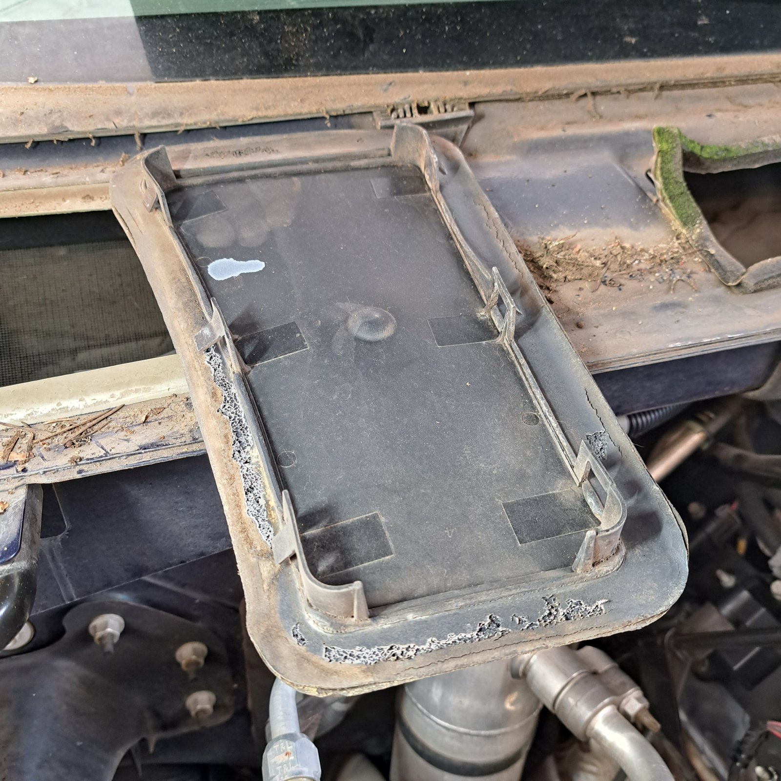

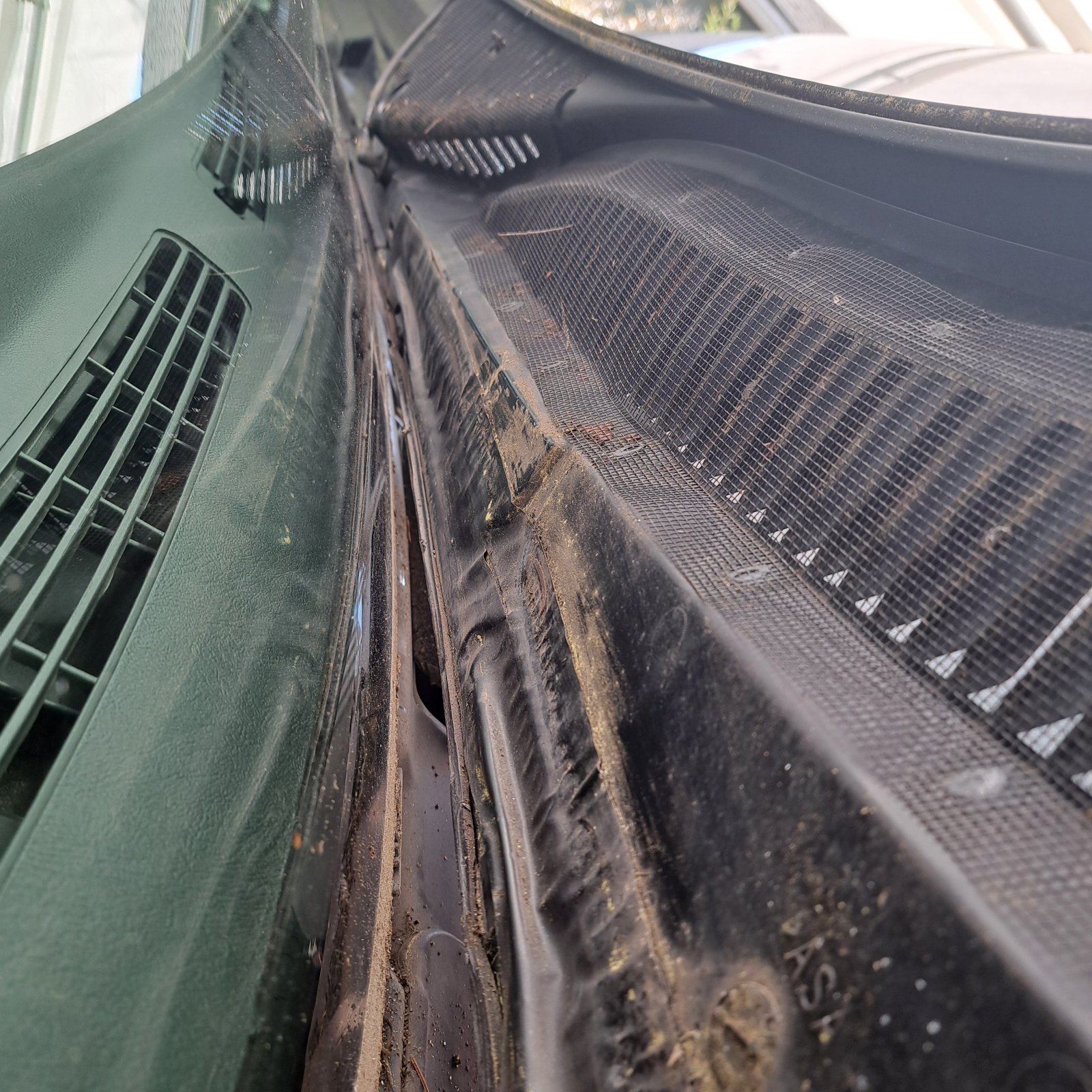

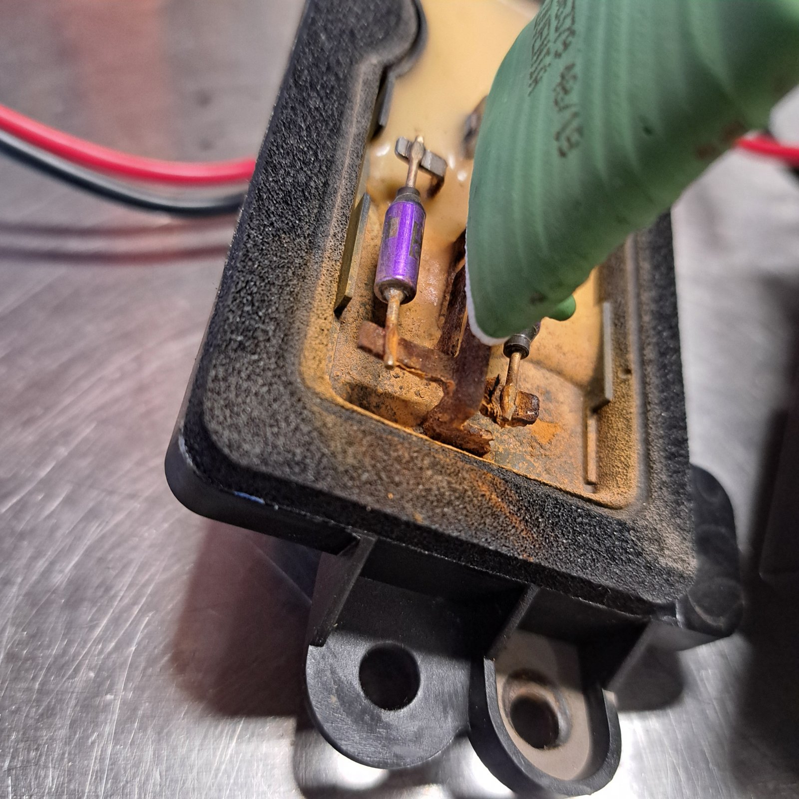

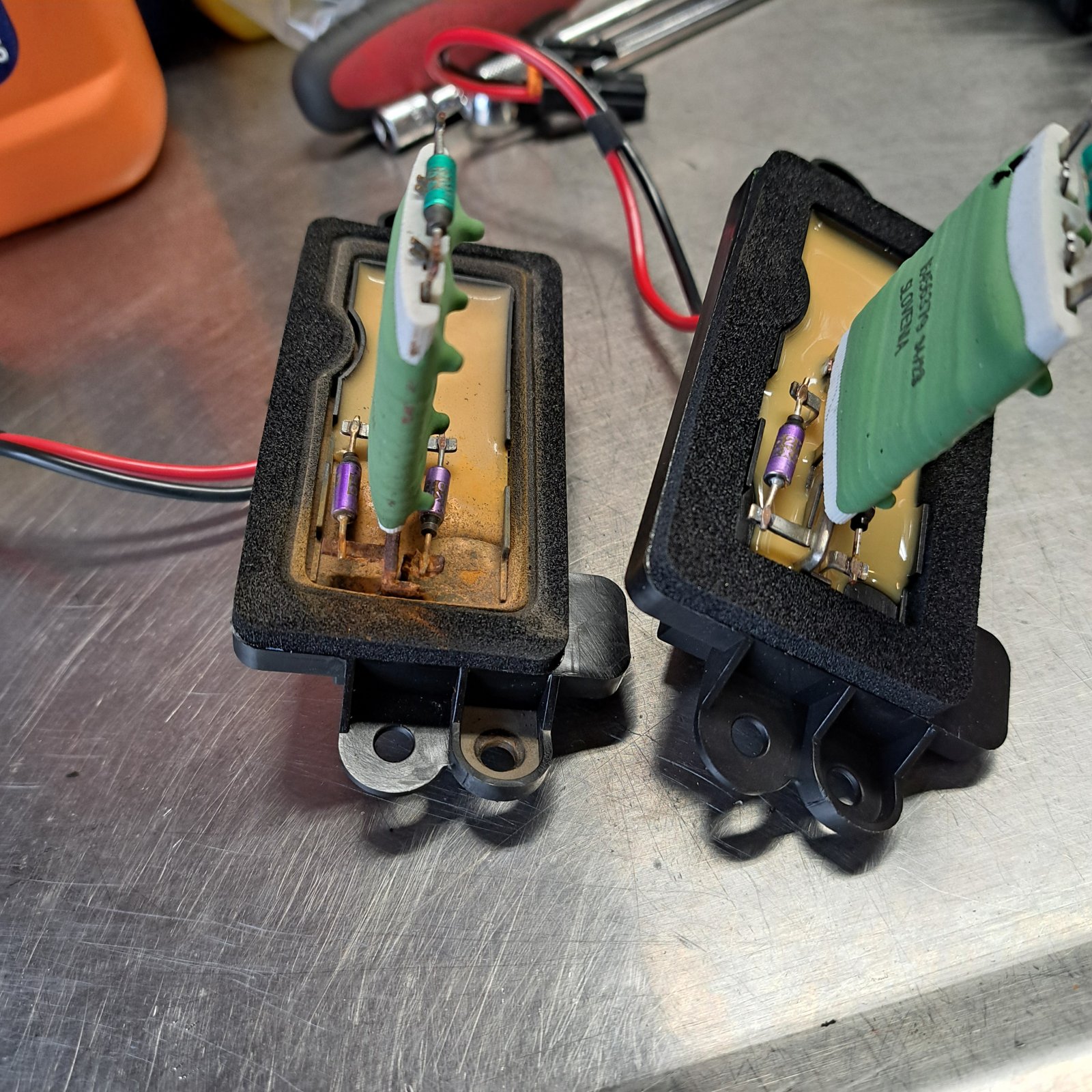

Gonna be a thorough inspection for water leak source, on the 2005 Tahoe LS, above the blower/resistor area. When the wiper arms and cowling cover is removed that exposes a cover that is over a rectangular screened area that feeds ventilation down in to the area above the blower and resistor area. Where that vent mounts, the seal around there deteriorates over time and the cover also breaks down and there is a soft foam seal where it sets on top of the vent hole. There is also another soft foam seal that is exposed, more to the center area, when the cowling is lifted off. At each end of the tunnel under there, where the wiper motor is located, there is a rubber flap that also gets clogged up on the inside and backs up water that should drain out of there. You do not have to remove cowling to access these. It is literally just a rubber flap. Look deep and you can see and reach to them. Pull them back and reach in with a finger and check for debris.
33,341
51,829
If you do that can you take some pics? I'm trying to visualize your description, but I've never been in there. I don't have any leaks--but just in case.

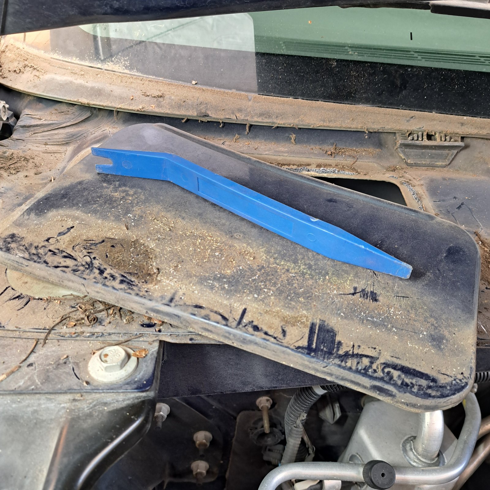

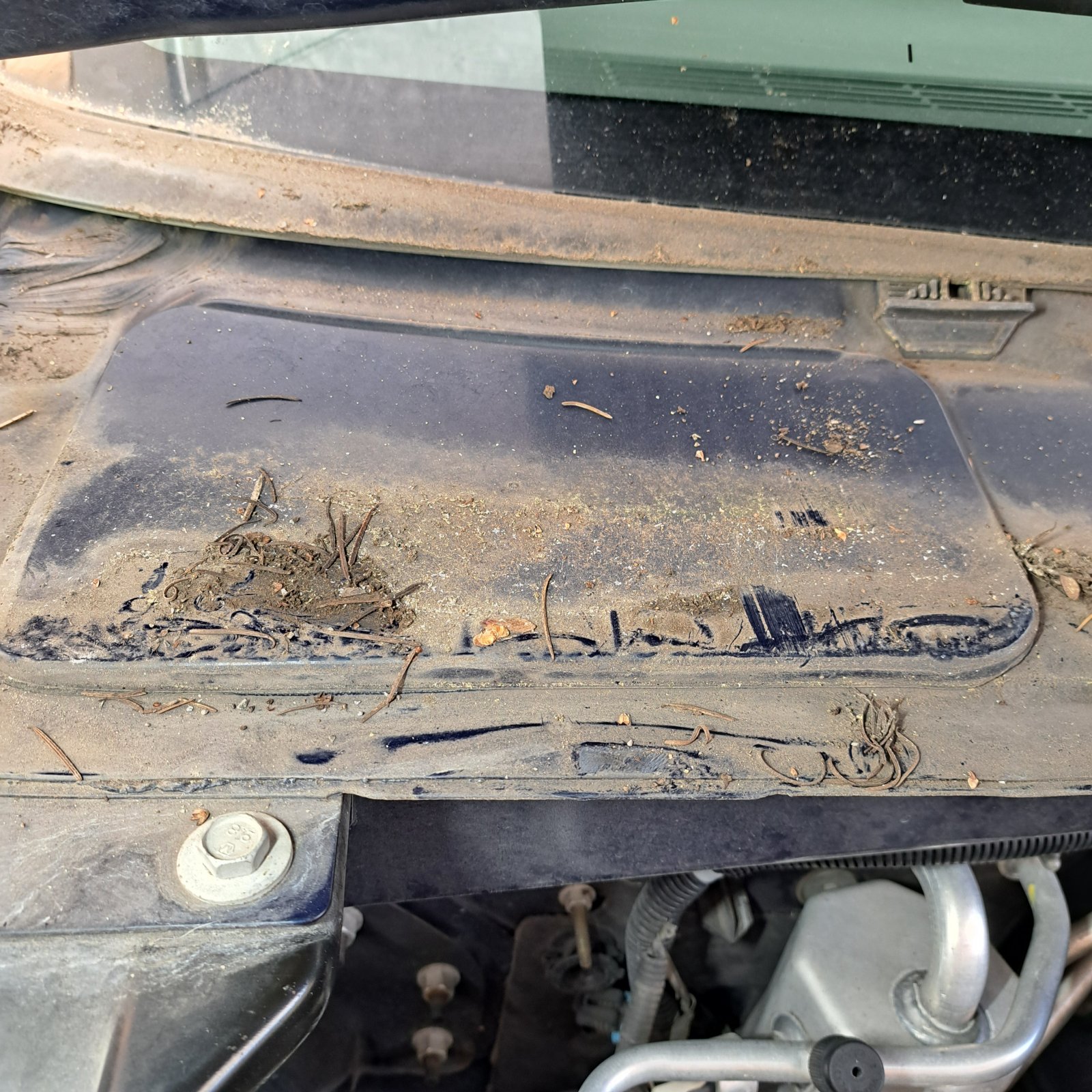

Ok, back at the 2005 Tahoe today. Removed wiper arms and the upper cowl cover. Found the p/s inner most vent hole foam seal was crap. The outer cover, when pried off, seal was crap. The screen cover below it had the spongy foam seal and was wet. You can see the blower motor wheel in pic. Cleaned it all completely. The outer perimeter of the outer vent with the cover, got a good cleaning and sealed with fresh silicone sealant around the whole perimeter. The cover was completely cleaned and sealed and when I pushed it back in place, the extra sealer oozed out and sealed smoothly around the outer perimeter. The inner most vent hole was cleaned and new foam seal installed. The bottom of the cowling cover was completely cleaned so that it would lay against that foam seal. Reinstalled everything. Pulled the blower resistor. Rain the water hose for 20 minutes and watched and felt for water back at the resistor mount hole. Felt dry and saw no water drips. Almost forgot, did check the ends of the lower rails and there was no blockage. You can see one, in the first pic is torn on the p/s. Also, forgot to say that I waited 1 hour before running the water.

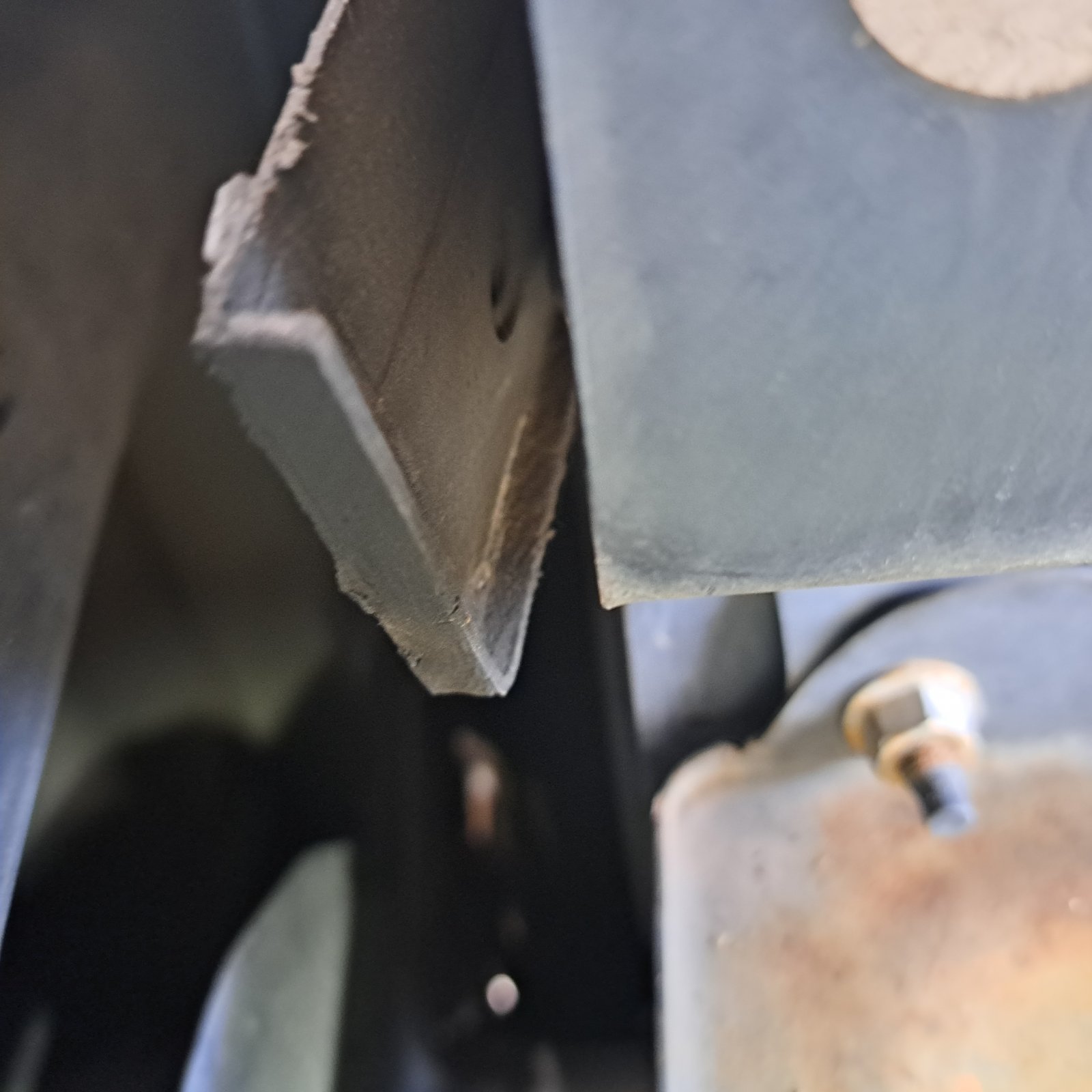

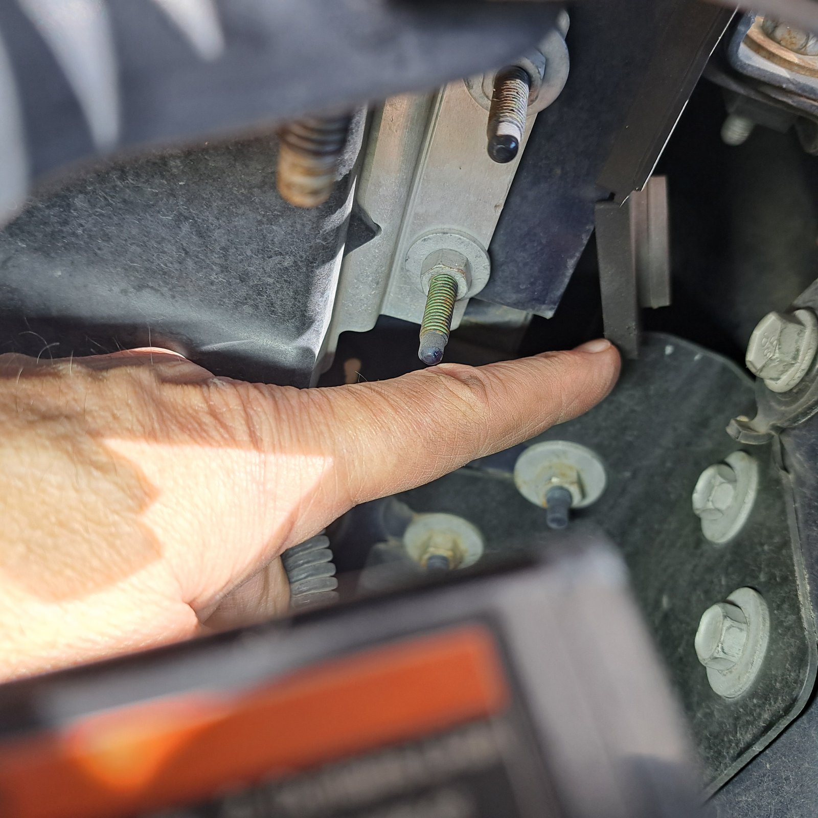

On the same Tahoe, it has hydro-boost brakes and when on a rough enough road or over bumps, there is a rattle noise under the dash on d/s and sounds close to the firewall. I checked and is not the lower collar bearing on the steering column and not the attaching shaft at bottom of column. Did find a lot of play at the upper brake pedal pivot. Has a large horizontal bolt with a threaded nut. Cannot seem to see or feel the other side of it to see if the bolt head is there. I was tired and did not spend a bunch of time digging. Also has P/S fluid seepage at back of hydro-boost at the firewall. See pics of seepage and threaded bolt. Bolt is at top of the pic. Anyone ran in to this before and know anything about tightening the bolt? Is there a bolt head or is it captured? Thanks in advance.

So now, more work in my future on this 2005 Tahoe that I did the door hinge pins on. I found a video that explains EXACTLY the rattle under the dash problem and shows what to do to fix. For info purposes, I have already ordered the bushing, gonna do the brake light switch while is off for bushing access and in my case, I am going to remove the driver's seat for way better access for me. At 6'4" and 280 pounds, I need some room. In the video, that I am supplying the link for, it is also a hydro-boost brake system with the exact same p/s fluid leakage/seepage that I saw on her Tahoe. The video is a Suburban.

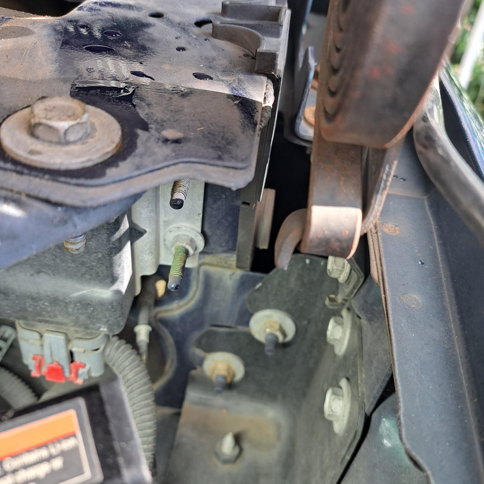

Sorry, no pics, of the 2017 Explorer front brake work. Old pads as thick and clean as the new ones so did not replace them. Replaced both rotors for the warpage problem. #40 torx holds the rotor to hub. Caliper slides pins held in place with 17mm and the caliper bracket bolted on with 18mm bolts. Removed it all, cleaned and lubed thoroughly and Brake Cleaned the new rotor surface and reassembled. Took it on a road test and verified no pulsation at any speed, including highway exit ramp speed. Seated the old pads to the new rotors and the owner was happy. Total time, 1.5 hours.
