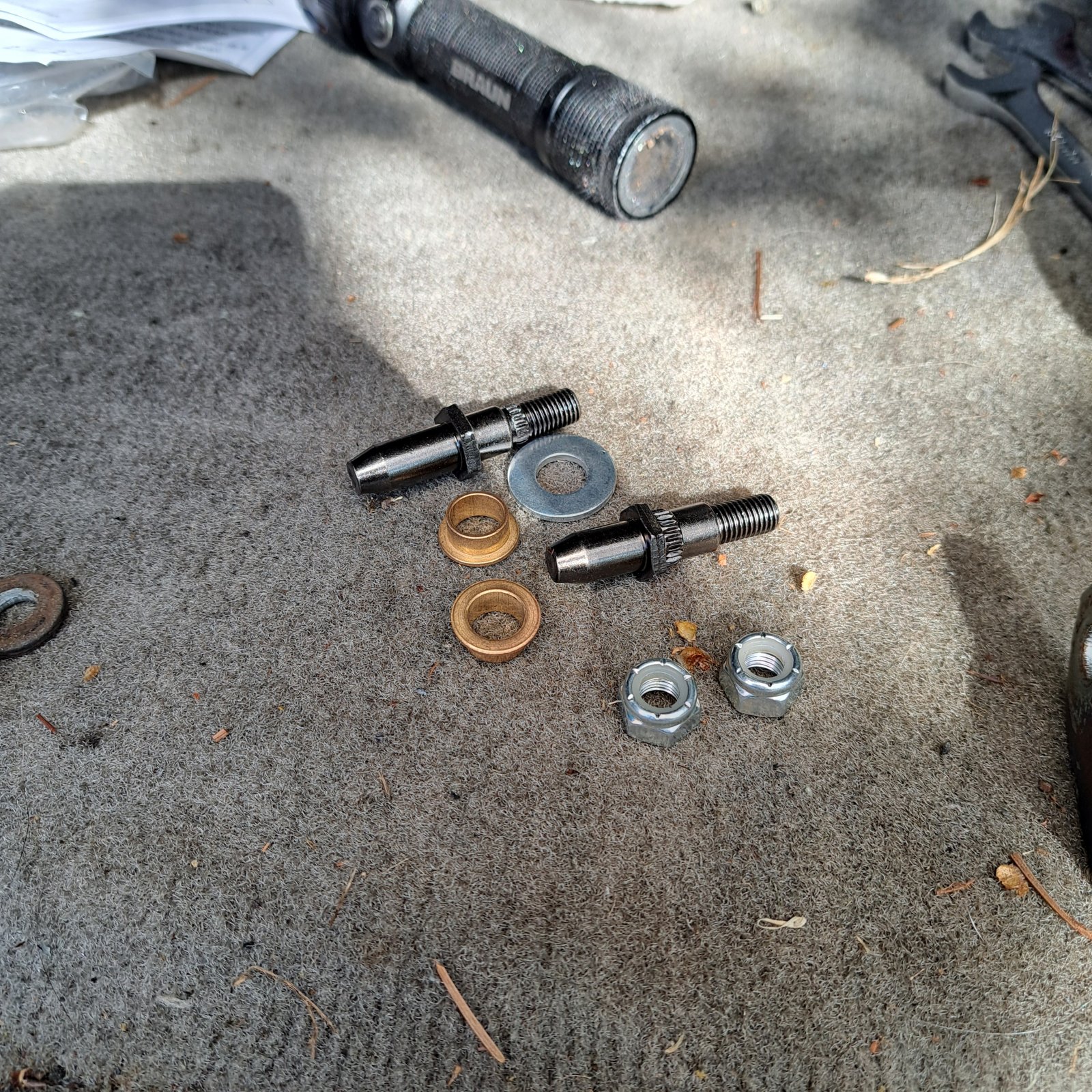

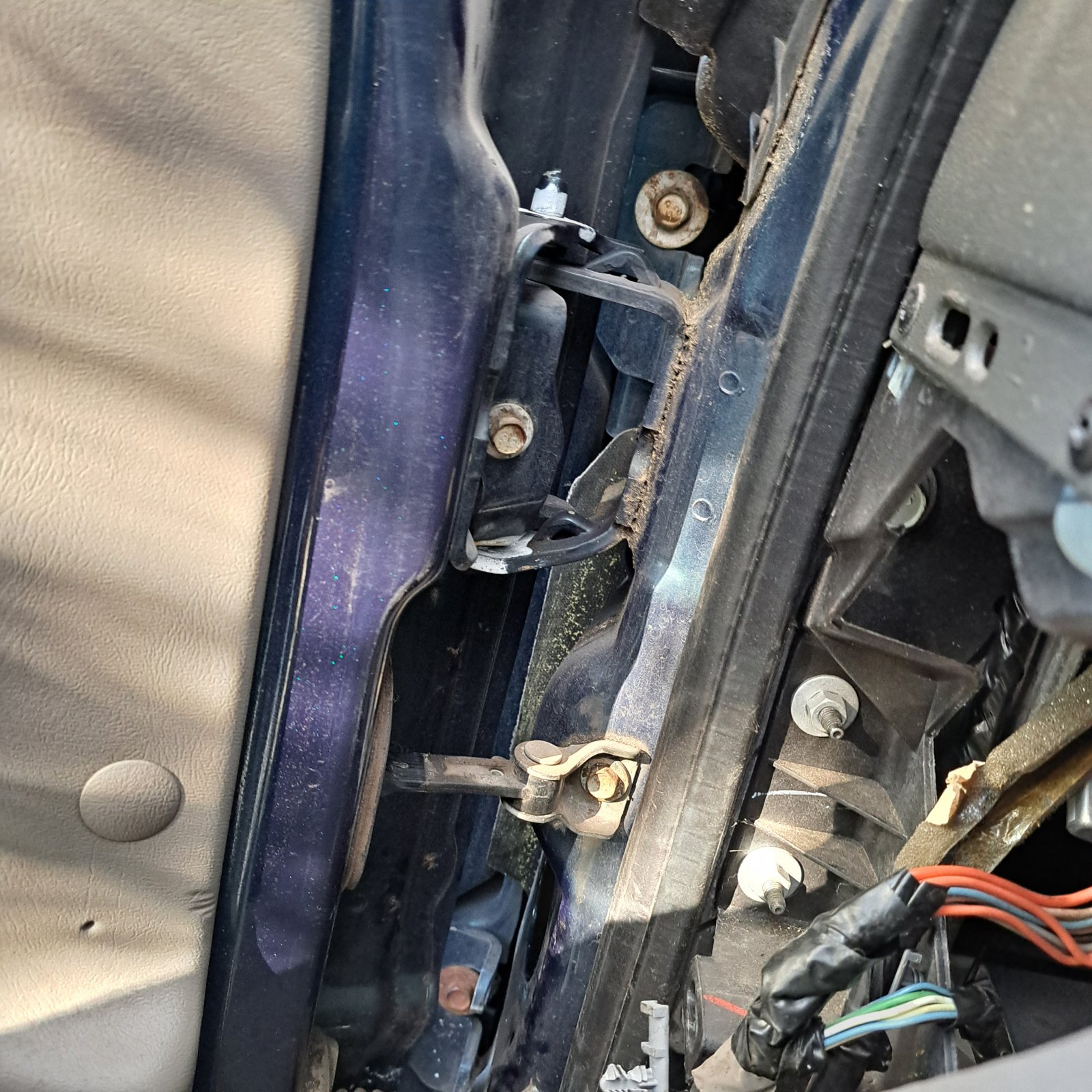

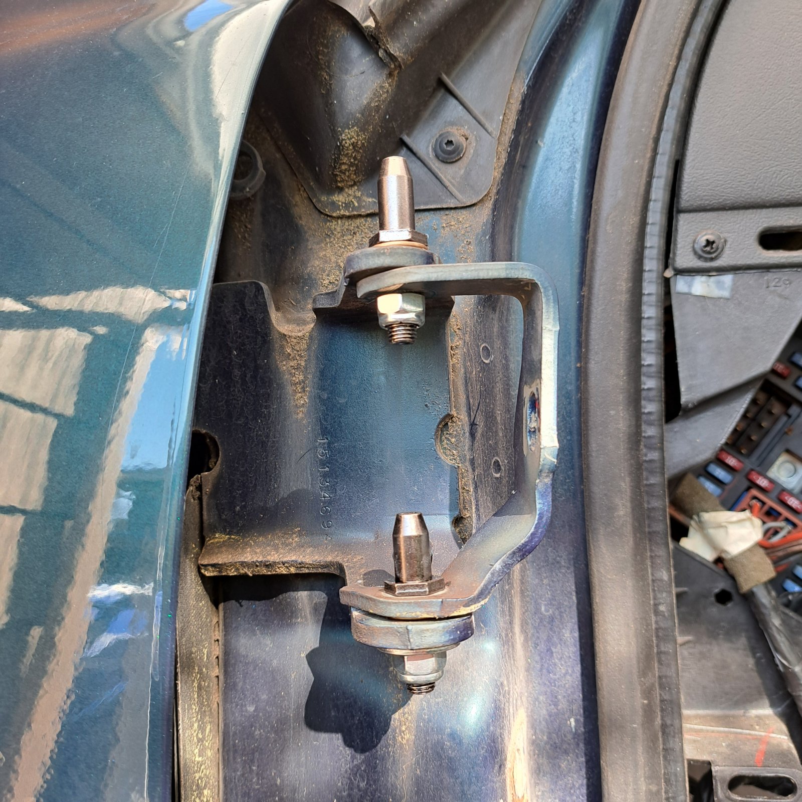

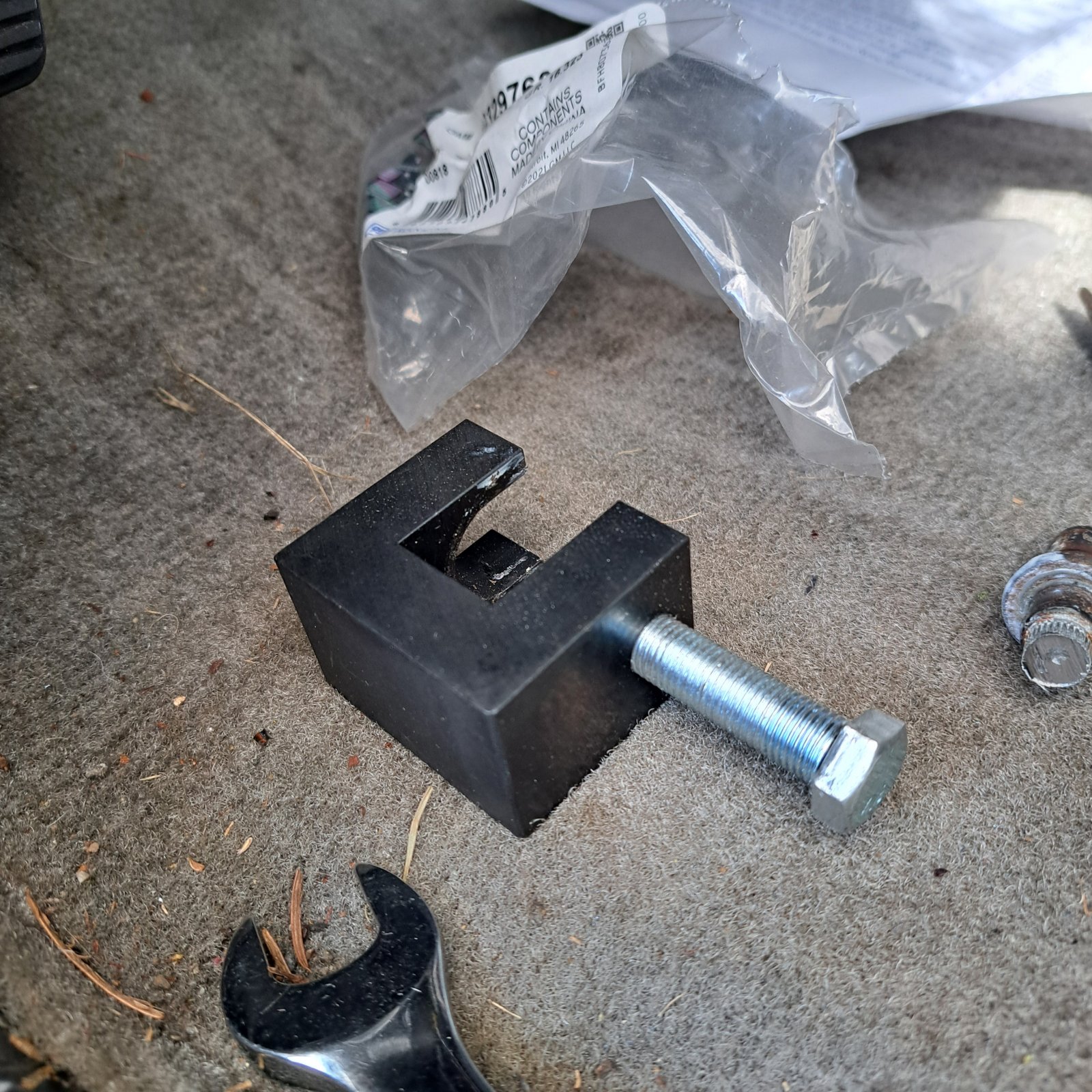

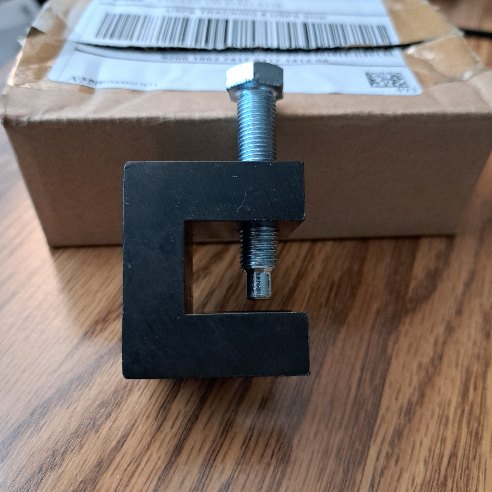

The final special tool I need for the widow of an AL friend that passed, 2005 Tahoe driver's door hinge pins work, is here. Now I can pick a sunny day and schedule the work. Gonna be doing a door latch actuator on the same door and a new blower motor and resistor, as well. Gonna be a busy day, in my driveway, when I do that work. I always like to do the harder job first, so that will be the hinge pins. As before, pics and a write up to follow.
I need to thank the German railroad (Deutchesbahn) for helping fix my Opel Rekord 1700 back in 1980. I friend of mine worked there and he made essentially that tool on Deutchesbahn time so we could replace my door.

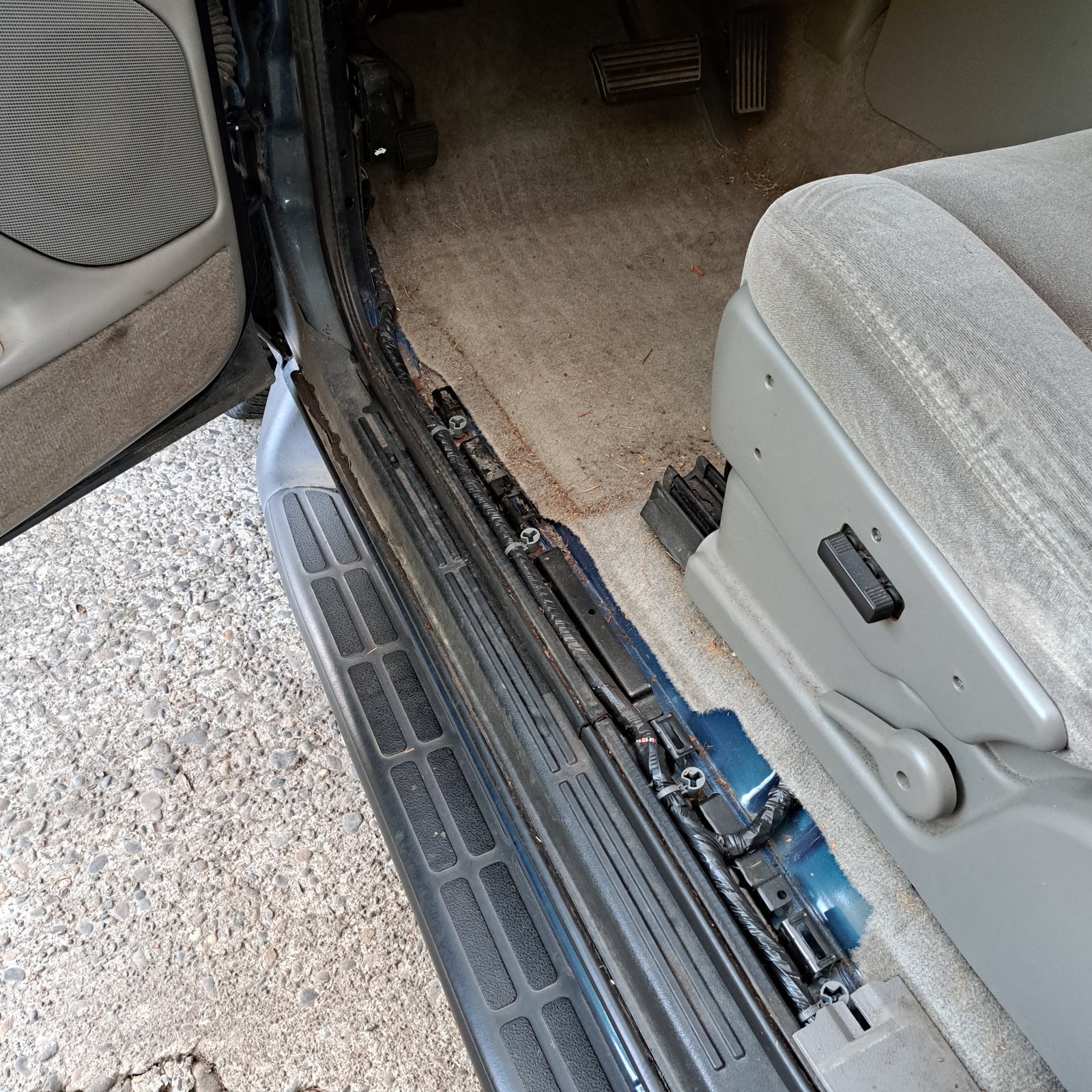

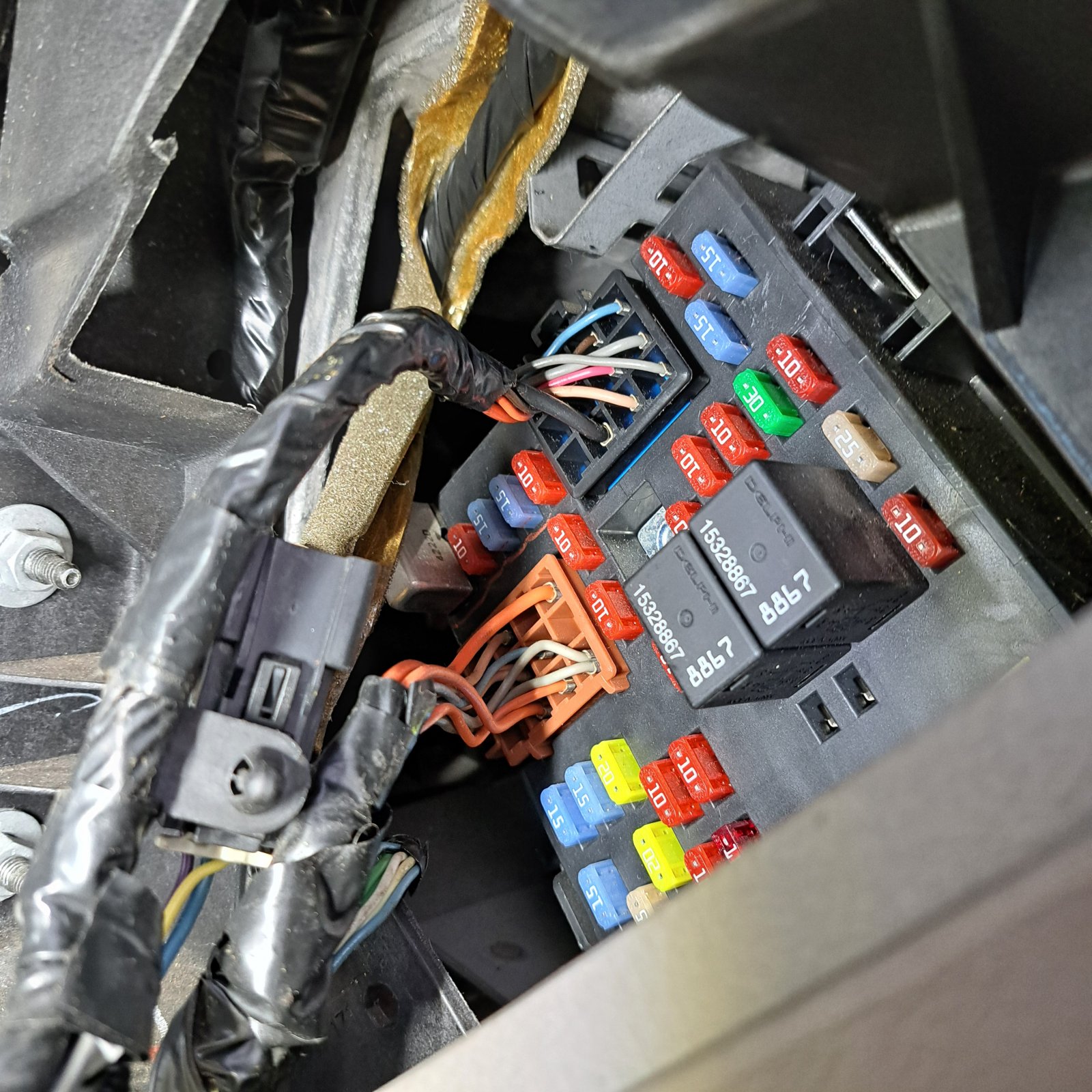

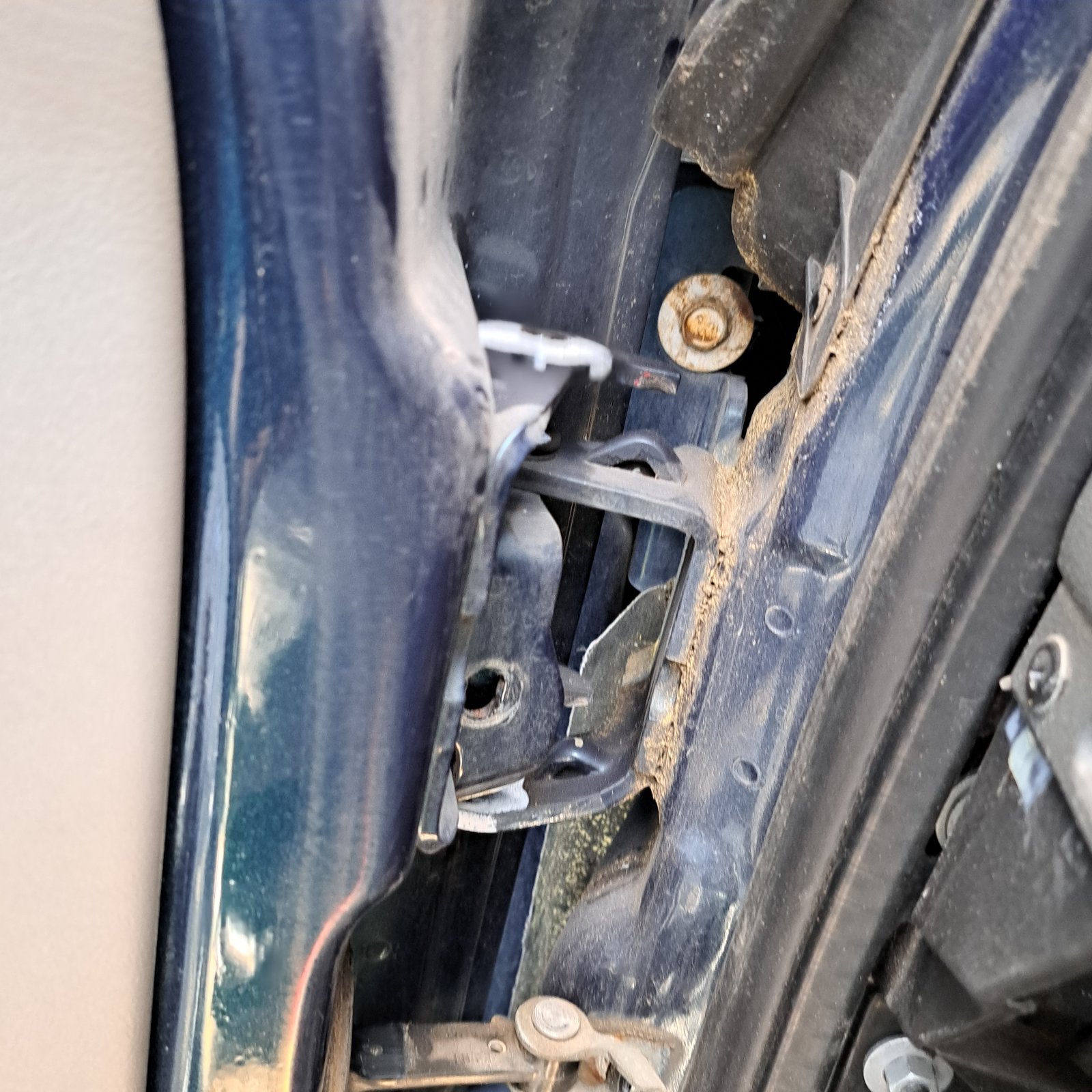

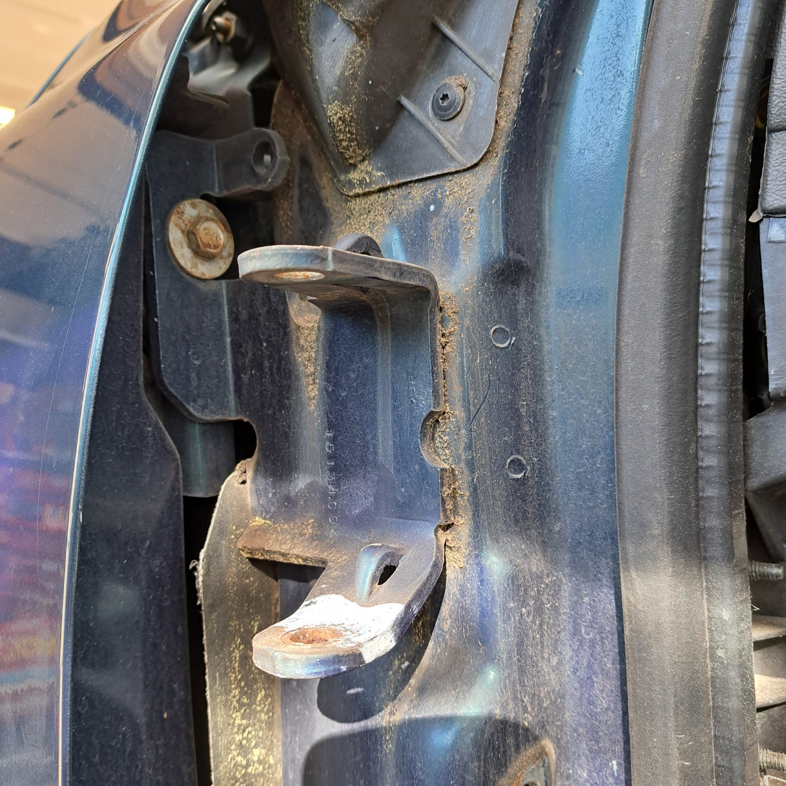

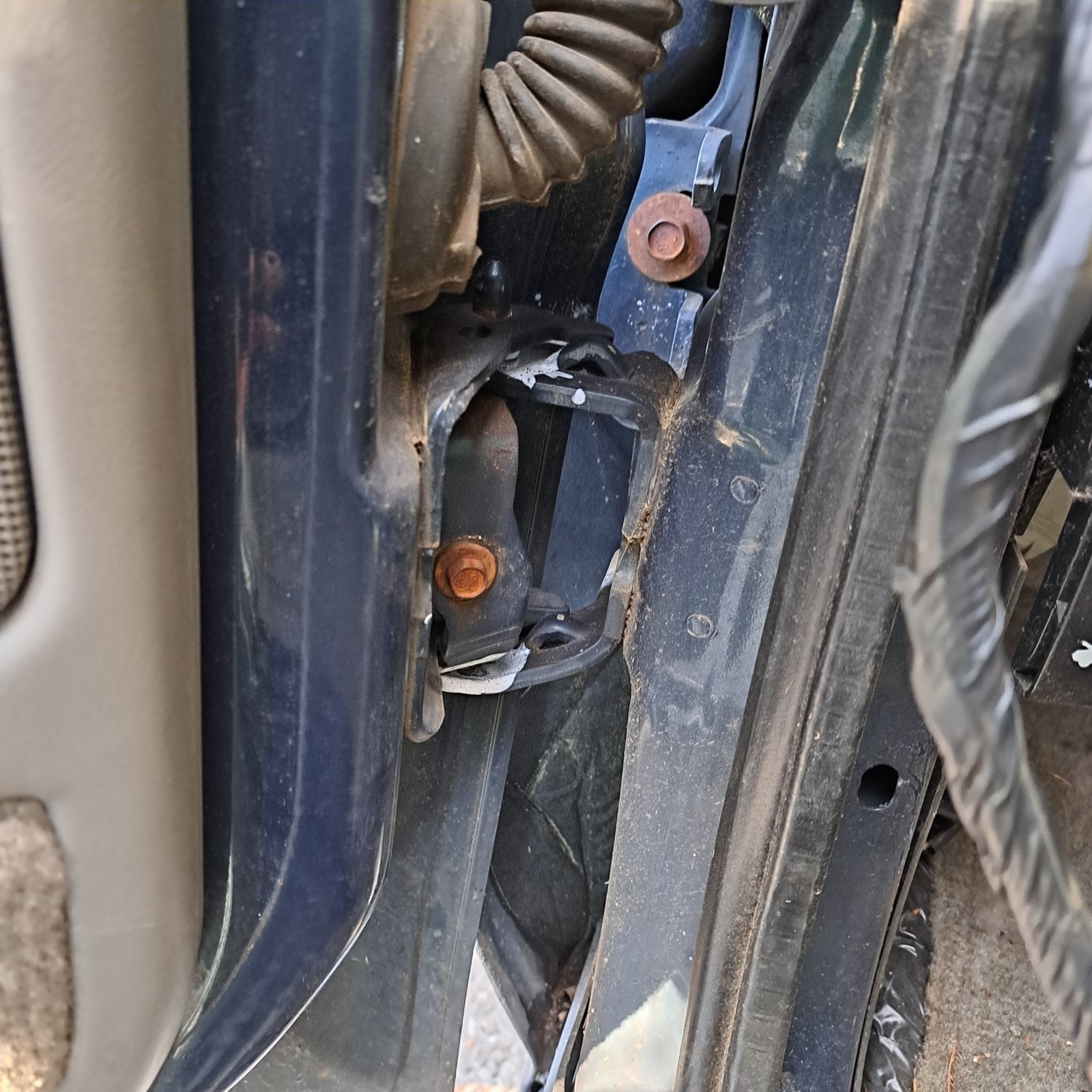

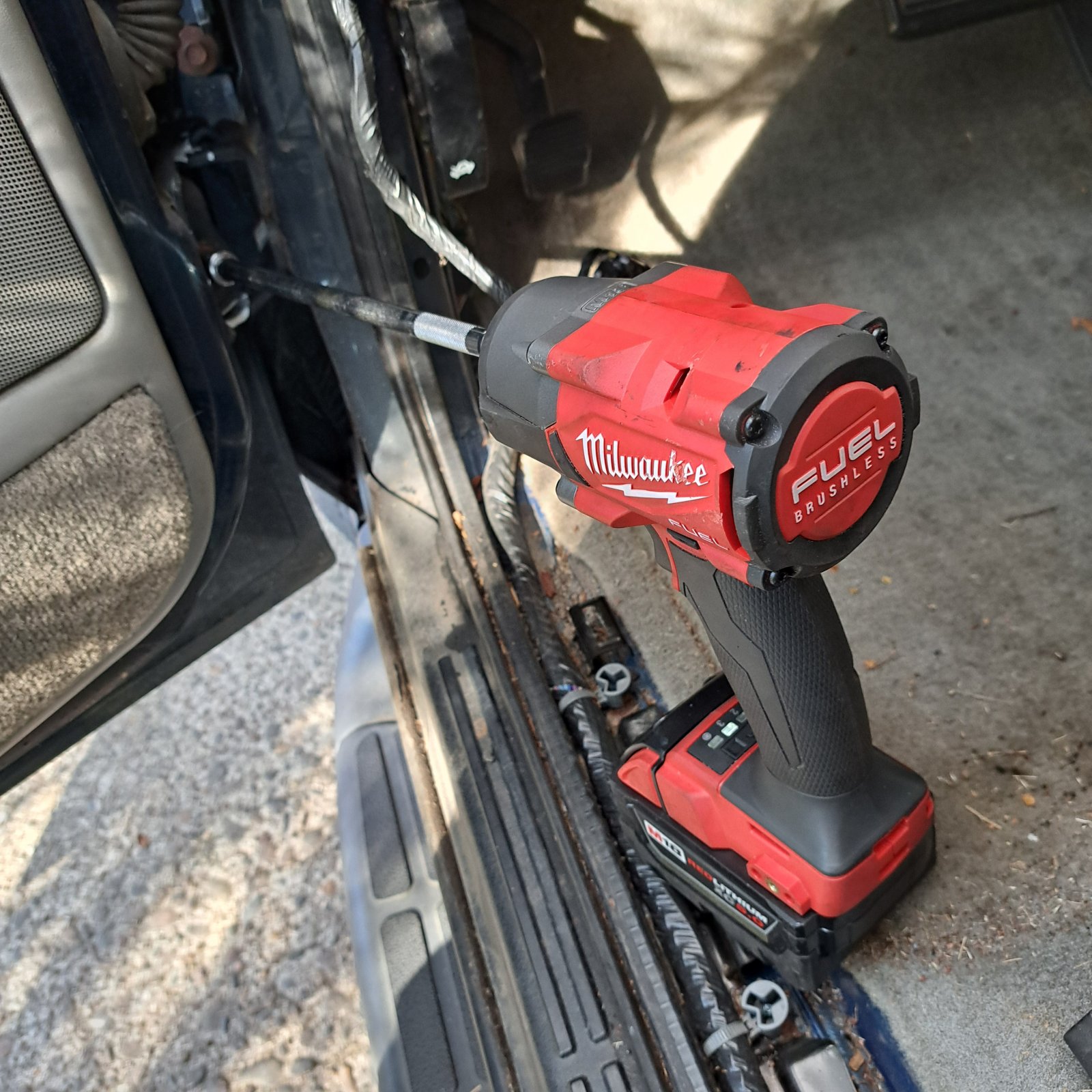

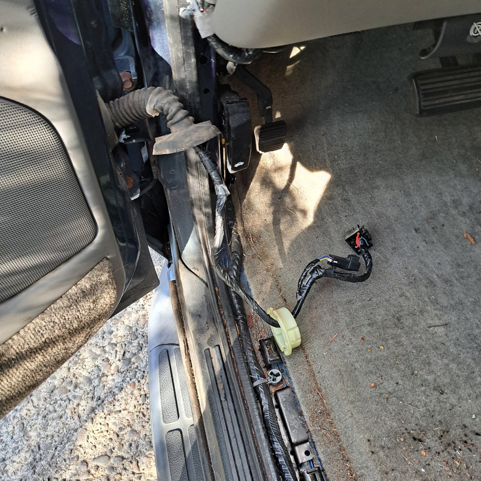

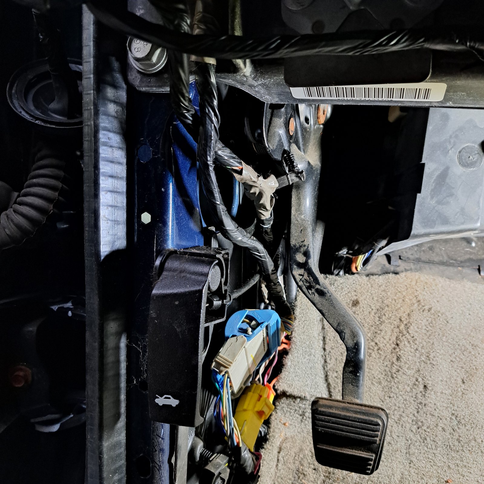

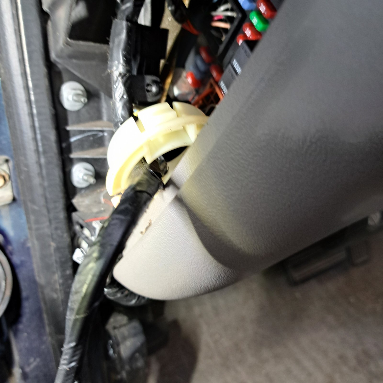

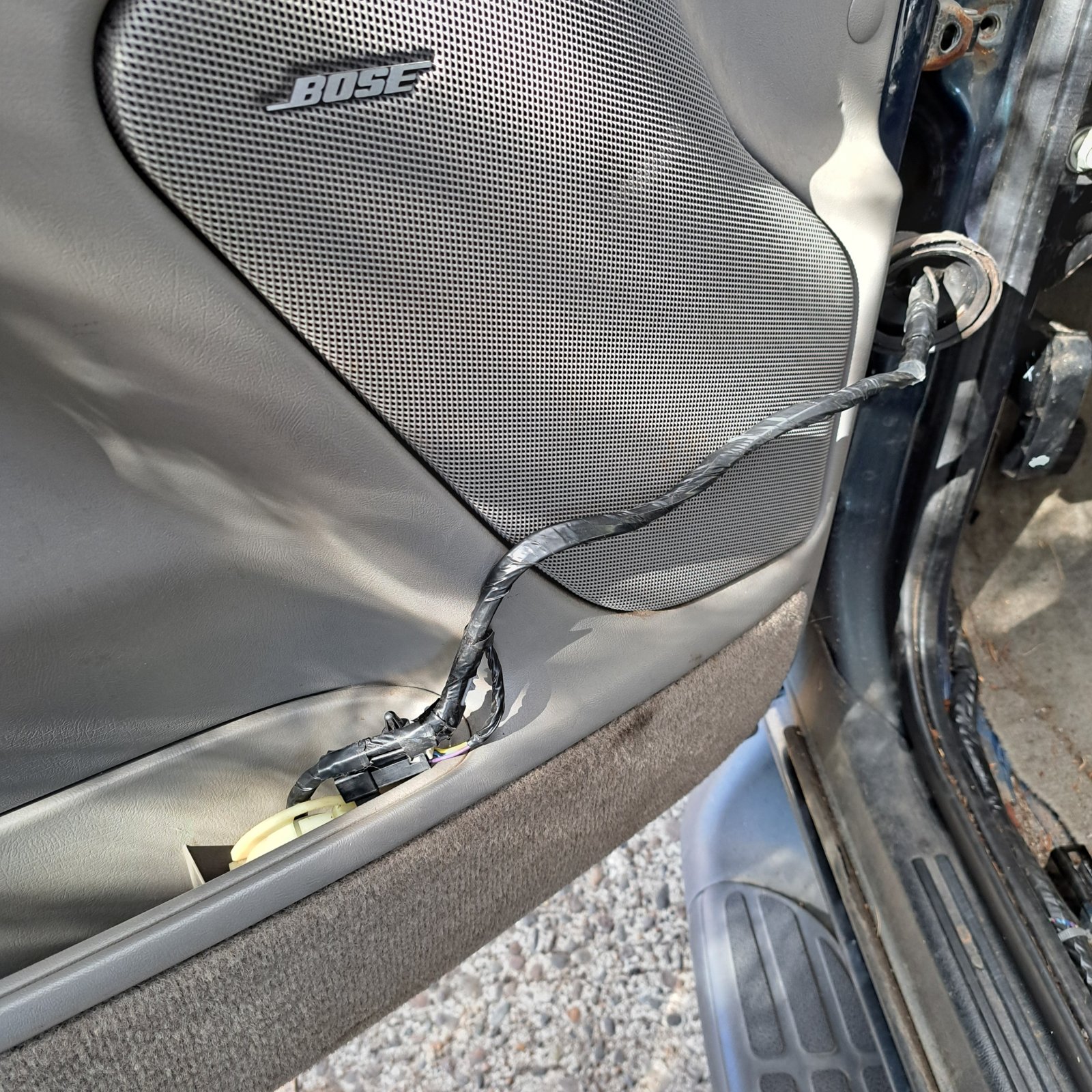

The 2005 Tahoe LS got dropped off at 3 today and then I took her home and came back and removed the door step sill, the kick panel cover and the side dash fuse cover. Located the ONE connector and harness that plugs in at the fuse box, right behind the cover, and then feeds down behind kick panel cover and then thru the hole where from the outside, the rubber boot/umbilical cord attaches. Disconnected and fed it all the way thru and then plugged back in for the night. I will remove hinge bolts and limiting strap bolt and lift the door straight up and off the hinge pins. Then I will be grinding off the swelled bottoms of the pins, 4 of them, use my special press tool to push the old pins out and then bolt in the new hinge pins and rehang the door and feed the wire harness back in and install the kick panel cover, step sill cover and the fuse box cover.
Be aware, if you tackle this job, it is a base LS vehicle. If you are working on an LS with more options, and LT or a Z71, you could have up to 3 harnesses that feed thru that umbilical cord rubber boot.
Then I will be doing the door lock actuator/latch assembly on the same door. These pics are all I did when I got back from dropping her off and spent about 30 minutes on where I am at now. You should notice the harness connector is plugged back in till in the morning.

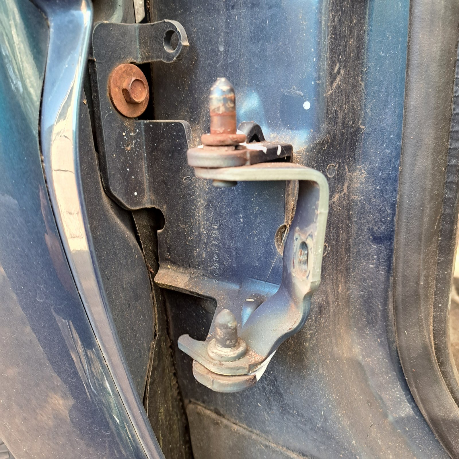

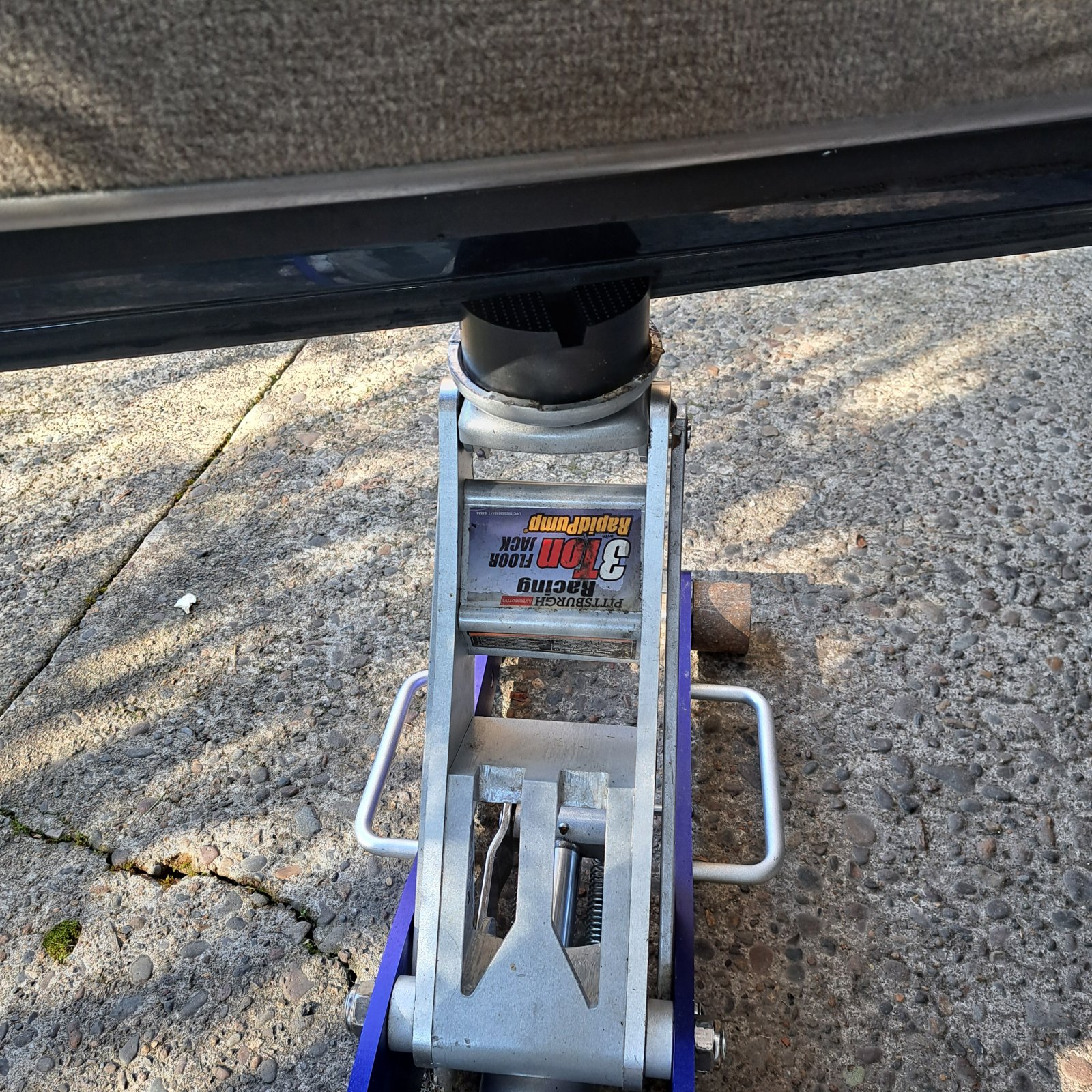

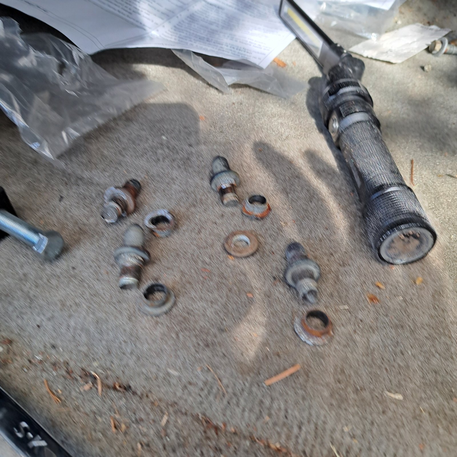

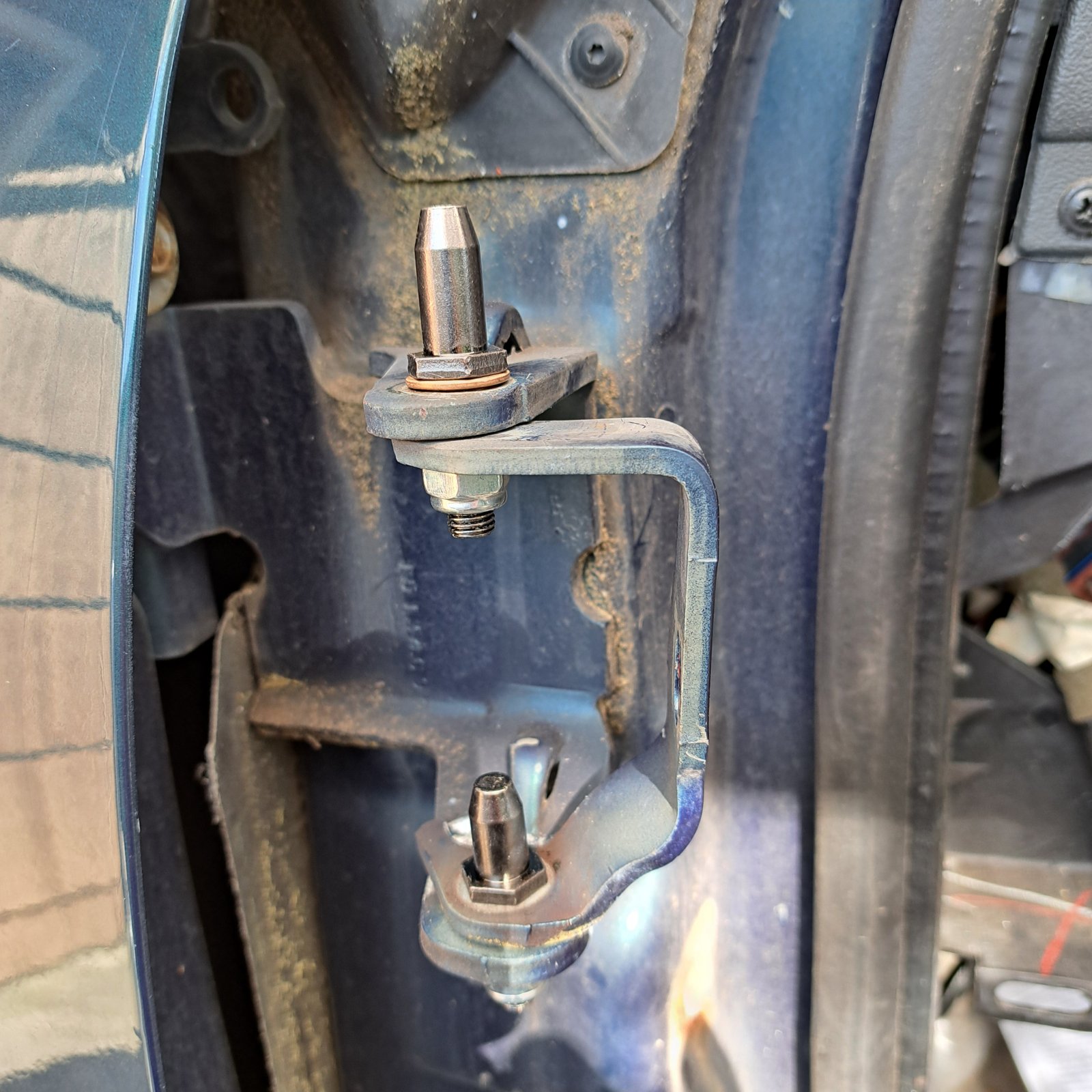

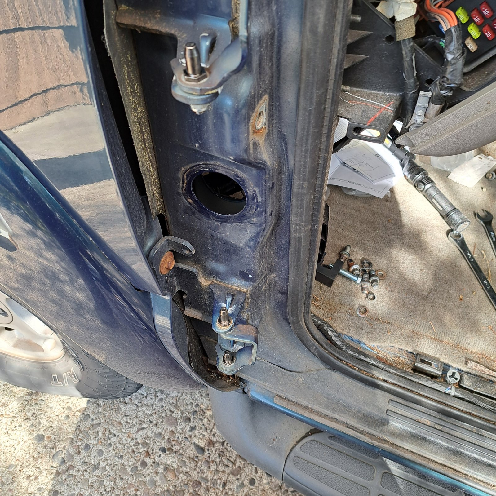

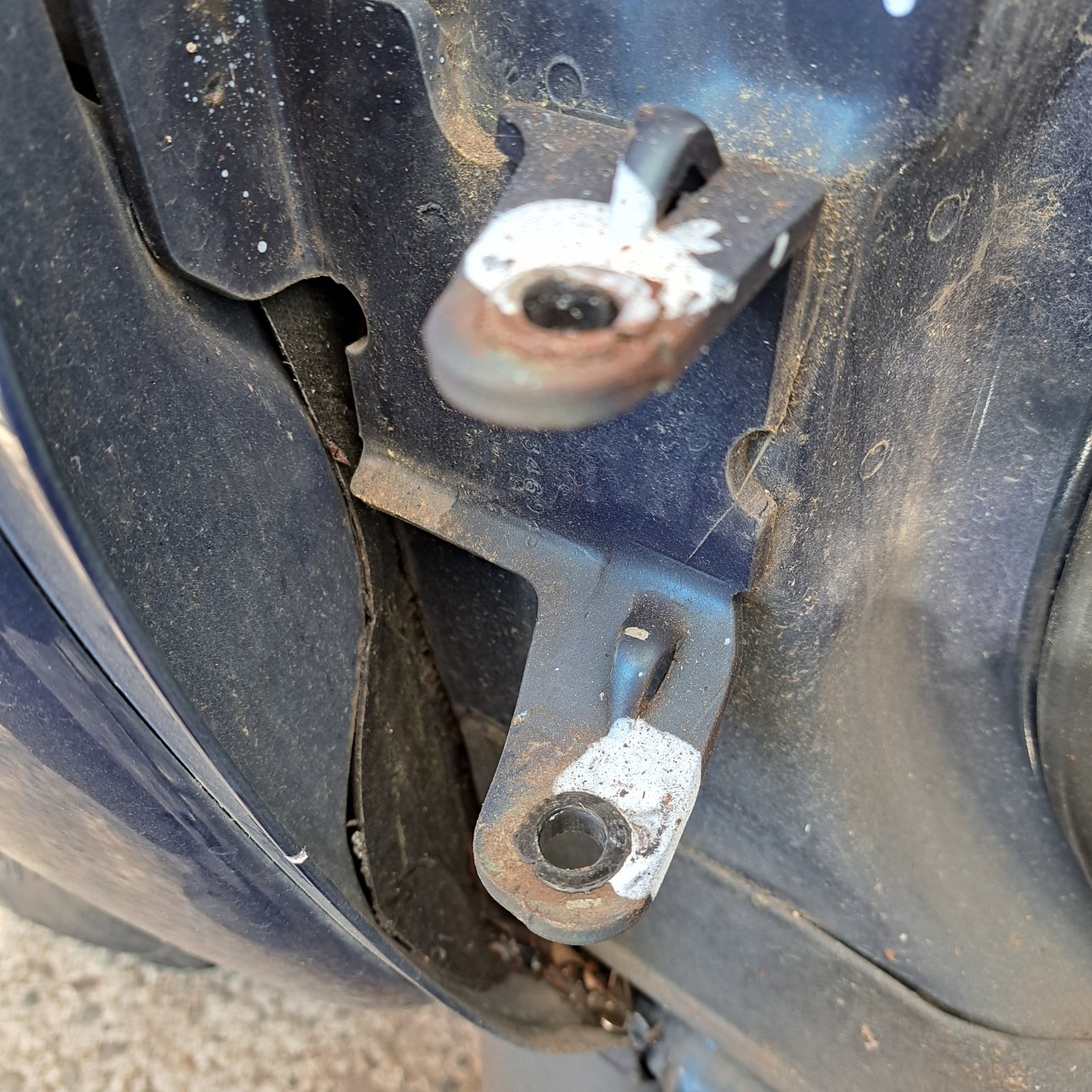

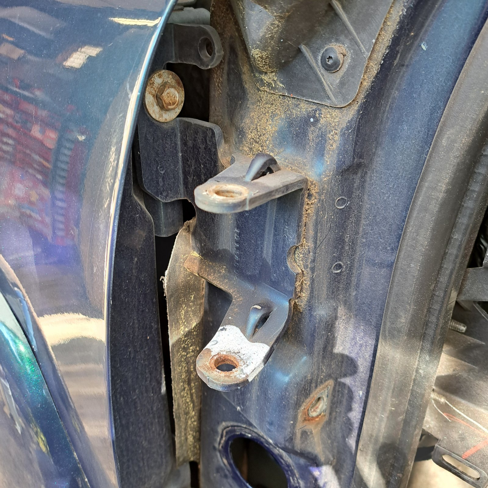

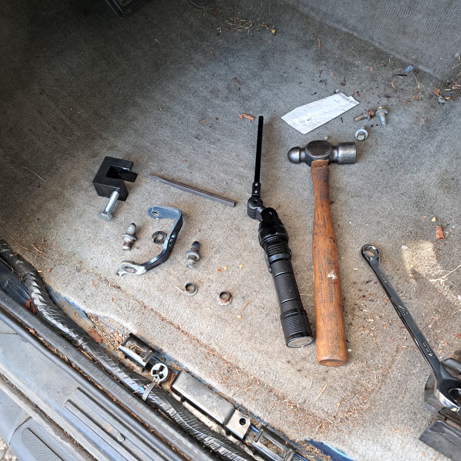

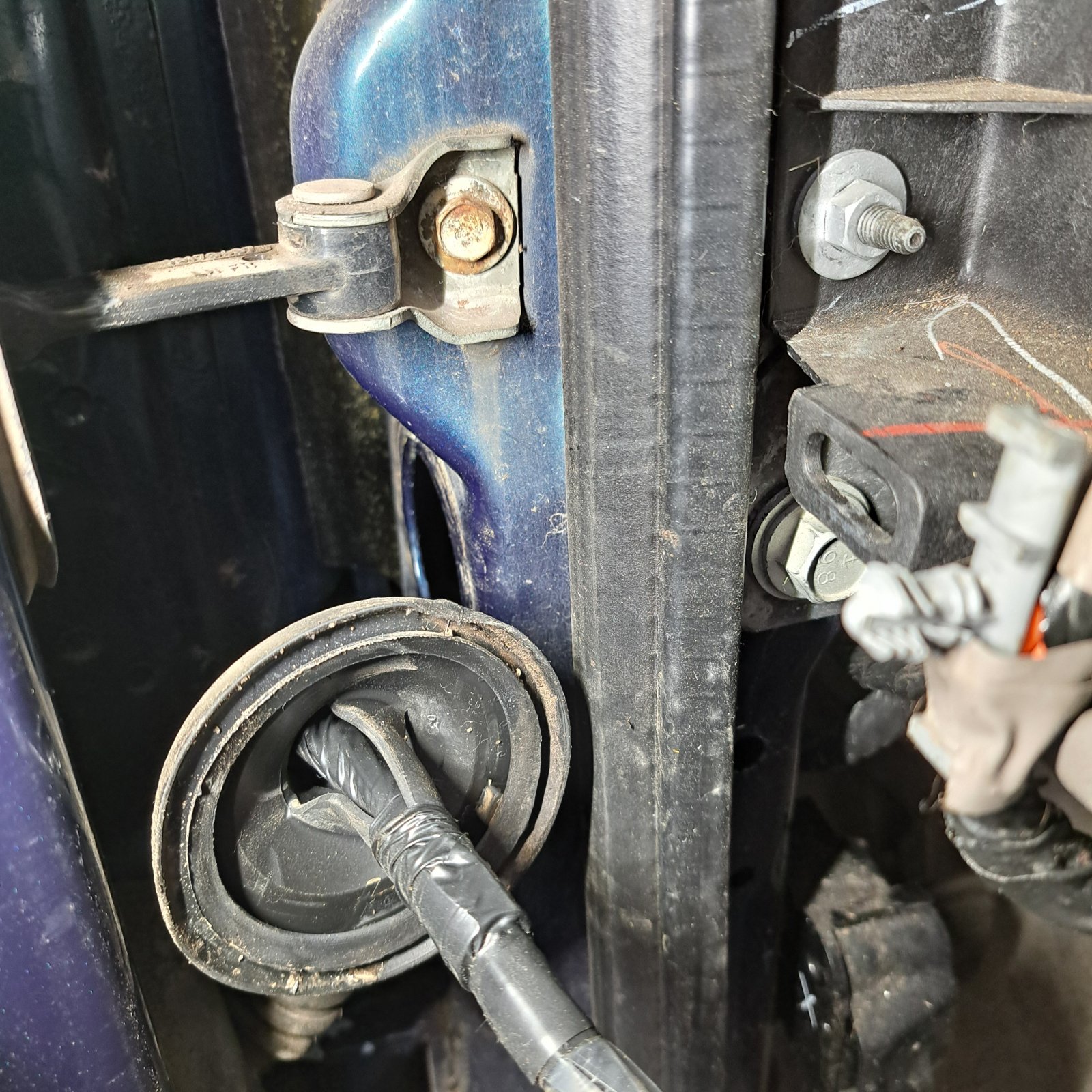

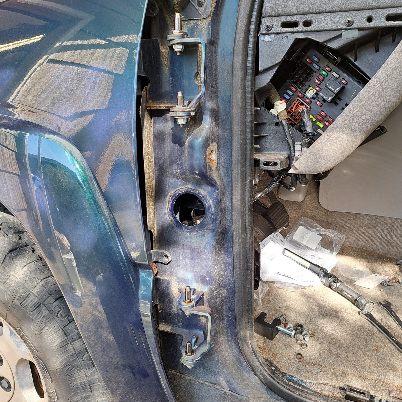

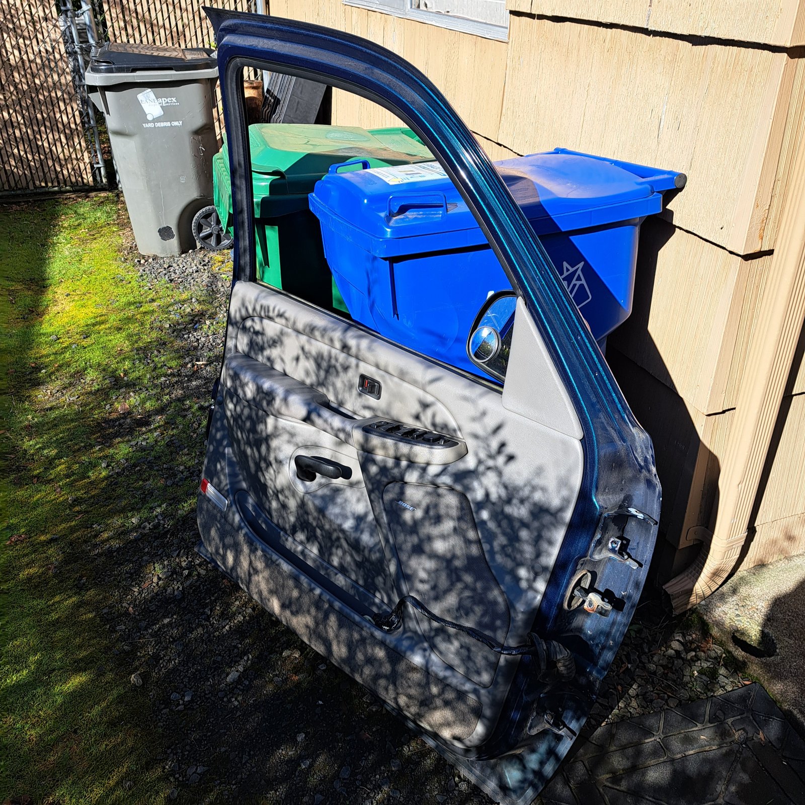

Well today was just fun fun fun. Unbolted the drivers door from the hinges and then, with the help of my neighbor, lifted the door straight up and off the pins. Used my floor jack to lift it, using a special cup that is designed for pinch weld lifting. Cut the bottoms off of the 4 pins and used my special push tool to remove the old pins. Bolted in the new pins and set the door back on and all went well.
Moved on to the door lock actuator and that went pretty smooth except for water coming out of it. See the red water at the pin connector area. Found leaking water at the glass wipe seal. Repositioned that and fixed that.
Then went to the blower and resistor and found one of the attaching screws for the resistor was rusted and when dropped the resistor, found it rusted badly. Blower was dry.
Gonna remove cowling tomorrow and locate source of leak.
