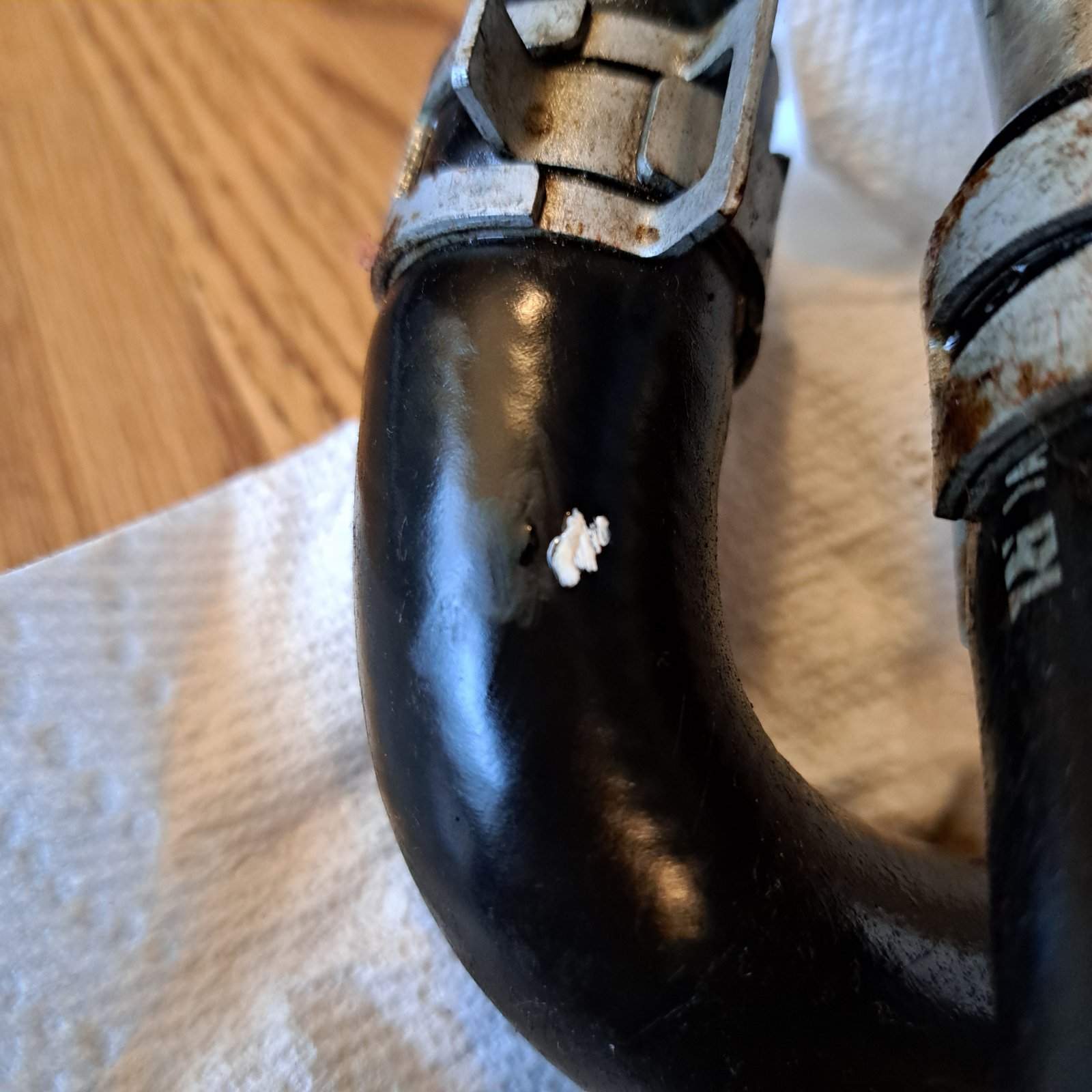

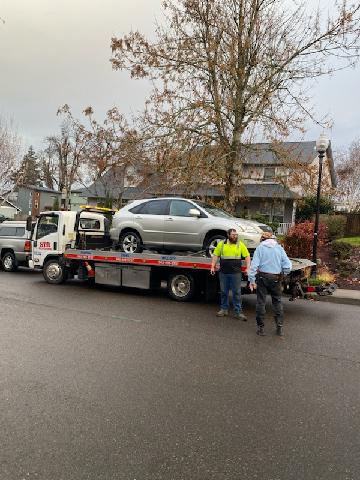

Ok, got the 2007 Lexus RX350 here last night and saw a large oil leak coming down and then got on ramps this morning. Turned out was spewing oil out under pressure at a pinhole of one of the hoses for the oil cooler lines. There is a new design with all metal and flexible tubes. 2 new gaskets. Removed old set up. Had to use a female torx, E8, to remove a stud for reinstall and then reinstall stud. Cleaned underneath, topped off oil, engine rattles went away, changed oil filter, checked and cleared codes and wiped down as best I could and reinstalled the splash shields. Not gonna list all definitions but had 6 codes: P0011, P0014, P0015, P0017, P0021 and P0024. All had to do with camshafts, crankshaft, advance and retard bank 1 and bank 2.
In the first pic, vehicle on tow truck in Silverton, Or. Second pic is of the bright new metal shiny part that I could catch with my cell. The next, if you look close, you can see the hose hole/slit/rupture next to the white mark.
