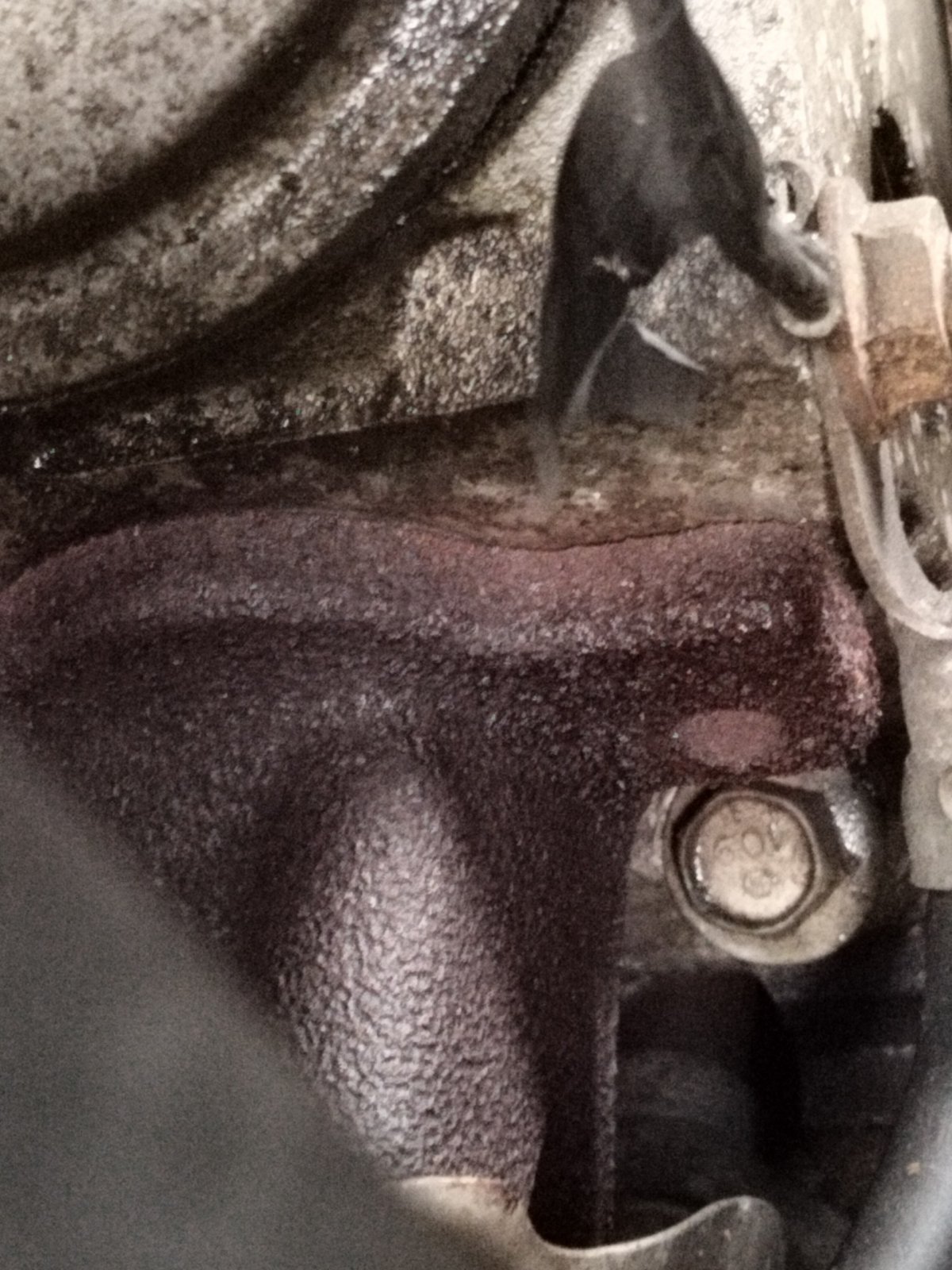

Alright some new info, got a sheared exhaust manifold bolt... Also it's the very front edge one so I suppose I need to get it fixed somehow.
How critical an issue is it? Will it survive say a 200 mile trip or so? Must have been recent since I found the sheared bolt beneath the manifold, Sheared to the block sadly.
Just noise at this point. Fine for driving. It "might" throw off the oxygen sensor
just a bit. But that's it
