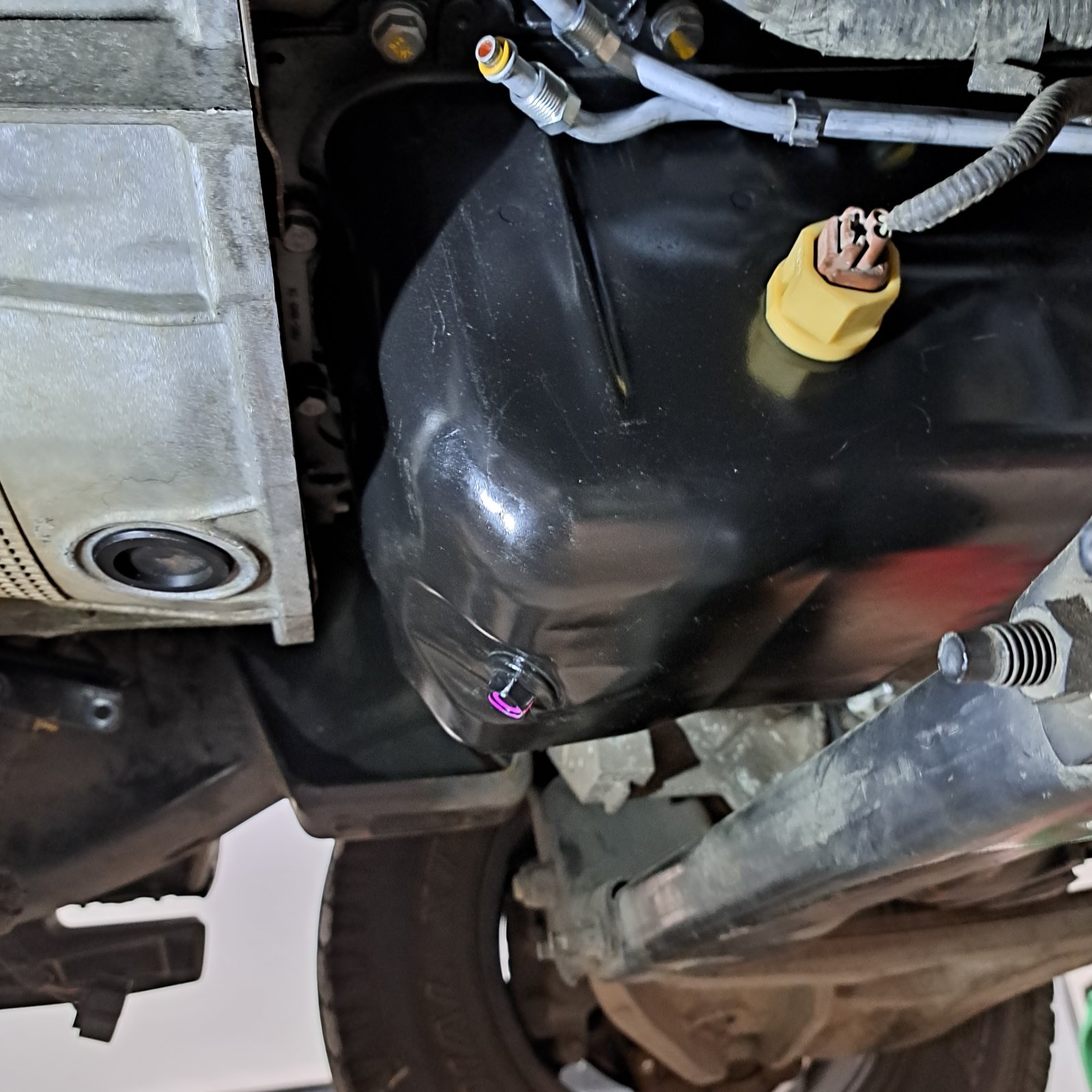

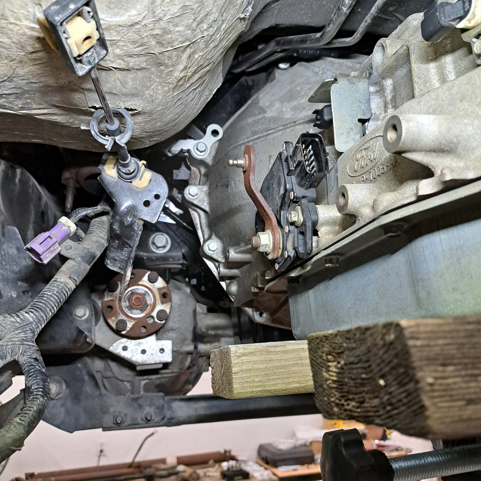

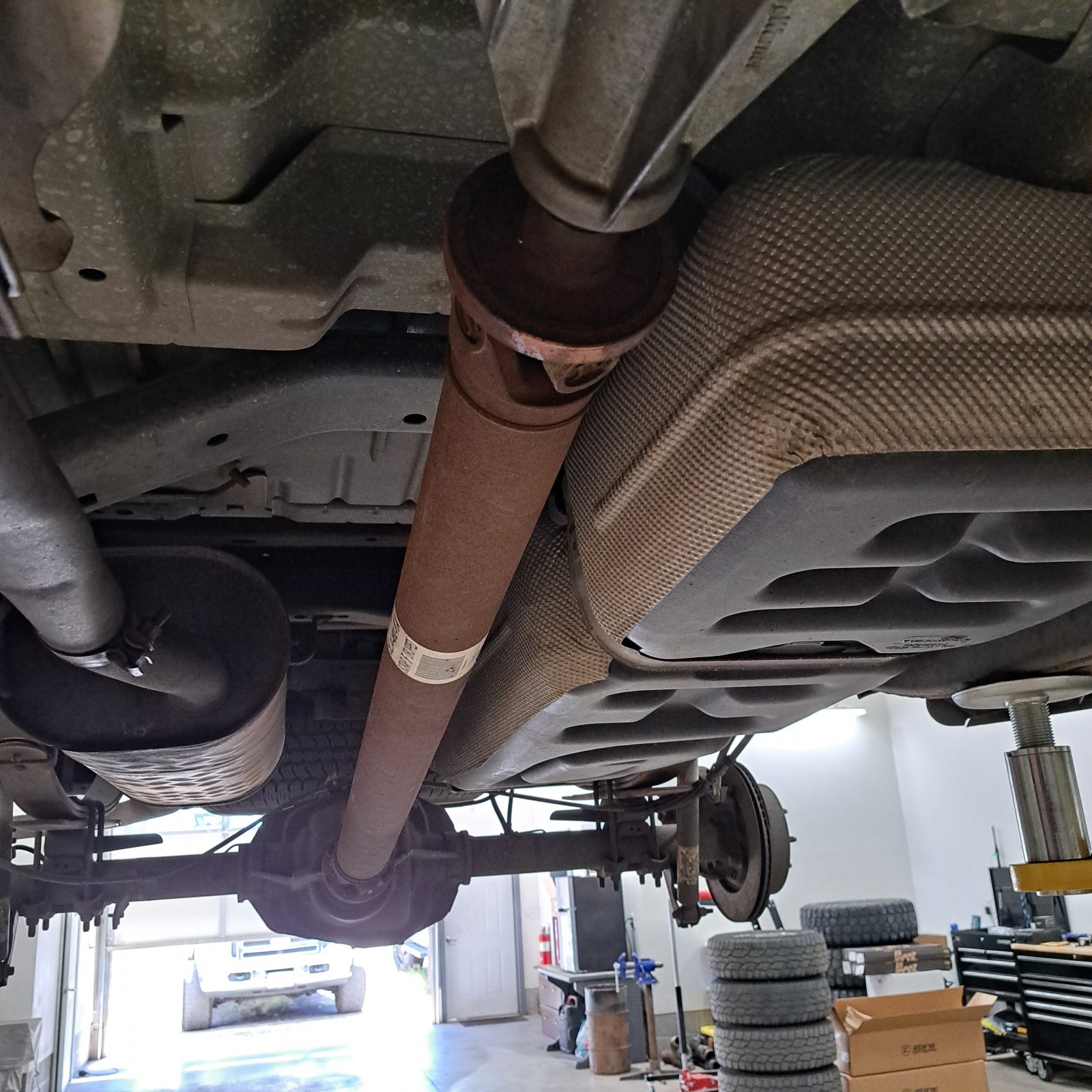

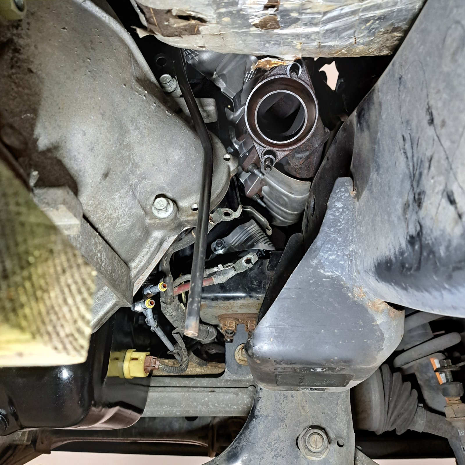

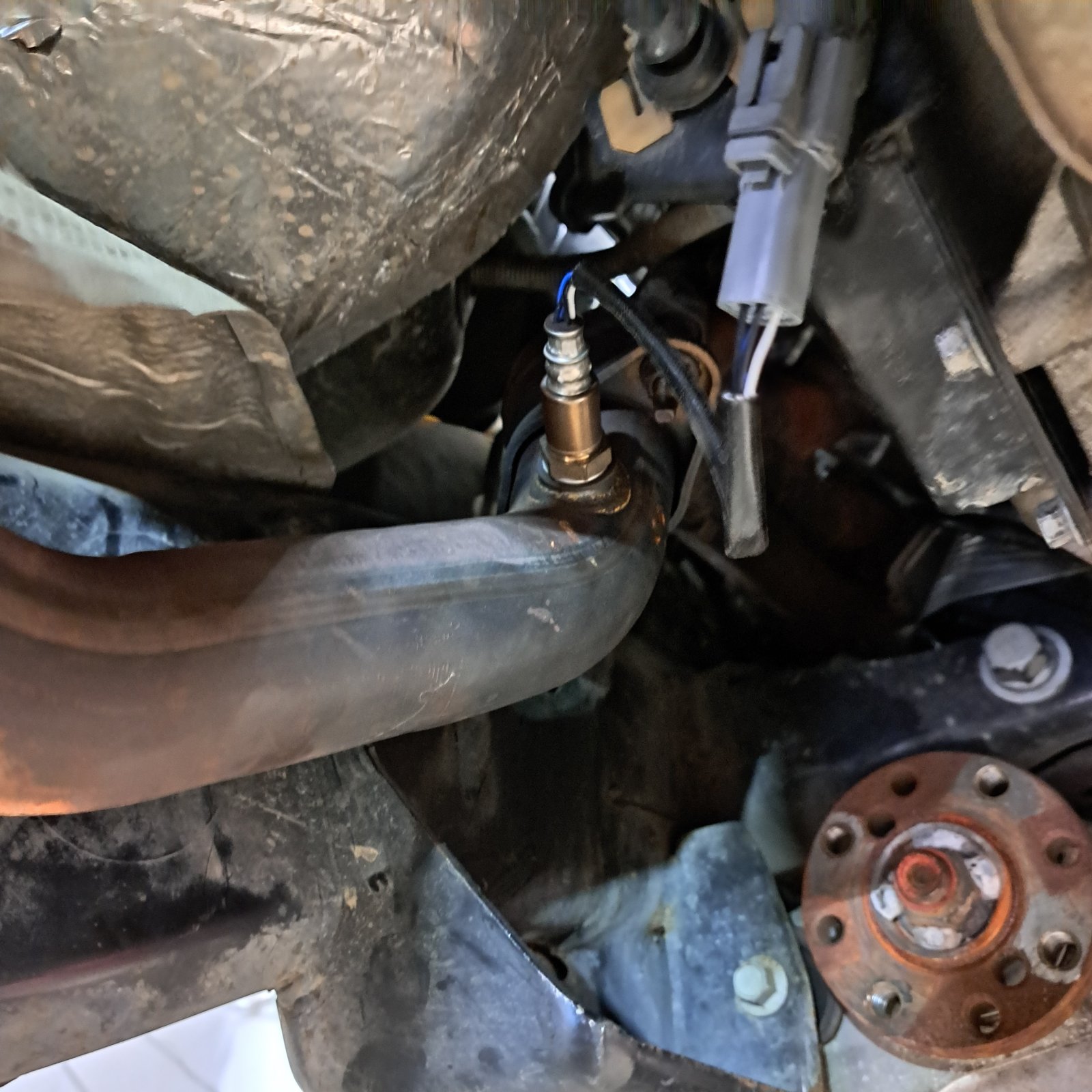

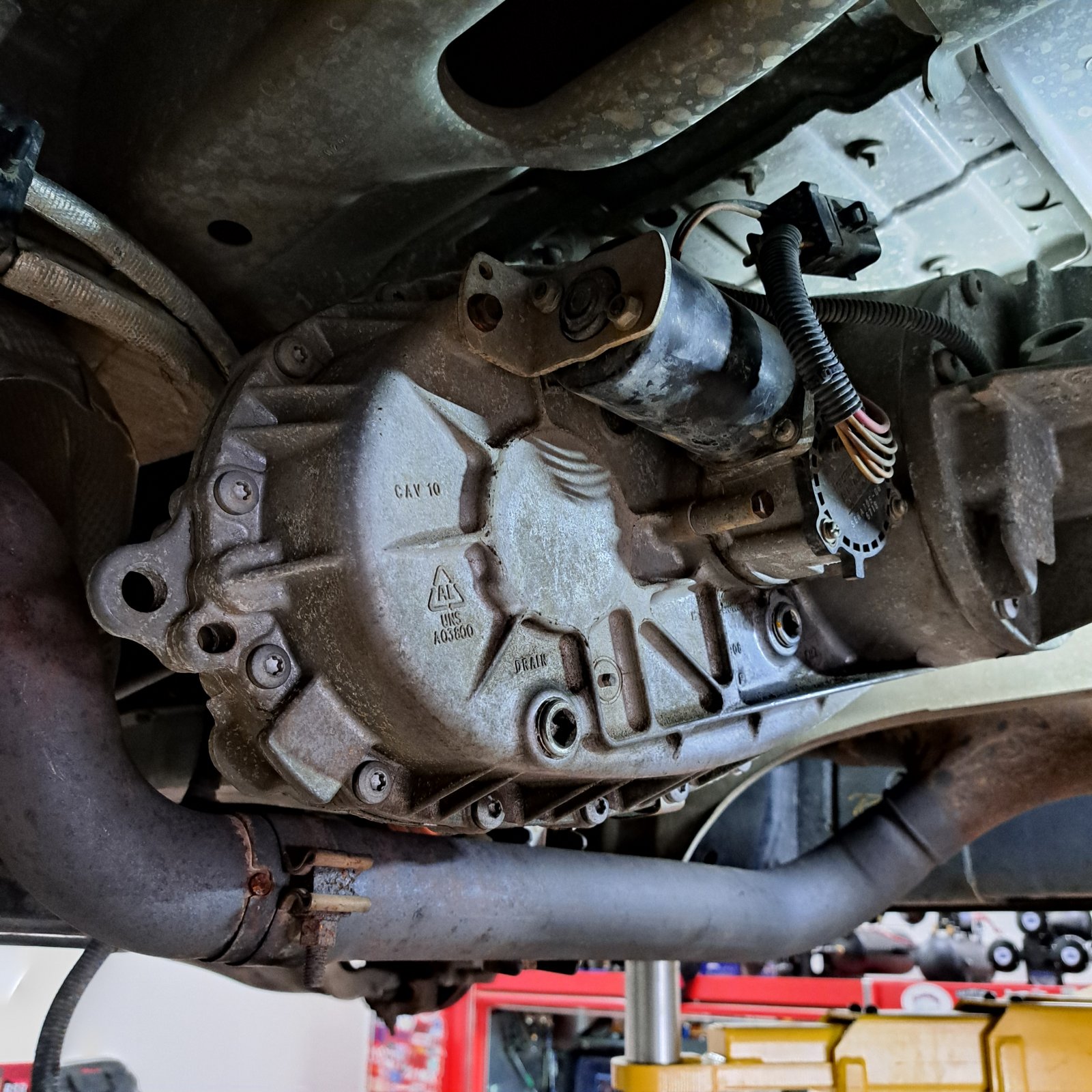

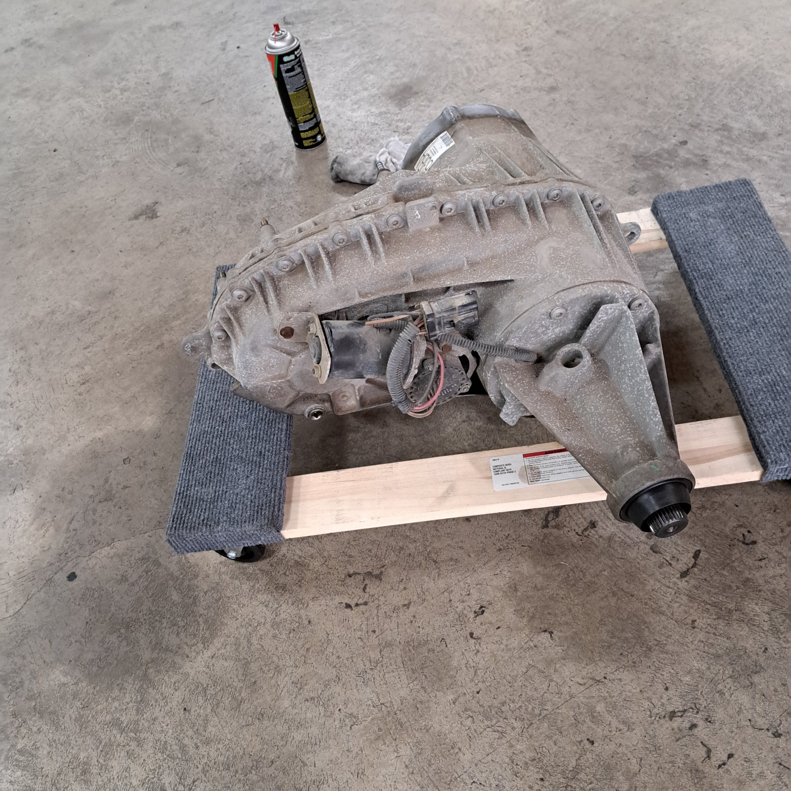

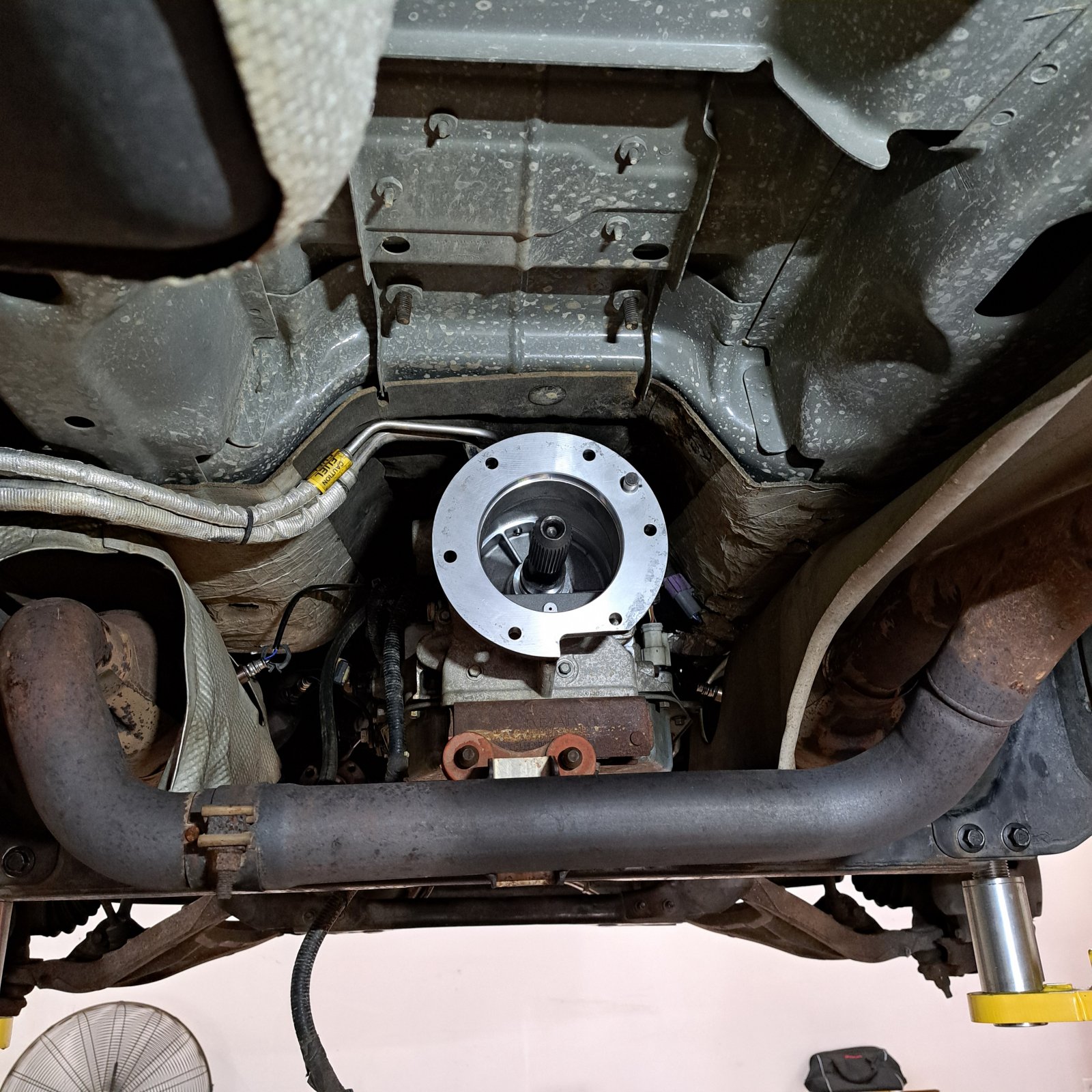

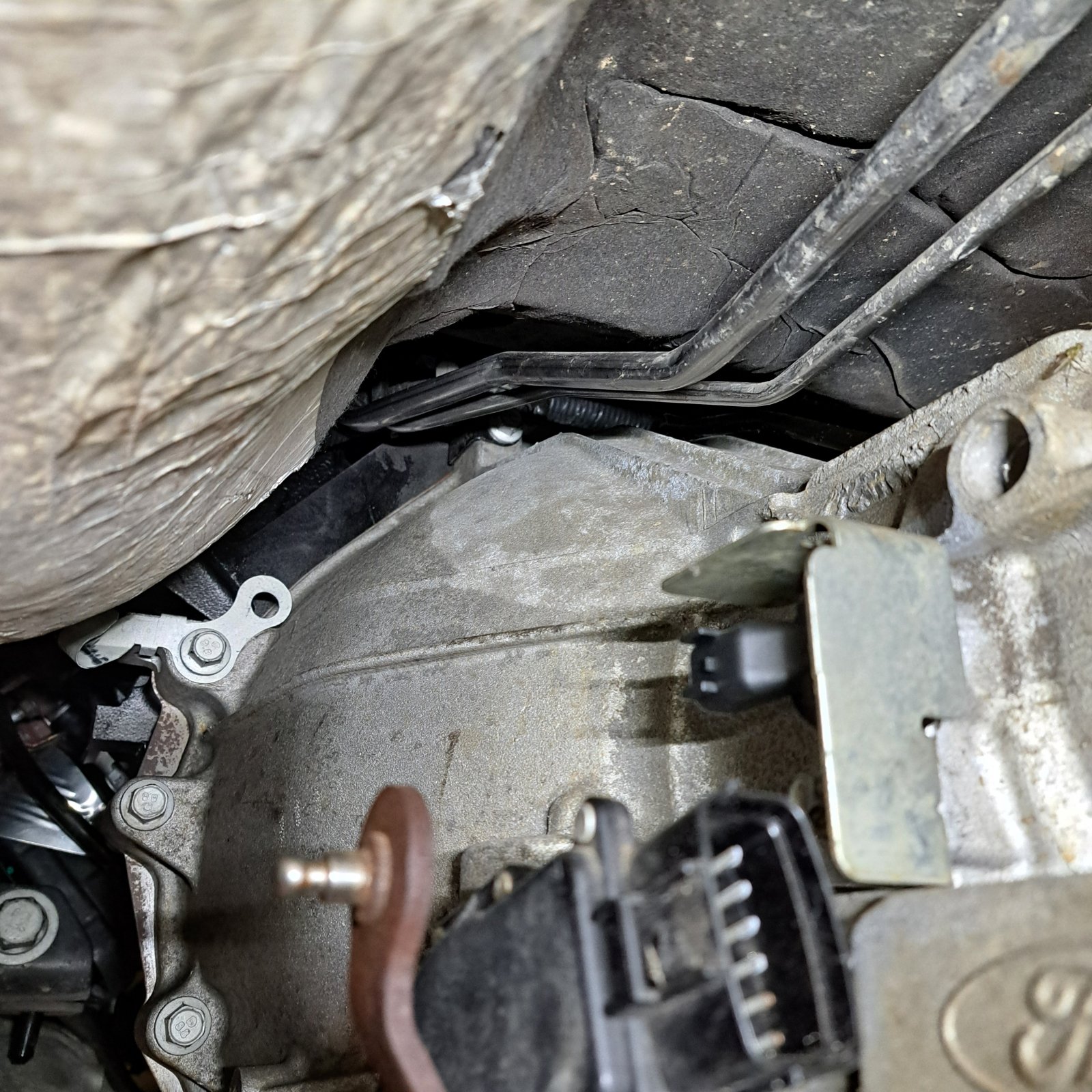

Got the transmission installed and torque converter attached to the flexplate, all related harnesses routed and plugged in and tethered to their attaching points, catalytic converter heat shields installed and the catalytic converter/y-pipe assembly installed, transmission crossmember installed and after the mounts were all checked for binding-all mounts torqued to spec. Some people do not do this mounts step that way and can end up with a drivetrain vibration if not done correctly. Then the shoe dropped. Found that the oxygen sensors were incorrect. Getting correct sensors this morning. Want to install the front sensors before installing the transfer case and front driveshaft. Will install sensors, transfer case, driveshafts and fill all fluids and start the vehicle today. Just have the transmission install pics before the crossmember install. More pics tonight or tomorrow.

Went to roadtest the F150 and experienced a shudder and lack of power. Transmission Fault at dash and CEL. Codes recovered: PO731, PO750 and PO753. Traced to a failed Shift Solenoid A. Showed 20 megaohms instead of between 20-30 ohms. Shift Solenoid B was supposed to be same ohms and read at 27 ohms. Torque Converter Clutch solenoid spec is between 10-16 ohms and measured at 15 ohms. Talked to transmission rebuilder and explained that if going to reuse electrical component, should test it. They did not. Gonna go ahead and install all 3 solenoids on Monday and roadtest again. Everything else shows fine with no leaks. My neighbor/customer is all good.

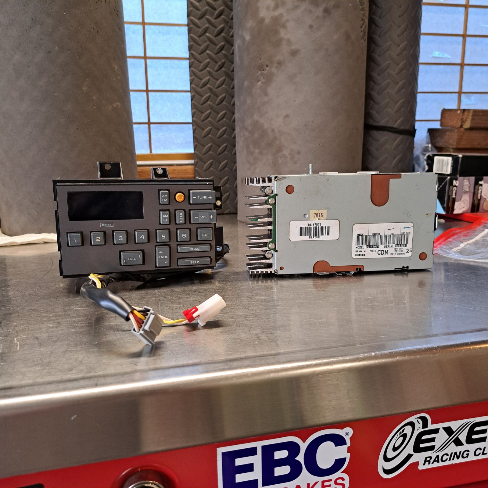

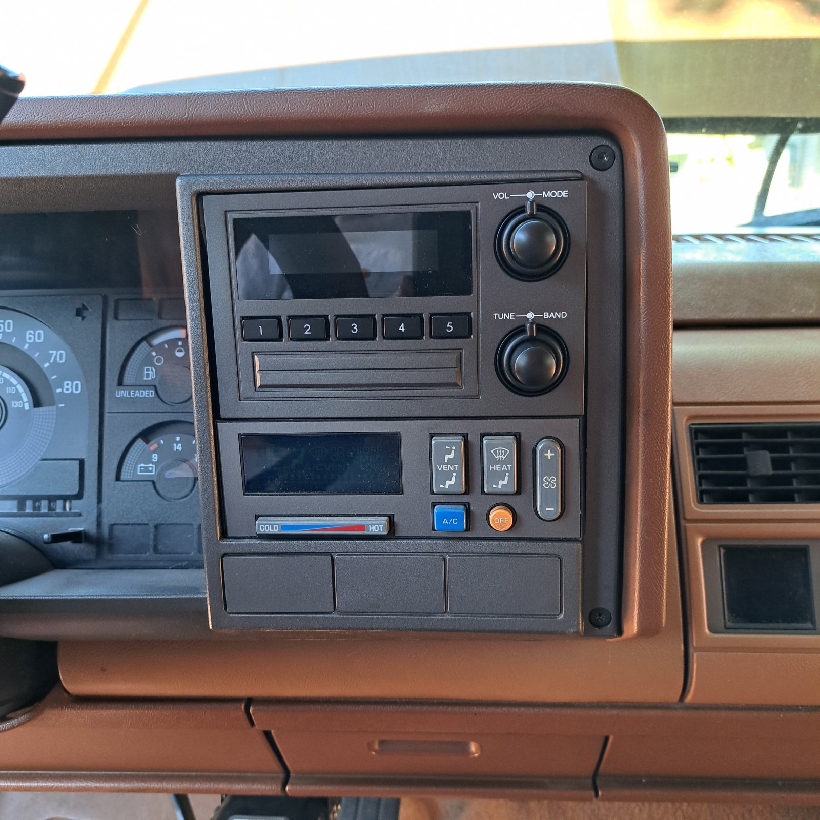

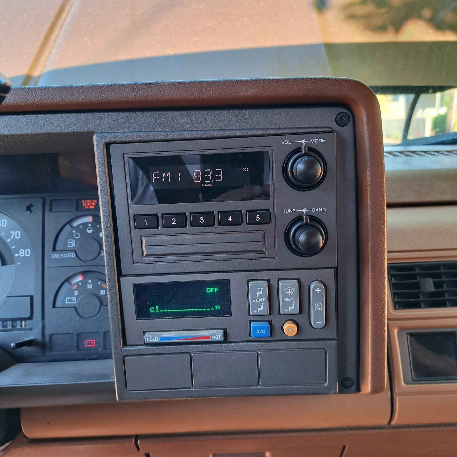

Took my girl's K2500 dash apart and removed the old radio and tuner and equalizer. Installed new Retro Sound radio and hooked up existing speakers. Figuring out the new mounting location for the controller took the longest. Plus, the existing ribbon connector, that comes preinstalled inside the controller, will not reach to the back of radio head. Had to remove the cover on the controller and plug in the longer ribbon that came attached with the left and right speaker control harness. I could have missed that part but did not see in the instructions about that. I made a management decision. If the radio head mounts right on the controller, then I would have been ok. Reinstalled the equalizer body, back in the hole for now. If anyone has a cubby hole fix for that, please tell me. Anyway, she can drive now with no transistor radio.
