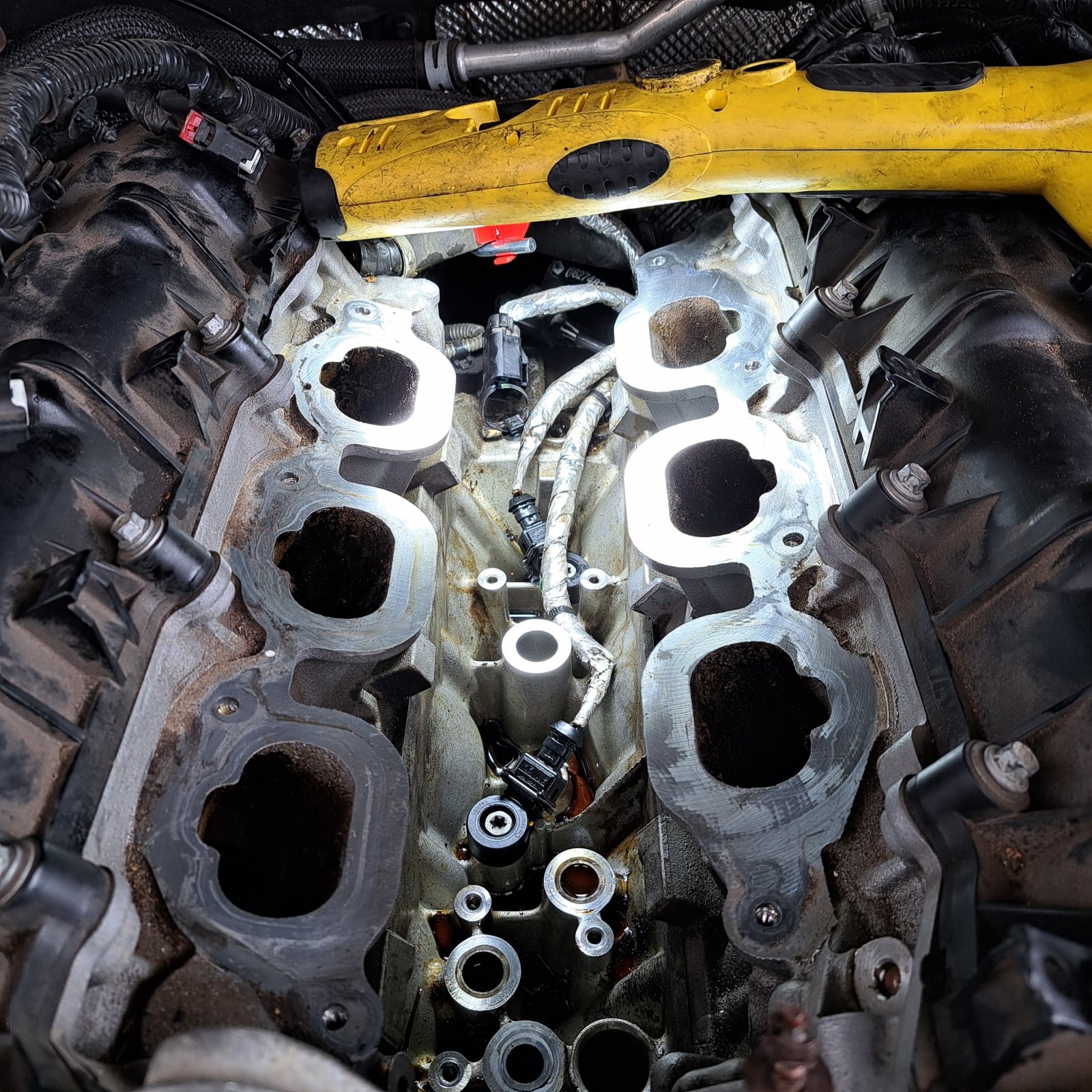

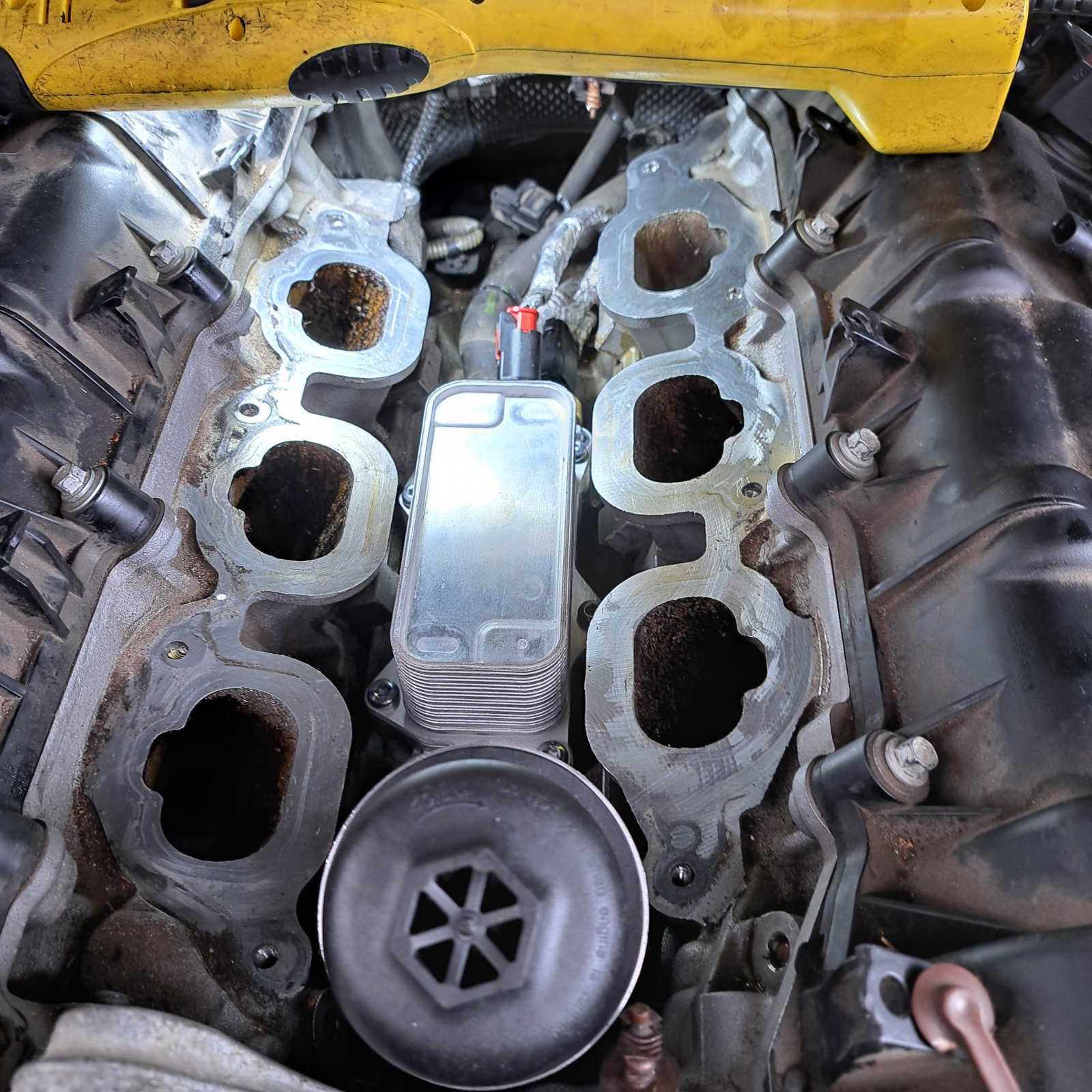

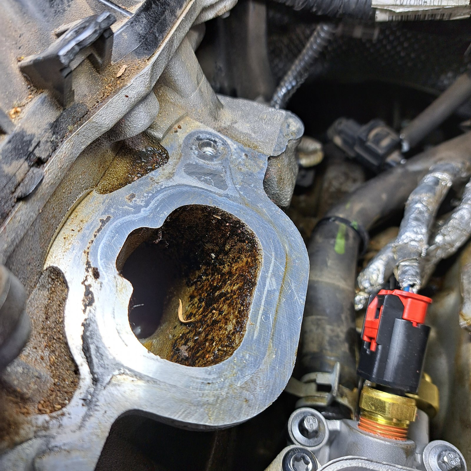

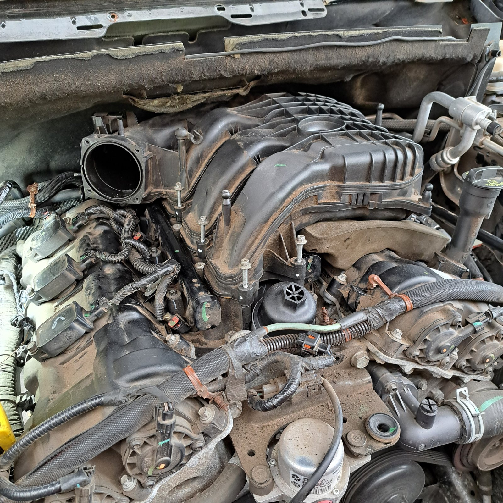

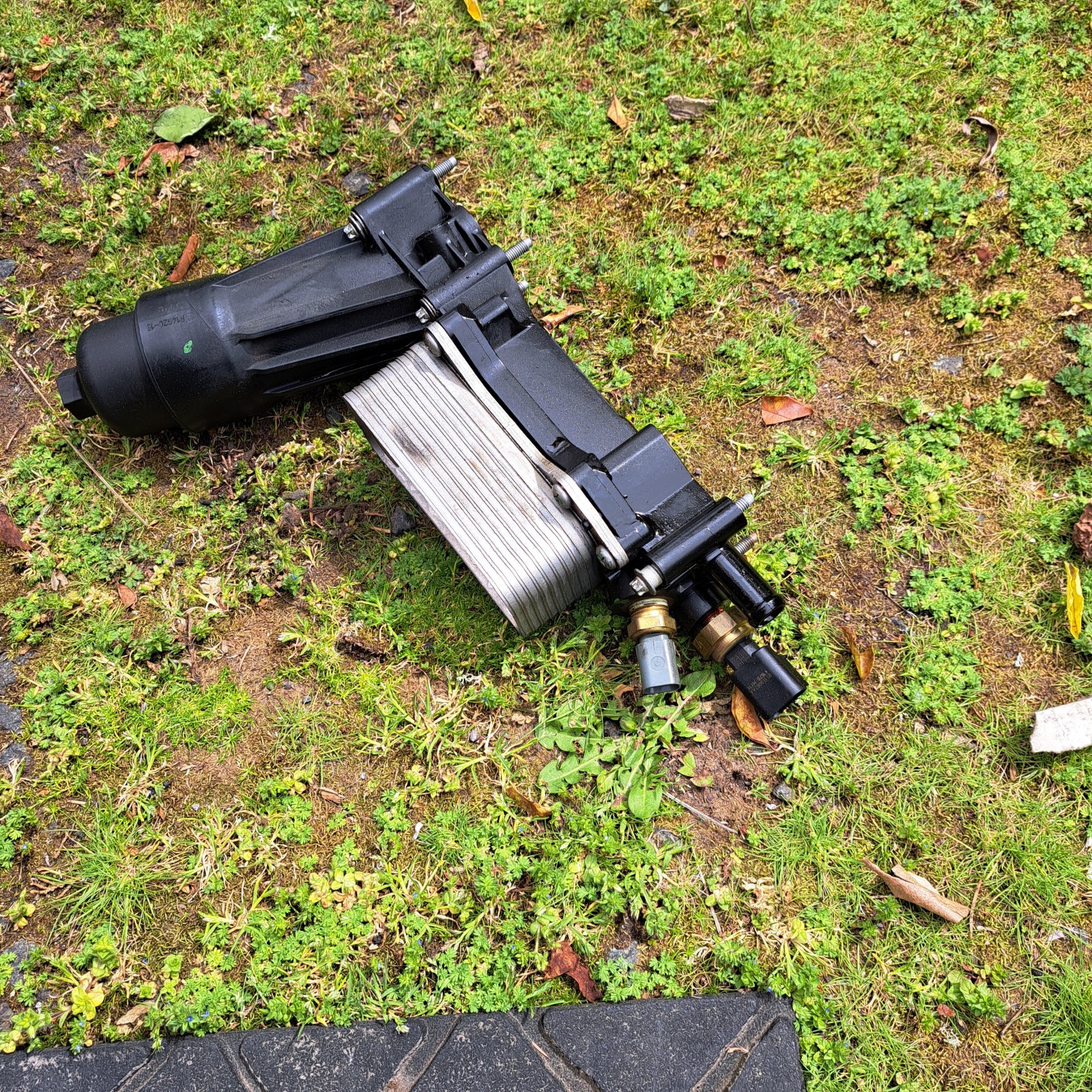

Next week I will be getting engine out and new one in and hooking everything up. Next weekend I have a 2014 Grand Cherokee coming in for the dreaded money making, oil filter housing/cooler assembly replacement because of the common oil leak on the Penstar 3.2 and 3.6 engines. This will be the 3rd one I will be doing in less than a year. The straight ahead engines, like this one, take a little longer because need to remove the cowling and all the connections and hose is in the back. Transverse is easier.

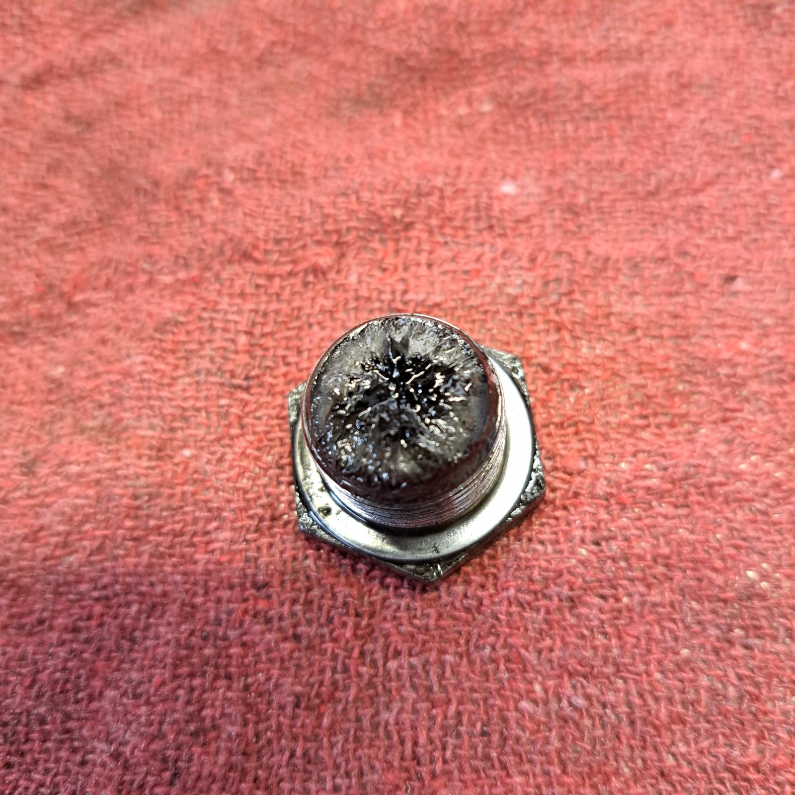

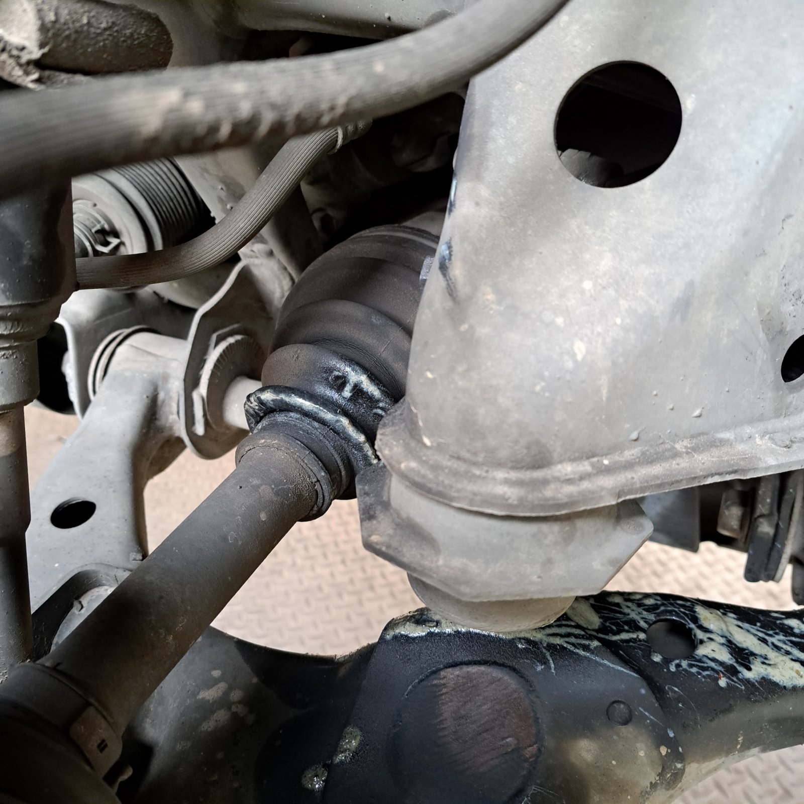

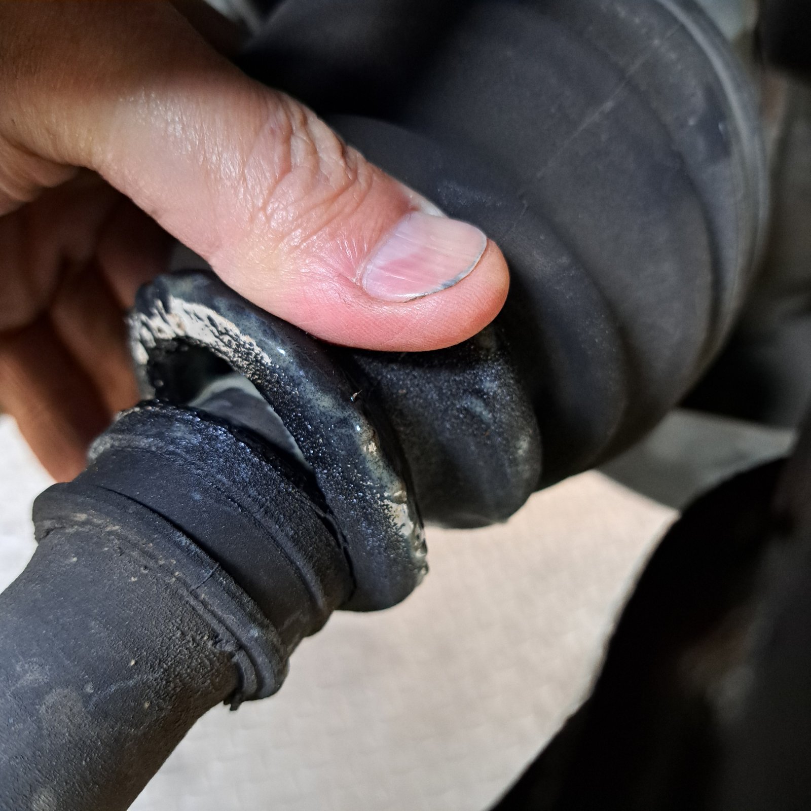

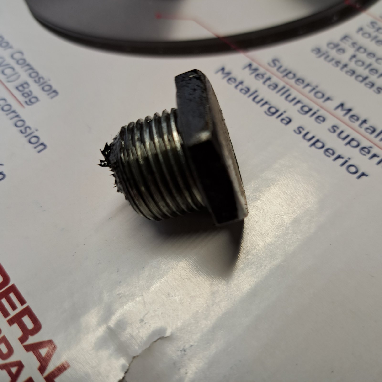

Had a 2008 4Runner here this morning for new pads, rotors, calipers for a front brake pulsation. Also drain and fill the rear diff for noise after the fluid was changed by dealer about 20k ago. Took front tires off and discovered d/s inner cv boot torn and slinging grease. I did the p/s axle and hub/bearing 3 weeks ago and checked the d/s and was intact and no tears and no grease slinging. Because of labor overlap, I went and got the axle for the d/s and she is also doing the hub/bearing and she is going to get back to me in 2 weeks and do it all at once. I went ahead and did the rear diff fluid change. Let it drain and sprayed brake clean in the fill hole and washed it out nicely. Unfortunately, the old fluid was grey and particles on the drain plug magnet. I would expect what I saw on first change but this is the 3rd change on a 128k miles rig. Refilled with 75w-90 synthetic, 3.2 quarts, delivered to her and was quieter but she knows she has an upcoming decision. I have tried for 6 months to buy the 4Runner from her for $12k. I even told her I would give her money back for the recent p/s axle and hub/bearing and pay her for all the new brake parts and left axle and hub/bearing and would pay her for the fluid for rear diff. She is thinking about it.......

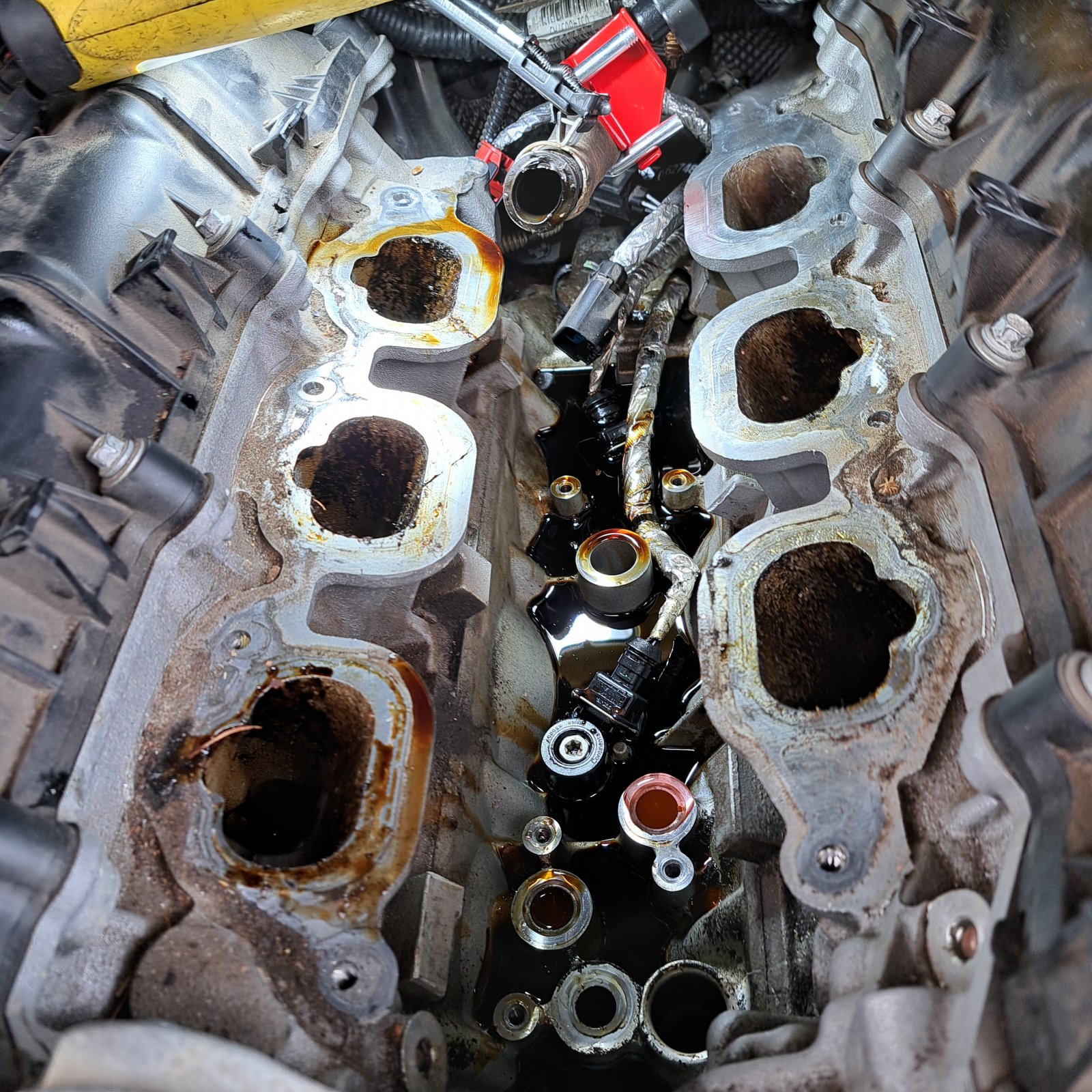

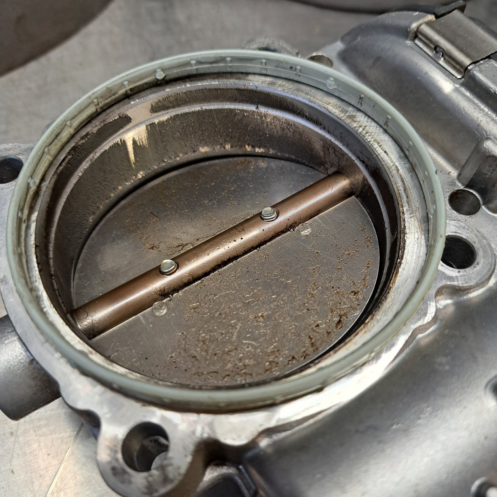

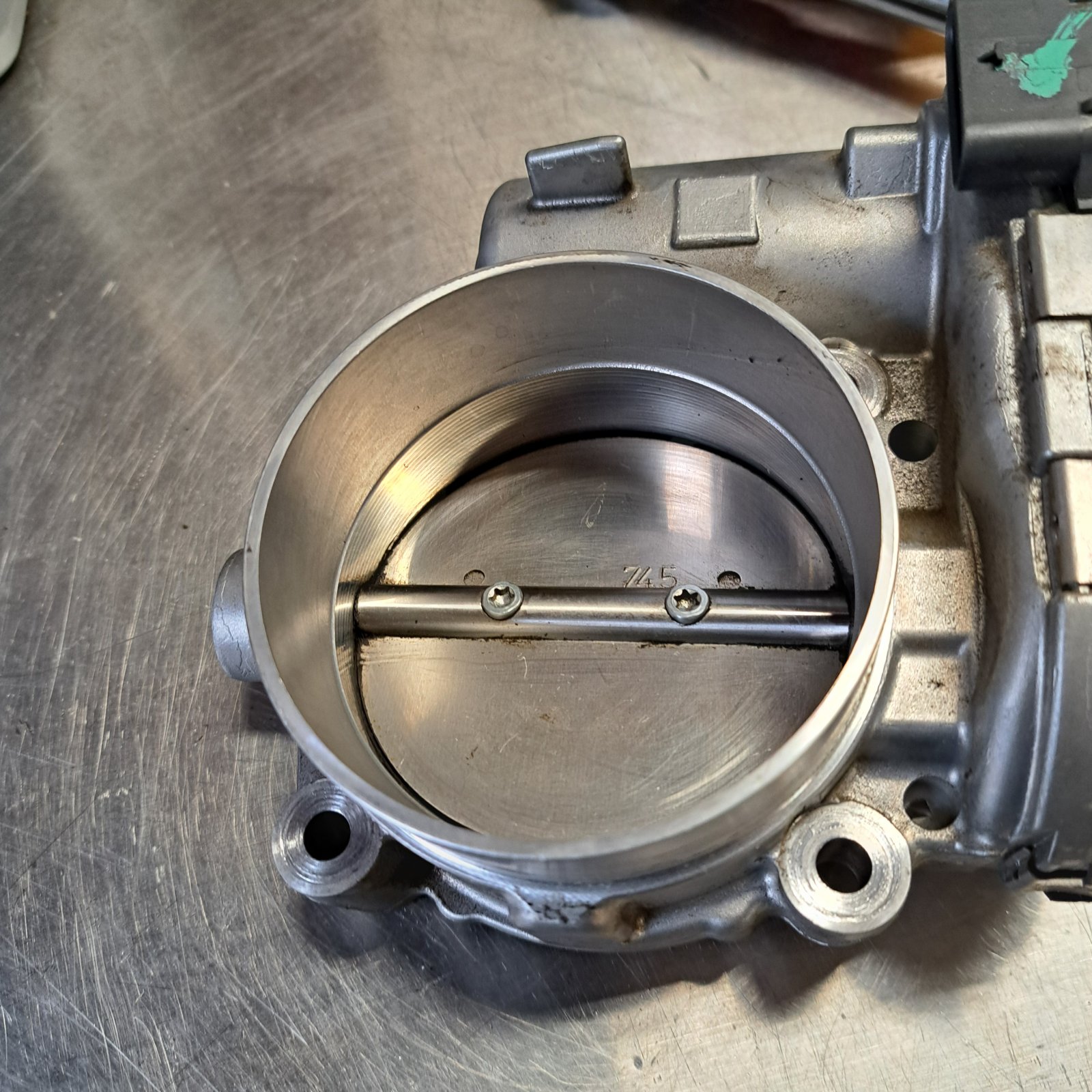

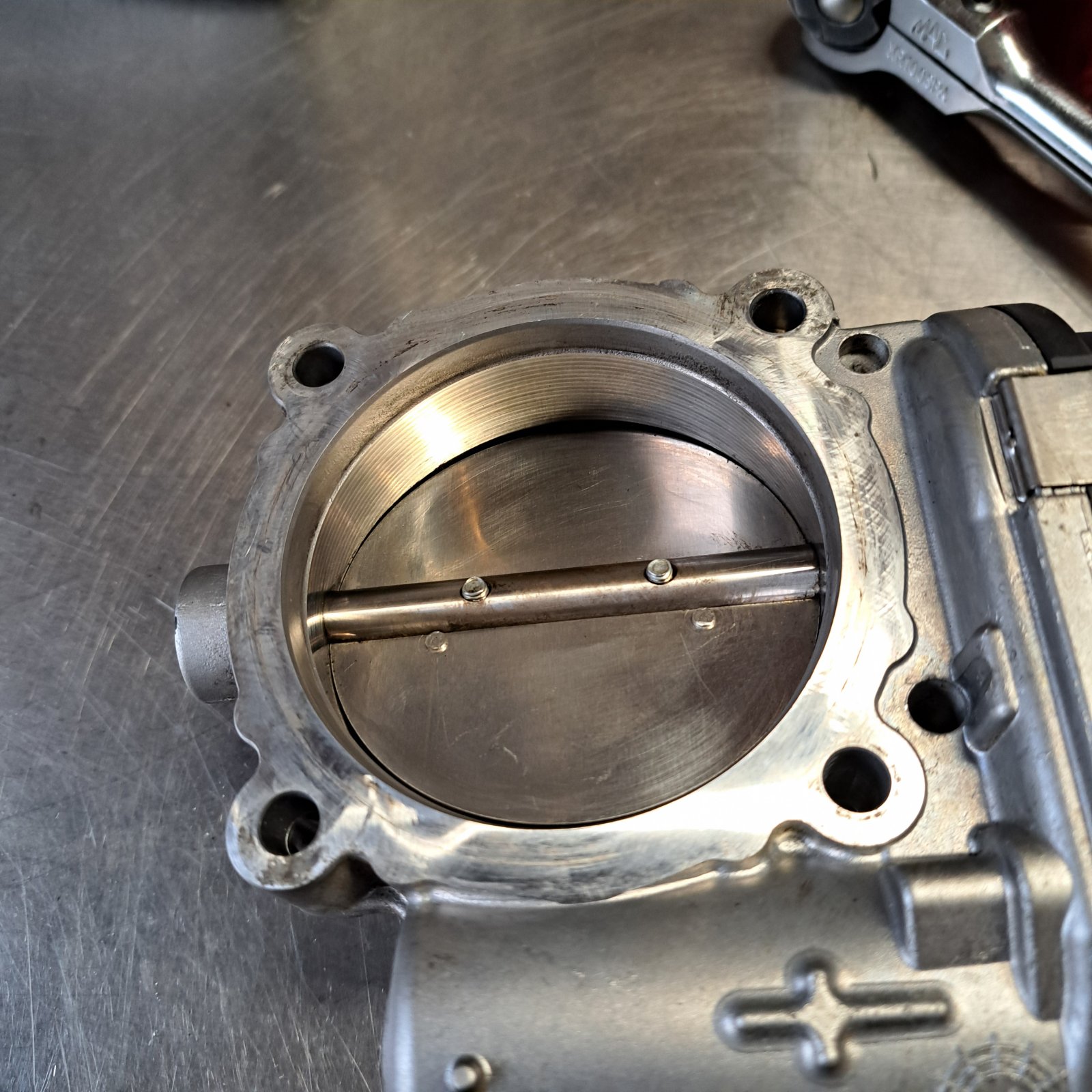

Well, today was the day for the 2014 Grand Cherokee 3.6 Penstar oil cooler/filter housing oil leak repair. Took a total of 4.5 hours, including the throttle body cleaning. Next weekend is the 08 4Runner d/s axle shaft and entire front brakes.

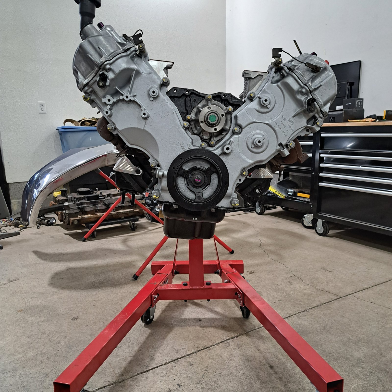

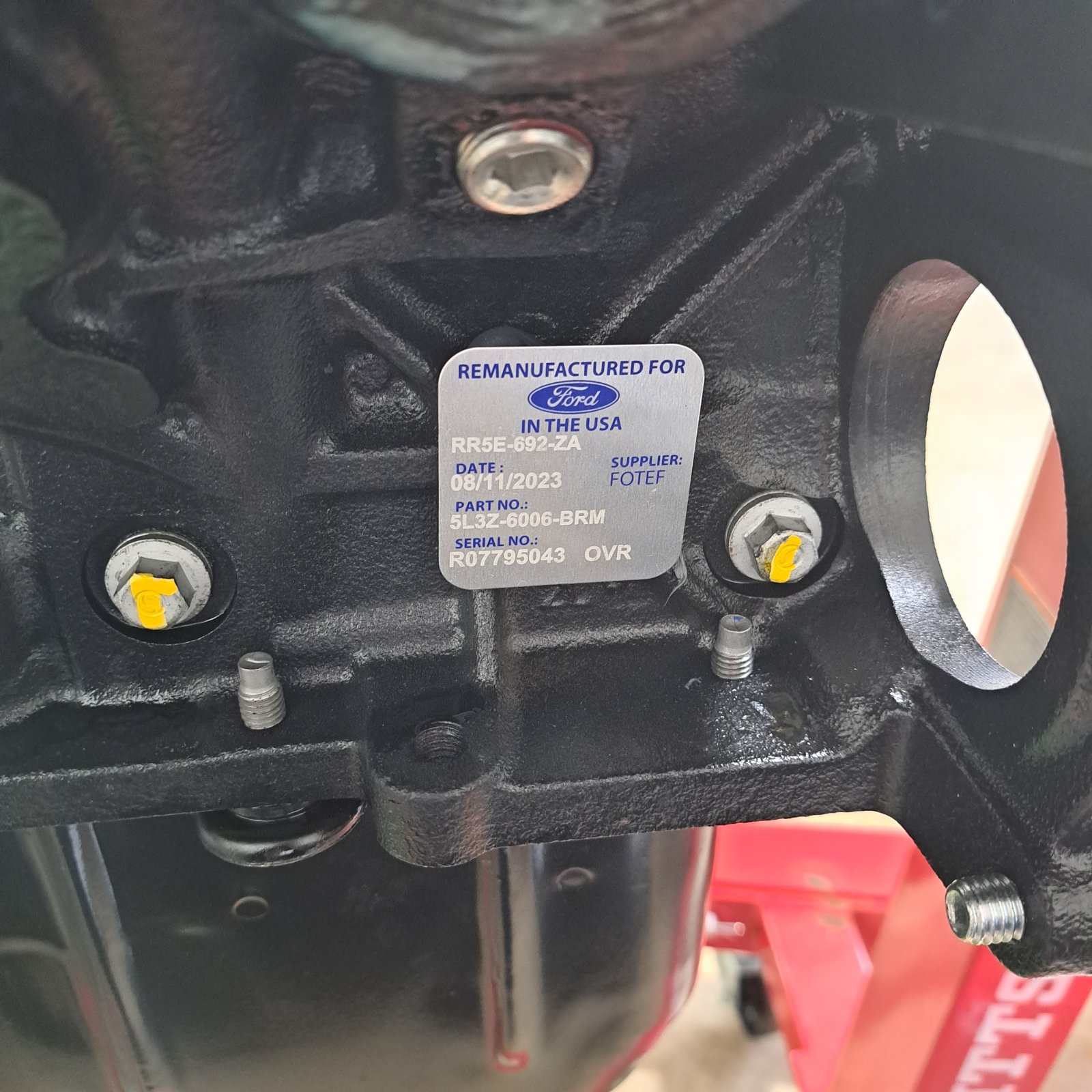

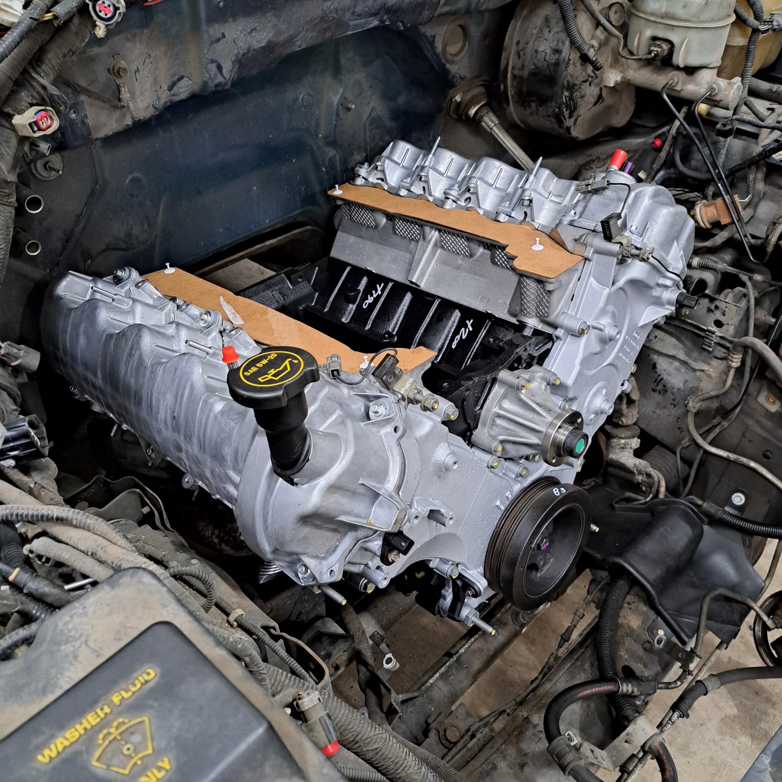

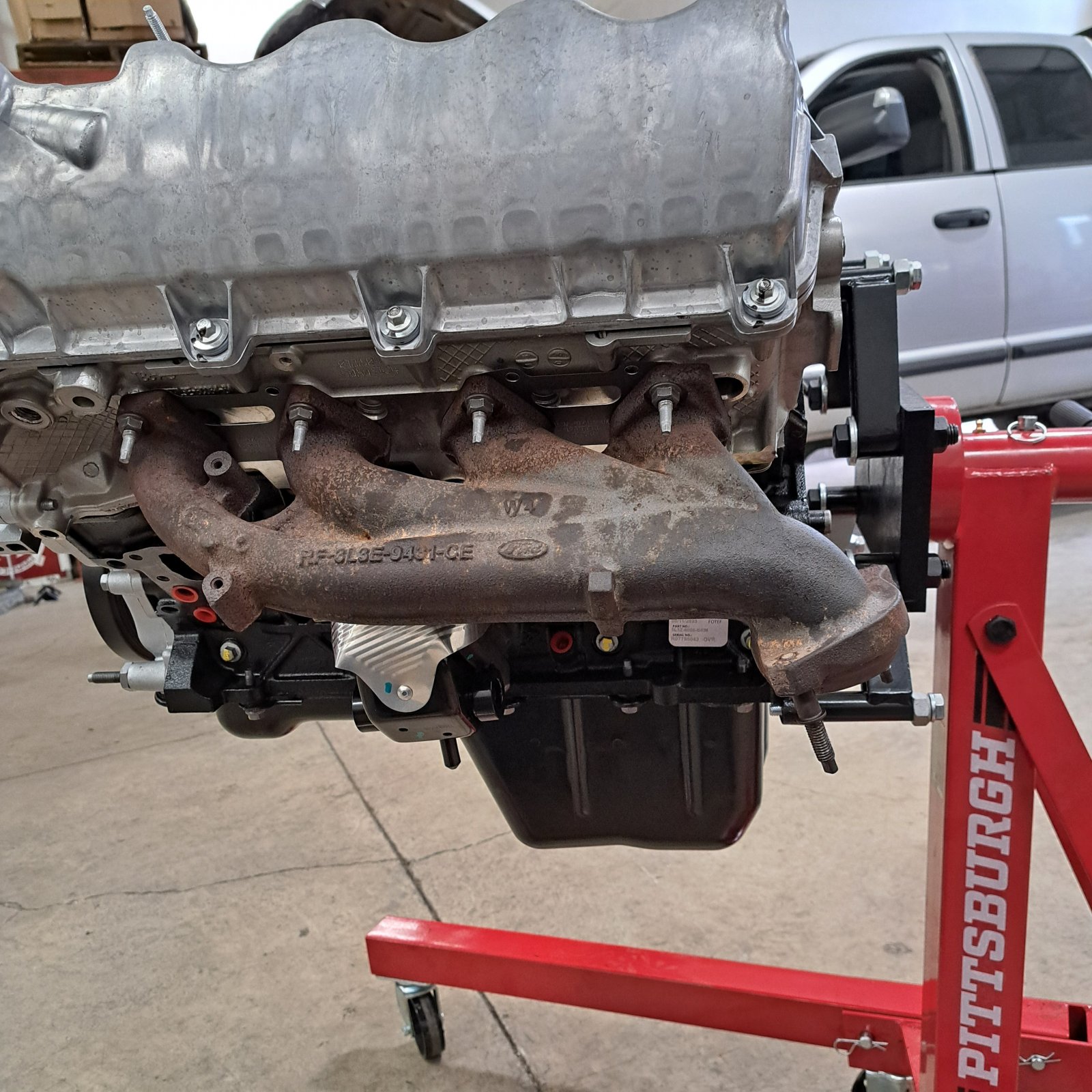

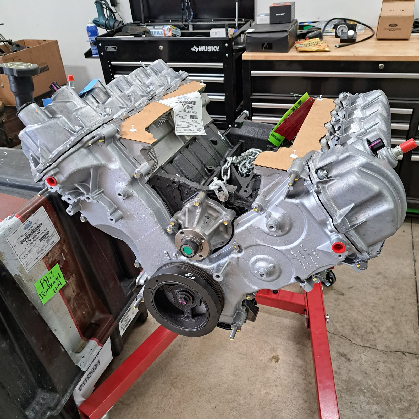

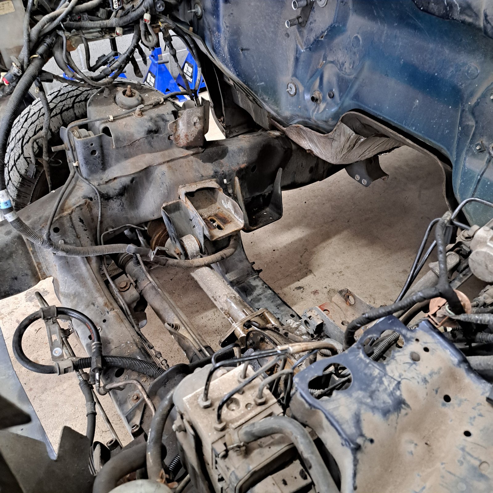

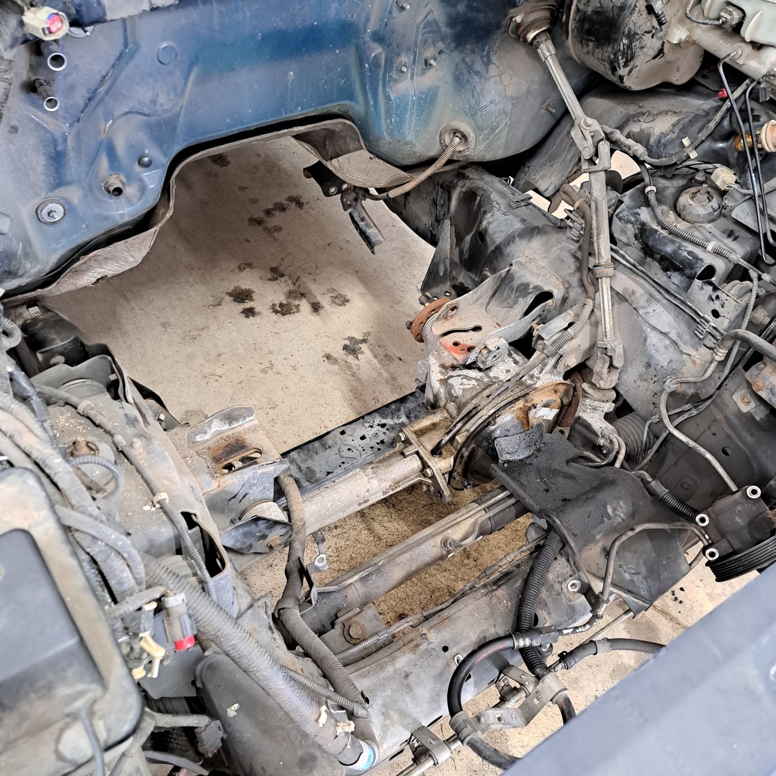

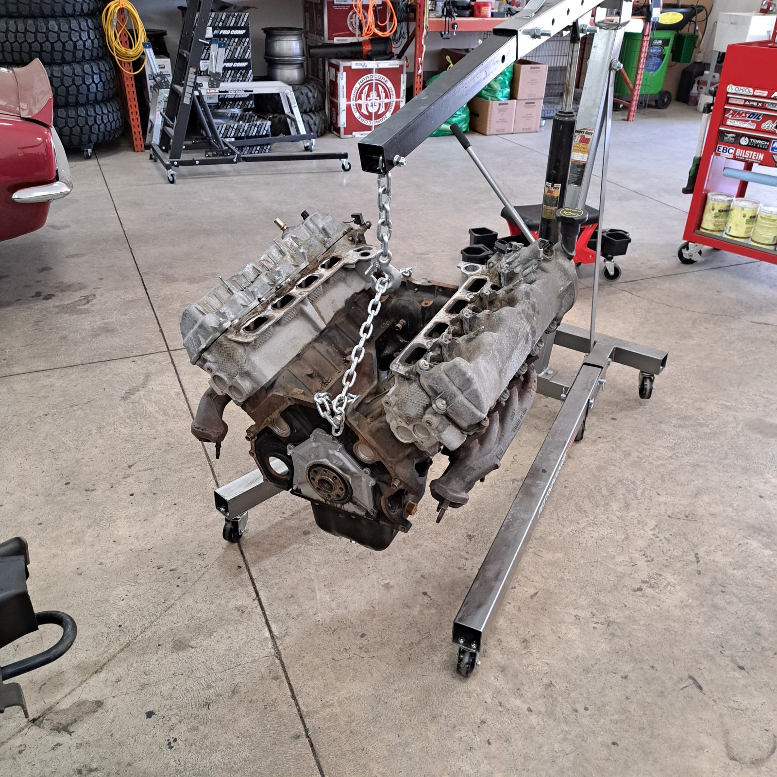

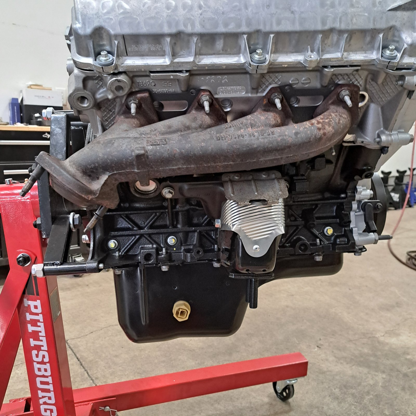

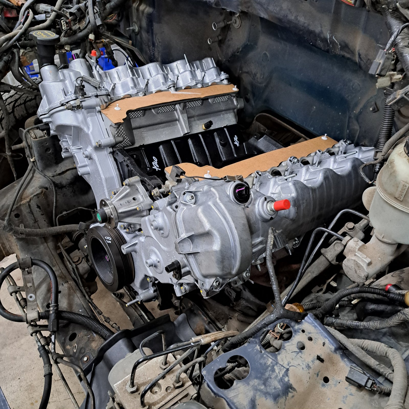

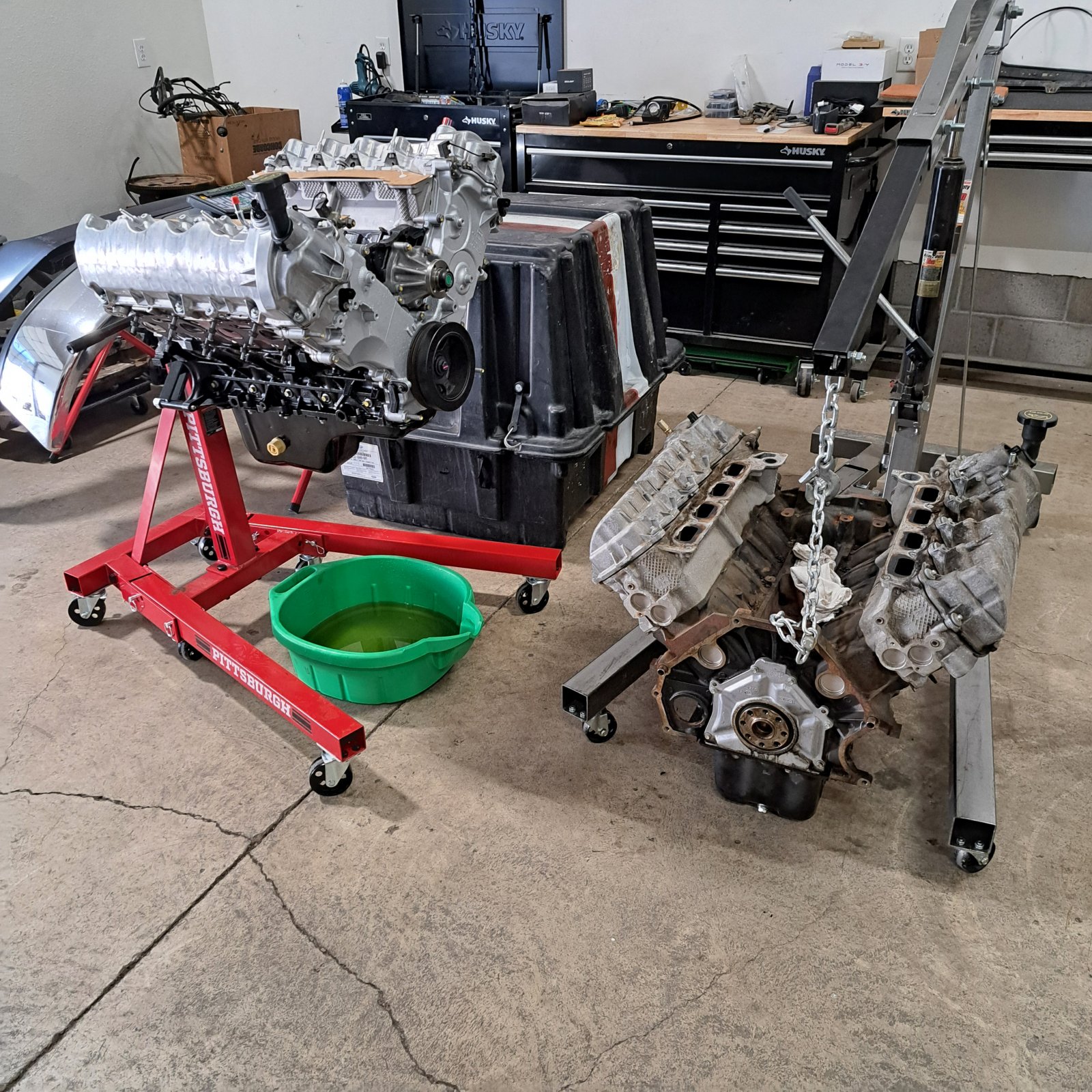

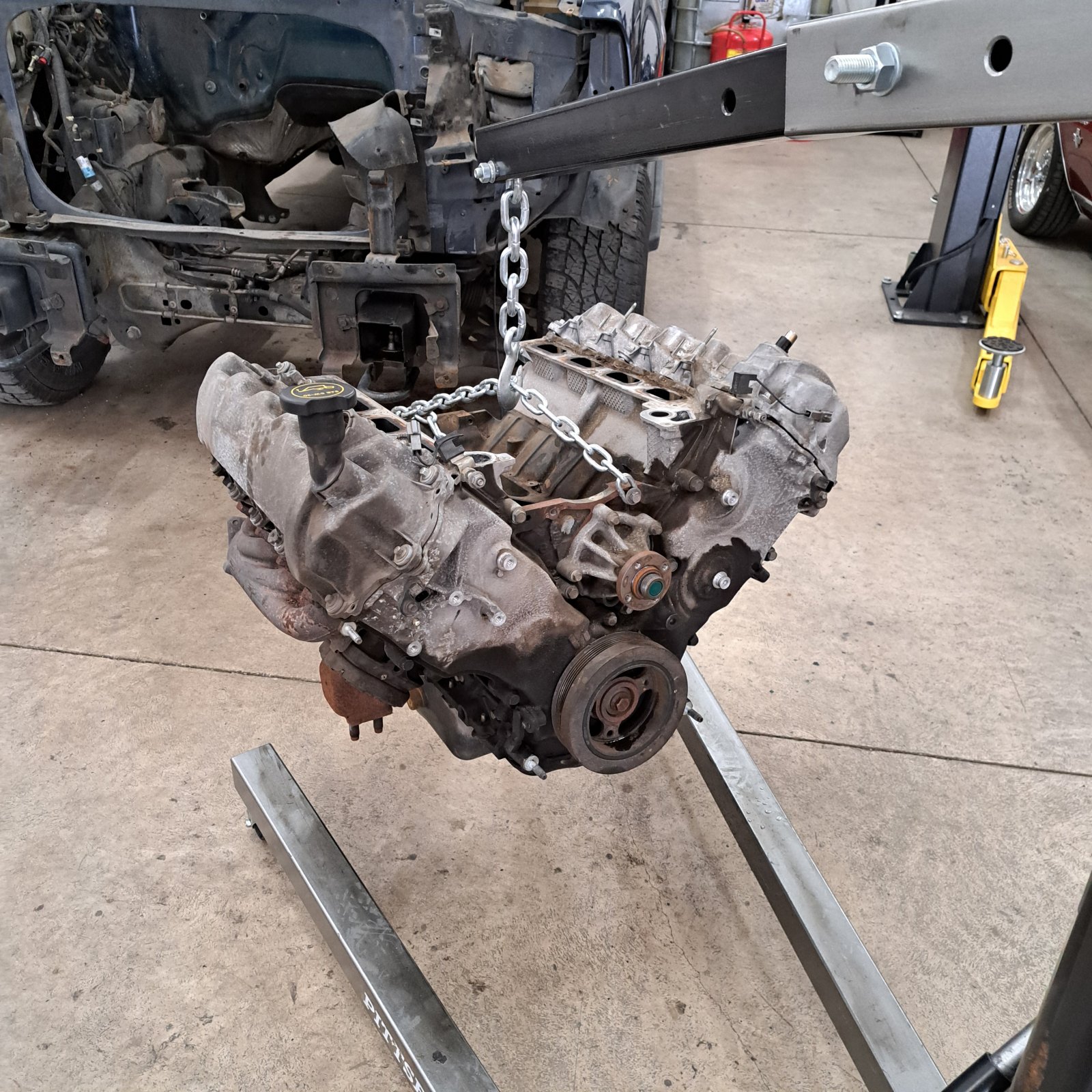

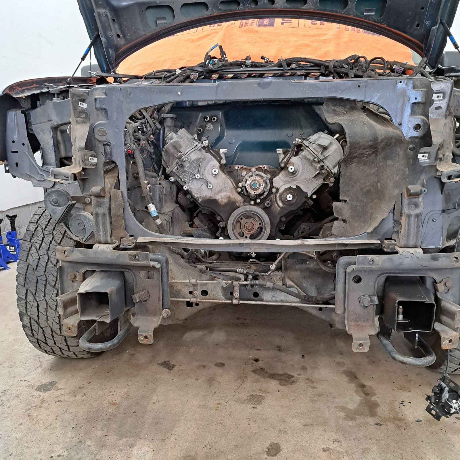

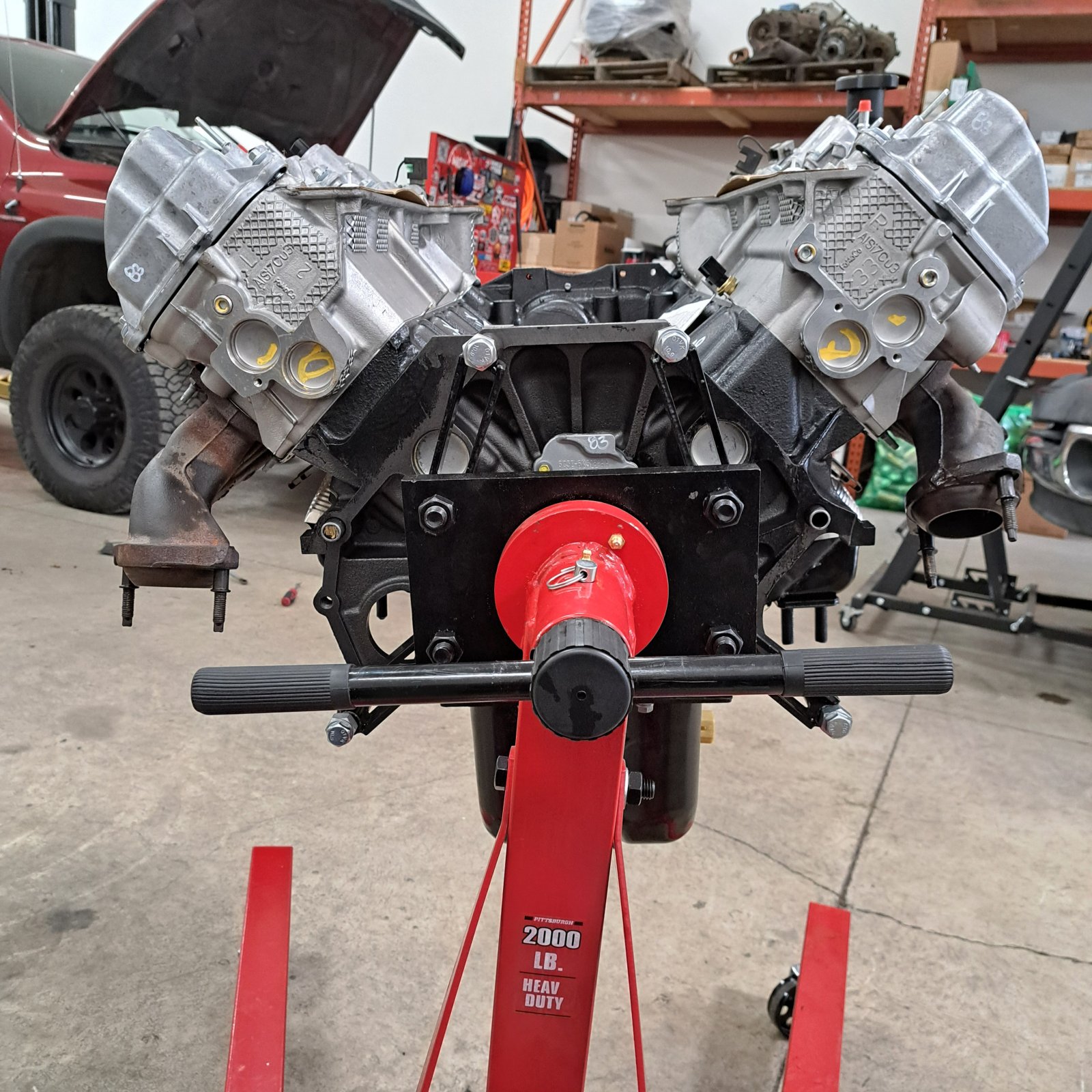

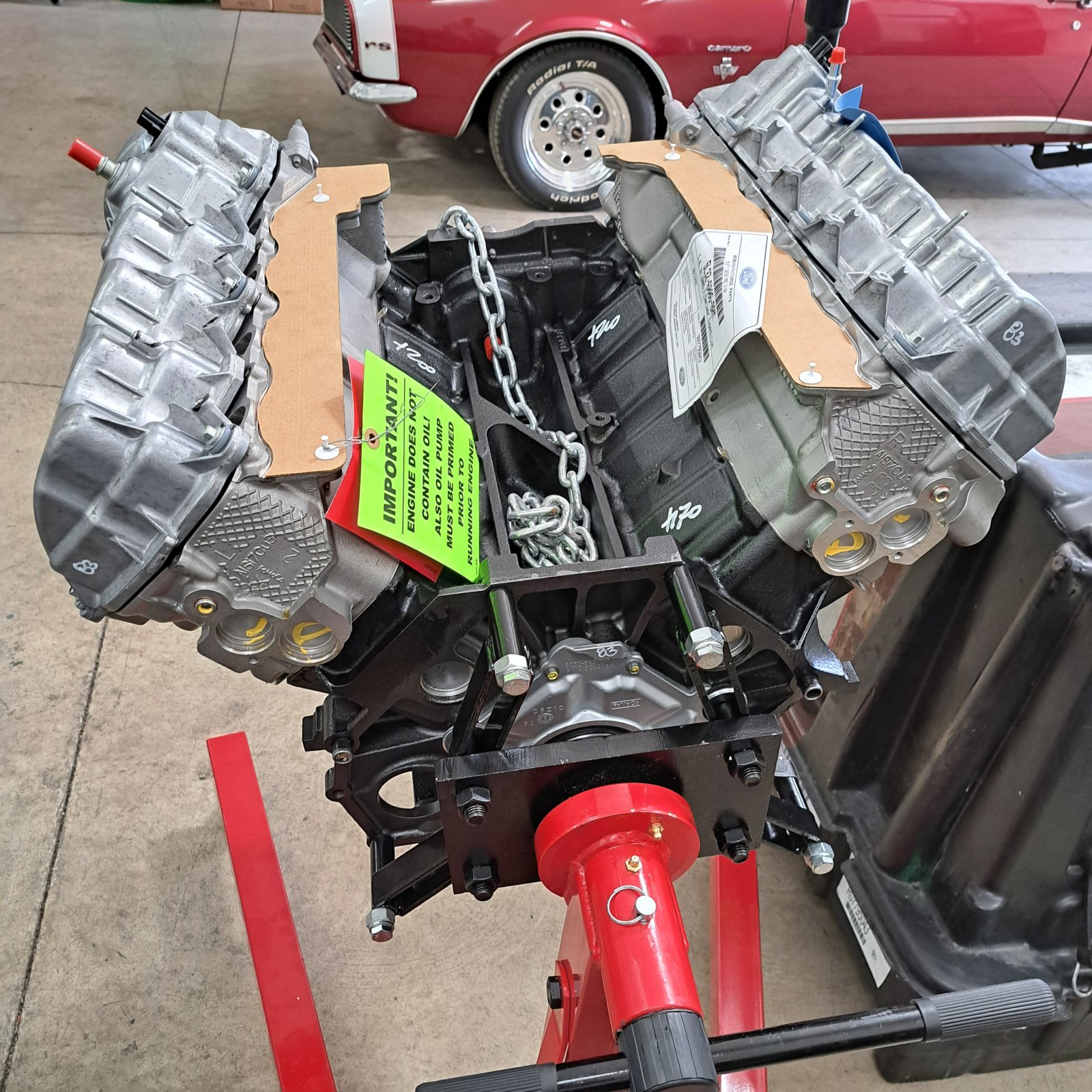

Got the new Ford crate engine on the engine stand and the old engine out of the 2006 F150, my neighbor's truck. Doing a reman transmission and a Ford crate engine. Started swapping over whatever did not come on the new engine. Ford supplied cam and crank sensor and gaskets/seals and oil filter.

I need to be clear about this engine swap. This is all being done at my friend's shop, in Junction City, Oregon. I do not do engine swaps at my home. My neighbor is paying him and I am showing up to help it all along. I am compensated by my neighbor and my friend. I was recently looking to go back to work as a service advisor but turned down two quick offers and decided I just want to help at this shop on a part time basis and turn wrenches sometimes and run errands and write some service.

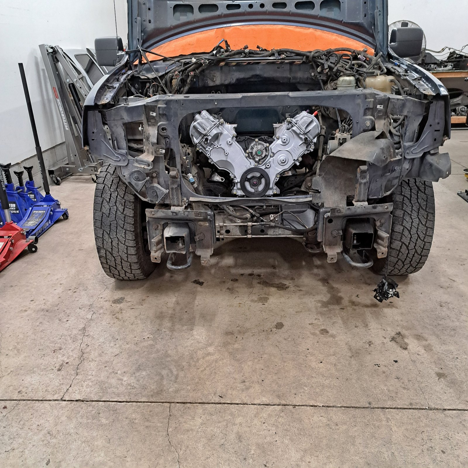

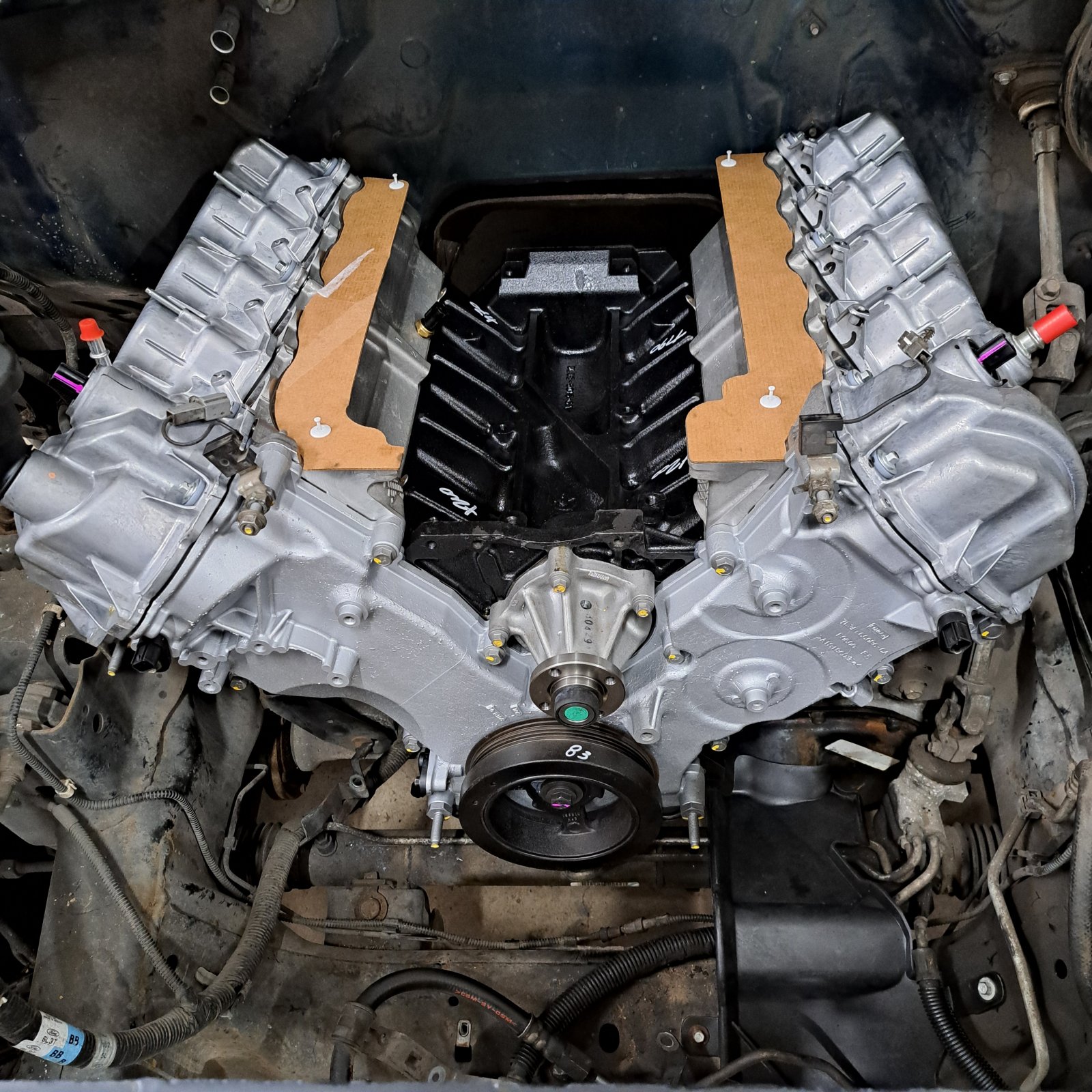

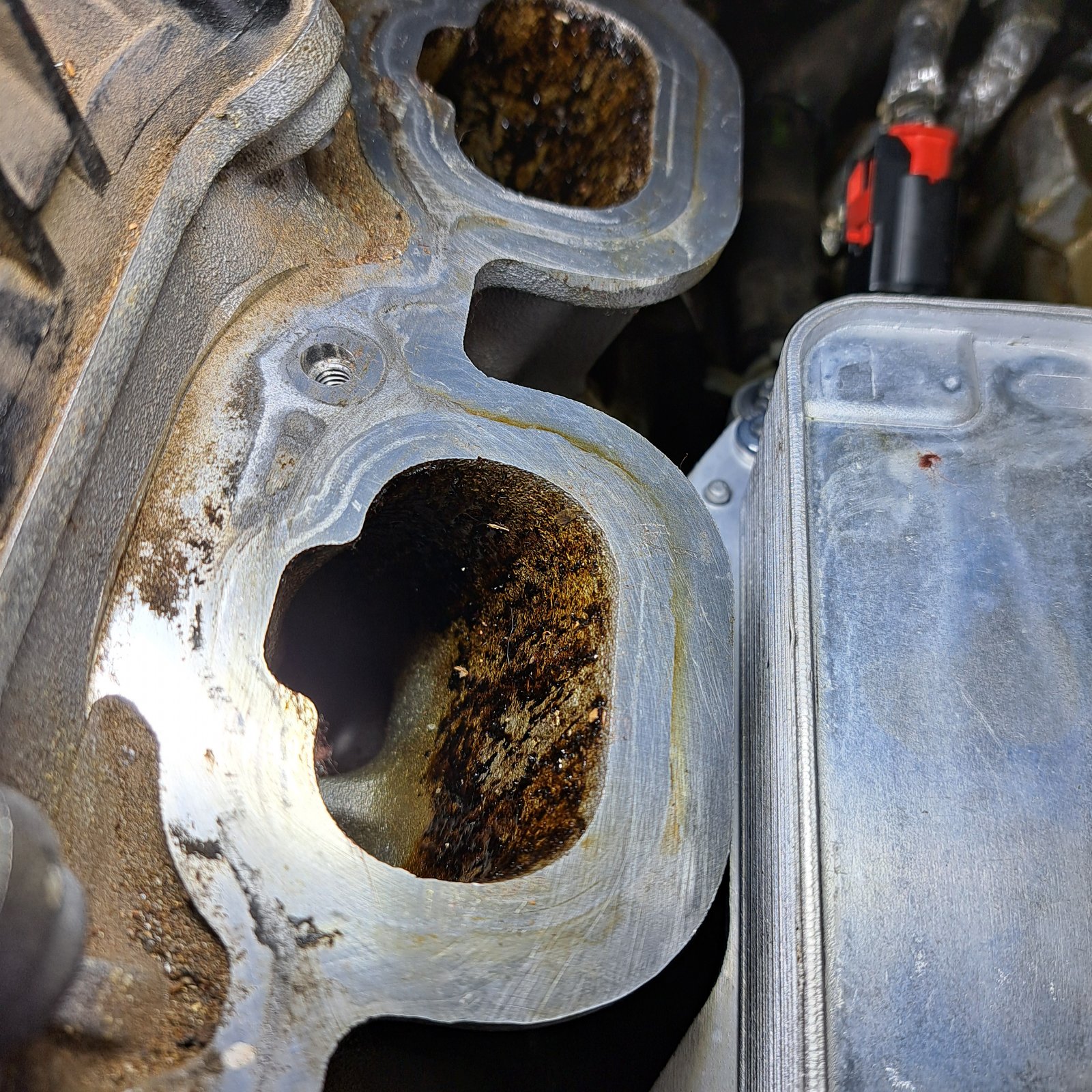

More progress today on the 2006 F150 engine/transmission work. Did the front diff fluid today too. The engine mounts attach to a plate and the plates bolt in at 3 points. They were cruddy and rusty so I cleaned both of them and painted black. chased all 4 exhaust studs for the Y pipe. mounted both motor mount assemblies and also checked the exhaust manifold for flat mount at heads and then cleaned them for the fresh exhaust gaskets. mounted and torqued to spec and prepped for dropping in the engine bay. Dropped the engine and went home.

So weird looking without the center camshaft and bulk steel of the middle of the V missing.
Yea, OHC and VVT make for very long timing chains. The failed hydraulic tensioners, for those chains, is what started all these problems and the big dollars spending for the engine and transmission and labor.
