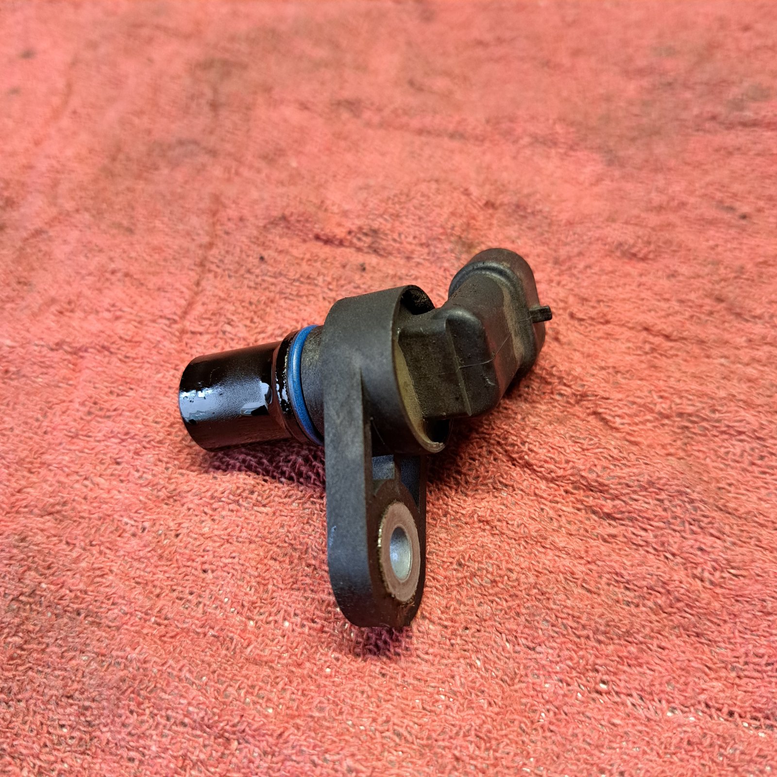

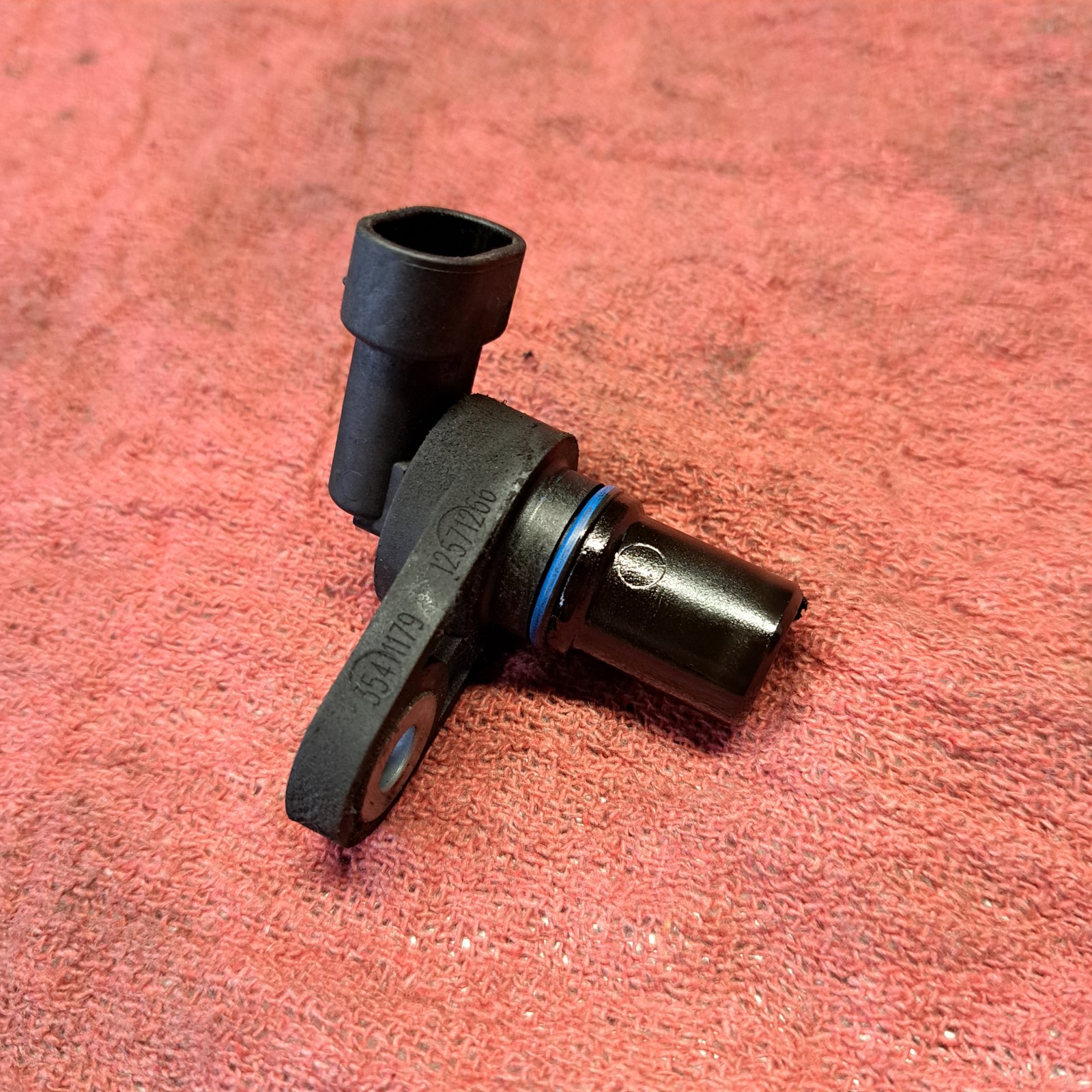

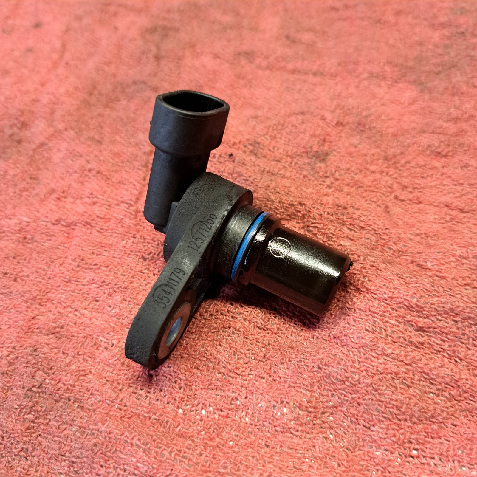

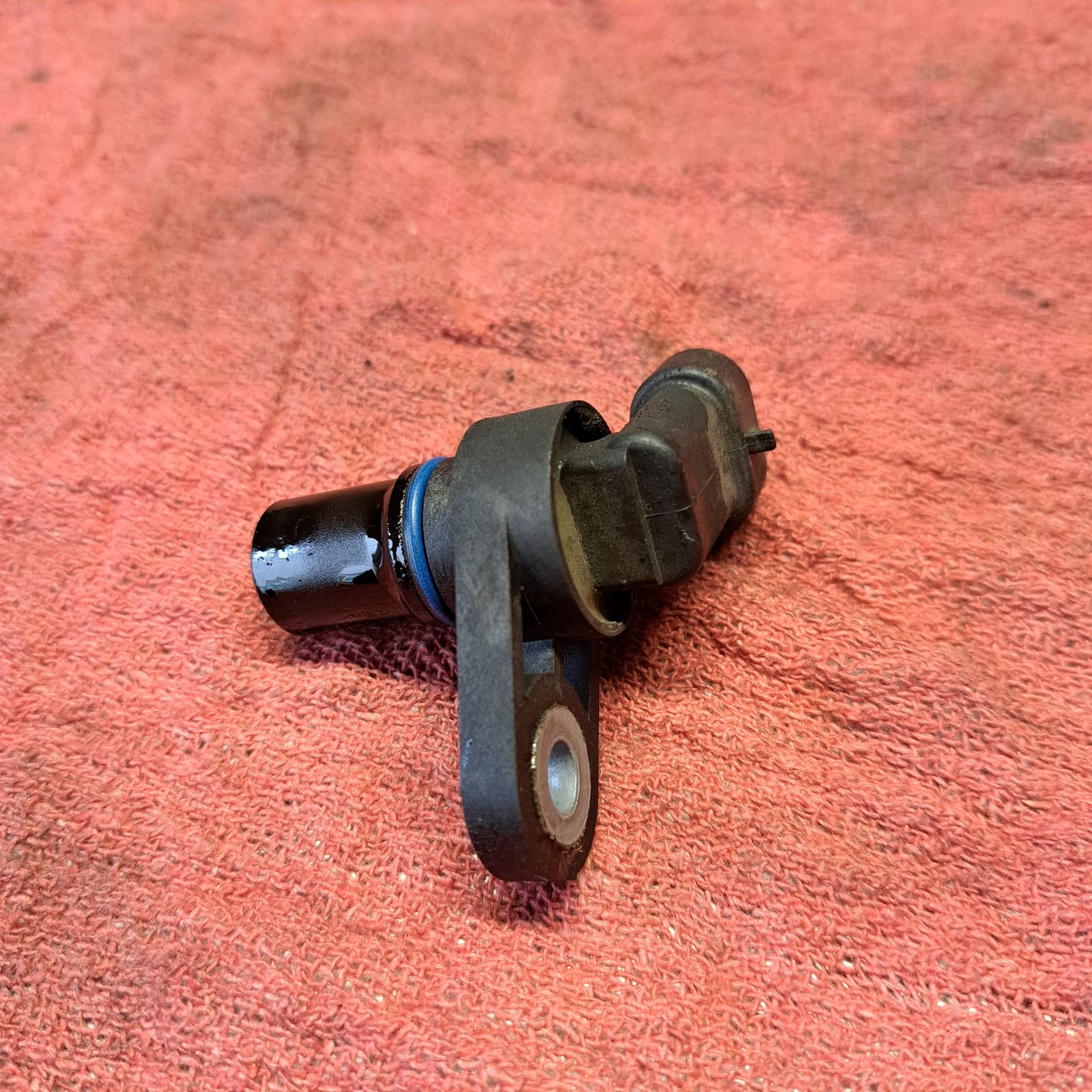

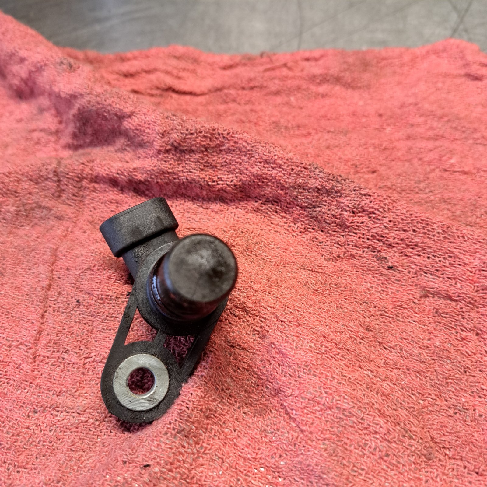

Since we had an ice storm here I have not done any work recently, except for a cam sensor on my girl's 2002 TrailBlazer 4.2. She had a sudden die at idle, in gear, at a stop light about 300 miles north. Started right back up but never saw a CEL. That was about 4 months ago. I looked at all grounds, fuel pressure and also checked for pressure loss, checked history codes and basically came up with nothing. Has been fine till about a week ago when the CEL came on and stayed on. Had a P0340 cam sensor related code. Ran great and no running problems or restart problems. Cleared code and has not come back. I ordered in a Genuine GM sensor and took extra time getting here because of ice storm.
Ok, so I replaced the cam sensor yesterday. Finally got the AC Delco/Genuine GM part in at AZ. It literally took all of 5 minutes to replace. I did find something interesting though. The attaching/hold down 10mm bolt was loose and backed out a bit and when I found that, I pushed on the cam sensor and it moved closer to head and bottomed out. There was no oil leak because the o-ring was still sealing in the hole/cylinder. So, it must have been floating at times. I wonder if the closeness to cam variance was enough to cause a CEL and the one time dying at idle at a stoplight? Here are the pics:
View attachment 419426View attachment 419427View attachment 419428View attachment 419429
The clearance ("air gap") of a Hall effect sensor is a precision specification. Do you recall the crankshaft sensor shims for the Vortec 350 and 4.3? On higher mileage engines, the wear in the crank bearings allowed the crank to move ever so slightly, mostly at high RPM, and the reluctor on the crank would actually contact the sensor tip. GM released a shim kit that was two .005" ring washers to space the CKP sensor away from the reluctor. You installed one and tested, then the other if one wasn't enough. That cam sensor is the same style and if it has visible slack, especially putting it AWAY from the reluctor, then I'd say that was the problem. If the PCM doesn't know where the cam is, it'll shut down all operations.
