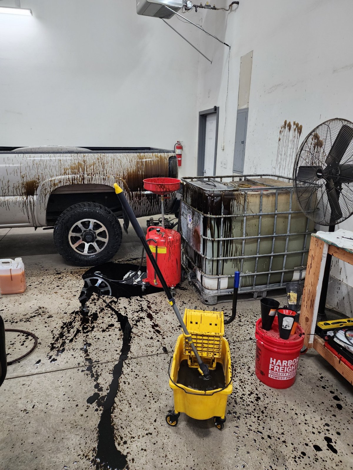

This happened today at my friends shop, close to where I live. Was dumping oil from the oil caddy to a storage tank and was under air pressure. got an air pocket and burped hard and the hose came loose at the tank and about 2-3 gallons of oil came out all over, as you can see. The truck in the background, is a shop truck. Fun times......

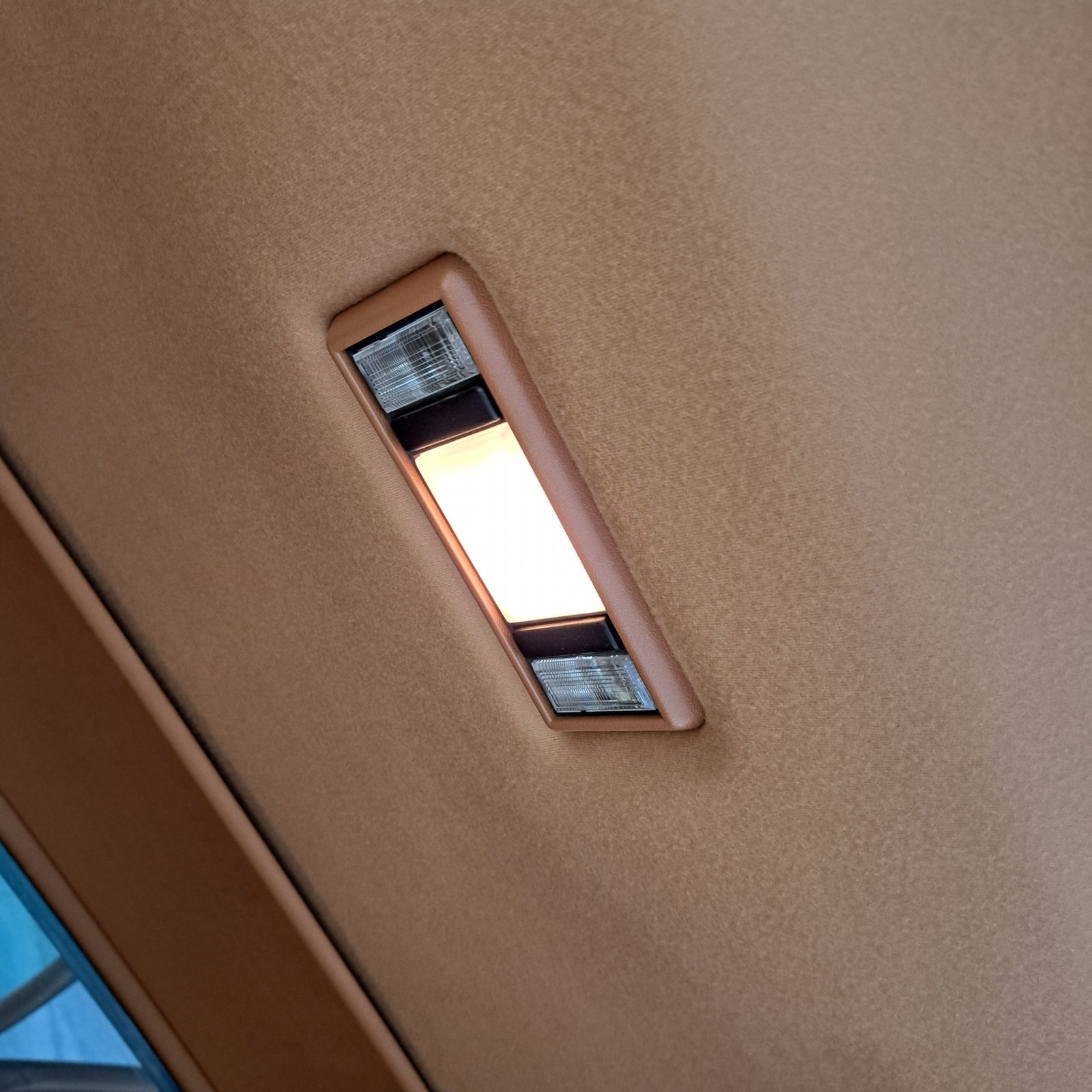

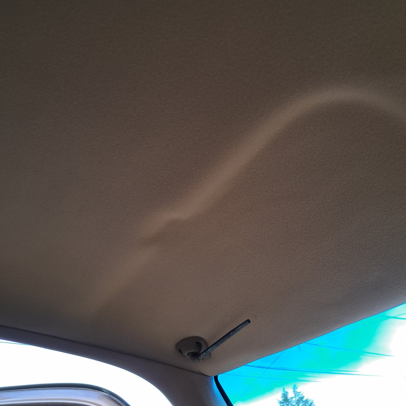

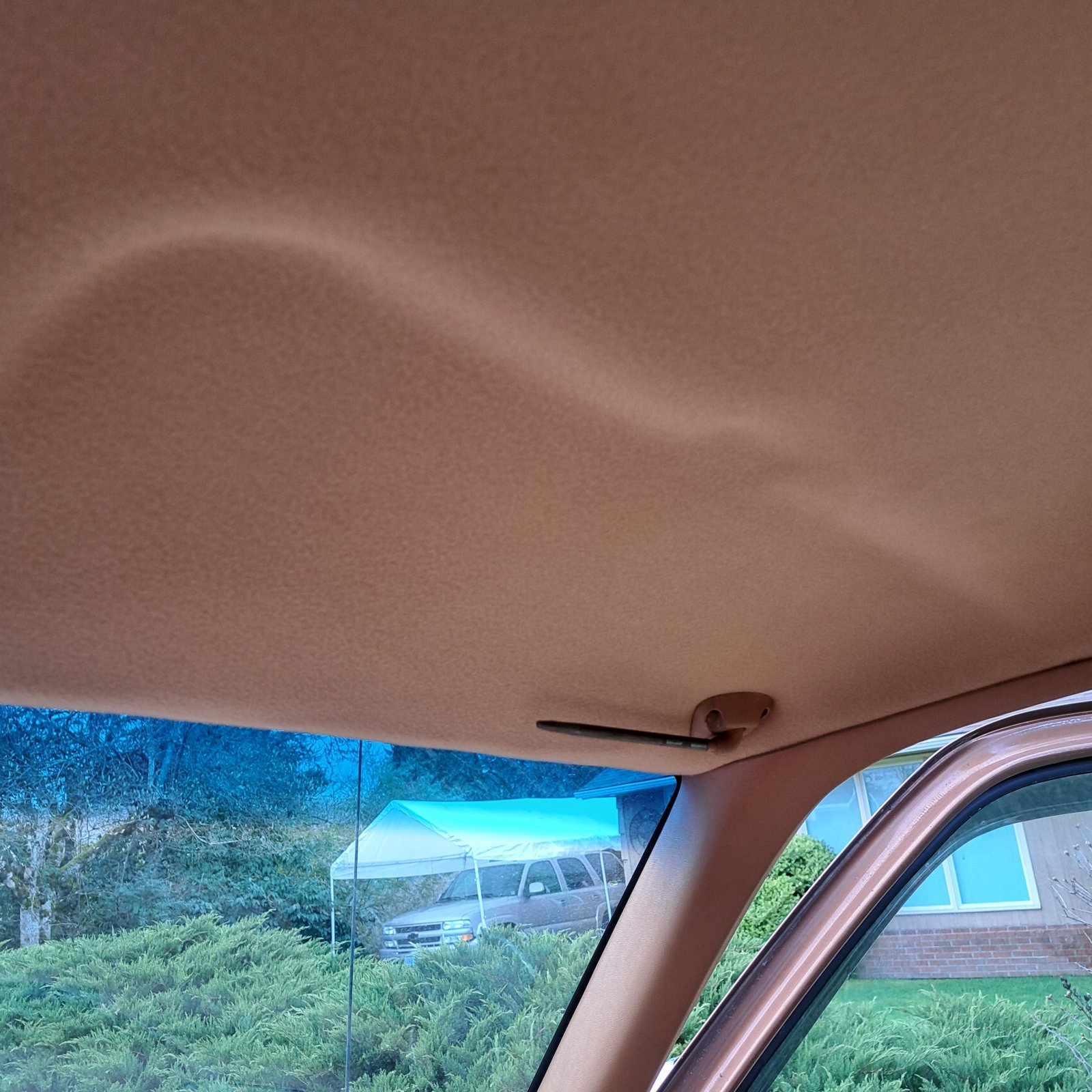

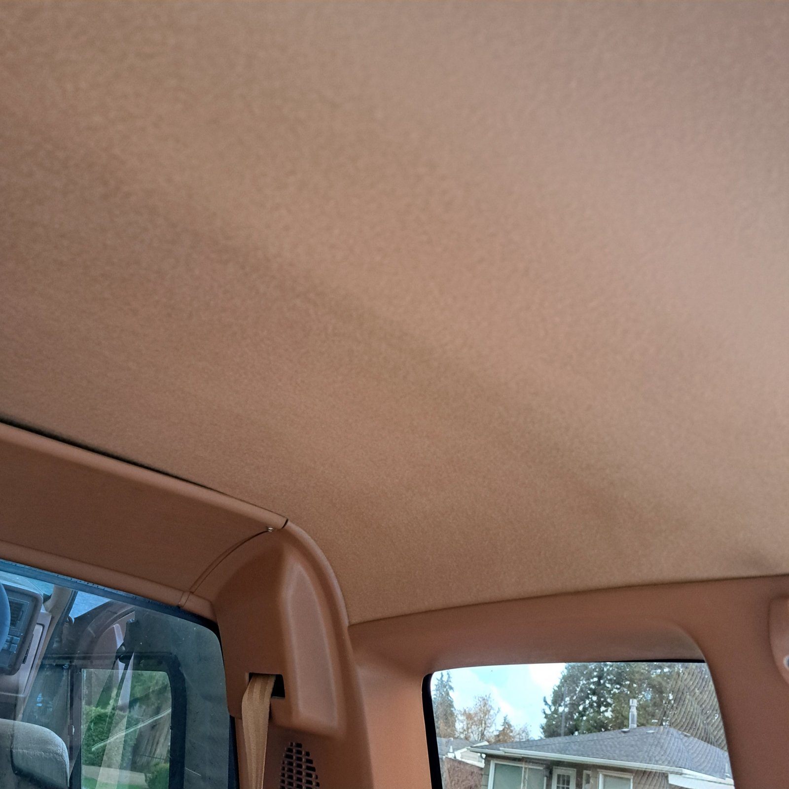

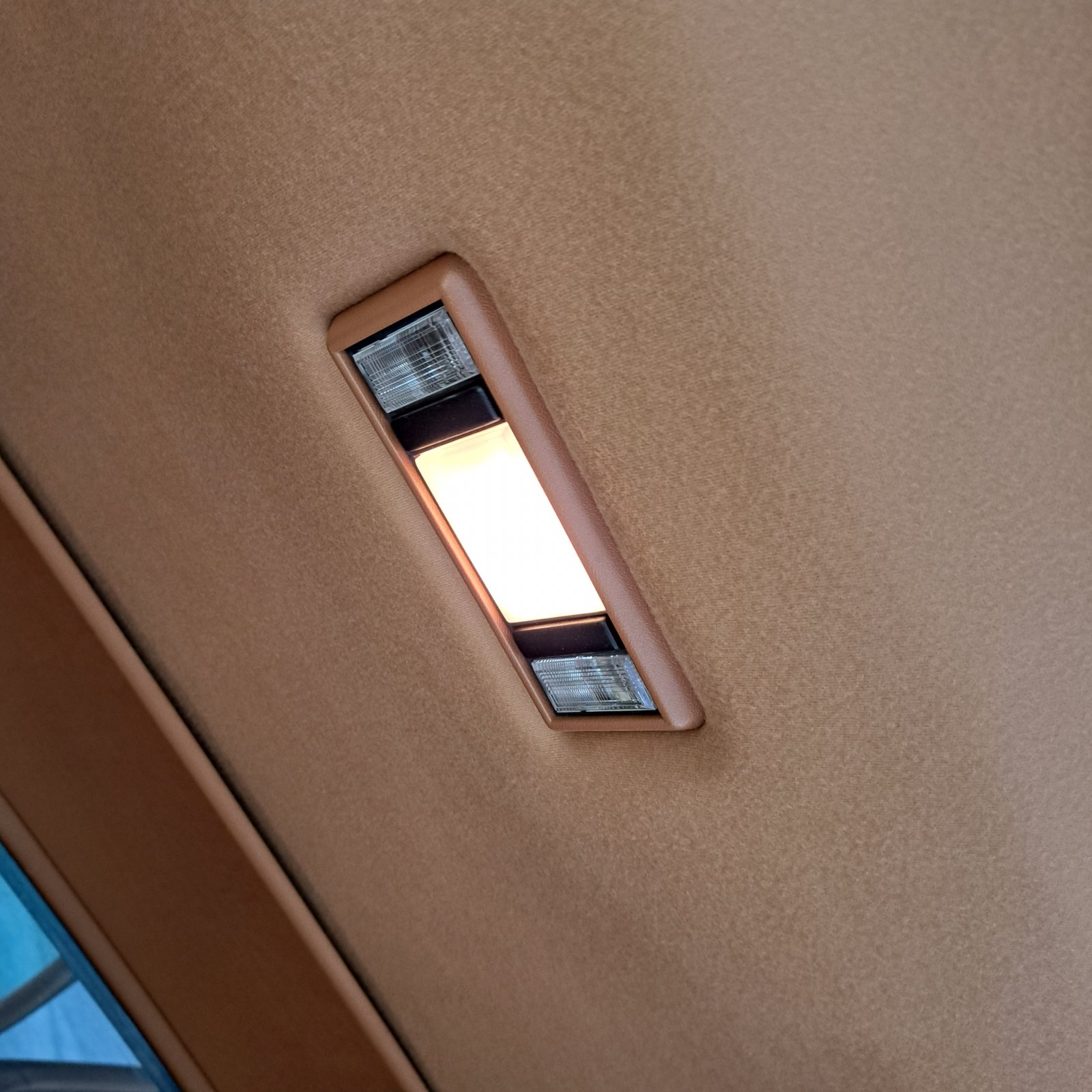

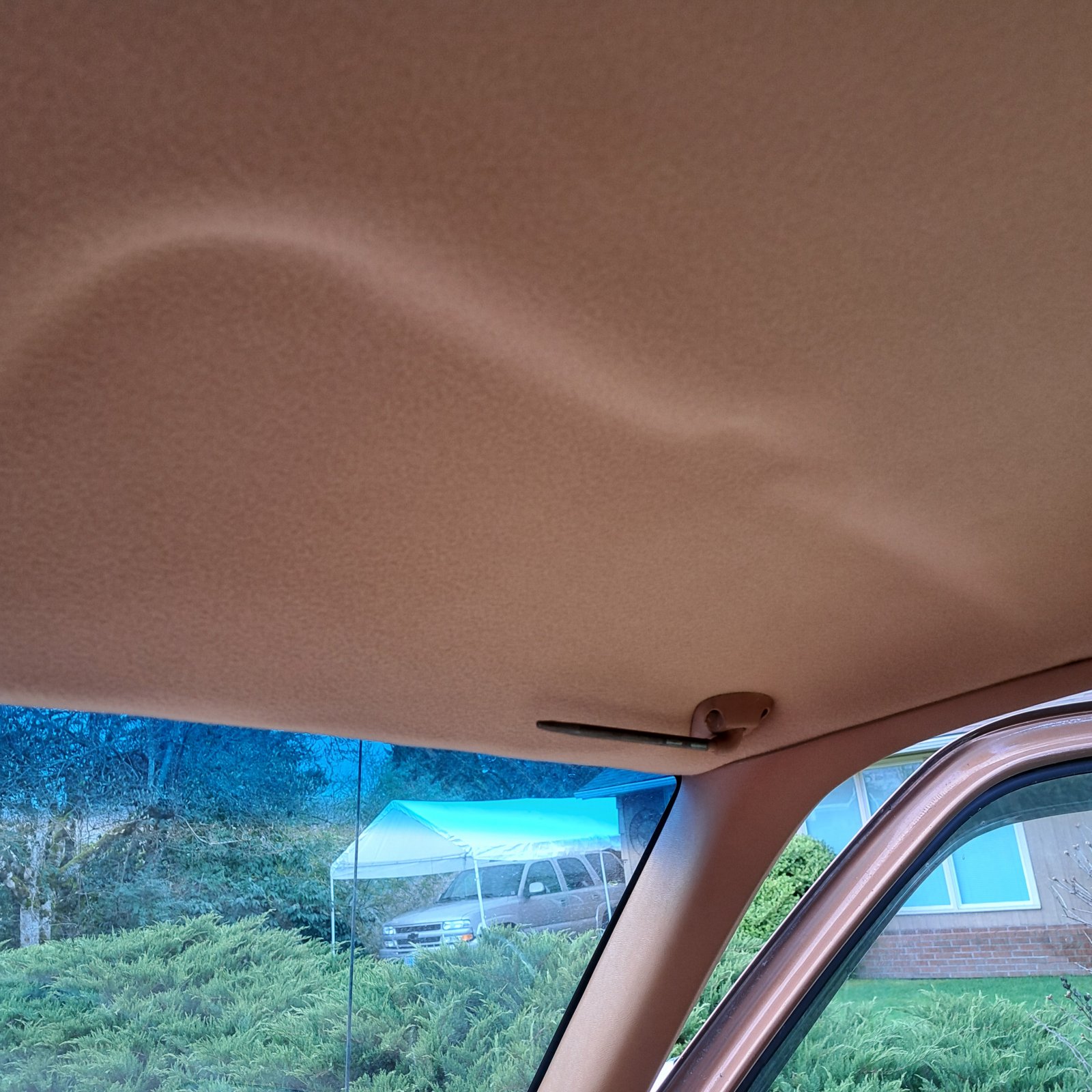

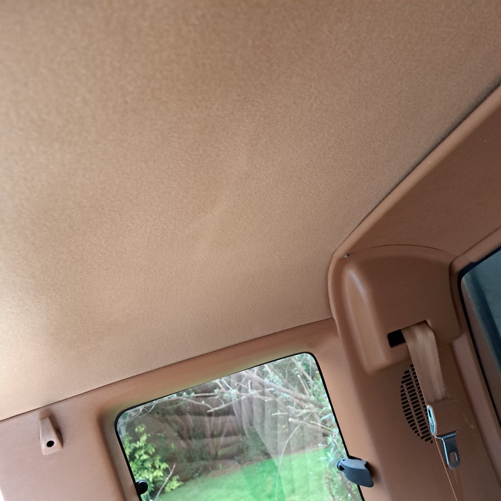

Headliners are a pita.
At least on this one, It was pretty straight forward. I expected to fight to get out and back in with the ext cab no rear doors problem. One person can do the out and in but with two people, it was easy. On a 34 year old truck, I had to deal with a couple broken clips but the upholstery friend of mine had fixes for both. Next is the transmission cooling lines replacement.
