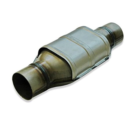

I will give that a shot tomorrow or tuesday when I can get out of snow haha. Thanks. I wanna do the cats but Im gonna be really bummed if that isnt it. I saw someone on this thread
has them cheap and then I just gotta pay to get them welded

you can also hit the cats with your palm hard, listen for stuff rattling inside the cat. if you hear it, cats clogged up, or even broken and clogging the pipe.
I tried that when i did o2s. Sound solid, no rattling or anything loose. Actually look very solid and clean from exterior too (I know that doesn't mean anything though). Im hoping maybe the computer needs to cycle and o2 sensors end up clearing it up. Im gonna hit with thermal temp gun this week and see if temps are in line
