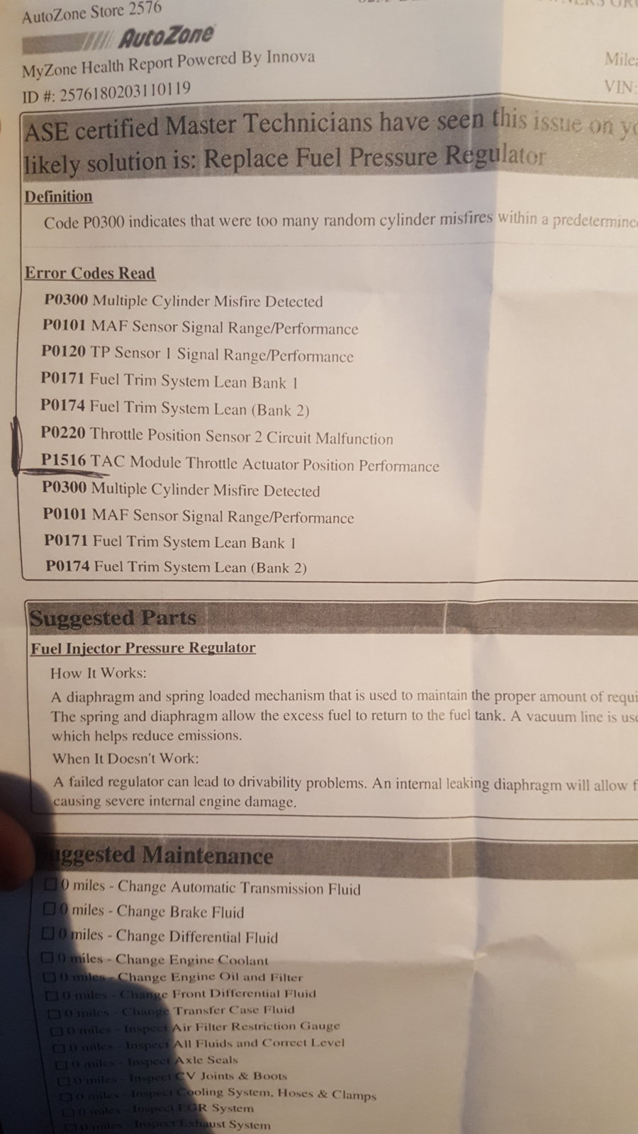

The good news is, its only 7 codes! Lol. 4 were repeats. However, these came upon battery disconnect and o2 sensor replacement. Im cautiously optimistic that it needs a run cycle to recalibrate. I will know tomorrow though as I will be putting on good chunk of miles tonight

P0300 means little, that's why mentioned codes. I would clear them all and just drive it. Sometimes the computers can get squirrely and need resetting. It's either that or your ECM took a dump. I'm thinking both and that you'll be replacing the ECM soon.

how you get to a bad ecu from a maf and tps codes?
dbw crap fails all the time. maf will make it run lean as hell and shift poorly and idle like crap. bad tps will *** everything up too. pcm has no idea what the throttle position is at. or its not reading the gas pedal sensors right.
pcm is doing its job telling you these things are acting up.

When all these codes pop up at once that's usually the case. Many sensors have specific codes that describe how a sensor either fails or why it is reading out of spec. In my opinion, he has too many codes at once and the first one was not specific enough to mean anything and that's why I suggest just clearing them all and wait and see.

im willing to bet his cel has been on for a long time and just now fixing it up. aka hes way behind on maintenance.
for all them codes, (7 really) hes got two problems, the rest are caused by the tps and maf codes.

My cel was never on. Flashed over 80. Stayed on since i changed o2 sensors yesterday. Hoping it just needs engine cycle

check for a blown fuse or two. could be the cause too. bad fuse would set the cel asap as well after being cleared.
