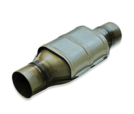

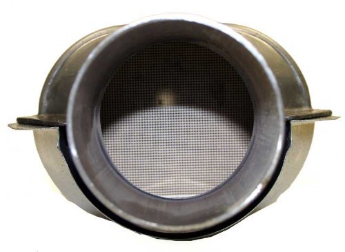

A quick and dirty way to tell if a cat is clogged is to hit its inlet and outlet side with a IR thermometer (Infra red gun). The outlet should be real close if not equal to the inlet temp reading. If the outlet is substantially lower its because the cat is clogged.

typically only two things make the cel flash is, needing a tune up real bad, but you got that covered, the other is clogged cats. clogged cats cause? yup you got it, random misfires.
it likely also feels down on power too when wot.
