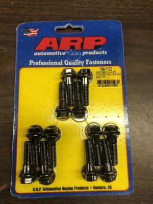

So quick dumb question on this one..... I got the arp 134-1102 bolts that are flanged and come with washer. Do I actually use the washers on the manifold install?

Got these...
